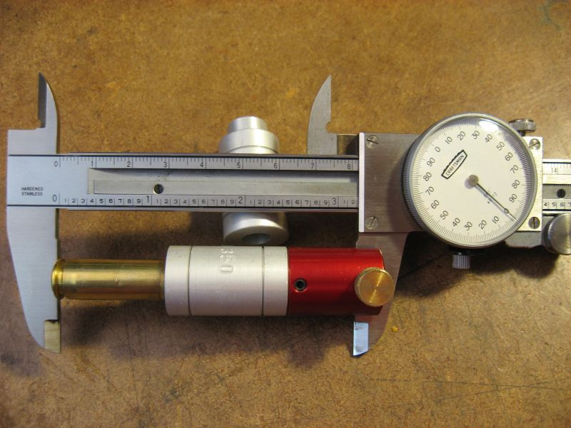

Cant say because you dont give us the loaded round diameter from which to calculate your bushing size, only that you are using a .336. Generally you want the bushing to size .003-.004 under loaded round diameter and then open up to .002" with the mandrel. By your phrasing your .336 is probably .002 under the loaded diameter and you arent using any expansion step but thats just assumption.

Before buying any more dies and shell holders I would just try it with the full length die you already have. Size a piece without the expander ball to measure how small it sizes it down to. Then do it with the expander ball installed and you can see how much it opens it back up and what your resulting tension/interference fit is of a loaded round.
