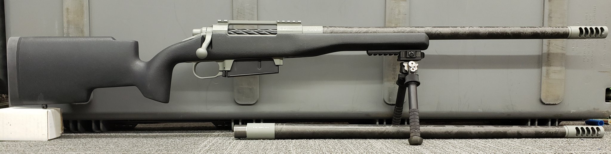

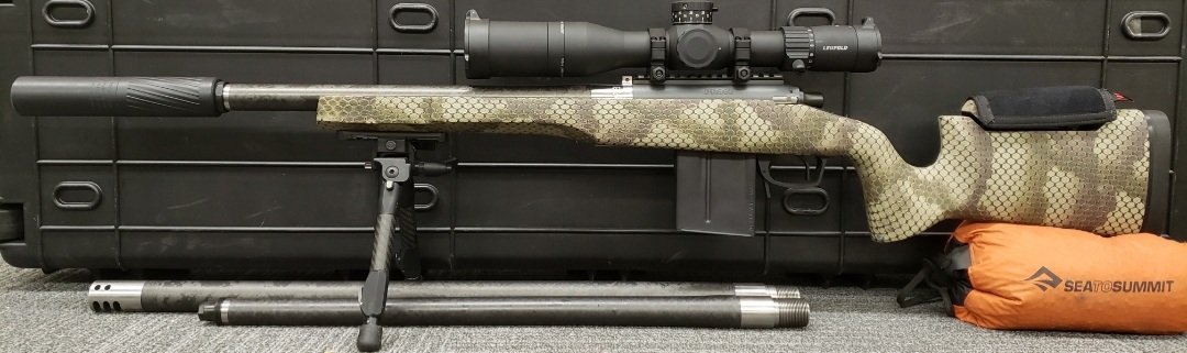

    I run one WTO switch barrel setup and two rifles I switch the barrels out on a Short Action Customs modular barrel vise (all Proof carbons)
    - 308 face WTO rig: 16.5" 22 Creedmoor, 26" full bull 6mm Creedmoor, and a 22" 7 SAW.
    - Short Action Mag face: 24" 6.5 GAP throated for the 156's and a 22" 300 Sherman Short Mag
    - Lapua face: 22" 300 Norma Mag 35° Improved and a 26" 338 Warthog (Robert Gradous design 40° Improved).
    These calibers scratch every itch I have from coyotes to Yukon moose and everything between.
