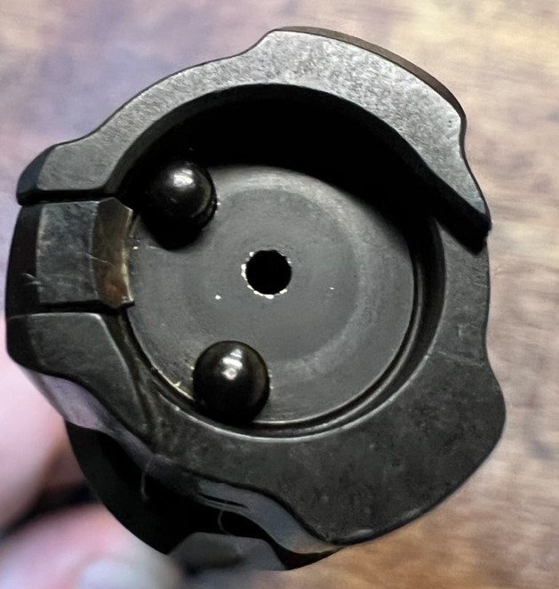

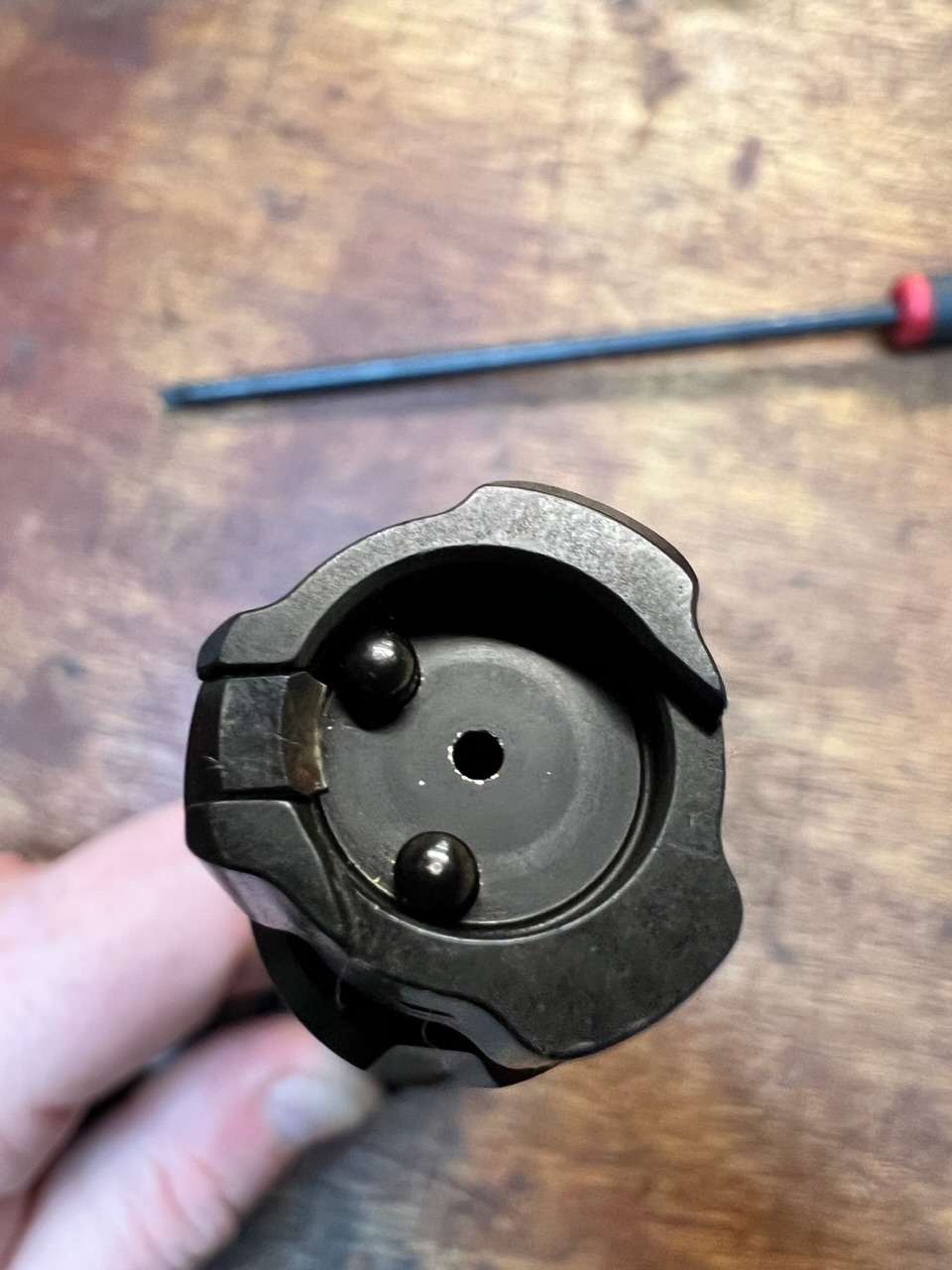

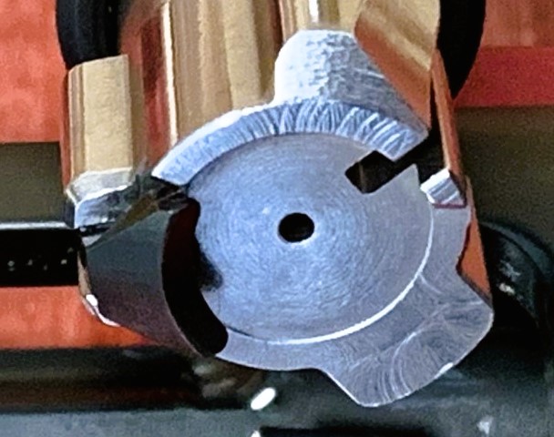

I did say I wasn't worried about it, but I do think it important to keep manufacturers to task with QC. Or the deal we get isn't quite a deal anymore. I have the skill & ability to fix blemishes like that. I would just prefer I didn't have to.
The bolt face looks pristine.
You know what the bolt face is, don't you? I mean, you wouldn't be posting if you didn't know what the a bolt face was, would you?
Oh you going to launch an argument in the minutia of nomenclature when everybody knows what the fuck we are talking about. That was a red hot sizzling "Point of Order" you had there. I am so proud of you. I know what comes next, if I misspell a word, or have a grammor error...
I would personally prefer it didn’t have tool marks at all.
The bolt nose is far different than the face for where I’d rather have them though.
I’ve bought more expensive actions with more tooling marks, but I didn’t like that either.

I think this will be dealt with. No reason why it should be that way. As complicated as the machining is all over this thing, the bolt nose marks seem like a fluke to me.
Agree, and I don’t understand why we wouldn’t want them too.
I have no doubt that bold head passed QC.

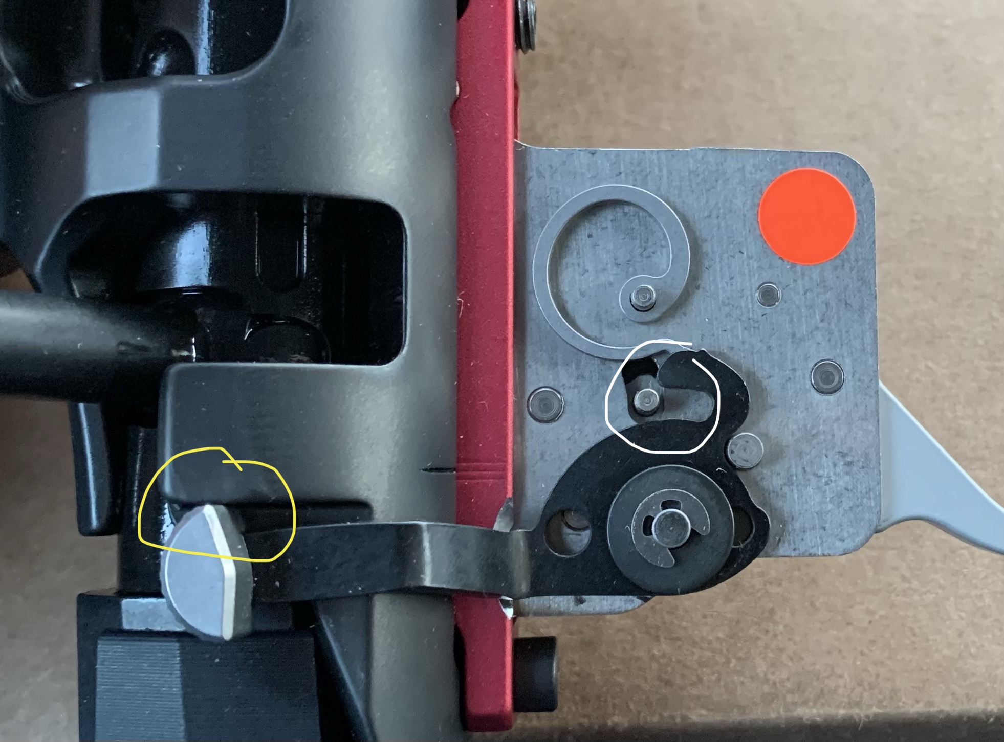

I have the pivoting handle, and I’ll be playing with several triggers. The trigger on it now is a B&A Tacsport two stage.
The trigger hanger needs to be clearanced for the safety lever on this trigger. Also, the knurled (top) portion of the safety needs to be altered to clear the receiver. I have two of these triggers here. Unaltered, one works and one doesn't. See pictures of the one that works.
Yellow circle: Contact with the receiver. This prevents he safety lever from moving all the way to the fire/vertical position. The hook near the safety lever pivot (white circle) grabs the pin preventing the sear from falling. The trigger pictured works. The trigger which doesn't work looks exactly like this, but the hook is just a few .001’s closer to the pin so the sear breaks, but the hook stops full release.
Note the clearanced trigger hanger under the safety lever.
The adjustable hanger system is awesome, and very easy to adjust.

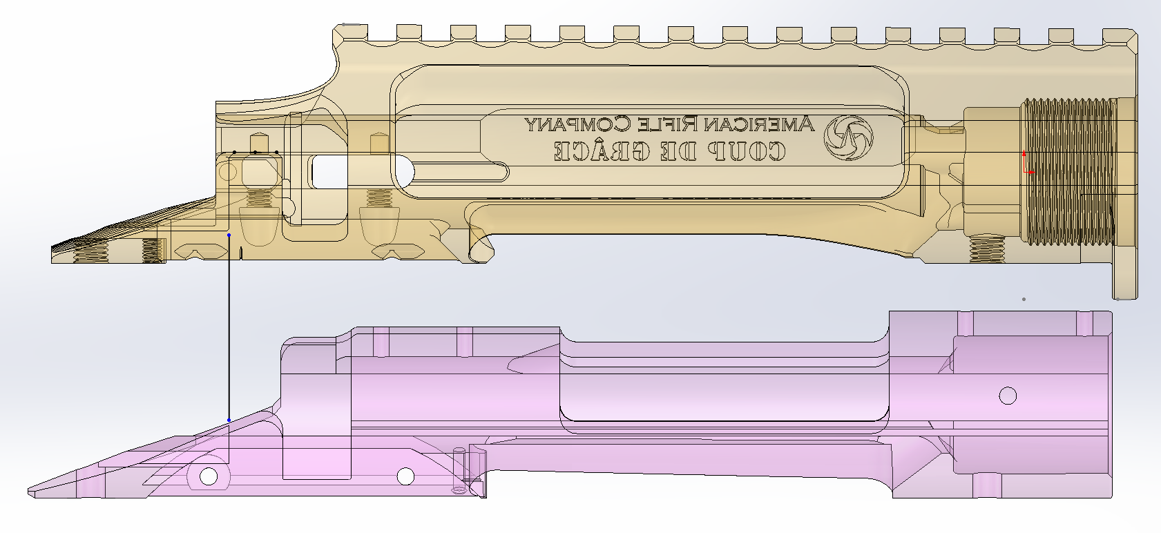

The surface against which the safety lever is impinging coincides with that of the Rem 700. See pic below. Guard screw holes are used for alignment. I suppose we could bump it forward a bit but it would be nice if triggers advertised as R700 compatible were actually made that way.

I agree, and wasnt trying to imply it doesnt. The CDG does appear tall to me though, and square. Perhaps the sloped rear face of that portion on the R700 prevents the lever from hitting anything.

Ted is correct here, the BnA triggers have an oversized knob on the safety lever which is the real problem. I've ran into this issue before on other actions with a BnA not fully disengaging the safety because the front of their oversized safety knob hits the action. Easy fix is to remove some material from the front surface of the BnA knob.

It appears to be in the same forward/aft location but is also that wall has a taller vertical projection. On the standard rem 700 footprint receiver I believe that B&A safety winds up clearing above where that wall terminates.

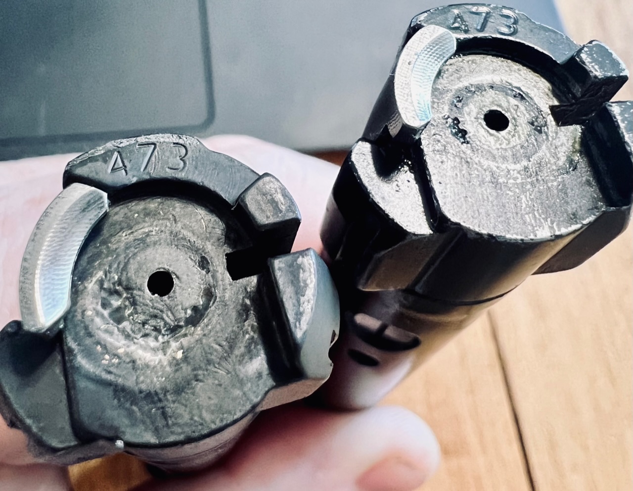

Is this better?
img_8539-jpeg.457716
Take things out of context like a fucking liberal Democrat. The truth of that cherry picked photo is me showing the result of a batch of faulty Winchester primers. But this moron knows that.

Here’s the thread: https://www.snipershide.com/shooting/threads/winchester-primers-bad-lots.7171148/
I have quite the eye for dogshit bolt faces.
The only argument that was lost is tooling marks on the nose is a QC failure.
I'm certain it meets "250Ra or better", but I'll wait for @superpubes to give us his profilometer reading.

that solus is all marked up too. it's a machined product. it happens.
Implying that the nitride is hiding it is also implying that the nitride is covering it. Nitride changes surface hardness and color(on most gun steels) but won't hide surface imperfections and machining marks..
Ever hear of trick of the light? Color & contrast?
