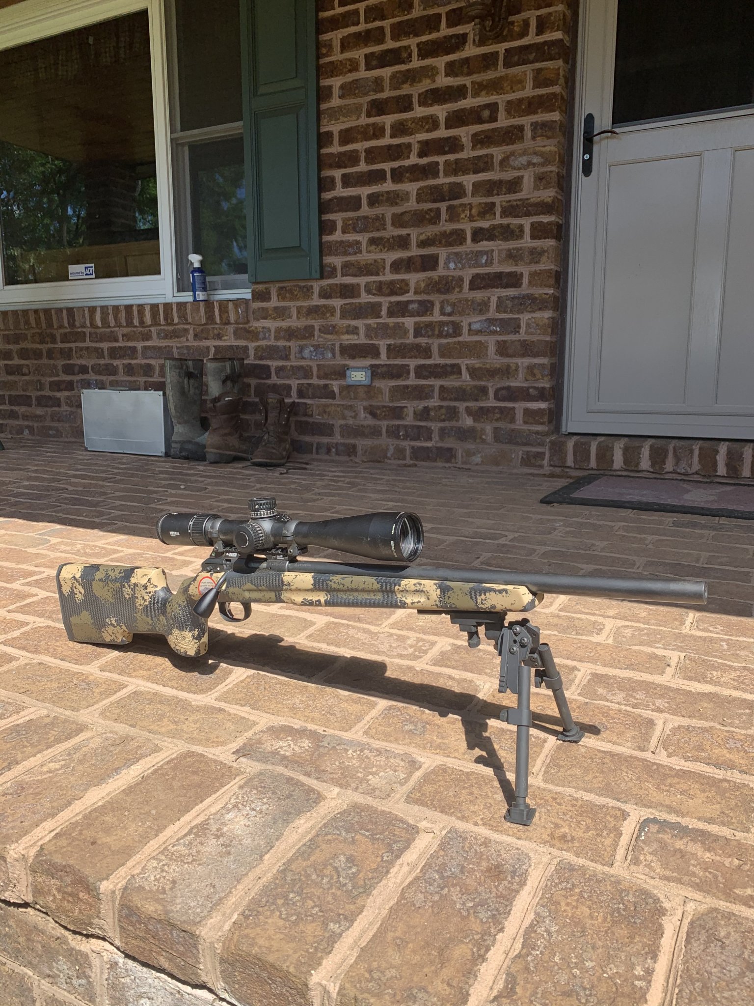

JAS-SH - I'd say you won the wood lottery with your 457 American. I've seen several photos of CZ RF stocks over on RFC that were very attractive, and I have to say yours is about as good as any 457 I've seen so far. I've ordered in two Americans, a Varmint, Varmint MTR to date, and the American I decided to keep (mostly because the stock was more attractive than the other American's) shot like crap. It was so bad that I bought a Shilen bbl blank, did some contour work on it, then chambered & glued it into my action. Hope you appreciate how lucky you were to get a stock like yours....enjoy!
Reactions: JAS-SH
Thanks!! I will. Imagine my surprise when I opened the box at the FFL!

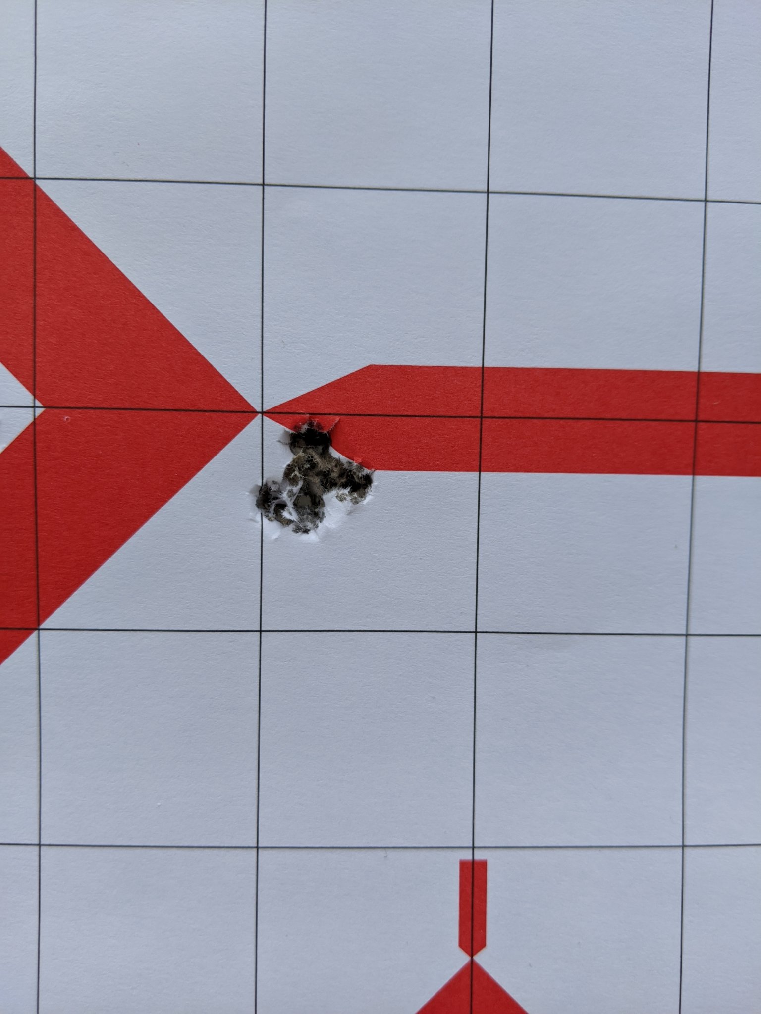

My new CZ loves the CCI, and definitely some old RWS ammo I found in a box. Yellow box Eley grouped really good as well. The CZ Chassis is nice and sits well. I did have a few flyers with the CCI, but could have been me or the wind .

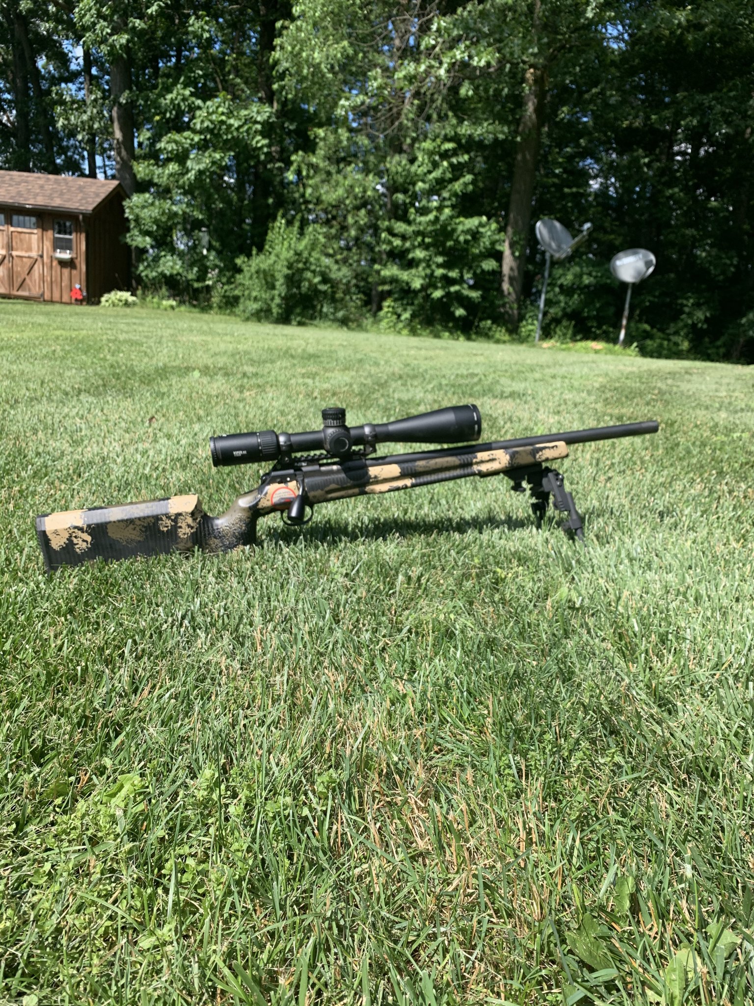

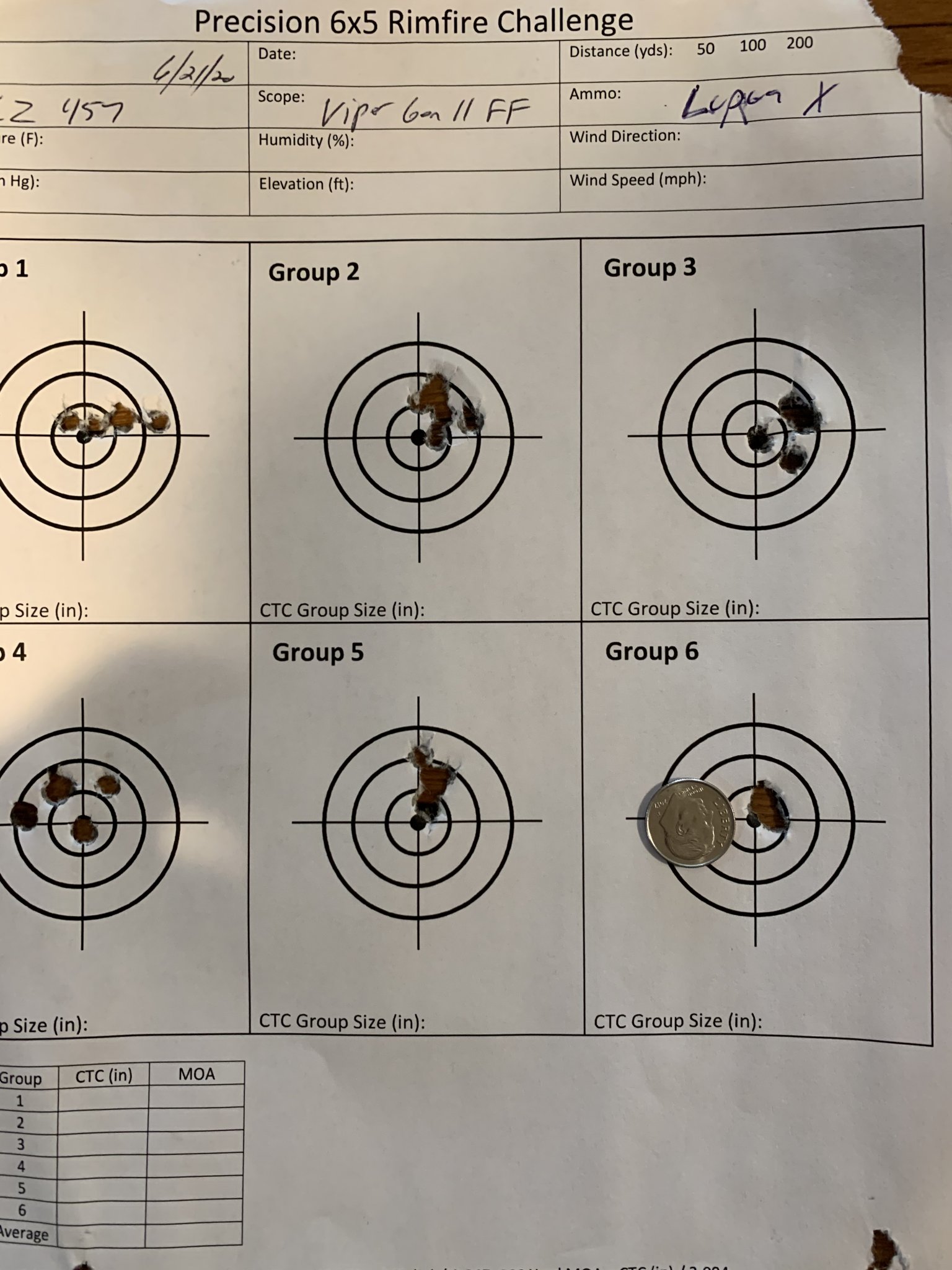

Spending Father’s Day at the range with my father and testing ammo at 50 yds. Bibop and rear bag I really like this CZ 457 every group but 2 I could cover with a dime even with me pulling my share. Hoping as I run thru lots of Ammo I can fine even better. It’s set up with a viper gen 2 FFP, area 419 30 moa rail and a converted badger knob and I added a Picatinny front rail for a bipob

Spending Father’s Day at the range with my father and testing ammo at 50 yds. Bibop and rear bag I really like this CZ 457 every group but 2 I could cover with a dime even with me pulling my share. Hoping as I run thru lots of Ammo I can fine even better. It’s set up with a viper gen 2 FFP, area 419 30 moa rail and a converted badger knob and I added a Picatinny front rail for a bipobView attachment 7356589
Nice looking rifle and good shooting to

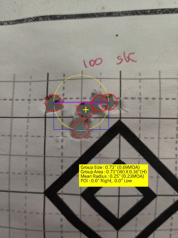

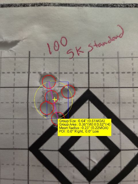

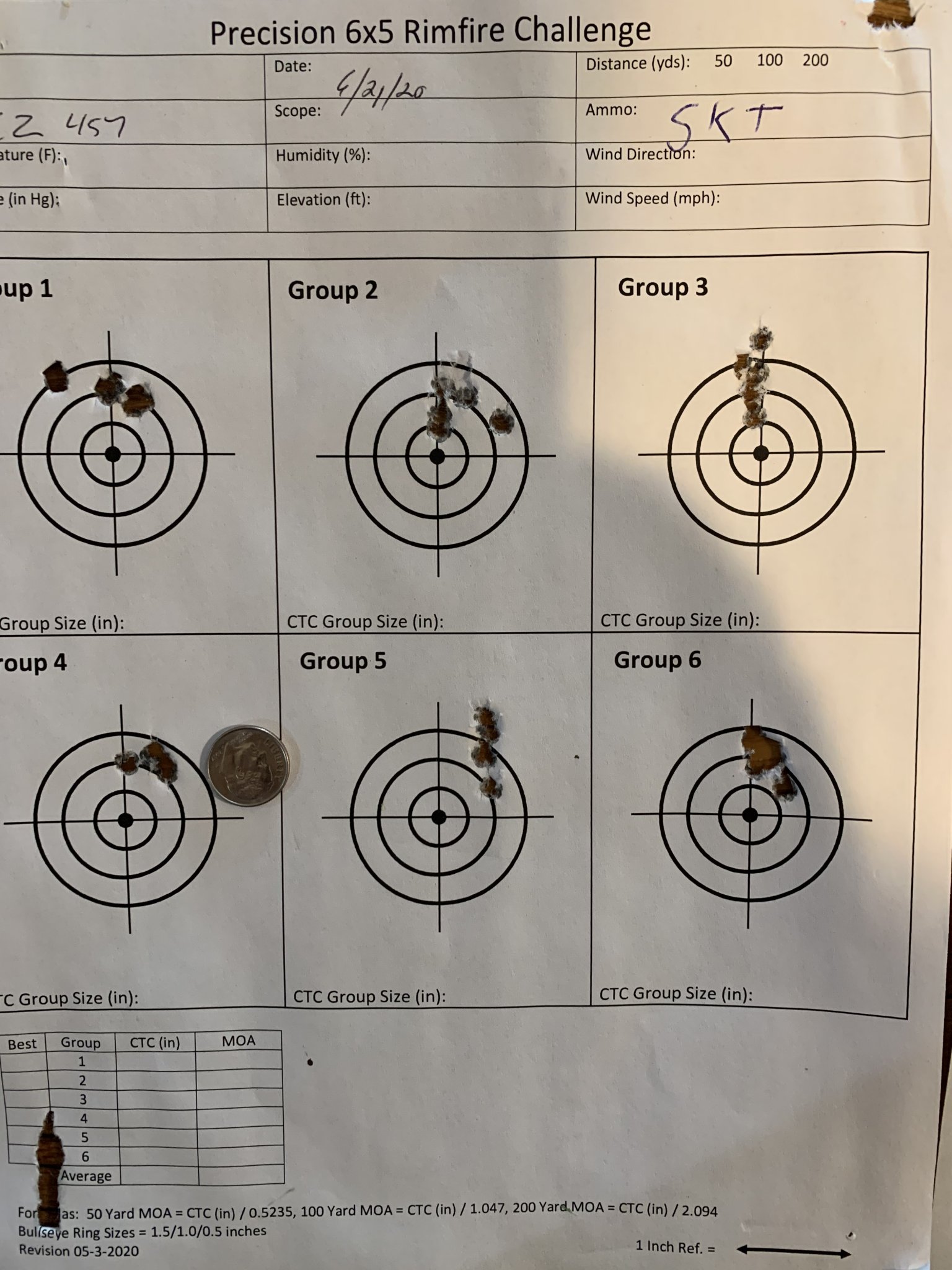

Had a few minutes before the rains came this morning and shot (Only) 2 bulls each on 3 targets trying out test lots of SK Standard Plus. One lot was not good - one was fair and one shot the two groups I am posting. Still trying to figure out how to use Range Buddy (without reading the directions) and so far only know how to post a picture at a time. My 2 groups from the first lot I tried - the best of the three. 100 yards with virtually perfect conditions here South of Houston. Didn't try to get the groups centered up just put it on paper.. This is from my 457 in a KRG chassis with a take off old Anschutz barrel cut down (from the chamber end) by Evelio McDonald to ~24 and rechambered with a Win 52 reamer. I'm very satisfied with this accuracy using ~5.00 ammo.
Reactions: Frankr and Hattrick
Thxs

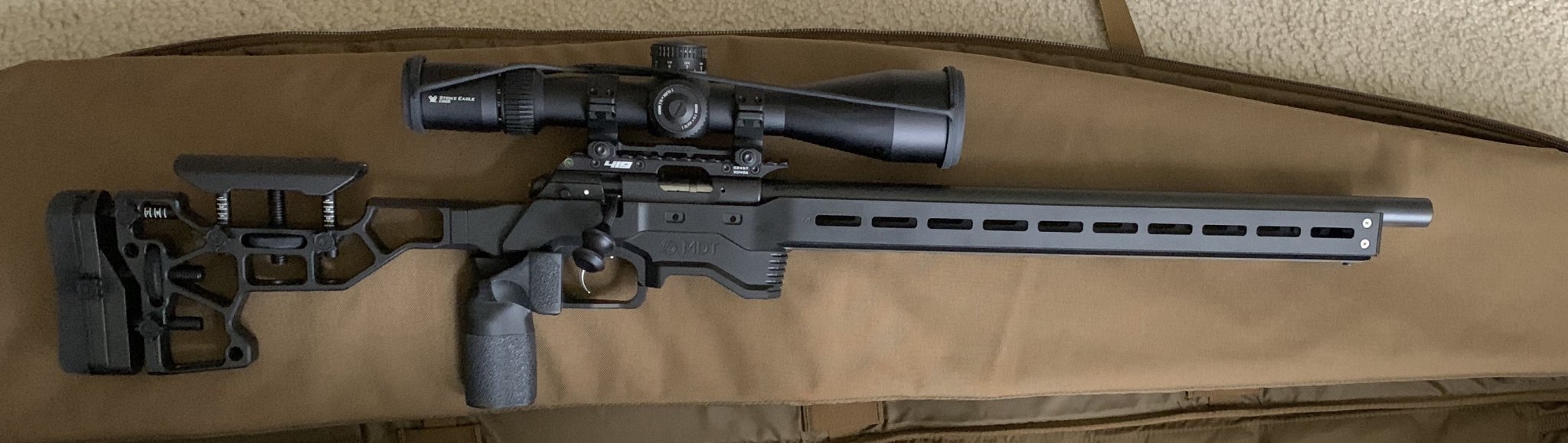

I'm looking for some magwell pictures of a KRG bravo, MPA and any other chassis or stock with the CZ mag in and out. Just trying to see how they fit in the large opening and how easy is it to hit the mag release.
I sometimes had to "look the magazine into the opening" but after few days it is pretty much an automatic. The Mag Release, once your are familiar with it, is not bad. I don't have any extension on mine and am fine with it.
Don't have an MPA - I am satisfied with the Bravo....

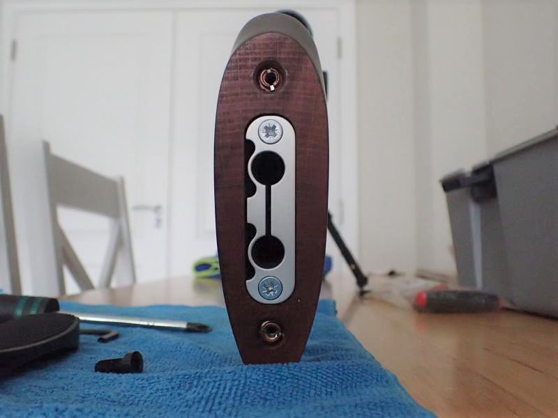

Can someone with a CZ 457 MTR help me out? I want to know if the wooden buttstock is solid wood? If anyone could remove the recoil pad and confirm it’s solid wood and post a picture it would be greatly appreciated.
I don't see any holes in the rubber buttpad that would allow me to remove screws - might be glued onto the black plastic plate under the rubber pad for all I know. But as near as I can tell, the buttstock is solid w/o any large holes bored out underneath the plate. Curious as to why you'd ask about this in the first place?
If the stock is solid, I can send it out to a guy I know that works on stocks. He can cut the stock and make it into an adjustable comb/cheek pad and adjustable buttstock. Thanks for checking!
That's one thing I really liked about the MTR's stock - with a low/thin 25MOA rail like the BScar, and a scope in low rings, I found I don't need any higher comb than the MTR's.
I have a MTR that I removed the recoil pad an added a 3/4 inch aluminum spacer. It was solid wood on mine. I also drilled a hole and filled it with lead pellets and epoxy. Recoil pad is glued on and also has 2 screws. Sorry about not having a picture
