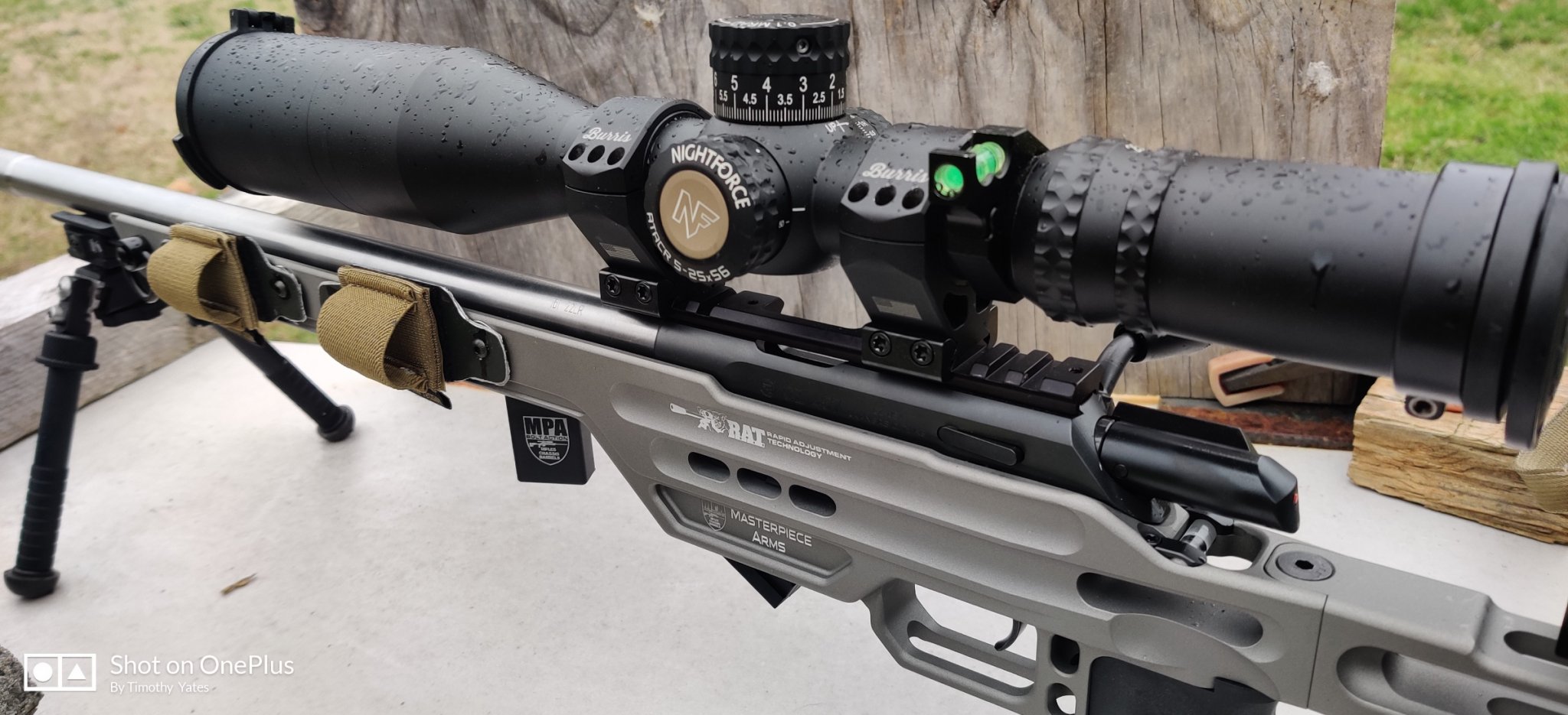

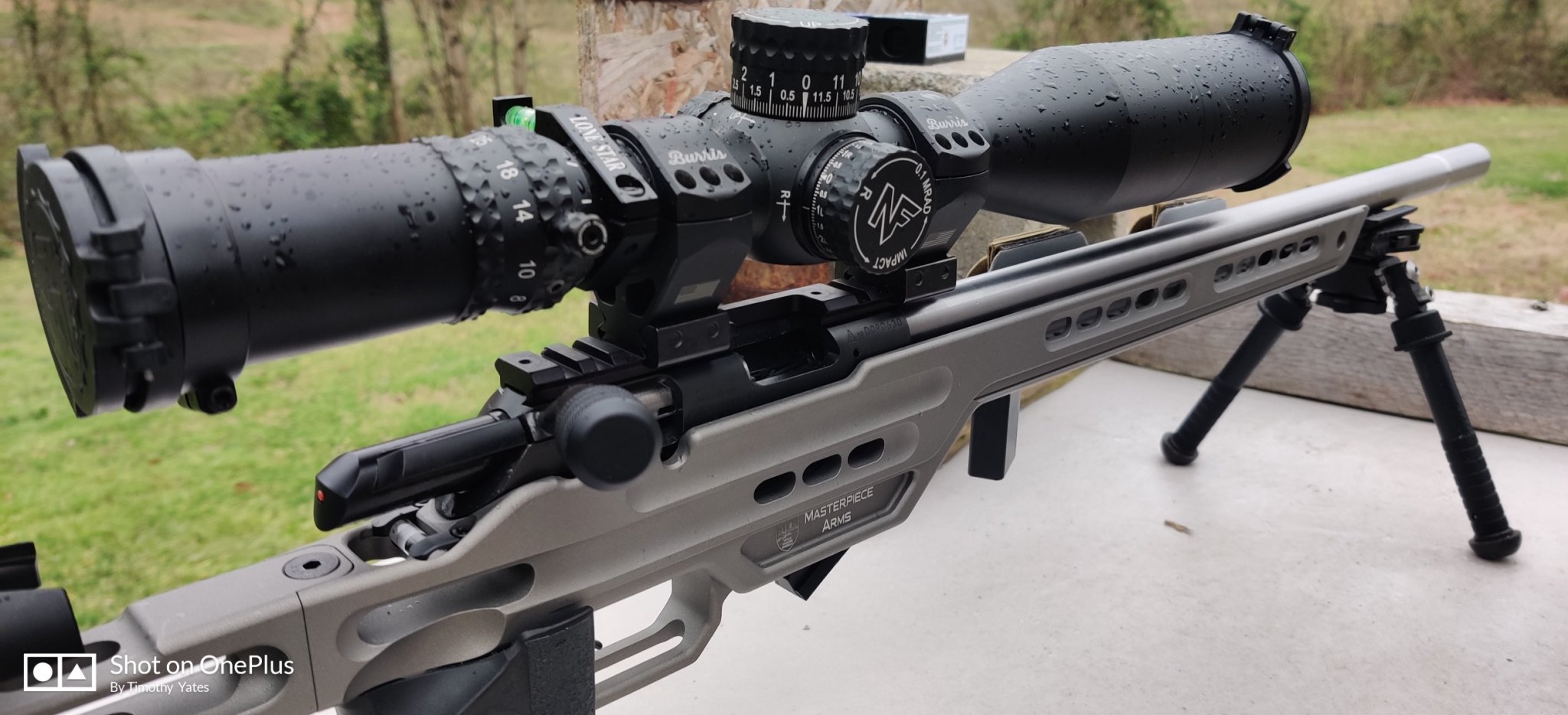

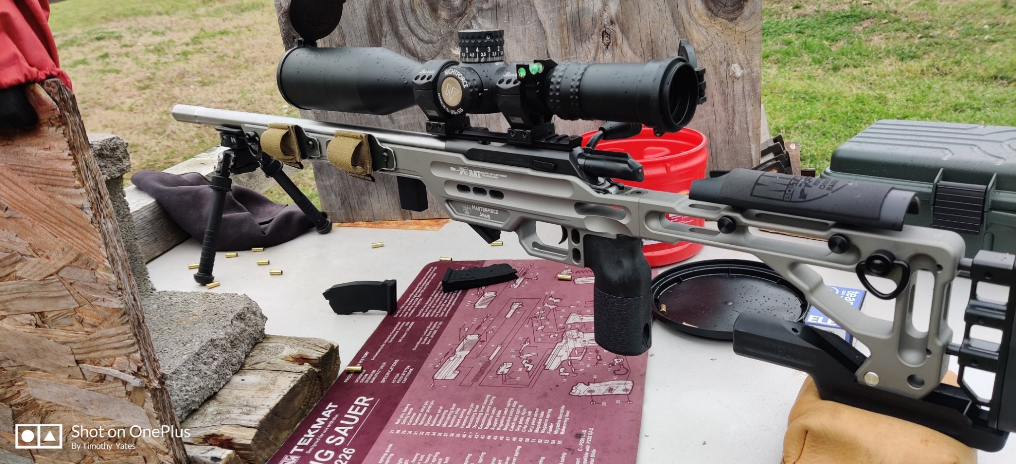

Has anyone tried the MPA mount? MPA CZ457
No MPA mount but better than that, the MPA chassis.
For whatever reason it's hard to beat SK Rifle Match.

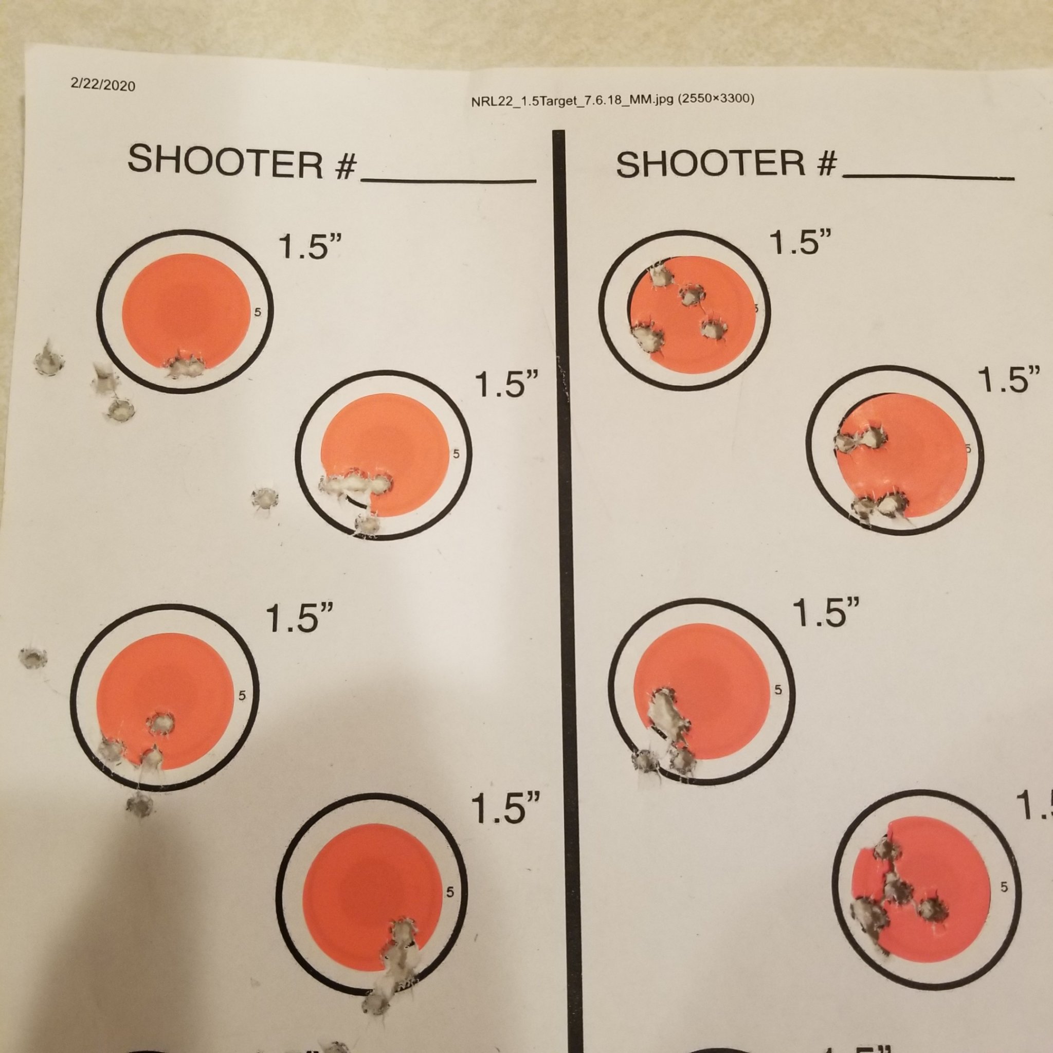

I thought I would introduce my helpers in holding my targets while I photo them. And yes, that is my very own Trumpy Bear!! :cool:

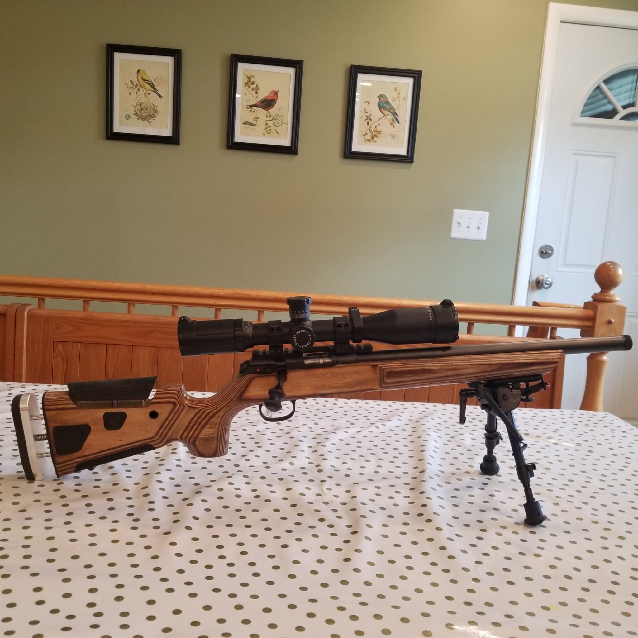

sphillips - That's a very nice looking 457 Varmint model. I've seen photos of a couple of these rifles over on RFC that had nice stocks with some decent figure; the buttstock on mine was so plain that I thought at first it was just stained pine... Yours is head-and-shoulders nicer than mine - enjoy!
Thank you!
Mine looked plain also when I purchased it, but after a little polishing of the wood with some Mother’s polish the stock turned out a lot better. If I remember correctly I did three or four coats of polish and then a good buffing with a microfiber cloth.

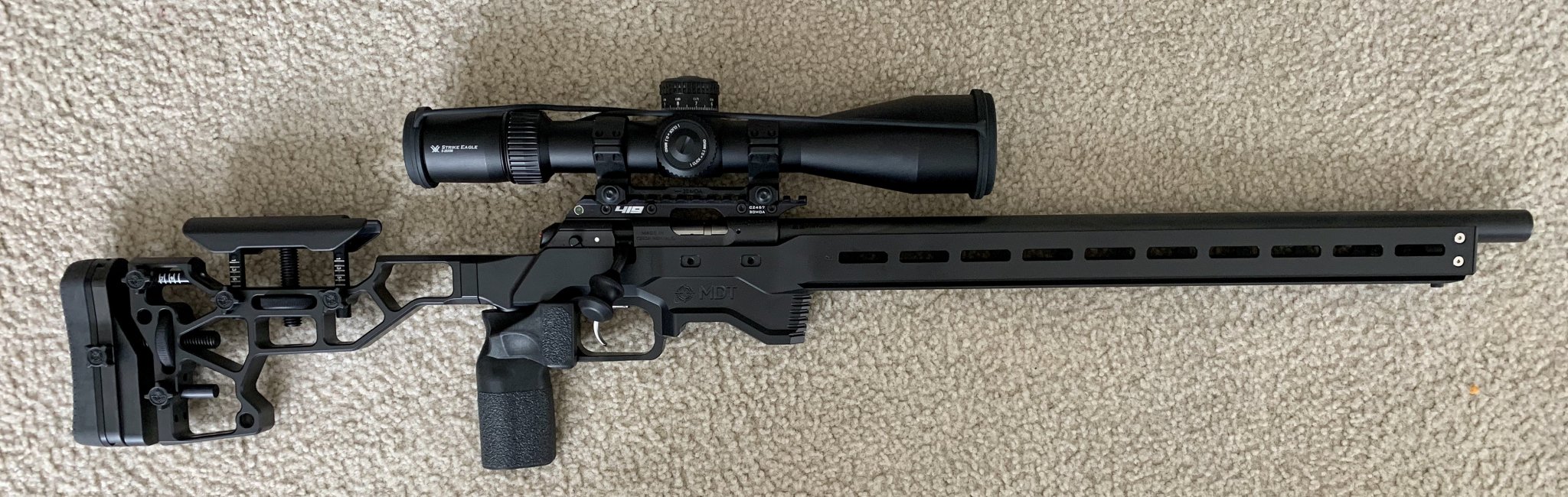

I just got my first CZ457 MTR. Lookig forward to taking it out this weekend. I have it set in an MDT ACC. do any of you all have a similar set up? My question is did you use the washers for the action screws and what torque setting did you use. TIA
