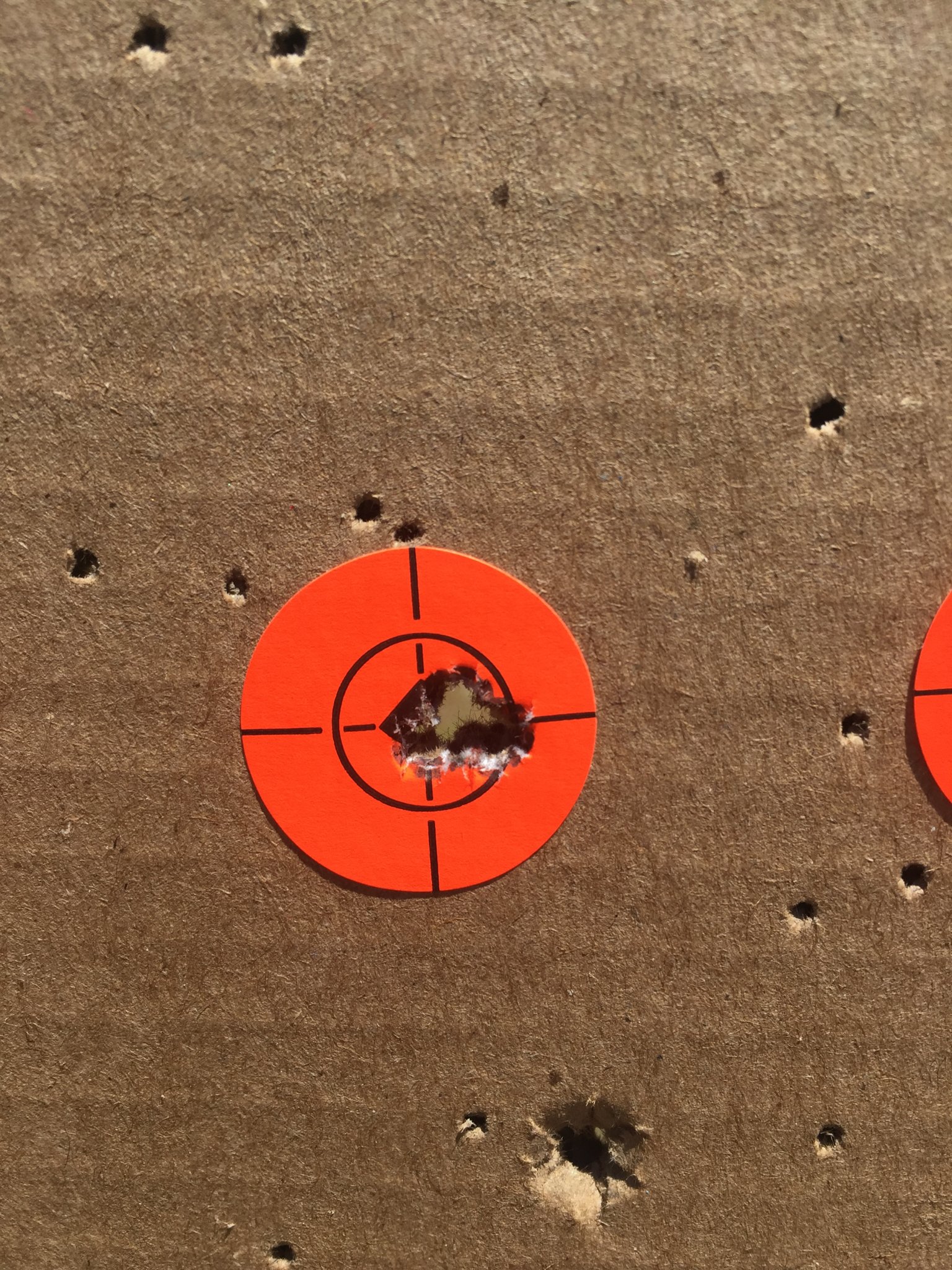

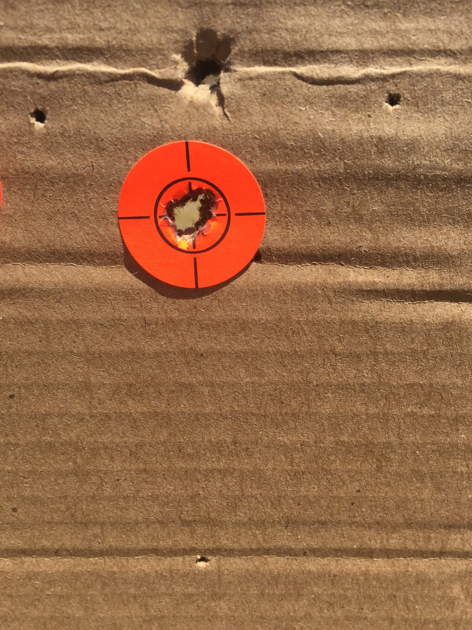

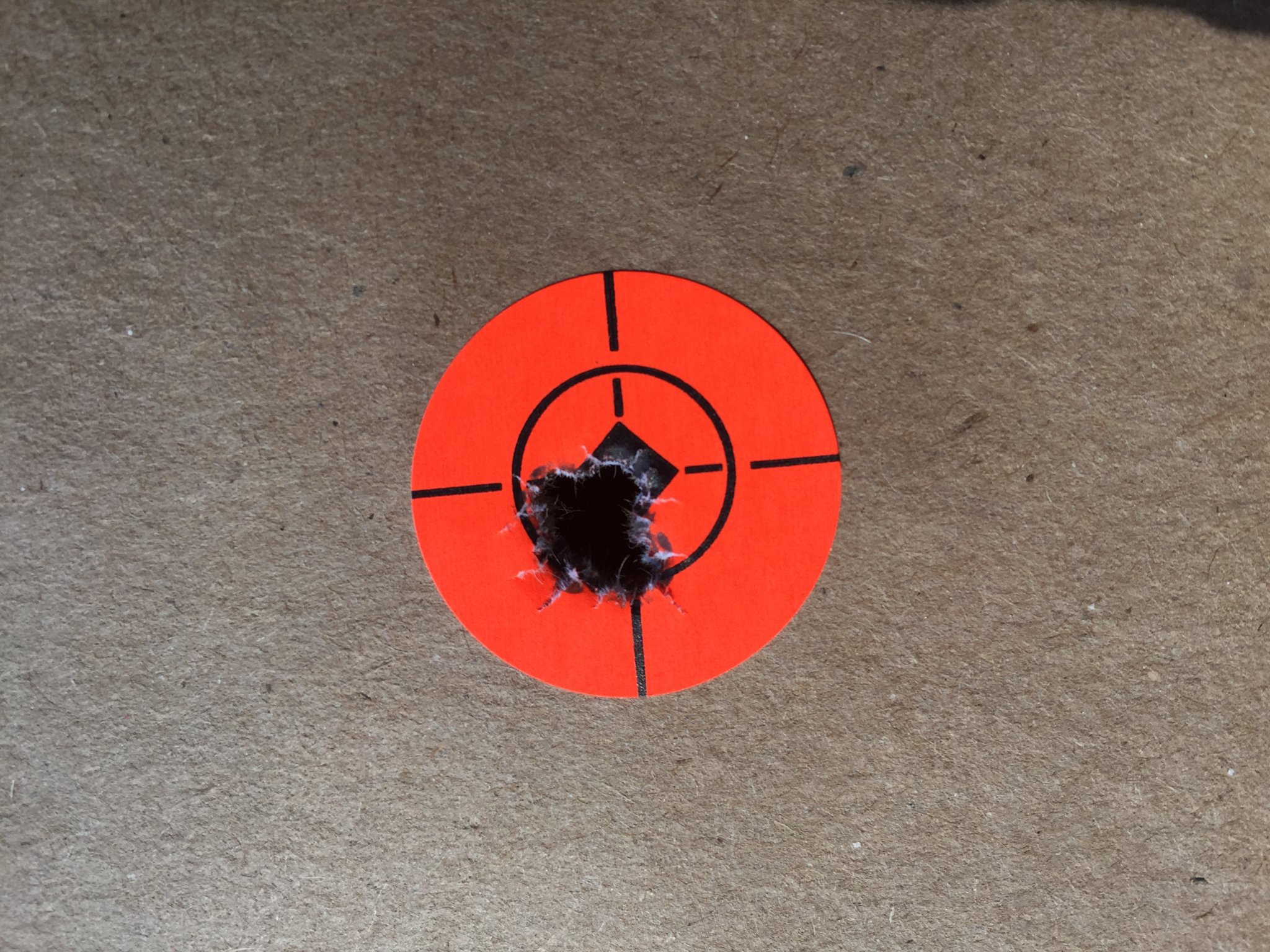

Love my 457 Pro varmint so far. Put it in a MPA chassis just for feel but it shot great before that too.
Reactions: Mr. Wolf
SubMech - nice shooting! Can you share the ammo, distance and # of shots in the groups?
cheers!
Those were all 10 shot groups at 50 yards with SK standard plus. Not just the best groups but repeatable. I tried a few different lots, and different ammo before I got those results. SK Rifle match and Lapua center X were better at 100 yards but not at 50, I could not get a solid group with Lapua X-act at 50 yards but it was great at 400, so I just stick with standard plus since it was more consistent.

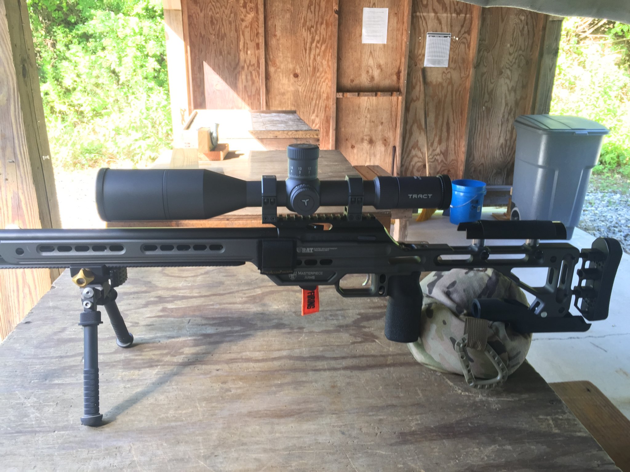

My set-up is the MPA CZ 457 30 MOA Scope Rail. I know that most everyone with 457's are running Area 419 rails, however I find the MPA version to be a bit shorter and cleaner looking (doesn't have the giant "419" on the side). While the Area 419 version does have the built in level - I can't imagine that being very visible once you are behind the scope without moving your head. I am using an Accuracy 1st Level - much better IMO. Reference rings, I am using the Seekins 34mm 1" High. Initially I thought they might be too high, but as you can see from the photo, it leaves JUST the right amount of room for the scope cap.
The last note I will mention - for a 34mm tube - it is not that heavy. But it is heavier than what most are running on their 457s. For me, it is worth it - but I was definitely surprised at the difference in weight once I removed it...haha.
