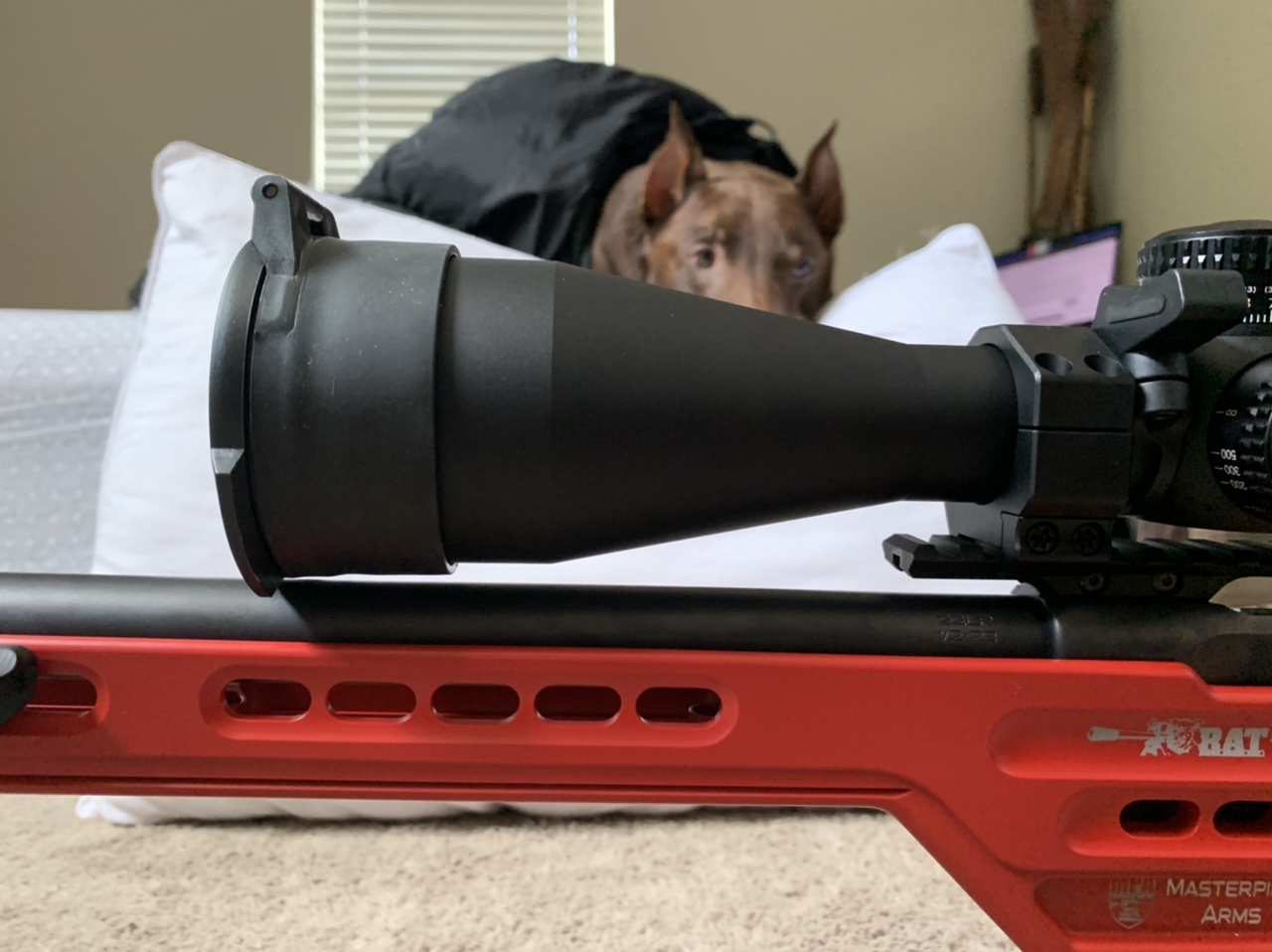

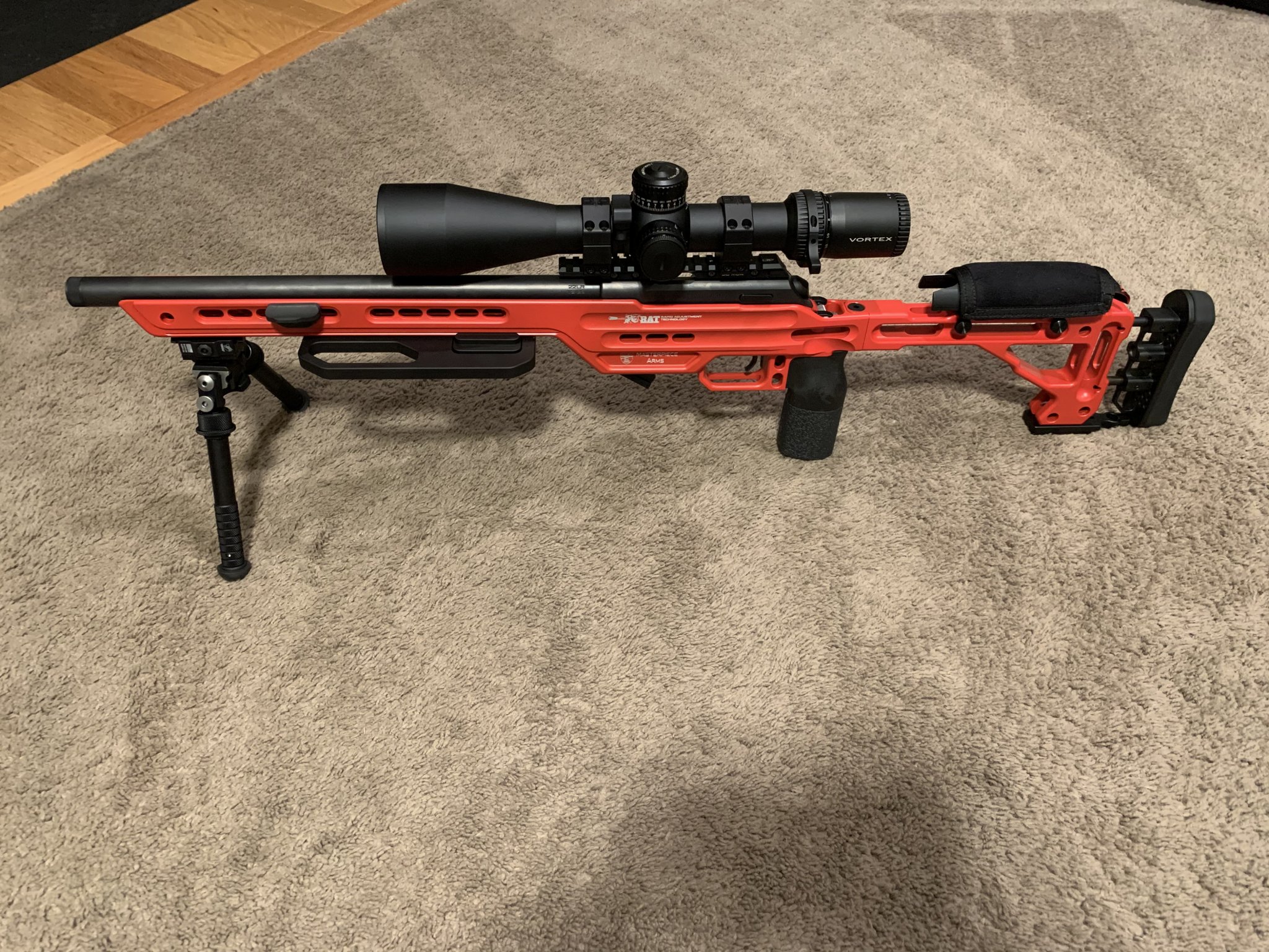

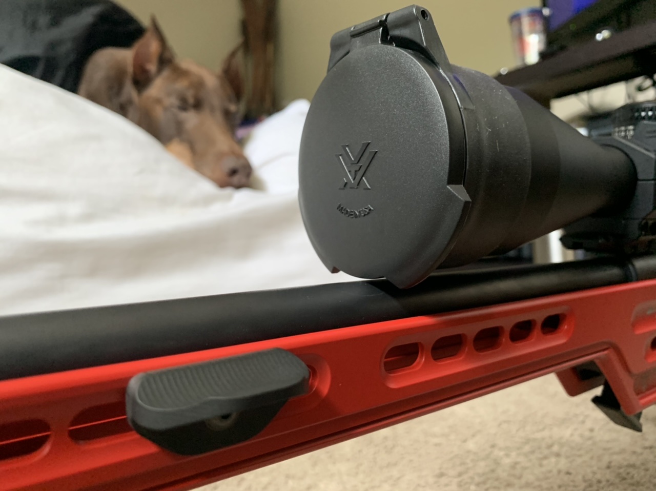

I have the Vortex Strike Eagle 5-25x56 FFP on my 457 and I love it. Tracks well, has a ton of features not typical found in scopes at that price range. parallax is at 15yds and the range of adjustment is huge. However, if using the zero stop mechanism- that significantly eats up that range, but with a 30MOA rail I haven’t run into any issues thus far. 34mm tube lets a ton of light in making it a pleasure to shoot precision.
Hey there,
Actually, after some digging around, this is the scope I am highly considering. What mount are you using?
Reactions: NES_tacticool
I love it - if you are military Vortex offers 40% off via Expert Voice too - so that makes it one hell of a deal. Something to be aware of however, if you are a fan of scope caps - Tenebraex (my go-to brand) doesn't have an objective cover that fits this particular model. I contacted them to see if other Vortex 56mm objective covers would fit, however they indicated that Vortex has a different thread pattern on this particular scope - so I am running Vortex branded objective cover in the front (eh okay) and a Tenebraex UAC019-FCR for the eyepiece. I am a little OCD about this stuff - so it is annoying - but not bad.
My set-up is the MPA CZ 457 30 MOA Scope Rail. I know that most everyone with 457's are running Area 419 rails, however I find the MPA version to be a bit shorter and cleaner looking (doesn't have the giant "419" on the side). While the Area 419 version does have the built in level - I can't imagine that being very visible once you are behind the scope without moving your head. I am using an Accuracy 1st Level - much better IMO. Reference rings, I am using the Seekins 34mm 1" High. Initially I thought they might be too high, but as you can see from the photo, it leaves JUST the right amount of room for the scope cap.
The last note I will mention - for a 34mm tube - it is not that heavy. But it is heavier than what most are running on their 457s. For me, it is worth it - but I was definitely surprised at the difference in weight once I removed it...haha.

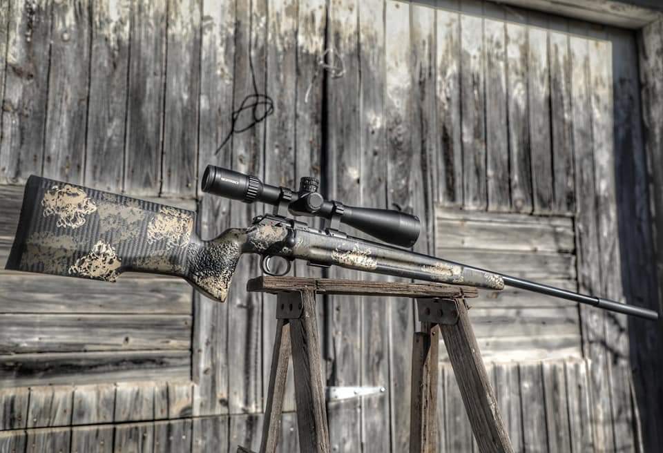

Took my CZ 457 ProVarmint out to day with @Mike Casselton and had a blast. Winds from nothing to 20+ gusting all over with storms rolling through. Really not expecting a whole lot just wanted to pop the cherry so ran a bunch of cheap Federal copper 36g HP through it(did put 50 CCI SV through it and dang those were noticeably better even in the high winds). So we broke out the golf ball rack(ball with screw hanging from string) and while a relatively large target at 1.68" it's so much fun we always end up hunched over the rifle laughing. Will look forward to sitting on a bench with no wind to see what I can do on the paper, but thrilled with the trial run. $12 to shoot 200 rounds laughing our asses off....this 22 stuff is cheap fun!
Shot my new PV this week also. Very happy with how it shoots but need to find a load it likes for 100 plus. Like everyone else has said they really like SK but seem to shoot anything good enough for fun shooting.

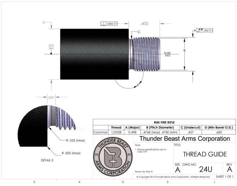

Anyone here suppress their 457? Would love to hear your thoughts on effectiveness of a can with supers/subs also any can specs please. Thanks
I threaded the Shilen bbls on my 457 American & VPT for a SWR Spectre II that I've had for several years. Though it has just a tad bit of a '1st round pop' that my TBAC 22TD doesn't have, it's just about as quiet, and every bit as accurate (if not a bit more so) than the 22TD. Even with std vel match ammo and 22" bbls on my rifles, the suppressor still makes enough difference in the report that I prefer shooting with rather than without a suppressor on all my 22RF repeaters.
I'm thinking about a CZ 457 PV as a host for a TB 22 TD. Anyone have experience with it?
Not too concerned about the sound reduction as it should be more than adequate, but want to learn about effect on accuracy, POI shift, and fitment (ie: is the thread length 0.400" per TB thread guide spec).
Thank you for any/all information you could provide.
