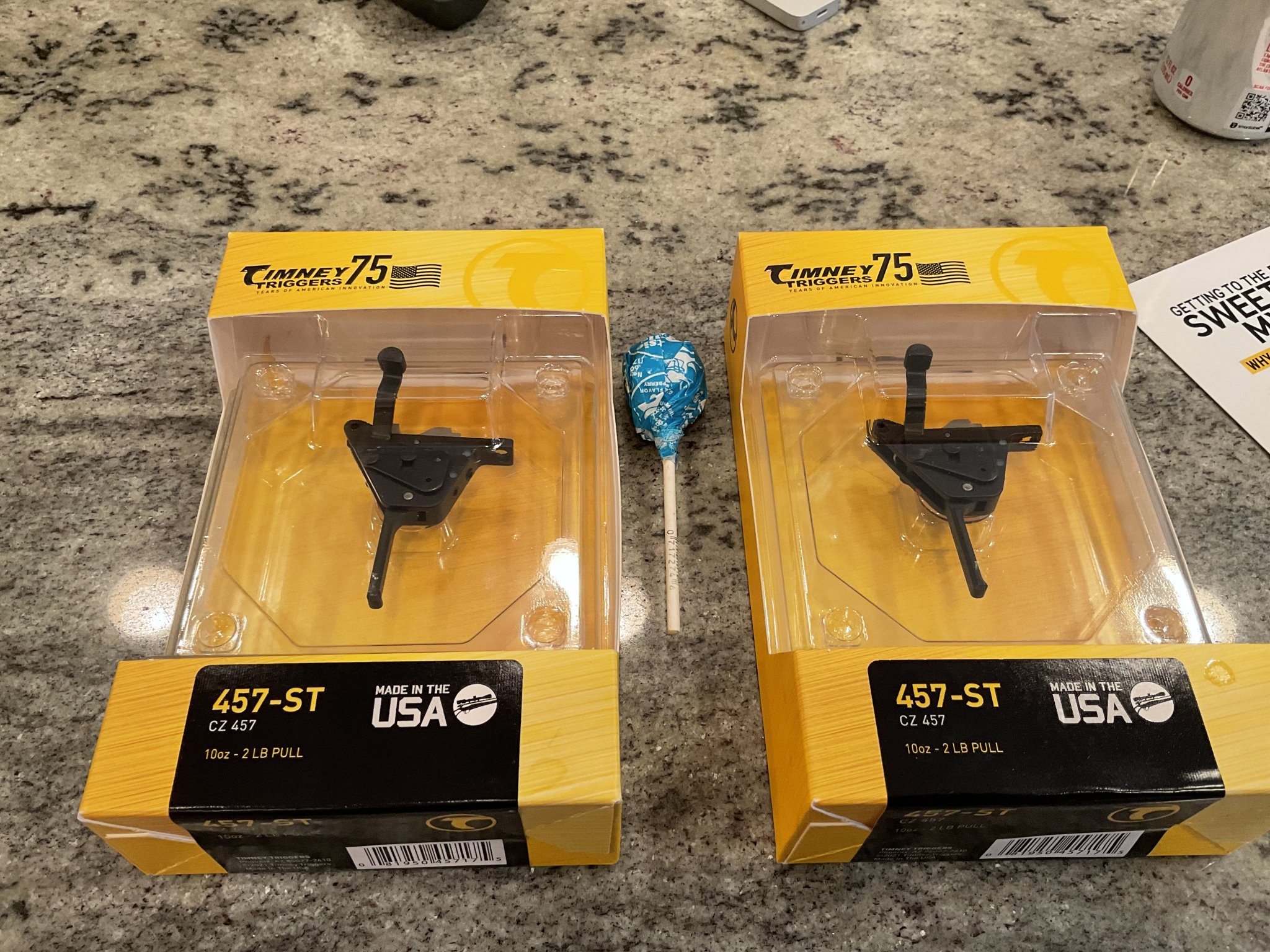

Timney came out with a flat trigger bow version of their CZ457 trigger today. I ordered by inferior bent one on Monday... ;) Says it hasn't shipped, trying to get them to change it... I was never able to dial down the weight on the trigger in my CZ below 3lbs. It isn't a bad trigger, especially compared to the standard CZ455 trigger in my other rifle.

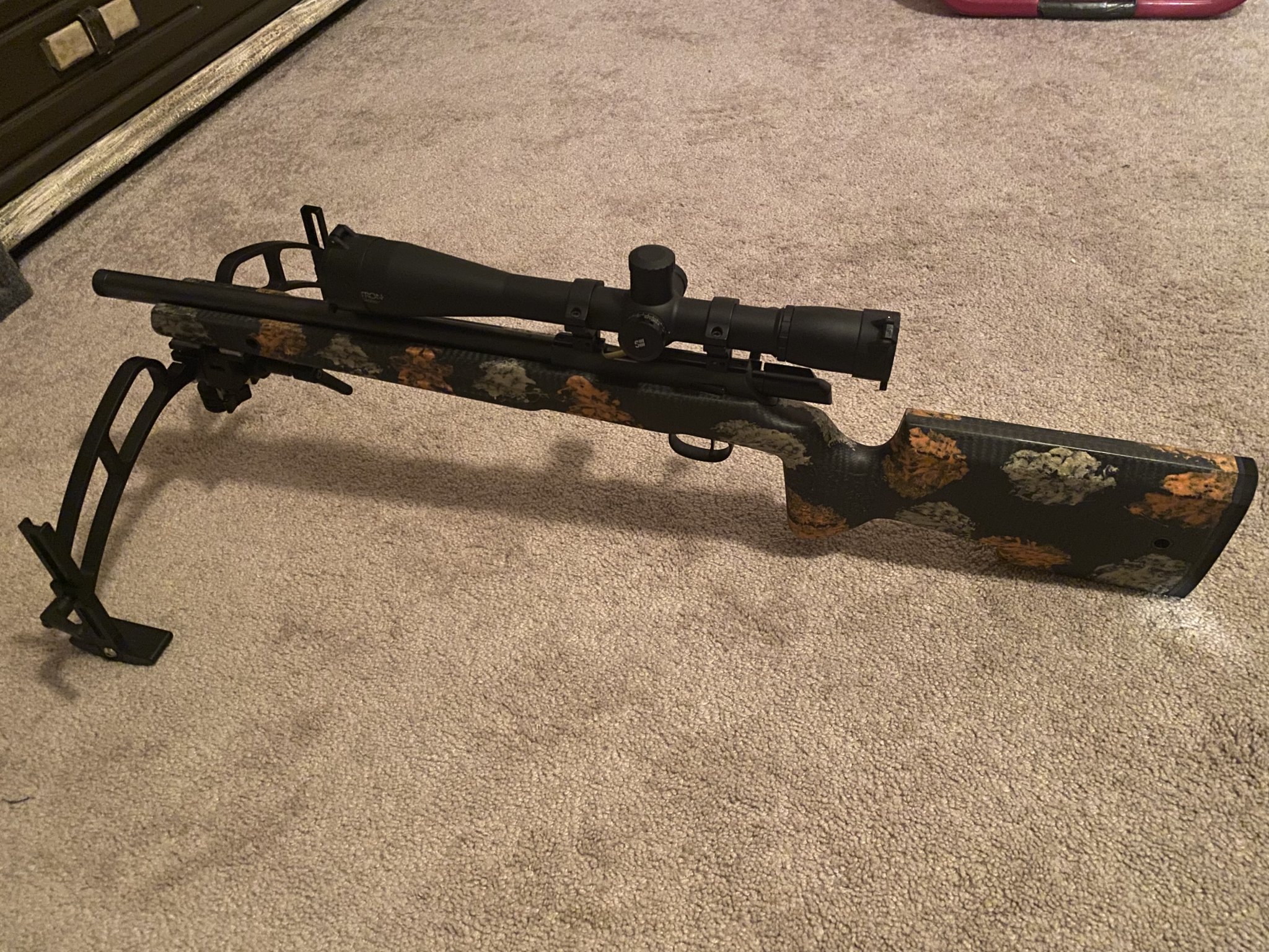

Here are a couple of pictures of mine if it helps. The second image is with a new Lilja barrel installed.

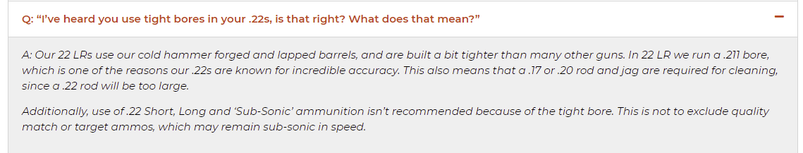

Hi, no shims. The .22 mag is cut to exact SAAMI specs. And it's a shooter :eek: 😊! Did you read their pages on the site about shimming? I might be wrong but I think I read that there are such variances with .22 LR ammo. I think you might be on the right track going to .008. Is there a shim combo that will make it .007? If so I would try that first. Lilja recommends torque on the barrel around 35-40 inch-pounds. CZ on the other hand recommends 48-inch pounds (video below). I went with CZ's recommended torque, which if you did not the additional tightening might make the chamber go even tighter, in which case .008 might be just right.
In any case, I would email Carson Lilja at [email protected] and ask for his advice. He knows .22 inside out - a lot more than I do....

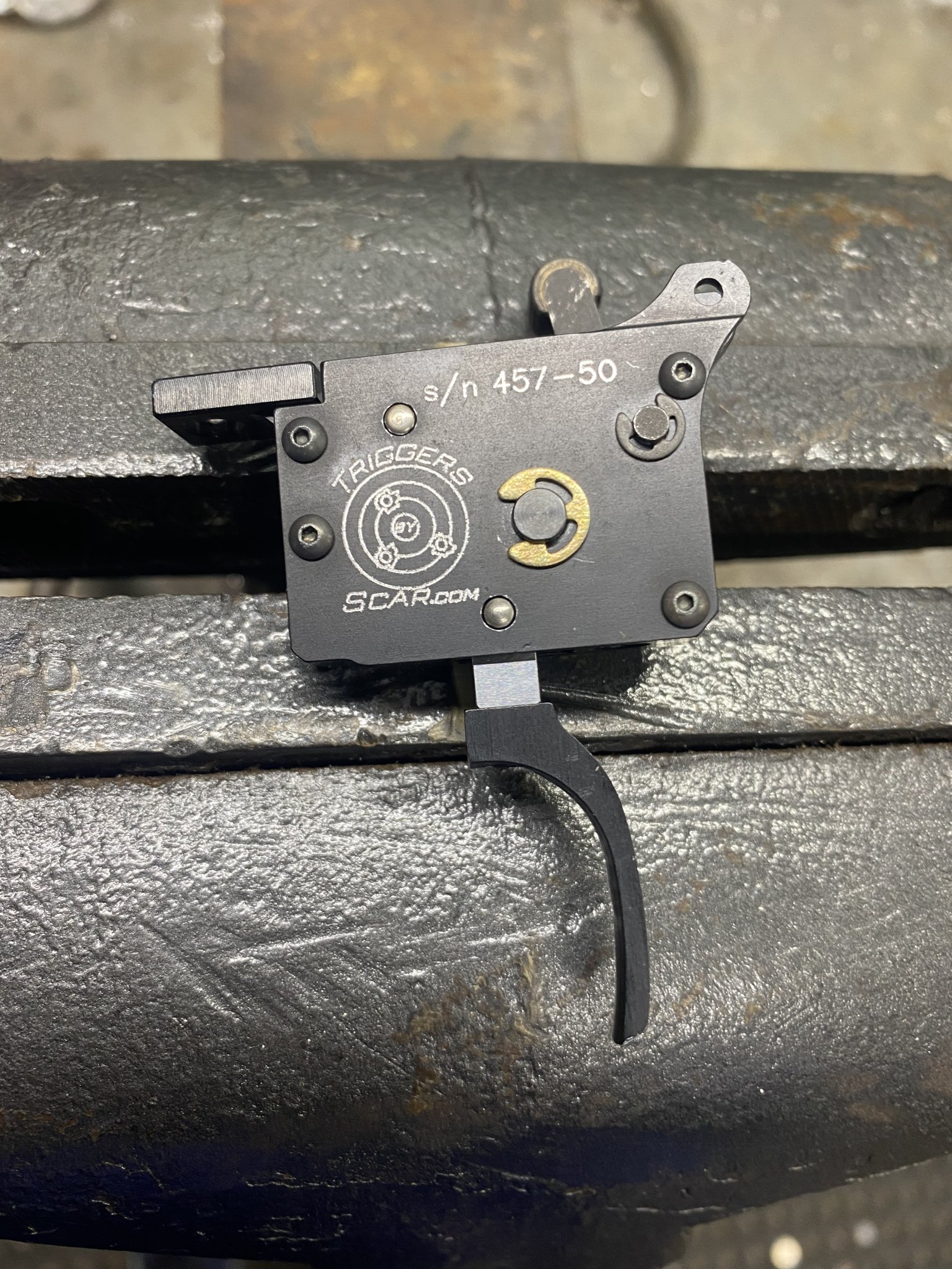

I was able to get two 457 triggers down to 8 and 11 ounces using the McMasterCarr 965K611 spring. I recently got a BSCAR trigger in a 3oz. single stage. I’ll buy another when my name rolls back around on the list one day. It’s an awesome trigger. I gave $200 for mine shipped.

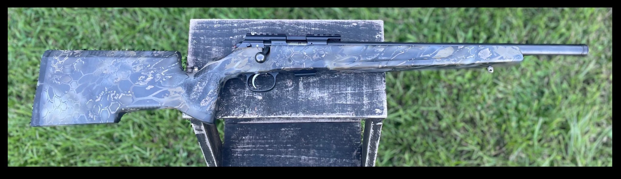

Got an Anarchy Outdoor Titanium bolt knob to Cerakote and install. Oh yeah, and little guy was super quiet with the Tac Sol Axiom suppressor. Can’t wait to stretch it out with the SK Biathlon. Looking like fun. Wasn’t even looking for a bolt 22. Mainly been shooting a modded 10/22 with Volquartsen barrel, Tac Sol X-Ring SBX and Kidd Supergrade. This shoots considerably better. I was expecting good things from reading about the CZ’s but didn't expect this level of accuracy or consistency. The Lapua X-act and SK Pistol shot well too, but not like the Biathlon. Good thing I have a brick.
