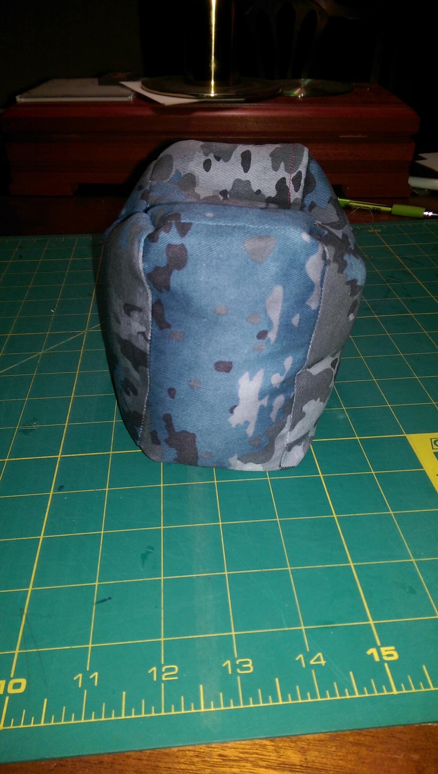

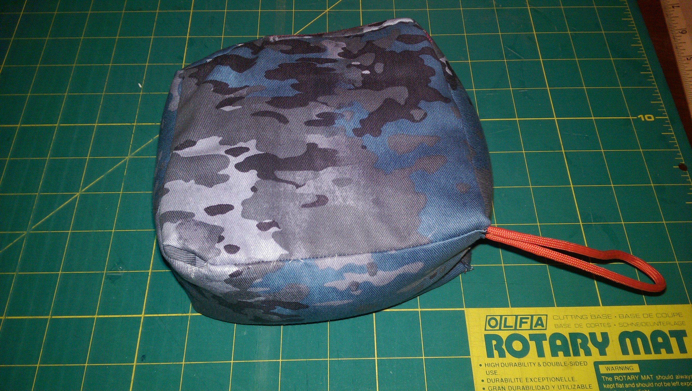

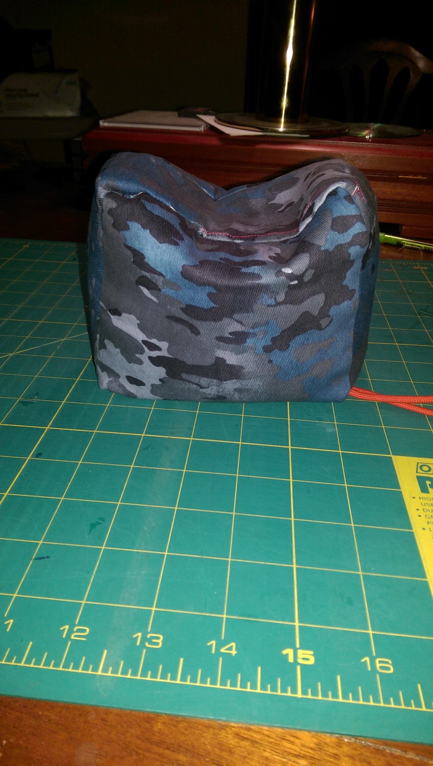

Had a DIY bug itching me tonight and had seen this thread lately and became determined to make me a rear bag. Not perfect by my any means, but heck, for my first time on a sowing machine I think it turned out pretty nice. Found the fabric and poly beads at a local fabric store and made a 4x6x7 cube. Even had enough left over for another one if I want!

I left about 3" of a seam open which was enough to turn the bag inside out so the stitched seam was inside and then whip stitched the opening once I was done filling the bags. Will post pics of that for you though.
And I'd be happy to post templates once I find them. The wife rearranged her sewing bench (which I had confiscated for my projects the other day without asking her permission) and my templates are currently M.I.A. lol
I think that the texture change was the outside edge of the fabric, I think their machine was off kilter or something that day because the other bolts of canvas I have had have never had that on the edges of them.

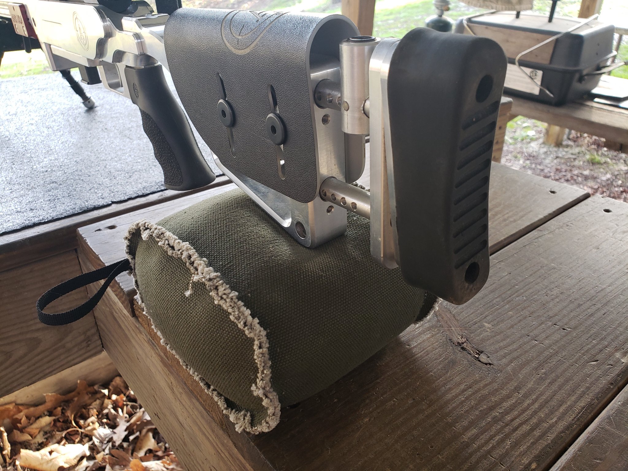

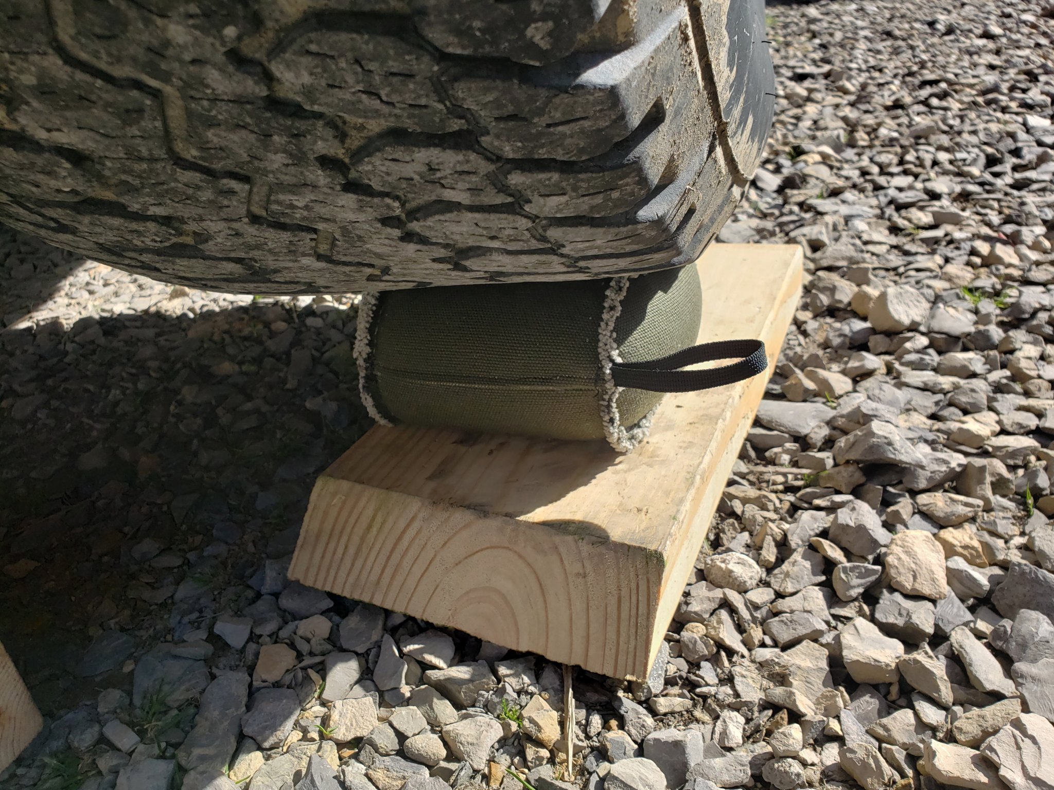

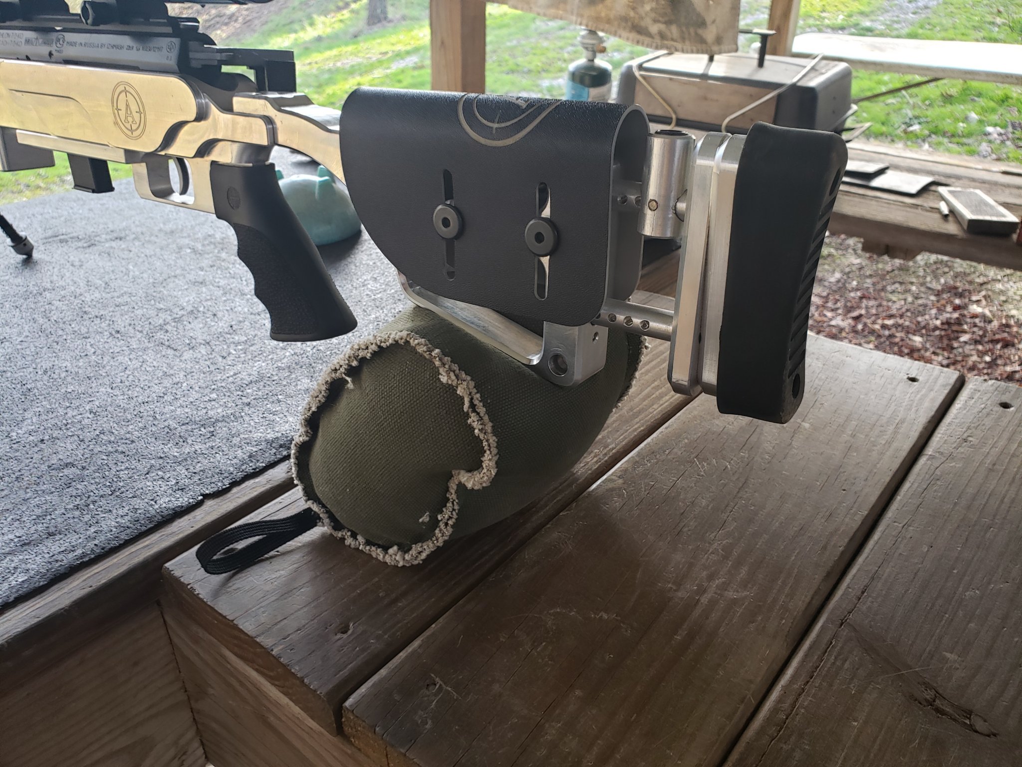

Here is one I've been making for fellow competitors. Got a roll of WW II military canvas. Using heavy thread used on sails for ocean sailboats. Tough as hell and canvas texture is perfect.
Just roll to change adjustment, won't tear like most bags. Canvas has frayed edges but won't fray past the thread. Too difficult to work with to try and turn inside out. I call it a manly frayed look.
