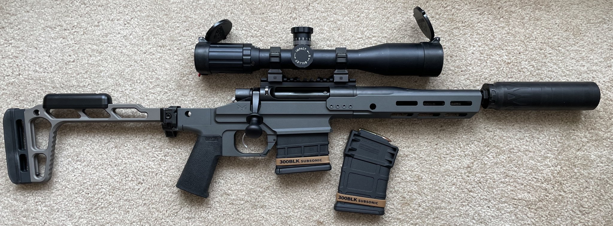

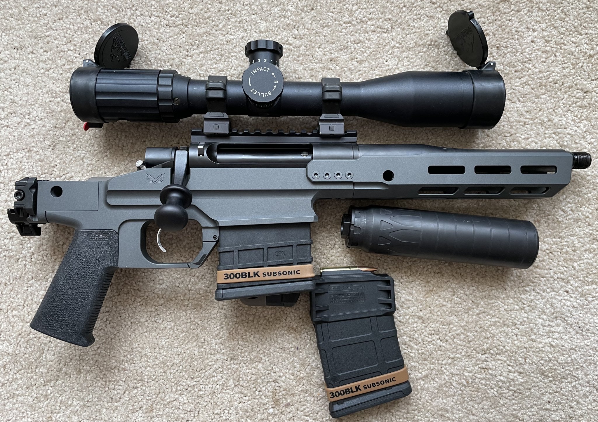

I did...for reasons
ARC Nucleus action, Preferred Barrels 9" 300blk 1/7" cut with a Sig taper, Dead Air Nomad-30, JTAC Screech Owl chassis, PMM "Kate Moss" stock, and an old Tasco Super Sniper 10x on top because that's the only optic I had laying around that wasn't spoken for :giggle:
I wound up putting a Dead Air Xeno brake on it rather than just use the Sig taper; I've got more things with Xeno than are cut with Sig tapers so it makes moving things around easier. It's pretty much giggle-quiet with subs.

Any issues feedings from the PMAG AICS 223 mags ?
I run these in my Ruger American Ranch that I put a standard Ruger Short-action Magpul Hunter stock (AICS) on, instead of the STANAG stock, and they feed perfectly. They also have a much longer internal length, so you can load up into/near the lands, instead of being limited by the AR magazine's internal length.
Reactions: st1650
Interesting. Magpul says they don't work great on the R700 action feeding 300blk. Maybe the Ruger action/bolt face is better than the 2lug R700.
I've also heard the Howa mini actions feed these good.

Not for me, no - I've tried a couple mags, I like the MDT ones the best with the Magpuls coming in second...the Ruger ones don't fit my chassis/action combo. They sit too low; it's probably adjustable, or I could just not buy those mags, so that's what I'm gonna do.
