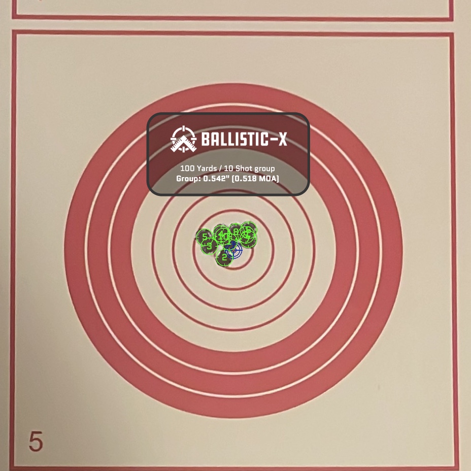

Here’s a 10 shot group I shot Sunday @100yds

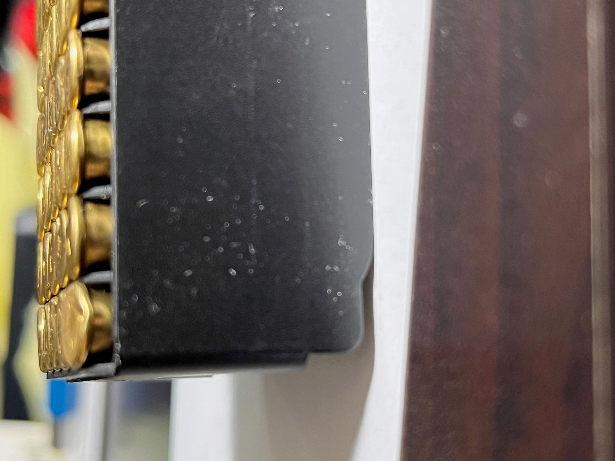

I can't say they all do but I had mag fit and feeding issues with my 360 in a KRG Xray. I eventually figured them out and "fixed" the issue with well placed Velcro "shims" on the mags and in the stock. I eventually sold the stock though as there is too much $$ invested in a Vudoo build to be band aiding fix's.

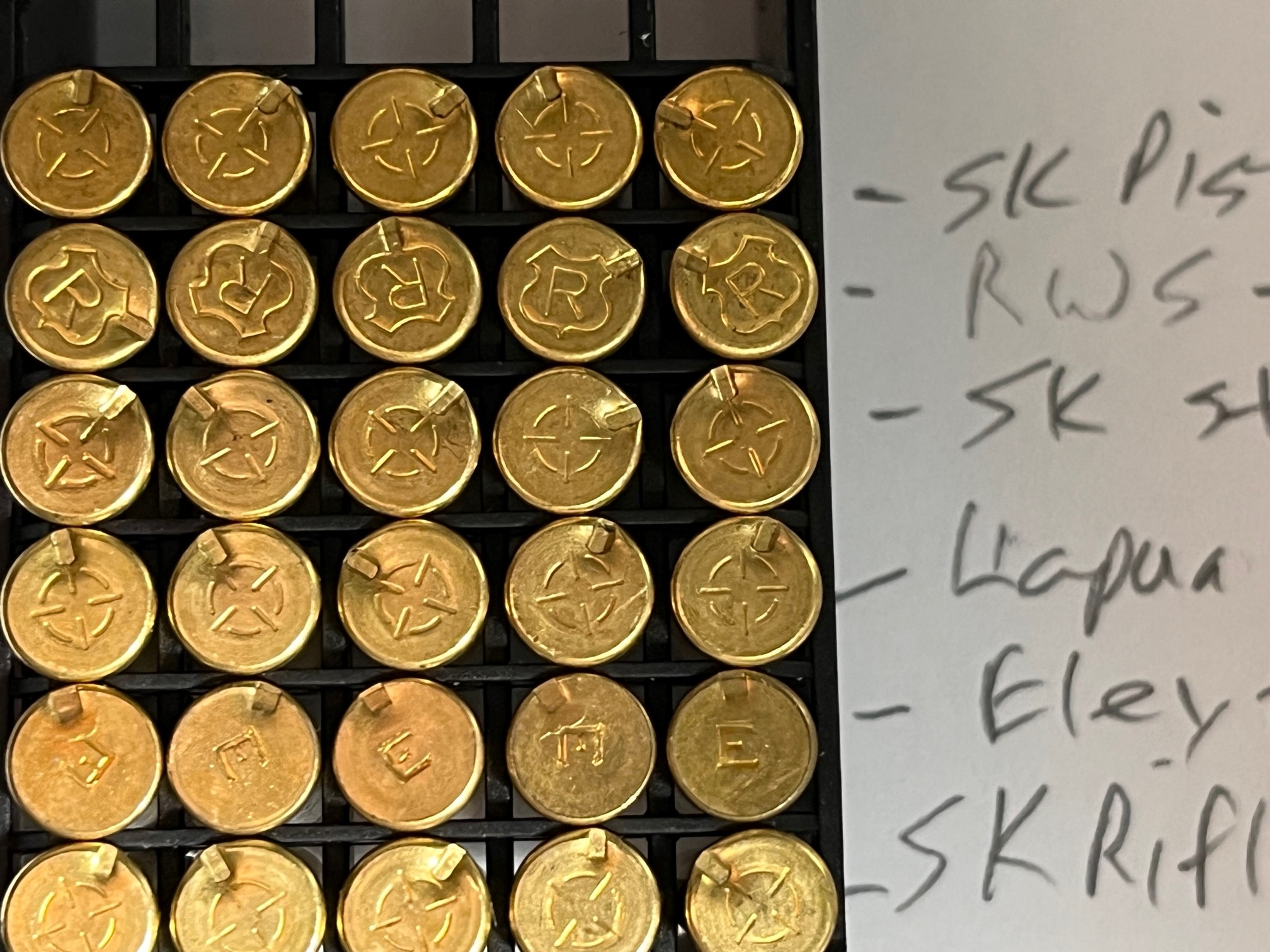

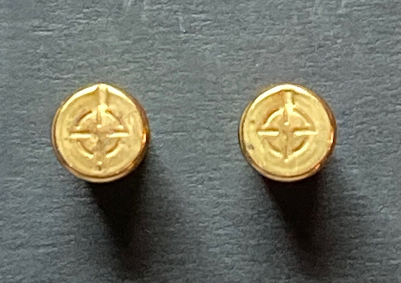

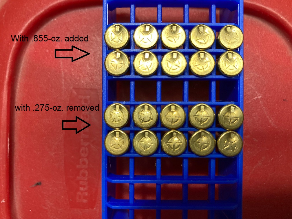

I have been studying the primer strikes on my Vudoo and noticed how strong they were. Several types of SK ammunition end up with the rim bent they hit so hard. Had me debating if that affects accuracy by affecting seal, headspace or rebound after impact? what's the school of thought on this?
Below are pics on my primer stikes in the Vudoo. Notice the bent rim on the SK Rifle Match in the second pic.
The Eley imprints have me baffled. I am second guessing I mixed up my casings between the Vudoo and another 22? As expected, note the light Eley imprints, but also makes me think Eley have a harder case head in their brass?

I'm not an expert but in my eye as an Engineer, the Eley casings there have clearly been run through a different firearm as the firing pin impression is differently shaped in all aspects. As for the impacts being too deep, I'd note that a firm and consistent strike on the primer is VERY important to uniform ignition (and resulting accuracy) . I'm also thinking that the case rims shown do not appear any more deformed than in any of my match/precision 22's . ( I've seen some really case rims get mashed in certain guns.) That said, you could try to reduce the force on the case rims by modifying the pin or spring but my bet is you'd be dancing a fine line between making things better (or just as likely) worse. I'd just leave it alone.
Over driving the firing pin can and will cause issues.
Yes you are over driving the pin by alot from the looks of it. Ignition needs to just close up the rim not distort it or bend it like shown. Over driving it will cause issues for sure. Sam
Yeah, I found out I mixed up my cases and the Eley strikes are from another gun. I would be reluctant to make any mods to the firing pin being it shoots good.

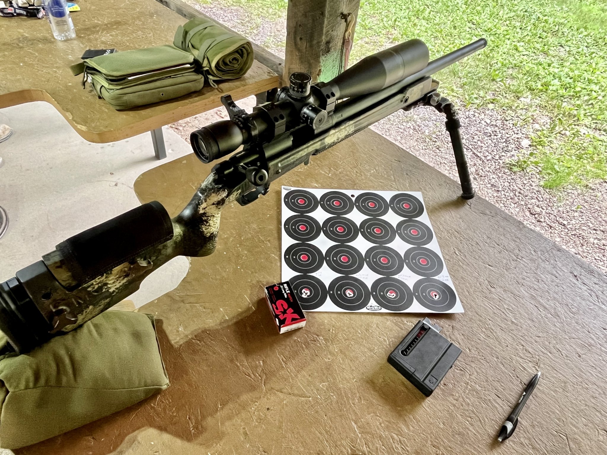

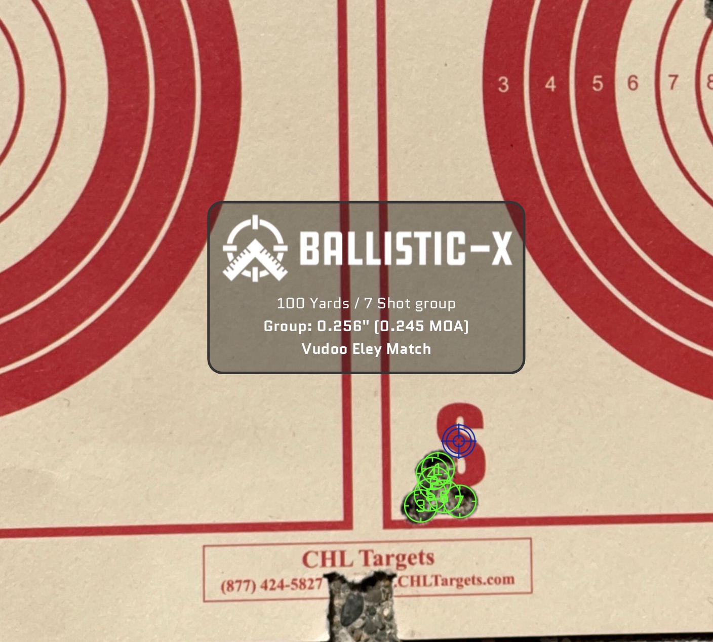

After a long hiatus I am back into shooting.
Picked up one of these vudoo a while ago.
Seems to like this Lapua LR a lot more than tenex
I’m so rusty I bet the shot to the right and the low shot are on me
This is with a sparrow 22 can

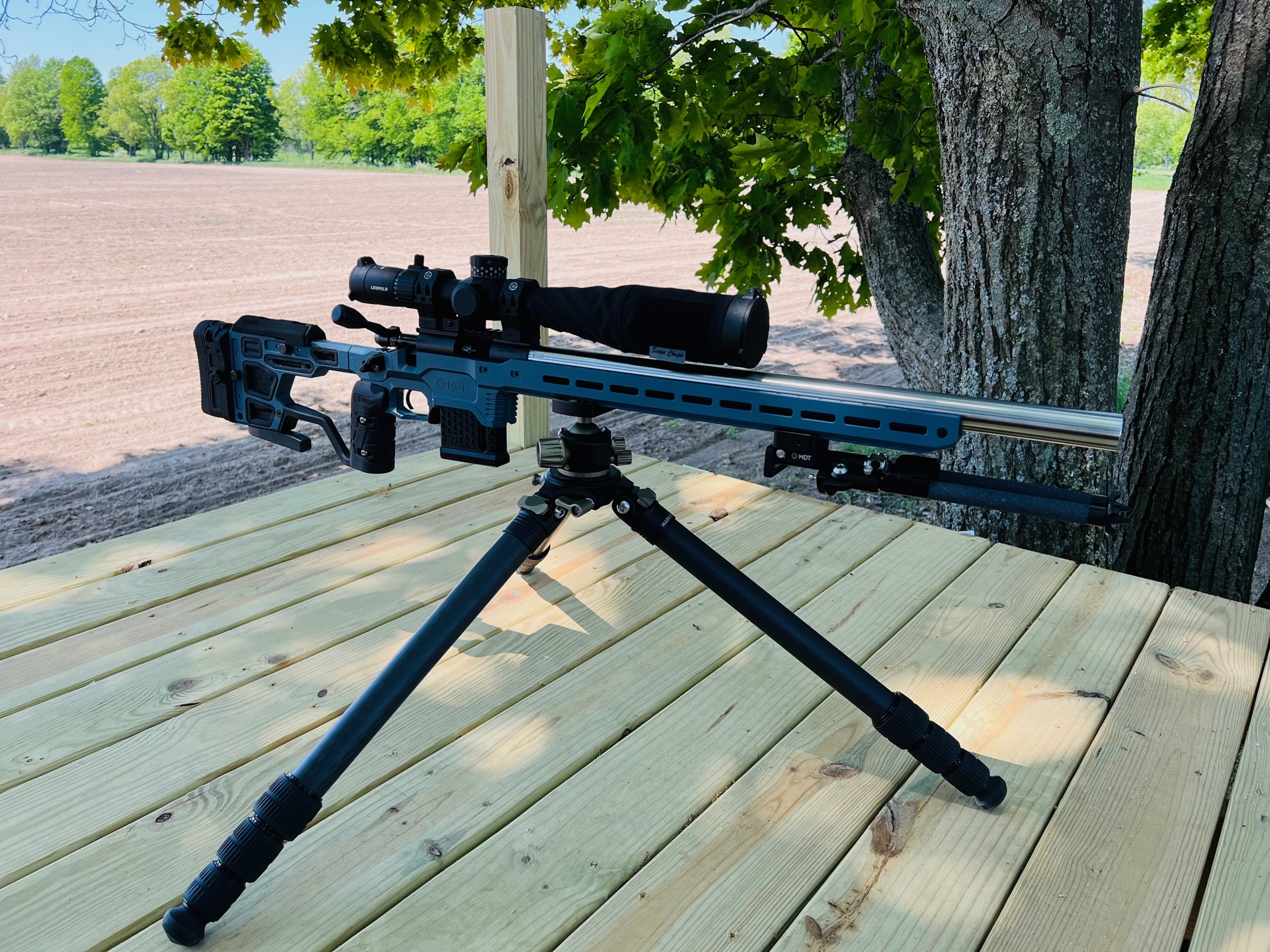

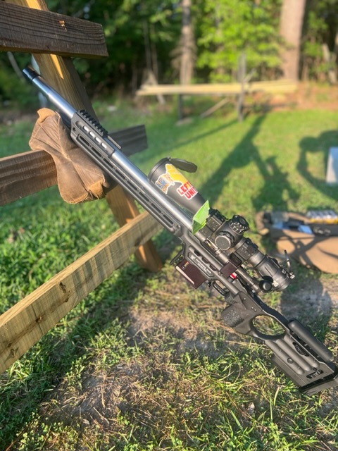

Zero feeding issues in a ATX unless mag is touched. Does anyone know of a mag guard for a ATX
Does the ATX have an ARCA rail that goes all the way back to the mag well? If it does, a Gray Ops CNC might help. I realize this an MPA chassis...picture from Gray Ops website...been thinking of getting one for mine.

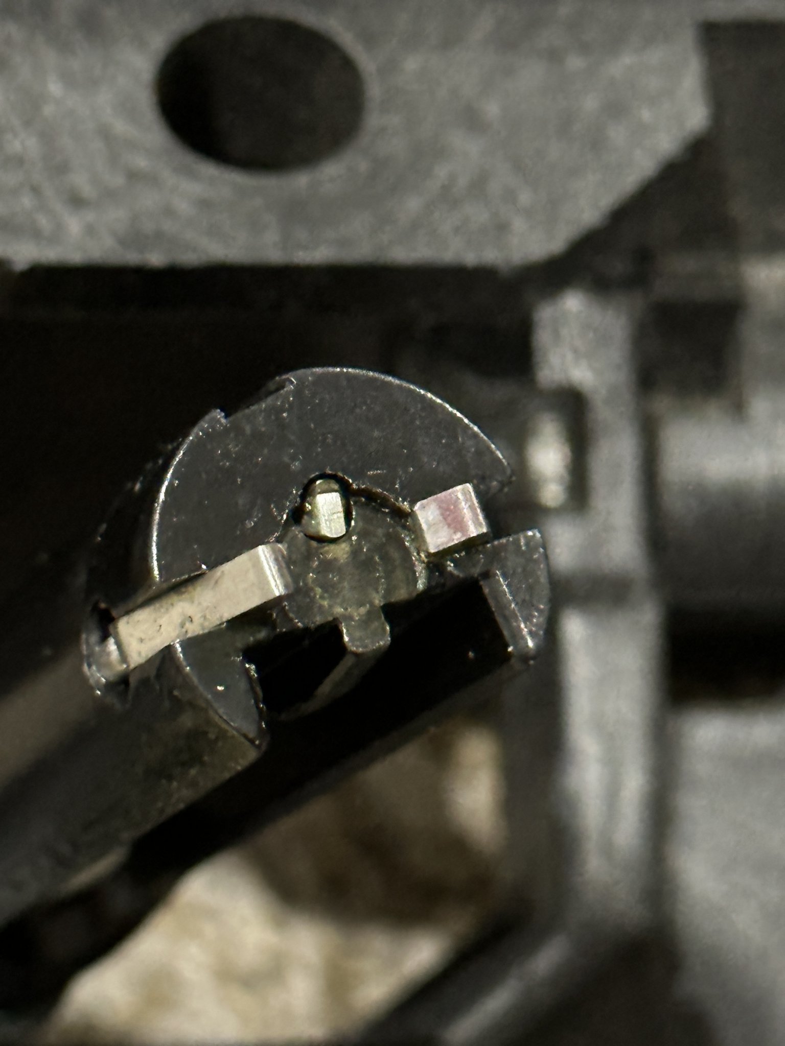

Not Sam, but what you will see is called flippers shots that just jump up for no reason. under driving the pin, you will see the opposite dropped shots. both will just happen randomly. but be a cause of wonder if it is the ammo.

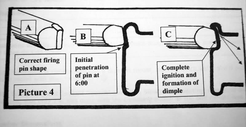

What most do is take a little off the corner of the pin so the strike in just inside the rim edge. just make sure if you do this that you have the pin oriented in the right position. the picture of the case hits is for a 12 'o-clock pin.
Lee

I don't have an example of an over driven pin hit but here is an example of a under driven due to a weak spring. I can't remember if it was the 3rd or 5th shot that just dropped the other 4 as you can see went same hole.
this lot of CX was a good one so I know it was not the ammo. changing the spring made this go away.

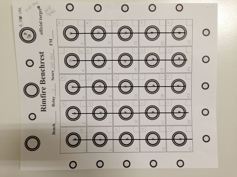

Now you have to know the ammo you are shooting to determine what is happening. does this lot of SK shoot flat? meaning shooting across a horizontal line you have very little up and down shots? here is an example of what I mean all 25 shots are nearly the same height I know this lot shoots flat, so if I start to see shots drop out or jump up, I will know something is not right. this target I shot right after changing the firing pin spring because I noticed the rifle was shooting low and this rifle does not do that.
Lee
Lee
I get a fair bit more vertical then you target shows.
Thanks for the info
