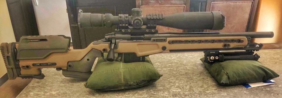

I'm just patiently waiting for my rifle ordered in late May, the Athlon Ares ETR, and a Larue QD bipod setup.

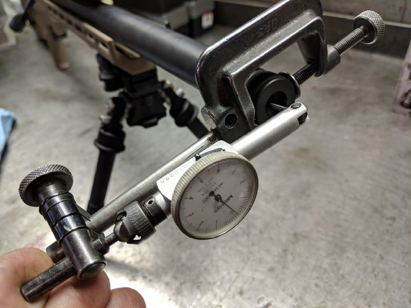

I checked concentricity between the threads and the bore ... no more than 0.0005 TIR. I clamped an indicator holder to the thread protector and rotated the thread protector to measure runout.
