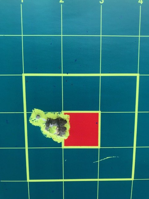

Here's a few pics of what I was talking about. These are 100 Yard groups. The outer circle diameter is 1". The inside dot is .22".
For a 100yds those groups are not bad at all. The environmental variables and your techniques could easily make them 20-30% smaller. (y)
