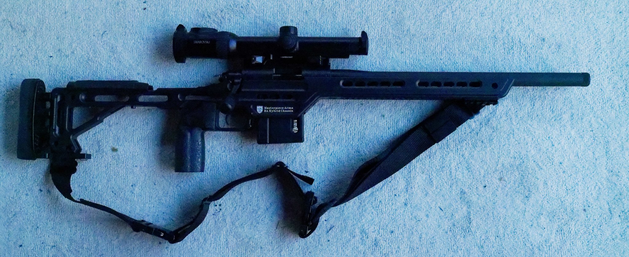

UPS dropped off the 22" Kukri bbl'd action while I was at lunch today, so I went to work on getting it into a Manners PRS-1T as soon as I got home. I'd glued pillars into the stock a couple of days ago, so the epoxy on them was g-t-g. Left them both a tad long on the bottom end so I could trim them if needed; took .030" off the front pillar to get things sitting right, then had to dremel a bit on the bolt handle slot to get clearance for the back edge of the bolt handle. That accomplished, I mounted a new Athlon Cronus in Seekins low rings, got the reticle leveled, wiped the bore out with Ed's Red, grabbed a few boxes of assorted SK & Lapua ammo, and headed out to the range. It took five rounds to get the scope centered up at 50yds after pulling the bolt & peeking through the bore to get it roughly aligned on target. 1st shot hit within 2.5" of where I was aiming, so we were good to shoot a couple of groups before it got dark. We've had a lot of rain/snow mix here lately, too wet to flop down a mat to shoot prone with bipod & bag. So I put a Dog Gone Good bag on the hood of my truck and shot standing. Too much pulse beat from leaning across the fender, but it still shot respectable. 5-shot group was also from 50yds, SK Rifle Match. I pulled the first shot out low & right, but the next four went into the same hole. Think I'm going to like this Bartlein bbl & the PRS-1T stock - my first after years of shooting Manners T4As.

Man, I love the look of that rifle! It sounds like you did not bed it, just pillars, correct? I look forward to seeing more out of it soon! My dad just came up for a visit this week & I gave him the Vudoo I bought for him, and maybe with any luck we can go shoot it this weekend. My brother and I just placed an order for our own Vudoo's, both with the 20" Ace Kukri barrel. So now we will have 2 Ace barreled rifles and 1 Bart in our family. He is putting his in a MPA Hybrid chassis and I have a Manners TF2A with the Mini chassis (interested to see how that mini chassis works out).
We cant wait!
Man you guys got me salivating. Don't get me wrong I love my 452, but these v22 are just on a whole different level. Dumped alot this year on rifles and optics but I definitely see a v22 in my near future.
Jesse, I gave into temptation when Paul offered to send this bbl'd action out instead of waiting on the one I'd actually ordered. For whatever reason, they had it sitting there in the shop, cerakoted in sniper grey, ready to go. They'd called to get me nailed down on the cerakote color on a V-22 ACE Ranch bbl'd action I'd ordered at the same time as the two Kukris (one for me, one for a customer); after we'd settled that, I mentioned how much I was looking forward to getting my hands on a Bartlein 22RF bbl to compare to the Kriegers I've done for my other rifles. Jay broke in to say that they had this bbl'd action sitting there, ready to go, if I'd rather have it than waiting a couple more weeks on the one I'd ordered, which was identical to this one....what shooter in his right mind is going to turn down that kind of offer?!?
You're right - I didn't bed the action, just pillared the stock. Will do more shooting at 100-300yds with Polar Biathlon in it as soon as I get the chance, but if what I saw last evening is any indication of what the rifle's capable of, why bother bedding the PRS-1T?

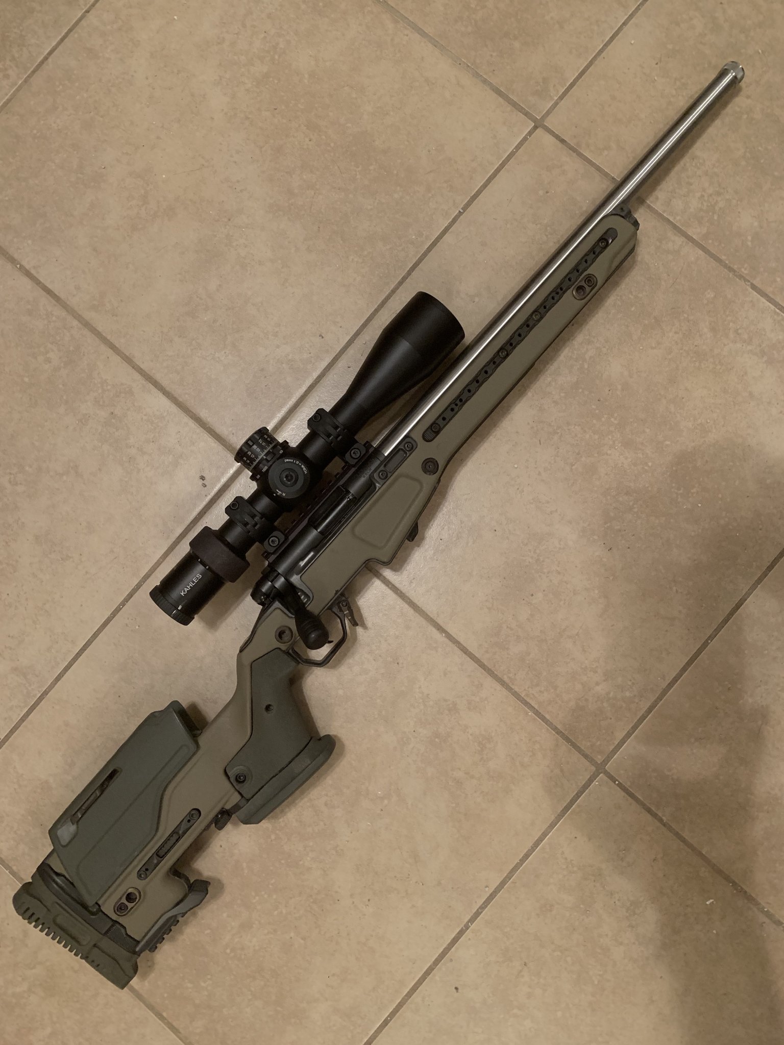

I just picked up a 20" Kukri Barreled action yesterday. Put it in a Manners T6A with a TT diamond and a 624i like my centerfires. Will be a couple days until I can shoot it, but I love the way it feels compared to any other rimfire I had in the past. Having the other components made it a little easier for me to make the jump.

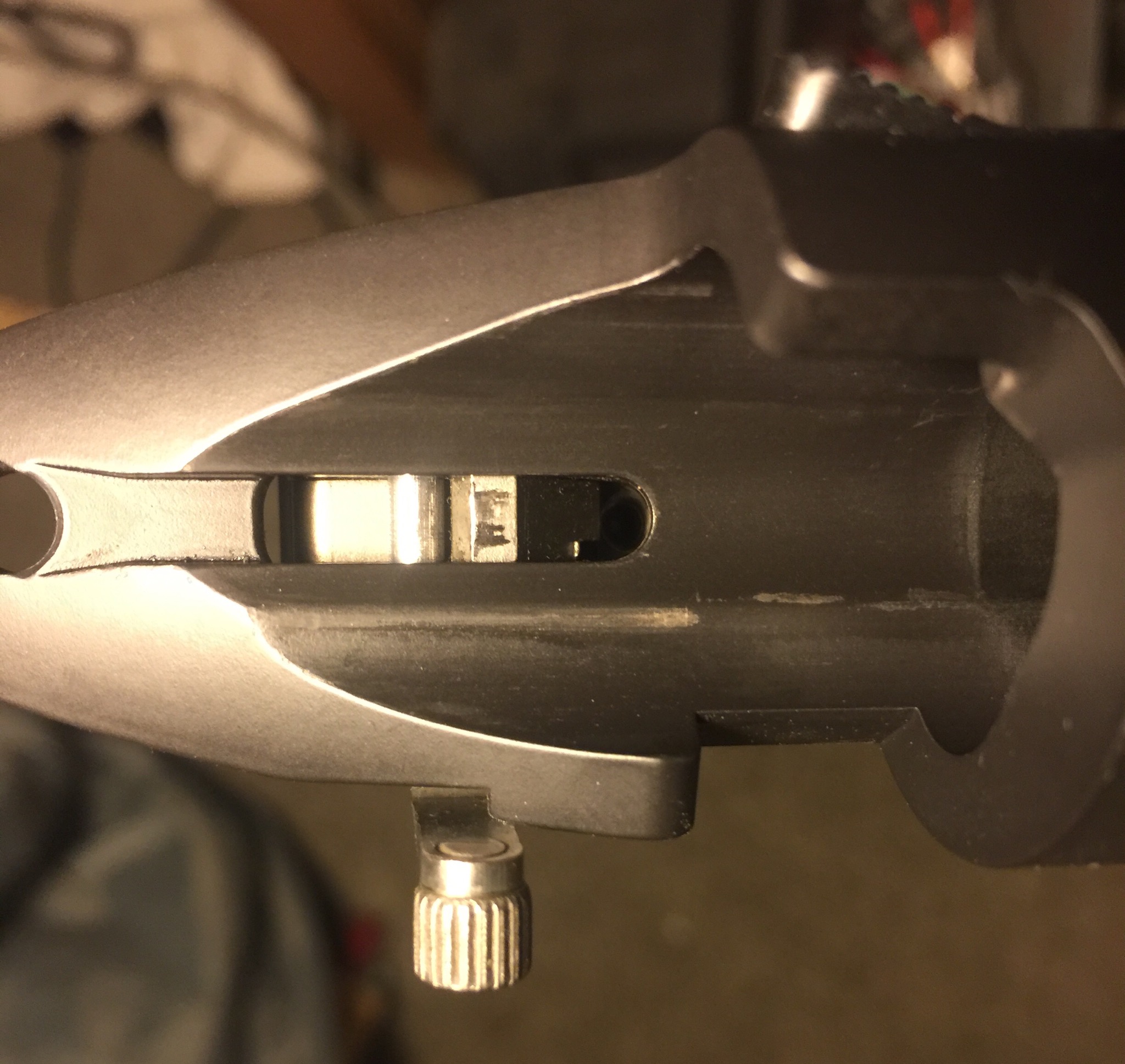

Are new vudoo actions typically tight running at first? My first vudoo was used and worn in. It ran like glass.
My new one with around 70 rnds through it will stick and almost stop halfway back when cycling. Can definitely feel the lugs(I’m assuming) dragging in there.
This typical and smooths out, or have I run across another anomaly?
Same experience with mine. If not already done, thoroughly clean the bolt and action and reapply a lube, seems it may be shipped with something on it that lends itself to being a bit sticky. About 600rds thru mine and its smoothed out alot.

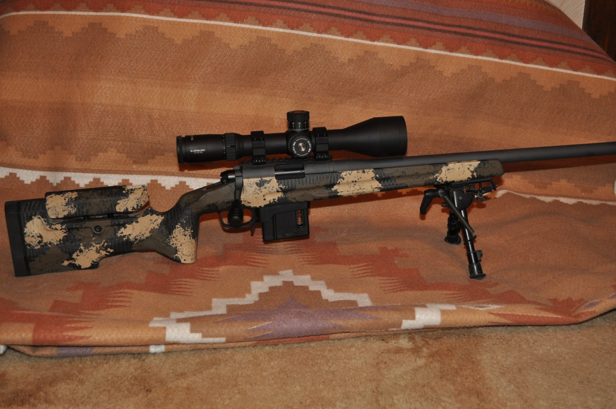

Vudoo, MPA Hybrid Stock, Swaro Z8i 1-8. All the good words about Vudoo are 110% true. Superb ergonomics for positional shooting.
And an all-black rifle mostly matte black. Ready for night-ops.
A few more observations. The V-22 just exudes quality, ever bit as much as an Anschutz 54. Functioned perfectly. And I prefer matte black to gunmetal blue but that is cosmetics. Bolt cycling had a wee bit of stick-slip until used a small amount of molydisulfide. Now cycles like glass ever bit the equal of Anschutz. The weight of rifle, MPA Hybrid stock without added weighted, magazine and sling was 9.8 lbs, heavier than I expected. Add almost a pound for a scope and you have a substantial rifle.
This morning put the barreled action plus mag plus tac sling into a Grayboe Ridgeback stock and weight was 10.6 lbs. Well, sniper rifles are not meant to be light. However, before shooting the first shot will broach the subject with Vudoo of down the road making a switch barrel system. I believe Kidd followed this route. Drop a 16" light barrel or a 22" bull barrel depending on the situation. And then, dare I mention the subject, barrel longevity would never be an issue. Some may wonder if a switch barrel is as accurate as a fixed barrel but not I.
ADDED: Granted that I do not have close to a championship trigger finger, the two-stage Timney on the V-22 was the equal of the two-stage 5109 trigger on the Anschutz 54.
The bolt and the action are very well designed and manufactured.....but you need to do your part. 1st clean the entire bolt and action with a good quality CLP/Cleaner. Use a brush, clean cloth and Q-Tips to get into all of the nooks and crannies. Next wipe it all out with a clean cloth back to dry metal. Now get a quality gun grease, I use Hawg Grease and apply to the lugs and a light coat to the rear half of the bolt. Reinstall the bolt and cycle the action 10-20 times. It will make a night and day improvement and within a few hundred cycles it will be warm butter smooth. Also no matter how often you clean the bore definitely wipe off the bolt and action every few hundred rounds and relube.
As far as the CCI goes they have a thicker rim and that is why the bolt is harder to close. Either run the bolt harder or try something else. I've only felt tat tightness with CCI as well.

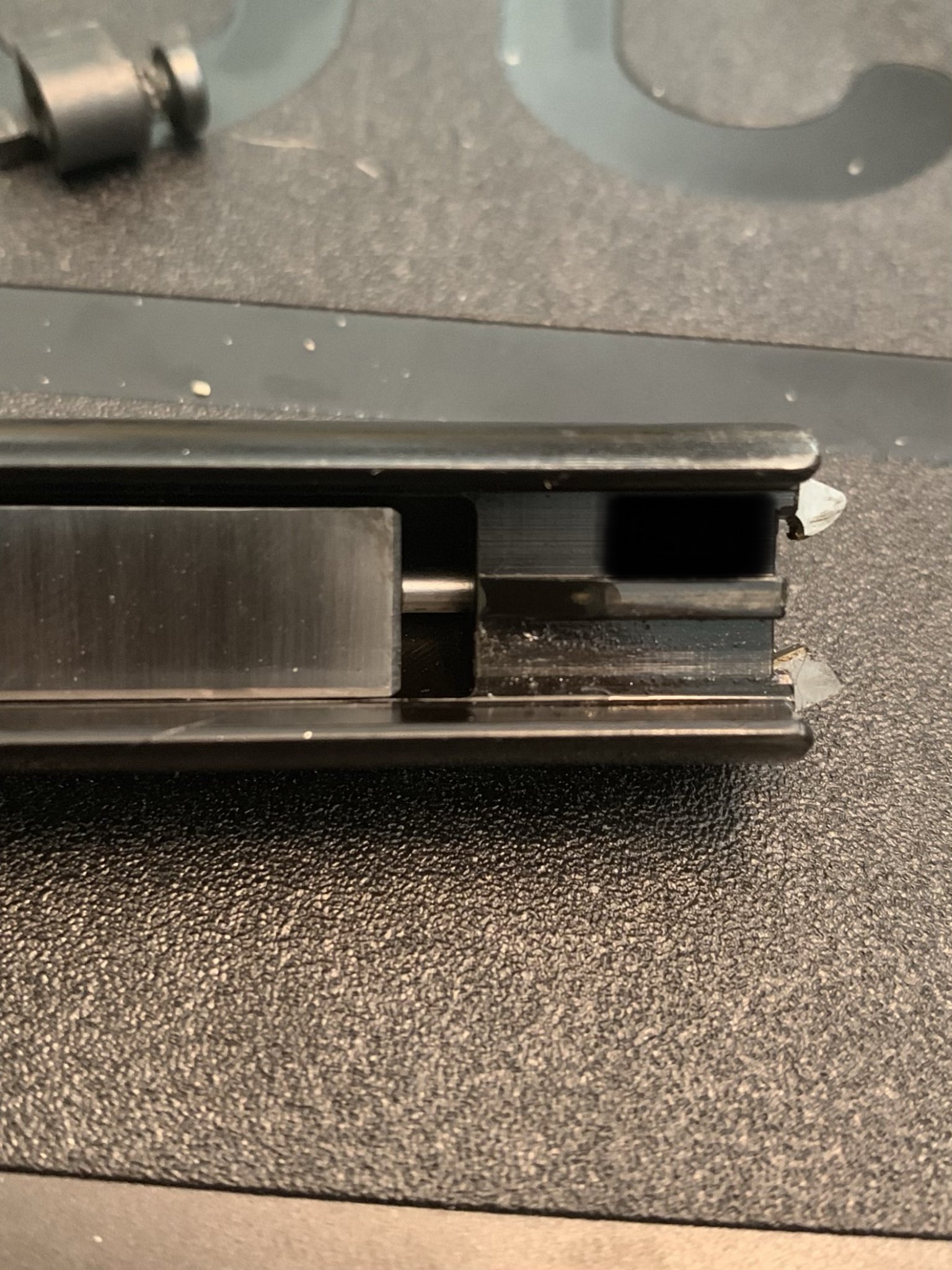

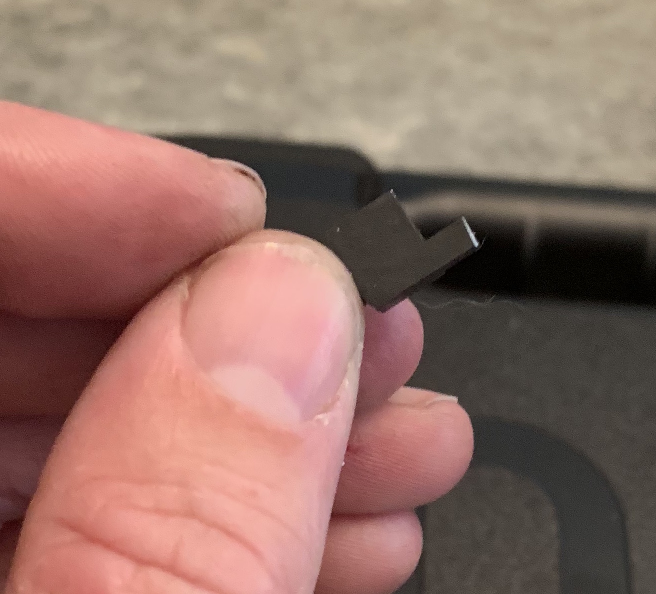

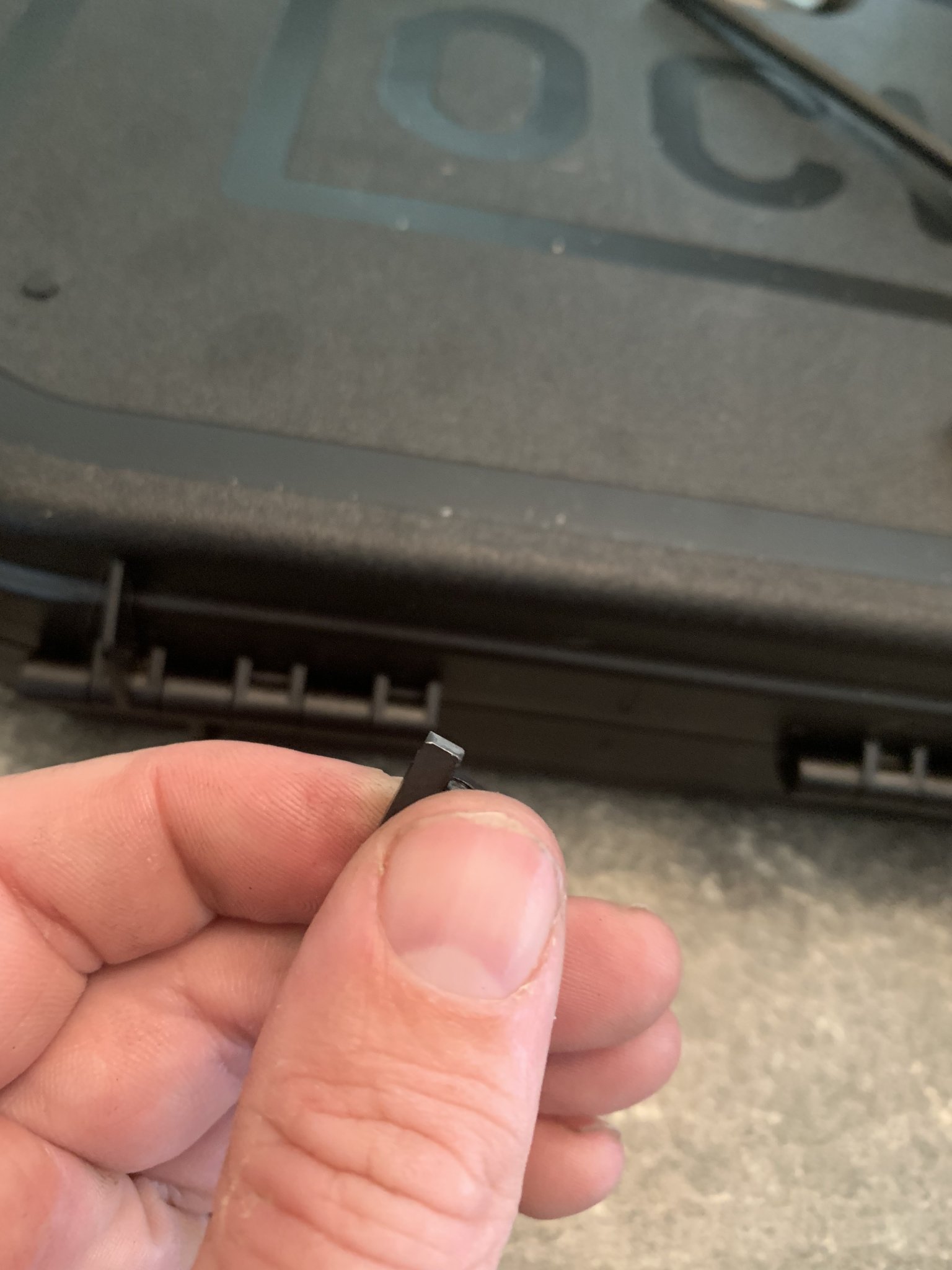

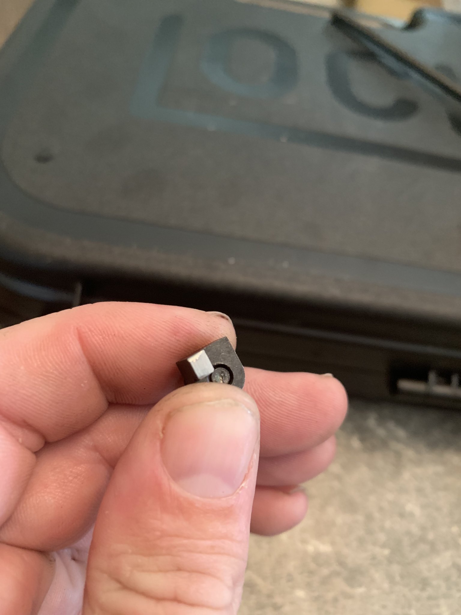

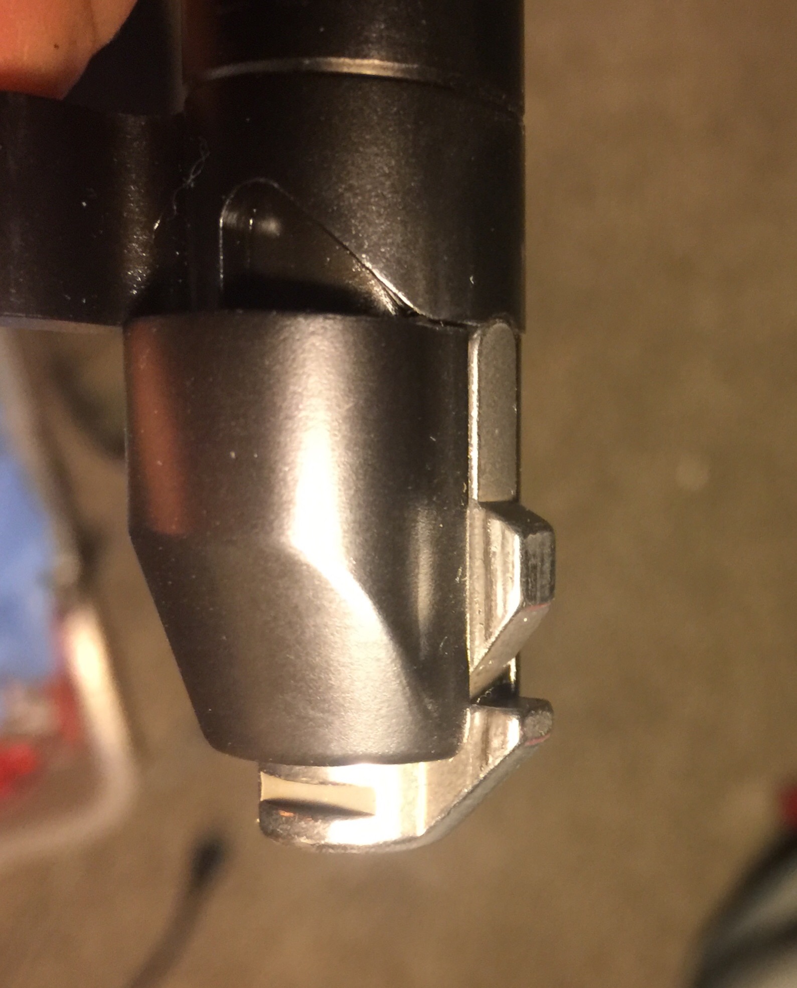

Update:
Took the ejector out and bolt ran fine. Back in and it hangs.
After inspection, the ejector is a hair too tall. Gonna get with Paul about a new one and probably file this one down ever so slightly.
In the pic, you will see where the bolt has been shaving the ejector down. You can also see the marks inside the bolt where it rides.
Simple fix!

Dave,
Been trying to call and sent an email. I believe I’m near your location for a couple days. Any chance you can meet up? I can square it away quickly.
MB
Just had a good convo with Mike/Ravage88.
Awesome response as always by vudoo. Even if it’s just to fix a small issue. Learned a lot in just a 10min phone call.
