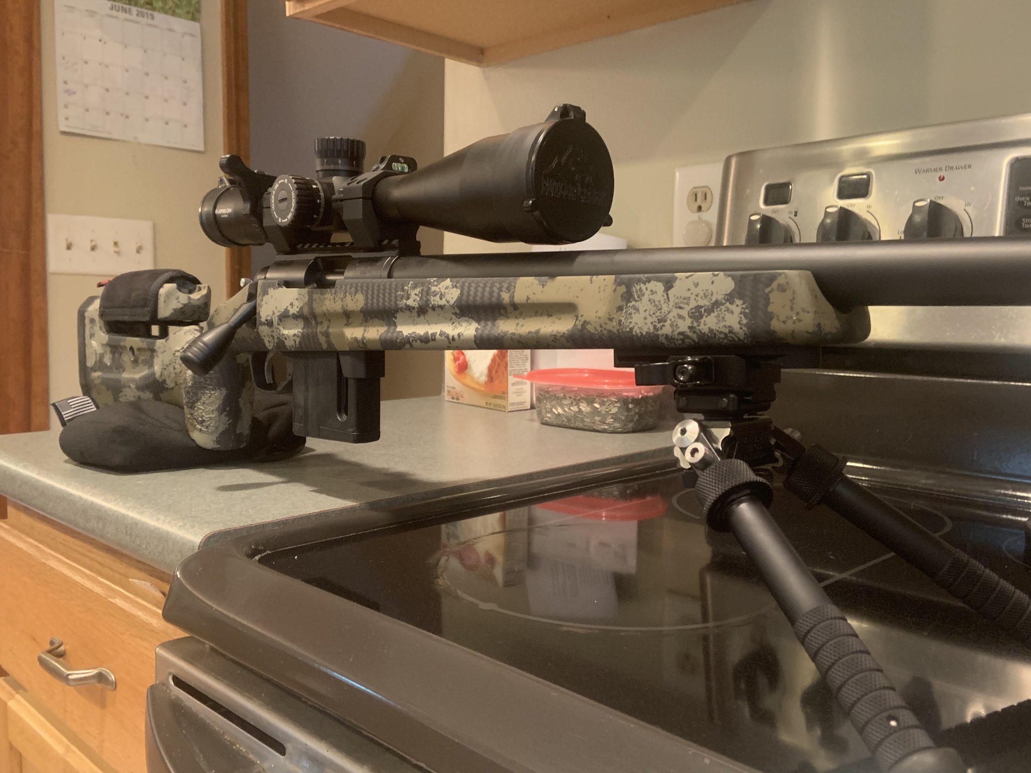

Swapped stocks since I’m shooting my v22 about 95% of the time.

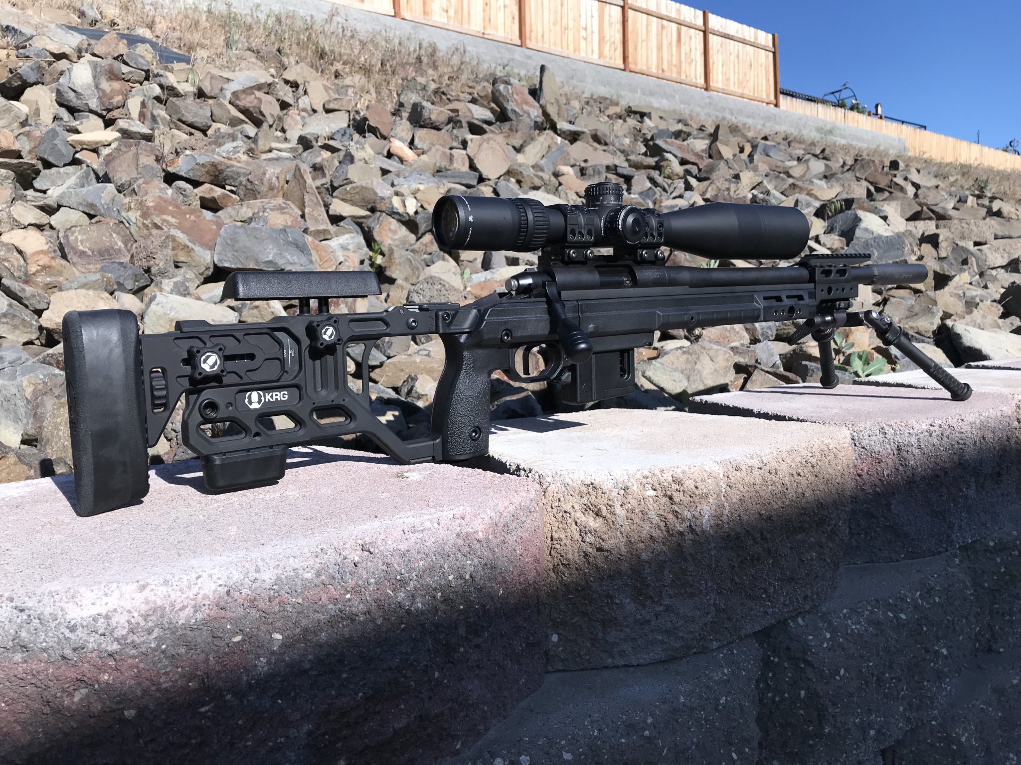

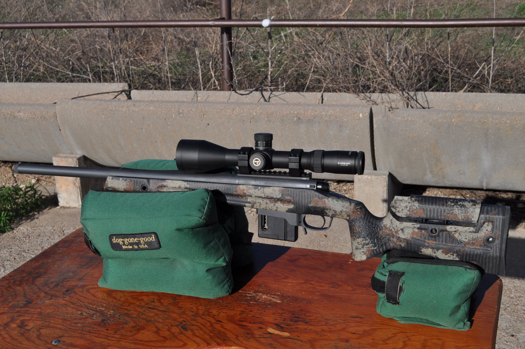

I'm in pretty much the same boat as 7mMike - all four of my Bighorn comp rifles are in T4A stocks, and my 1st V-22 was also, only with an Elite shell. I put a 2nd V-22 (22" Kukri) in a PRS1 in GAP camo, then decided I really wanted a PRS1 in scorched earth for the Kukri, which was done in sniper gray. So when that new PRS1 stock finally arrived a couple of weeks ago, I put the GAP PRS1 off the Kukri on the 'old original' V-22, and set the T4A aside. Was hoping to shoot a local match with that rifle this weekend to get a feel for the PRS1, but it's looking like I'm going to have to stay home to get some rain-delayed farm work done. At the rate things have been going in that respect, I may be lucky to get to shoot one match this summer....
There's a photo of the Kukri in the scorched earth PRS1 - which I'm probably going to send back to Manners to have a spacer installed, since I ordered it with a 1/2" pad, which resulted in a 13" LOP... Ordered it online (1st & probably last time I do that), and had no idea going with a 1/2" pad would result in the 13" LOP. Better to speak with a live person when ordering a custom stock, in order to avoid unpleasant surprises when the stock arrives. It's sometimes hard to reach anyone at Manners on the phone, or I'd never have used their online order form.

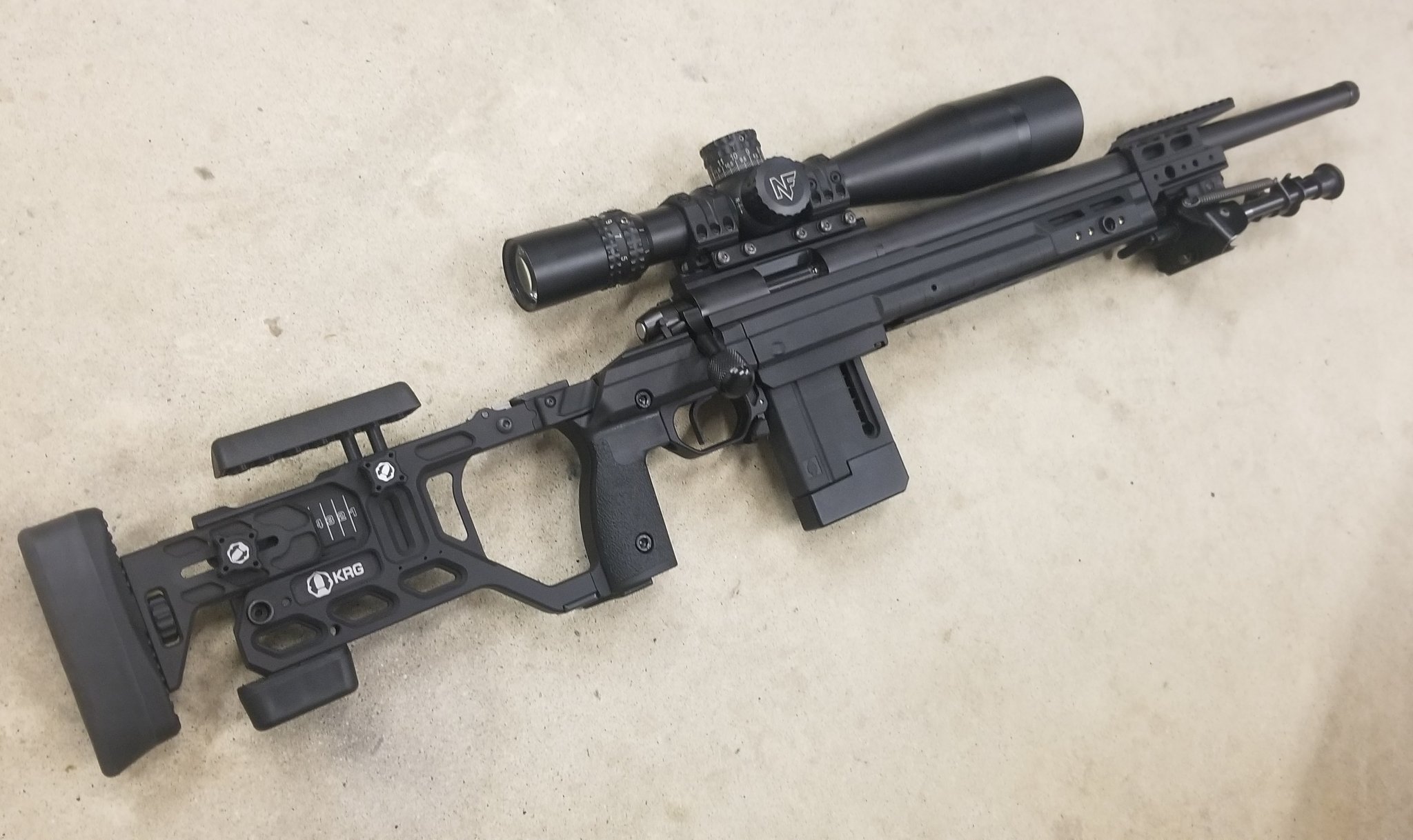

Got my V22 in AIAT folding chassis. My first impression.... "wow". Gun is easy to shoot well. Shot the SK+ std very well. If you are on the fence about AI AT, go for it! and get the folder so you can get the thumb rest. Really nice rest.
The bolt is sticking a little, but from what I have read, it should smooth out. I will keep shooting it as is for the next few hundred rounds and see what happens. Can't wait to get some 6x5 targets up.

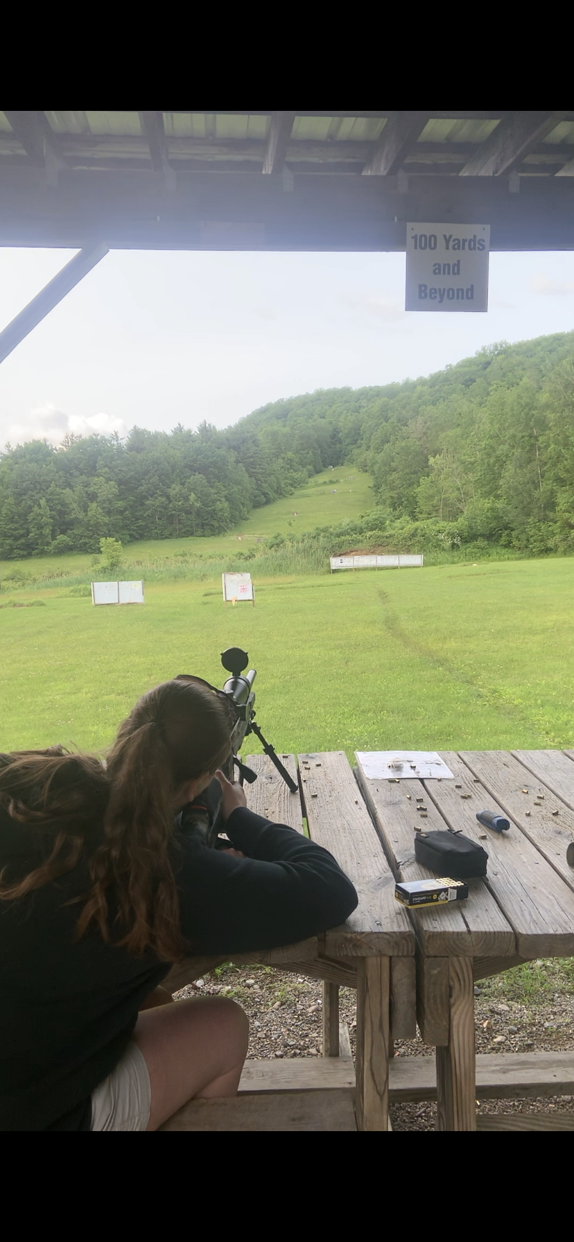

Some SK Standard at 100 yards. Top 1 o’clock was first shot then made my adjustments shooting cross ways from the target. Also had the wife hitting steel at 400 but it won’t let me upload the video. She doesn’t shoot much at all but was having fun I could tell

Wow that’s a good group with yellow box, mine is a mess with that ammo but she loves some Center x for sure. I just bought a few boxes of sk red to try that out..
Just curious, is having ur thumb on that side of the grip comfortable to shoot?
For me, it is. Supposedly if you shoot long days, hour after hour, it is even more comfortable. I started shooting my CZ that was in a Xray this way and got used to it. So, for my V22 I wanted the option to do that. Had to go to the folding AIAT to be able to add the aftermarket rest.

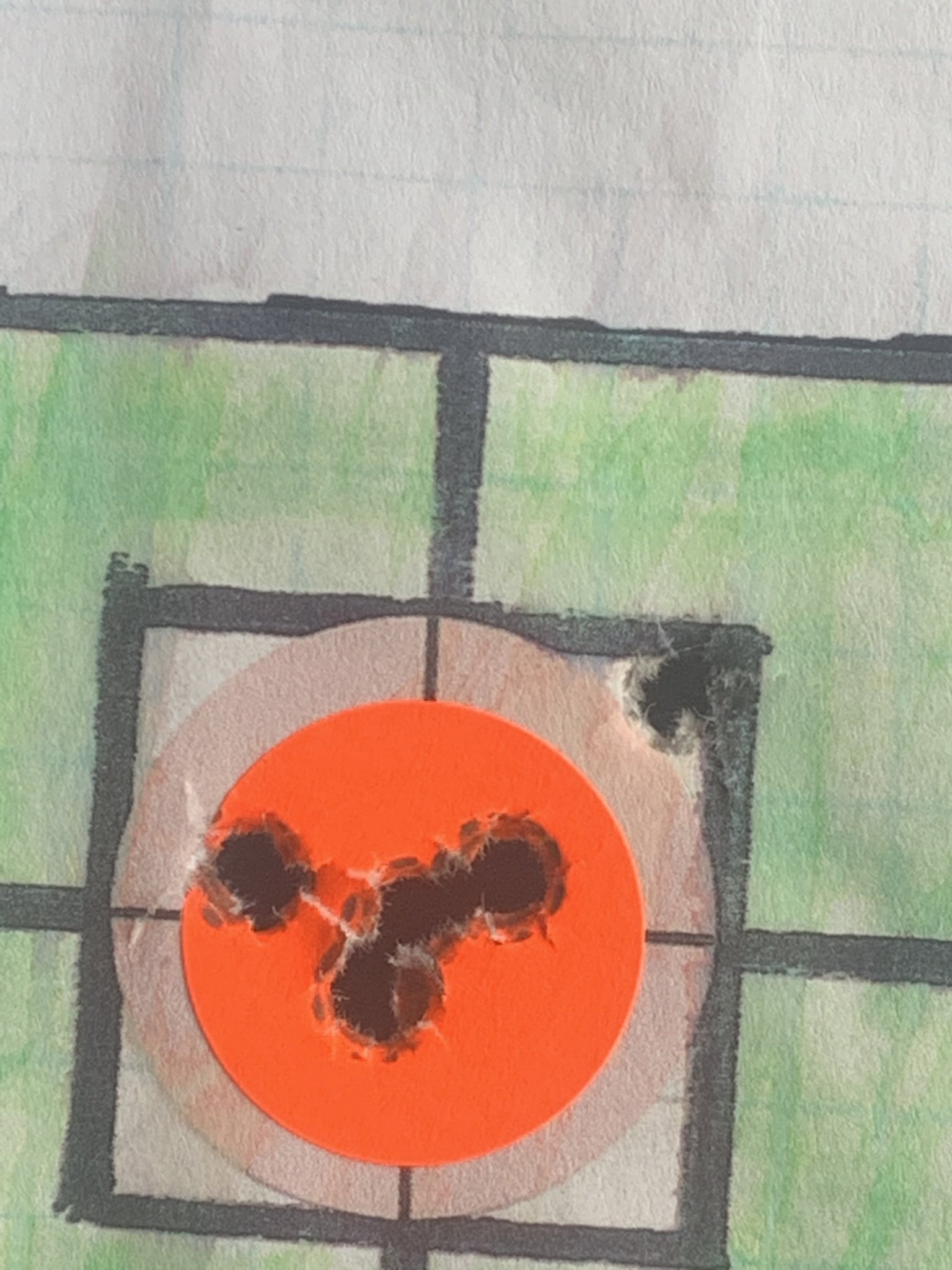

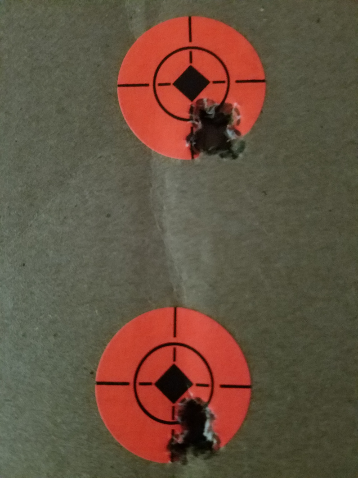

Not going to post to the 6x5 yet, since I'm still getting comfortable with this gun, but here are some groups I shot yesterday. Can you see the grin? These are with SK+.
The gun sits in an AIAT, 18" Kukri and TT
