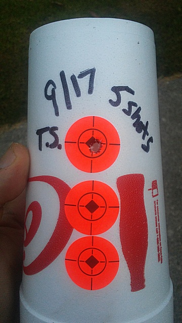

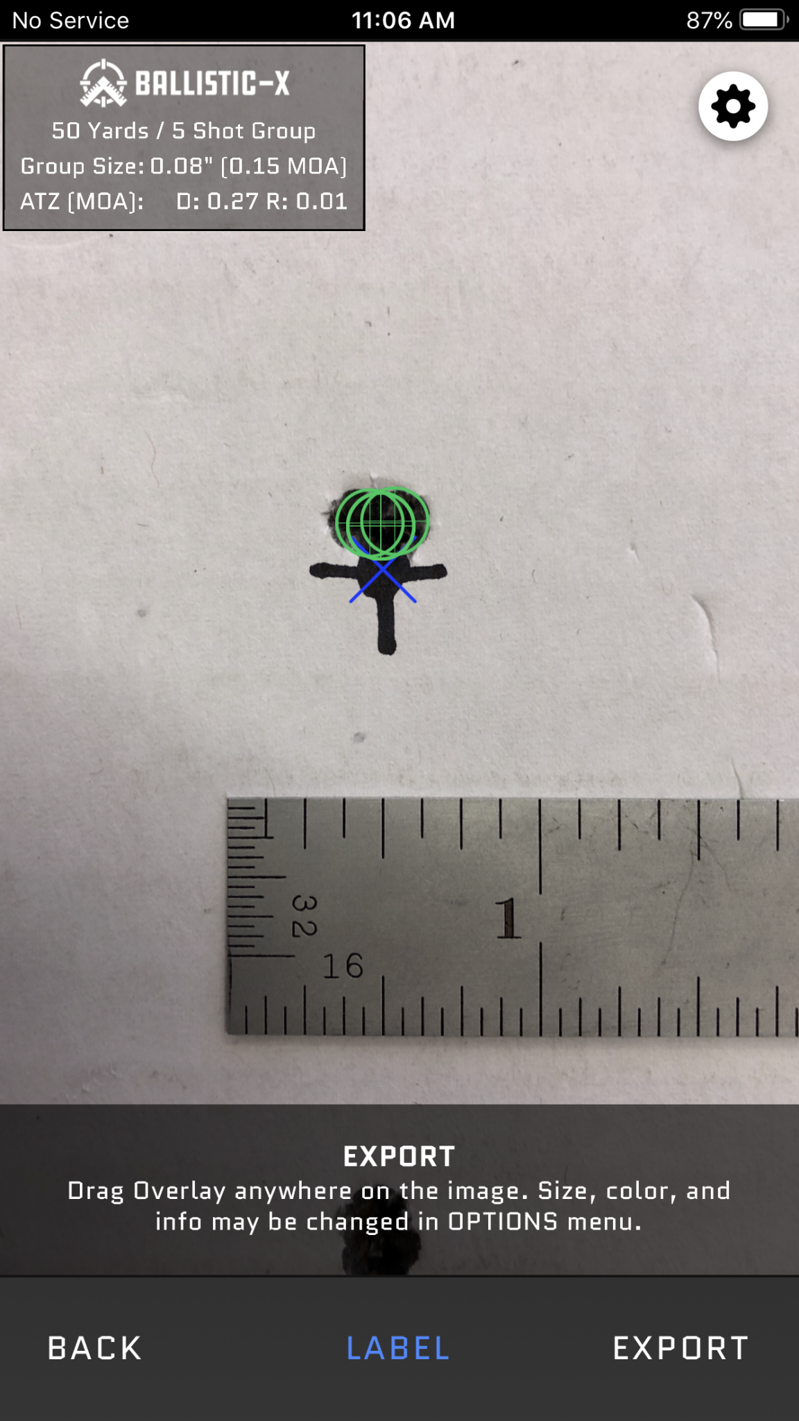

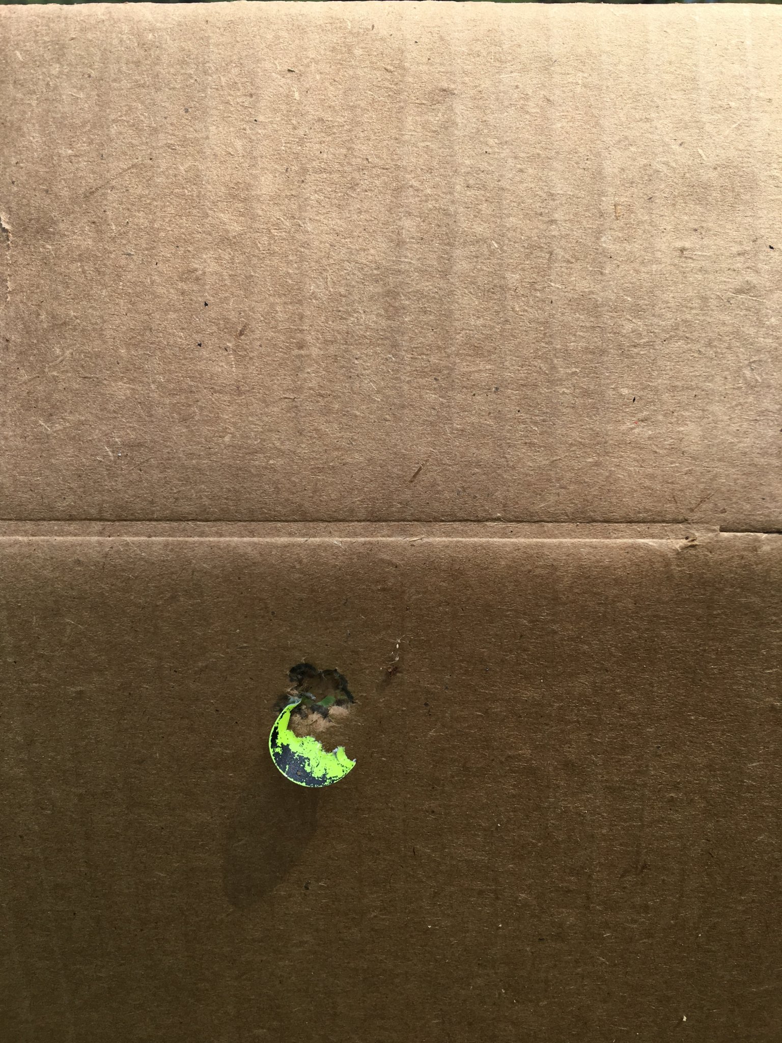

What I am about to show you , many here will call bullshit........especially Kevin1 who has admitted that he stalks me.
I have my own range which I can light up at night. I shoot .22 rimfire and PCP airgun, almost daily. I do this to keep my skills honed in.
I do not own a rest and shoot primarily off cheap sand bags from Cabelas when going for extreme accuracy levels.
My targets are at a lasered 50 yards from the muzzle of the barrel.
My Vudoo hasn't been shot in about a week. I've been playing around with Airguns. So today, from the gun safe to the sand bags this is what a Vudoo gun can do, with 0 warm up fouling shots.
These are 5 shots including the cold bore.
The target bull is approximately 1/8 inch. ( smallest of the Birchwood Casey targets)
I shot the Vudoo only 5 times today. After the 5th shot, I picked the gun up, got up and walked away.......put it back in the safe and then went and plucked the target.
This is the target. It was shot at roughly 6:12 pm today.
So when I see and hear all the bullshit about CZ's and Anschutz and some of these other 22 rifles being as good as Vudoo.......lets see one of em do this.
My gun was crafted by Mike Bush, Paul Parrot and team Vudoo. I have never seen , handled, or fired a better , more inherently accurate .22 rifle.
And let me add this. My gun does this ( or very close to this) with astounding regularity. Not every single time, but with astounding regularity.

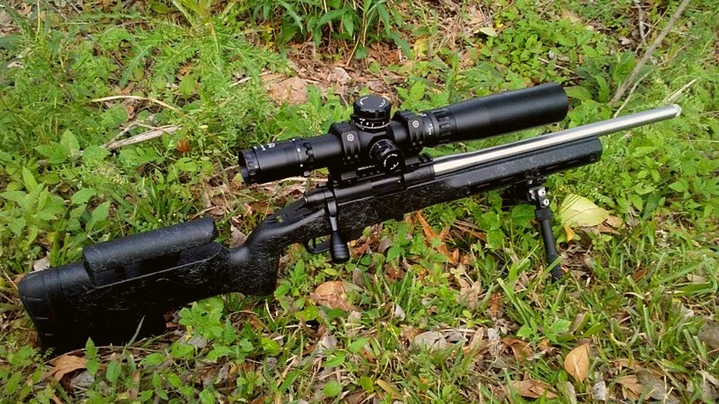

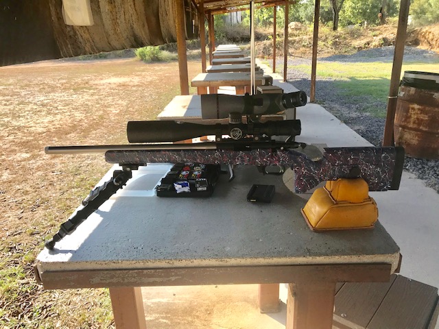

When I was much younger I actively competed in three position small bore shooting, as such I was fortunate to have fired many fine .22 rimfire rifles from BSA, Rem,ington, Winchester and Anshutz. I have over the last several years put many rounds down range from my Volquarsten bull barrel 10-22 and was happy with the results until today. I shot my Vudoo for the first time testing various brands of .22 match and WOW what a gun. As with any rifle different barrels like different ammo but there were no bad groups through this ne barrel and in windy conditions at 100 yds.
The gun has the Vudoo barreled action, a Jewel trigger, McMillian A-10 stock (painted red, white and blue naturally) and a Nightforce scope
The rifle looks a lot better than my poor photo
Vudoo makes a great action and Hill Country Rifles did an outstanding job of bedding it in the McMillian stock their test group at 100 yds in a climate controlled range was .26 .... gives me something to work towards
That is an Act Tac bipod which Im very happy with
Nice toy..ill be gettihg my a10 soon for my vuddo aswell with pillars installed.do you think bedding is a must???
Im certainly not a bedding expert by any means. That said I think miller bedding is critical to a center fire shooting great and it certainly aids a rimfire. I cannot say enough good words for the expertise at Hill Country Rifles. They built me a 6mm Creedmoor in a McMillian A5 that whose test target was .35 with factory Hornady match and re stocked and bedded my Remington 40X 22-250 that I have had for over 30 years in a McMillion A 5 with a test group of .31 all these were at 100yds in their test range. Bottom line is proper bedding means something to me and the results prove it
This is the gun
T.S.
That is a nice group for sure, but what I want to know is how in hell did you keep the cup from moving?
There is a natural phenomenon known as Gravity. It comes from the Latin word, " grativas" meaning weight.
This allows one to use things like paper weights to hold down things like, you guessed it.....paper.
It is a natural phenomenon by which all things with mass or energy—including planets, stars, galaxies, and even light—are brought toward (or gravitate toward) one another. So we can conclude that by placing enough weight on the cup in question, and firing a small projectile traveling at roughly 700 miles per hour.......that the projectile will pierce the Styrofoam cup, without moving the Styrofoam cup.
That is what I could have done to keep the cup from moving. But that is not what I did.
This is what I did.
I had one of the clowns from the Barnum & Bailey Circus come over and hold it down with a bowling pin, that they usually use for juggling, to make sure it didn't move. He was wearing a bullet proof vest, but I was disappointed , not because I didn't hit him, but because he forgot his big red nose at home.
You see , Jbell, you can fool some of the people some of the time, and that should be good enough.
T.S.

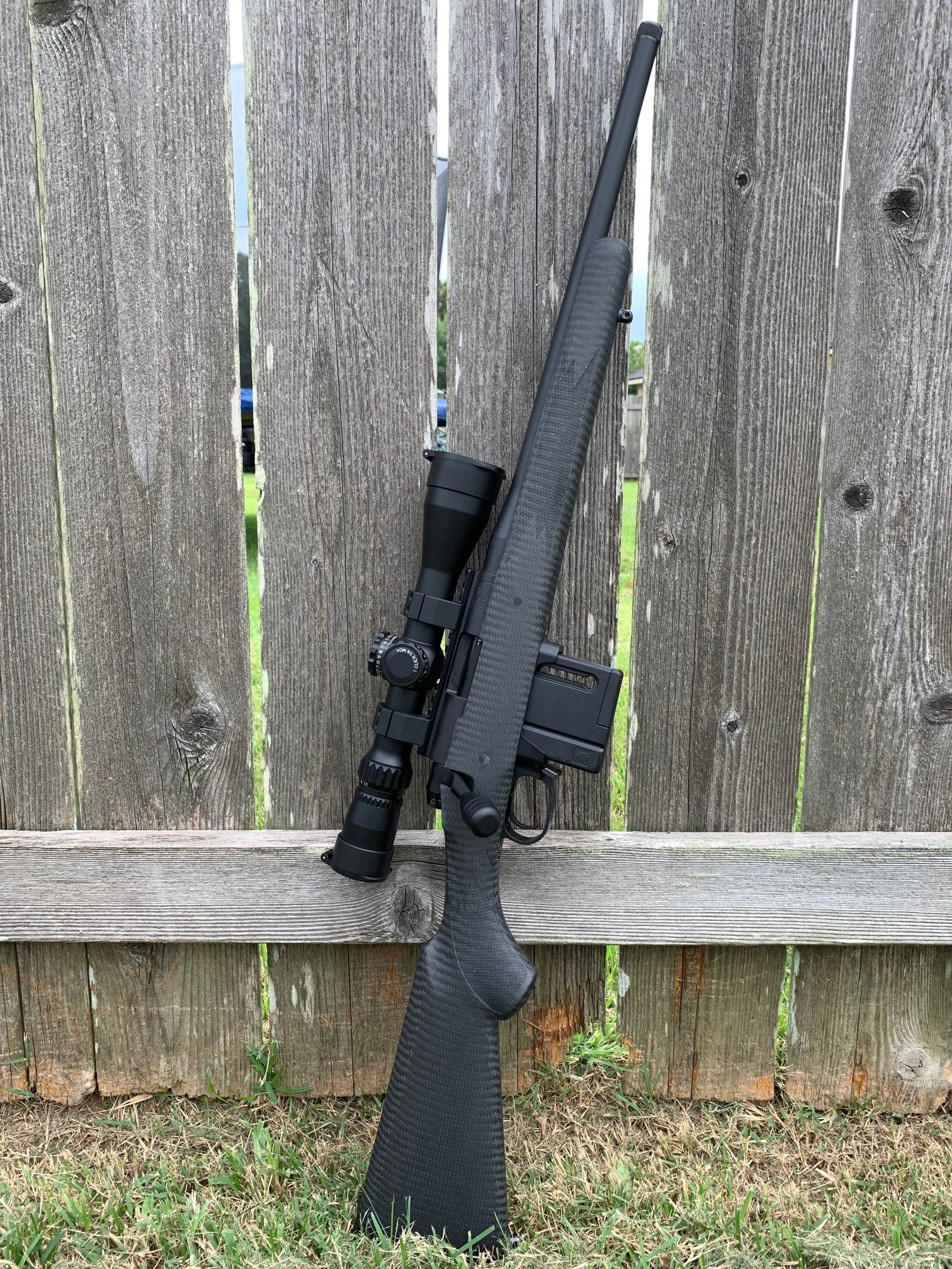

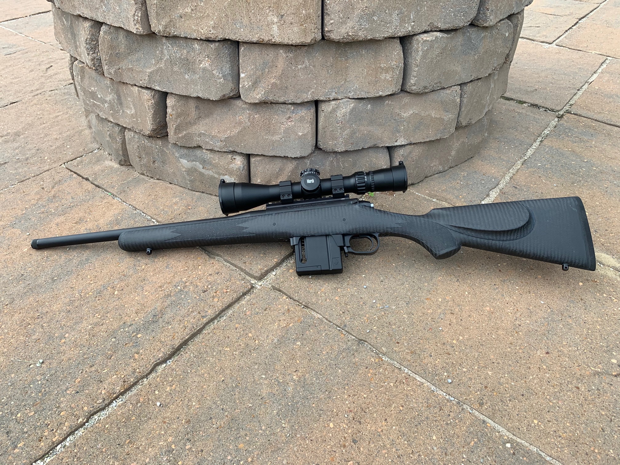

I retired June 1st. The Mrs. said, you should treat yourself to a new gun to celebrate. She asked, isn’t there anything you want to buy? I will just say, if Voodoo comes out with a handgun that would be a competitor of the S&W Model 41 I am in deep trouble. I can see the purchase of one of their long guns but to buy two at once! This site has already cost me thousands of dollars as it is.
Their gun case with matching long gun & a hand gun would be a really nice retirement package.
Maxwell
I used to shoot Olympic air rifles so she has some high standards to meet. Not to be confused with shooting in the Olympics.
Air rifles were only cheaper than .22 in terms of ammo. Ultimately, it came down to shooting enjoyment. It surprises me that the .22 ammo varies so much in cost and in performance. The only way I could justify buying this 45-70 was if I got a .22lr liner for her.
Had I know about a Vudoo, I likely would have passed on the big bore. Don't get me wrong.... I really like the 45-70 but it does tie up a bunch of cash. and then I had to buy a scope and have it mounted.

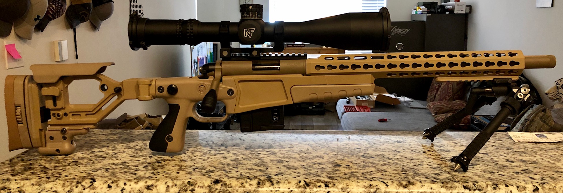

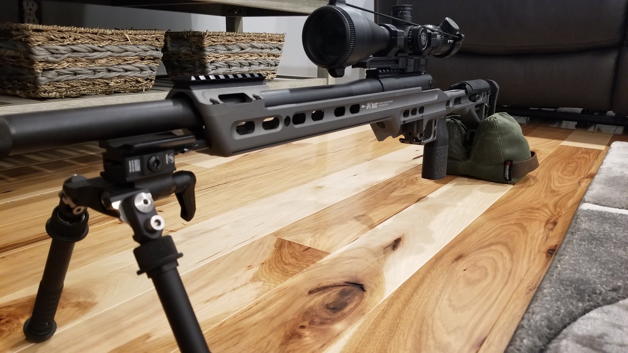

Throwing my build in the V-22 thread.
Build write-up - https://www.ocabj.net/precision-rifle-project-series-vudoo-gun-works-v-22/
Component list:
  • Vudoo Gun Works V-22 barreled action, Bartlein 20" MTU contour (30 MOA base) in FDE
  • TriggerTech Diamond Pro Curved
  • Masterpiece Arms BA Competition Chassis
  • American Rifle Company M10 34mm, 28mm height scope rings
  • KAHLES K525i 5-25x56mm LSW SKMR3
Not many rounds down the pipe, yet. Unfortunately, barreled action was received and built during a vacation blackout at work so I'm still breaking it in. Center-X seems to shoot better than SK, though.
No feed issues with the V-22 in the MPA BA Comp chassis (latest revision).
(Not me in those photos, btw).

Component list:

Got me a new squirrel gun! Wanted to keep the weight down so I went with the new Manners MCS-UC. The stock weighed in at 17.0oz. Scope is a March 2.5-25x42 with seekins rings and bottom metal is Hawkins. Could have made it lighter but I stuck with the 18" Specter barrel. Total weight as seen is 7lbs 15oz. Not too bad! I think a sub 7lb gun is possible with the right scope and barrel combo.
