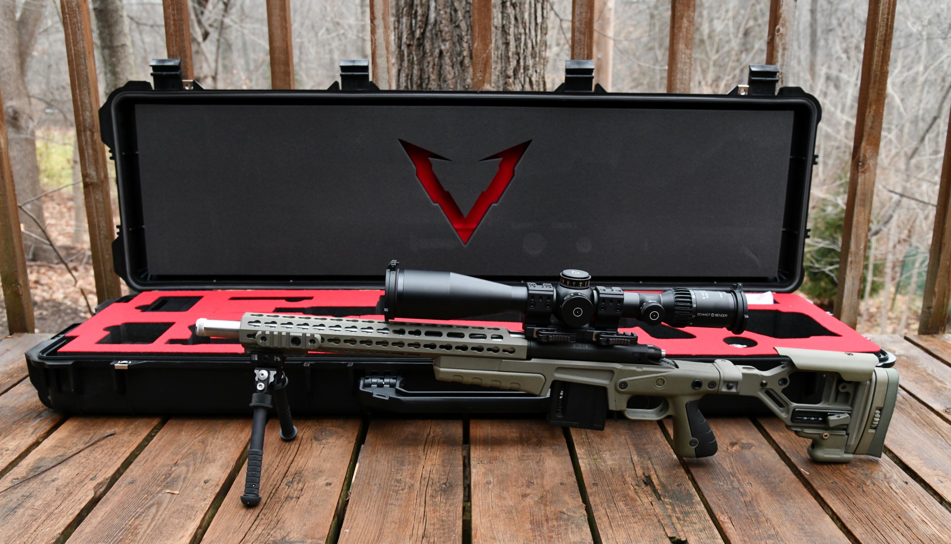

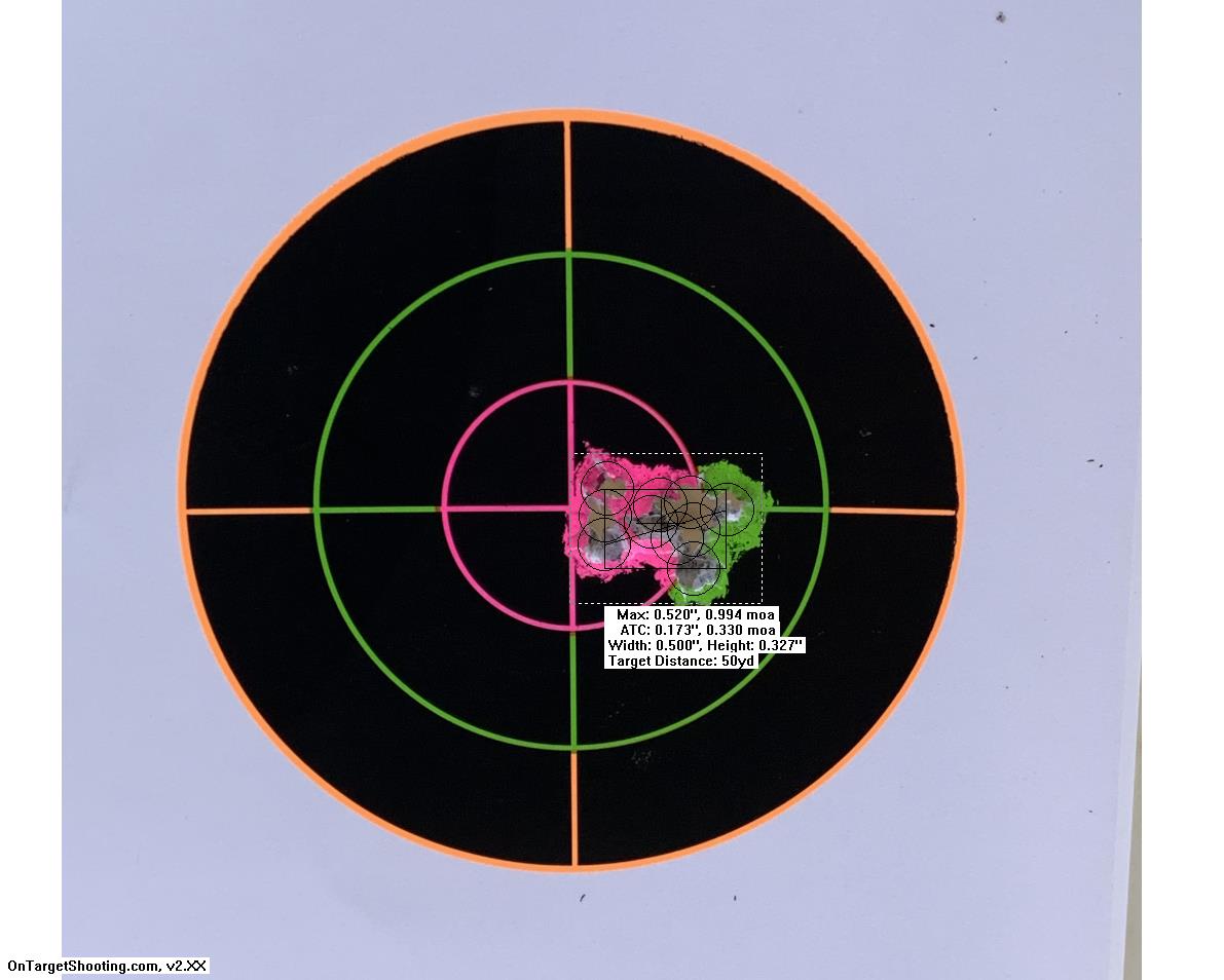

I had my Vudoo on order and it finally came in a week ago. The scope was waiting and I mounted everything up and braved the cold yesterday to go shoot a little. I have read it here over and over but to add one more to the pile - It was awesome and so much fun. Everyone I worked with at Vudoo Gun works was awesome and it was a really a great experience.
Mine is on an AI AX chassis, with 18" Kukri barrel, Atlas bipod, Timney Calvin Elite trigger.
I did order the custom case along with it, and the case just looks amazing.
It tips the scales at a health 15.3 lbs with everything attached, and an empty mag.
Only shot 50 rounds ( Lapua Center-X ) yesterday before I was getting too cold but was impressed with my first 10 rnd group once I had zero'd the scope. I don't shoot very often , so hope that more time will improve my groups even more. This was just seated at the bench.

I love that case. If I fly out for NRL22 nationals that would be one killer transport case.

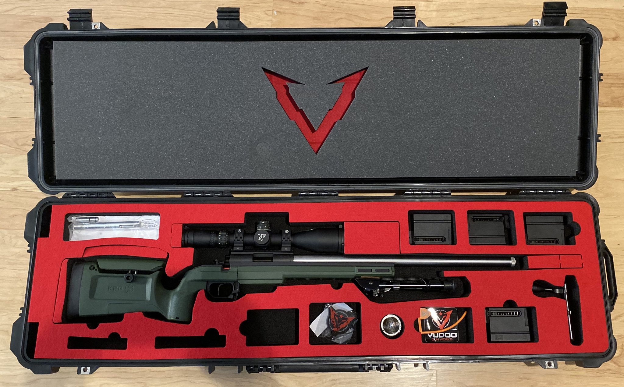

I also got the case with mine it’s spectacular, although it is heavy but considering I got $5200 worth of gun and optics in it.. it’s certainly worth the extra effort in terms of hauling that monster around!

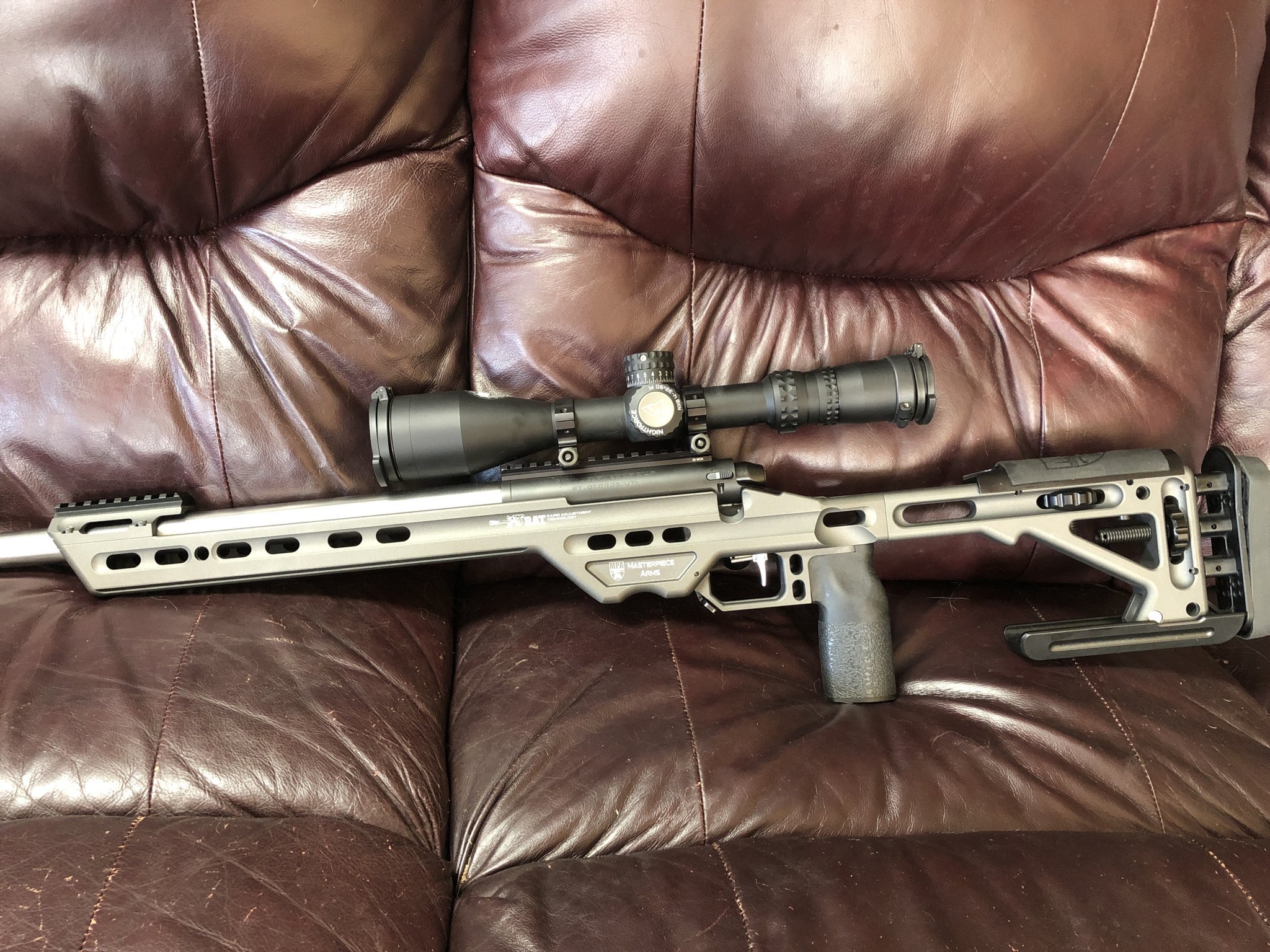

Anyone have this v-22 in a mpa competition chassis , nightforce nx8 2-20 and spuhr unimounts?
Wondering which model (height) spuhr to do.

Very little help here, v-23 in mpa , nx8 4x 32. Scope could move to the rear 1/2 to 1” to fit me. IM 6’ 1”, long neck and i shoot off bench only.
