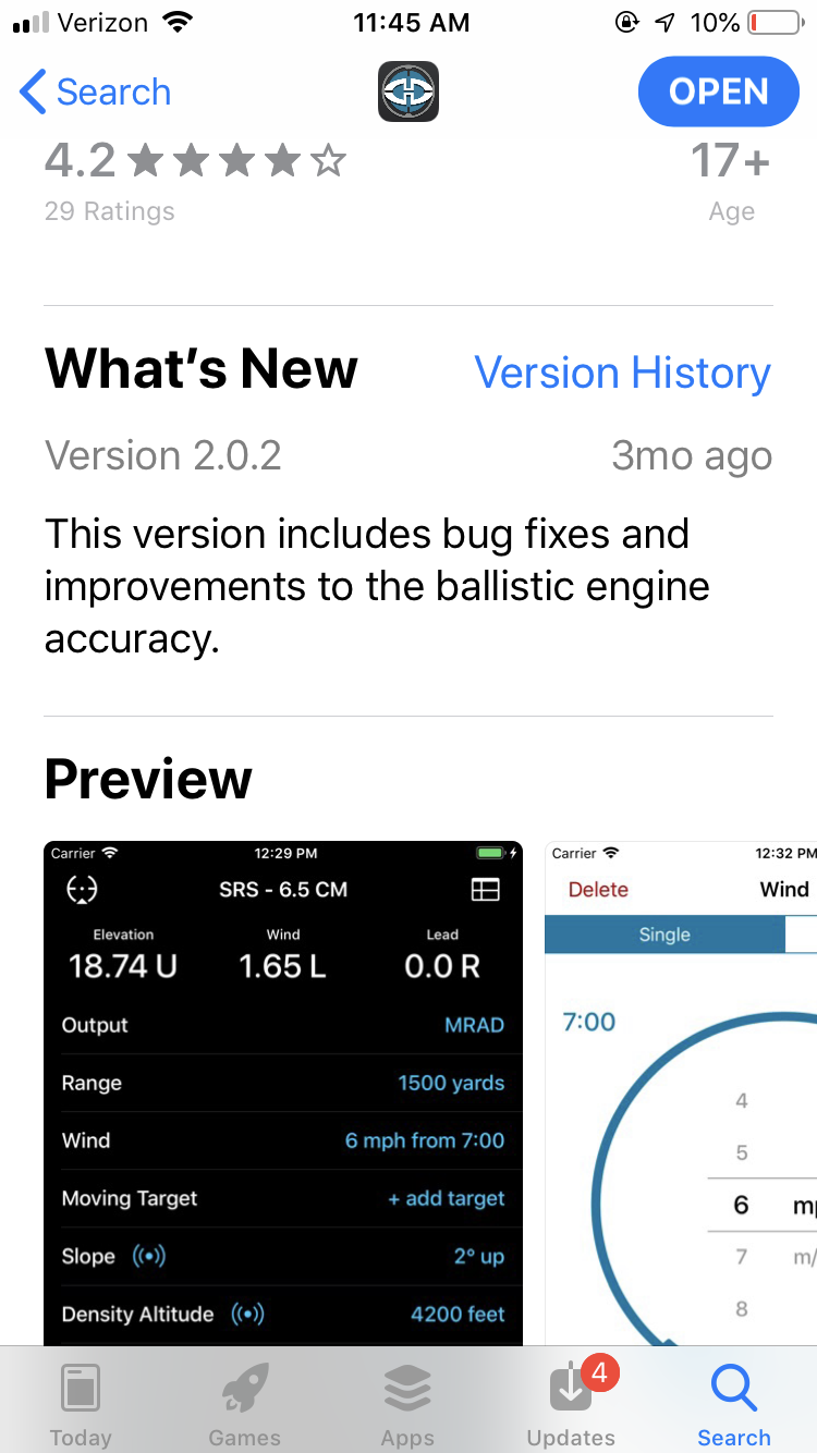

FWIW, the iOS version before the latest fix also had lots of issues with saving profiles and reverting back to the wrong (prior) units. I’m guessing until they release an Android update equivalent in functionality to the iOS version you will have no joy.

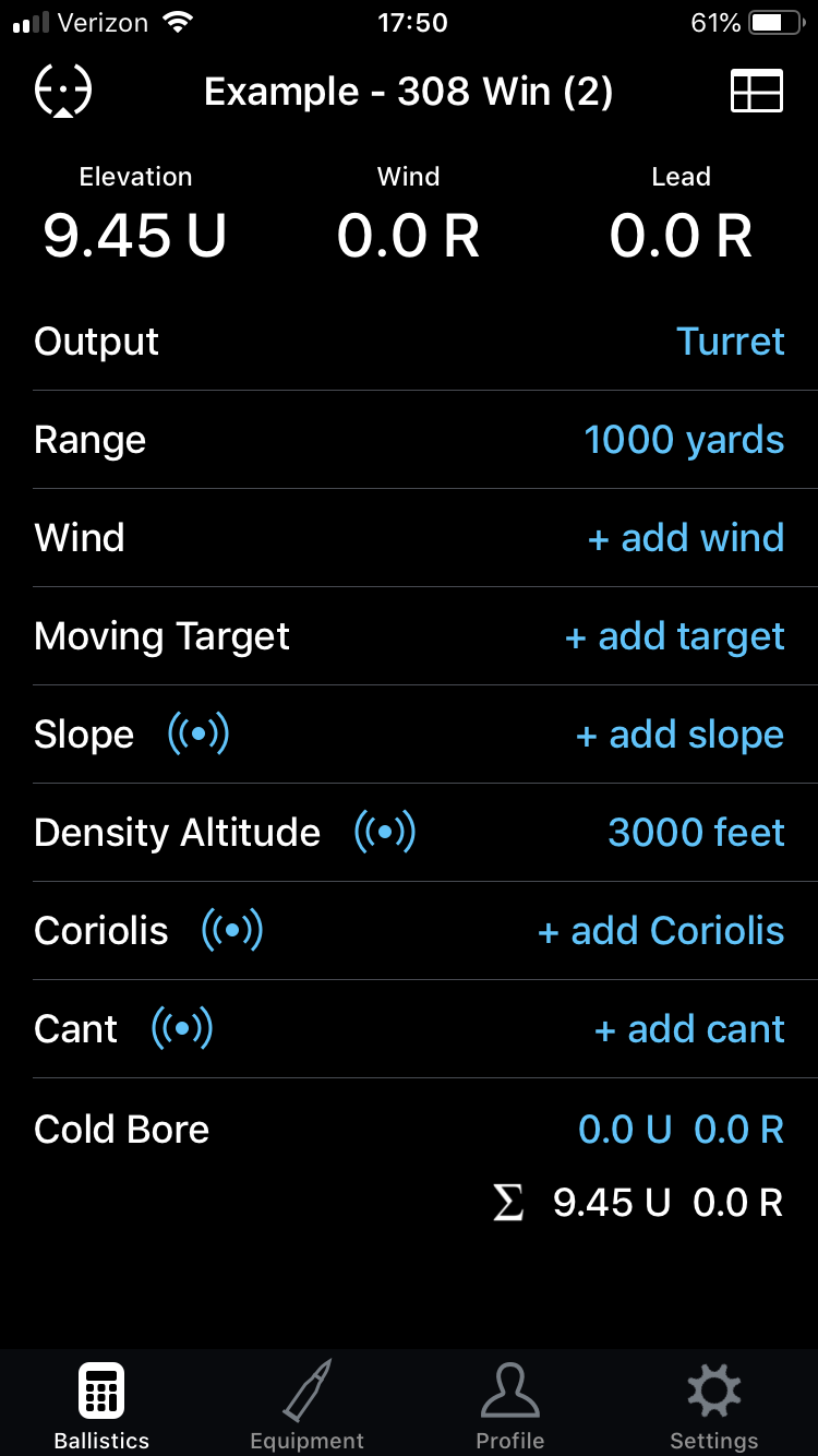

the app works but there are some bugs:. P.e.: when you want to input actual weather data under "Density altititude" it not works. You only can input DA, but you cant input pressure, humidity or temp. The fields seem blocked...
If you use DA, you don't need to input pressure/humidty/temp, etc. They are mutually exclusive. Turn DA off. Then you can input the other stuff. You would use one or the other. But not both. That's the benefit of using DA. You only have one number to keep track of.

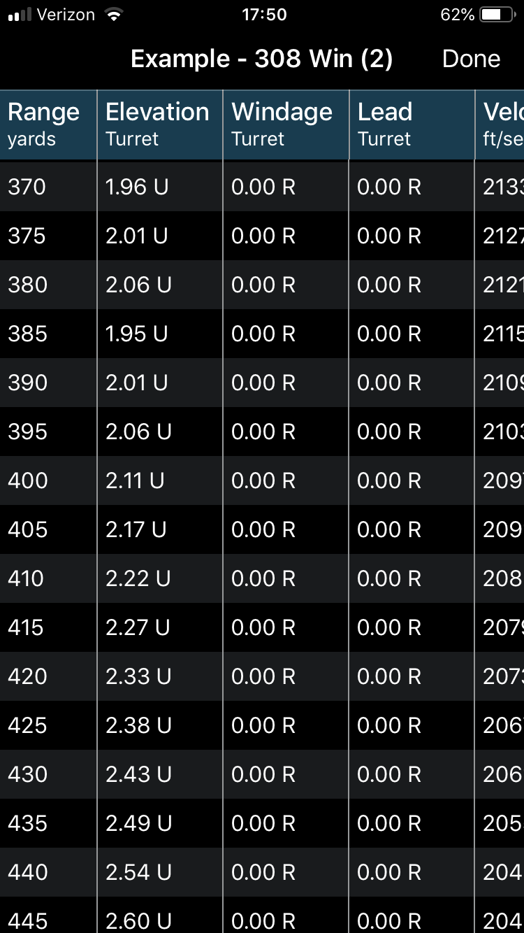

Not sure if it's been covered but has anyone noticed if you pull up the data table 5 yards short of 100 yard increments (ie. 295 to 300 yards) the table says you actually need like .2 mils less at 300 than at 295 and then it slowly starts to increases required elevation at 305, 310 etc. There's clearly a glitch with this software/formulas TRASOL uses. I had a friend check his as well and it does the same thing.
Yes, it is true and has been addressed previously in this thread. It is part of the way the program is written.
@cro789 your settings are fine, and the app is working as expected.

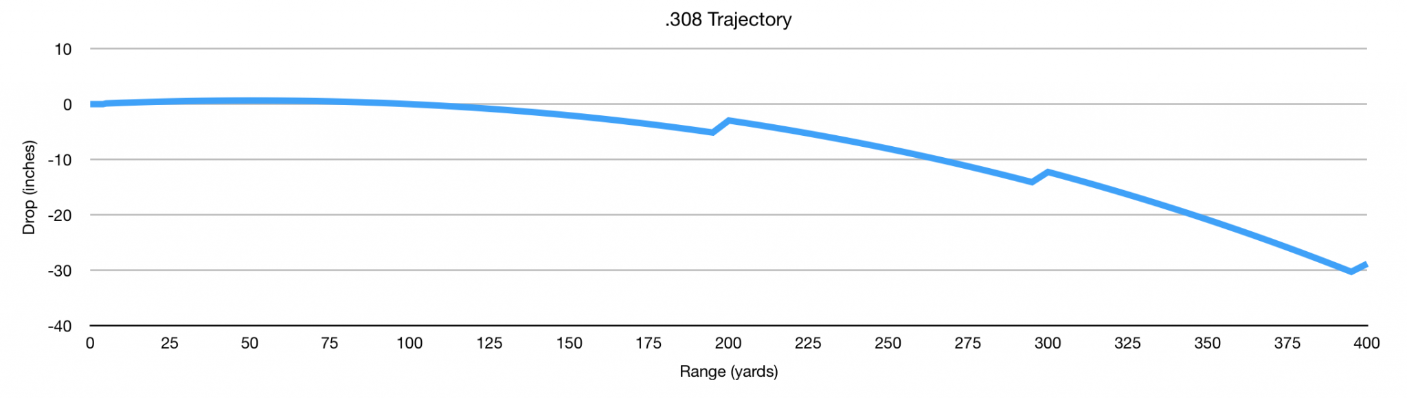

What you're seeing is an artifact of the underlying ballistics engine, where the trajectory periodically needs to be "adjusted" to account for the changing velocity throughout the bullet's flight. The theory is pretty heavy, but basically: your Ballistic Coefficient is dependent on velocity (most published values assume a specific set of conditions), and as the bullet slows the drag needs to be re-computed to account for the new velocity. In a perfect world this would happen at each time step (i.e. each yard), but this would be pretty compute-intensive, so instead the adjustments happen at predetermined intervals.
To help visualize this better, here's a graph of your specific bullet's trajectory, zoomed in to the interesting portion:
Here you can see 3 instances where the adjustment occurs, and the first "spike" explains the result you're seeing. This might seem undesirable, but keep this in mind: these spikes are relatively small (I adjusted to graph to exaggerate the detail), and the effects actually become less pronounced at longer ranges. At the distances most shooters are using TRASOL, the effects are completely negligible. The benefits to these adjustments, however, are significant.
Hope this helps.

Thanks. HAve they addressed this and issues a date it will be fixed? Or are they not planning to fix it? The app seems great other than this but as it is now I’d never trust it for a PRS match
Per Hundley's comments (he is the programmer so he should know) the issue is more pronounced at short range so it should be less of an issue at the longer ranges. In spite of this quirk it is the most accurate solver I have used, I try to just "average" the spikes out when looking at the table.

Gotcha. Sounds like it may be a great app for ELR. It works great for me at 1000 however the issues it causes at 300-600 are too great for me to ever use it for PRS.
I've never had an issue. I shoot from 100 out to 1200 and at any random distance between and the data is always within about 0.1 or 0.2 mil.
