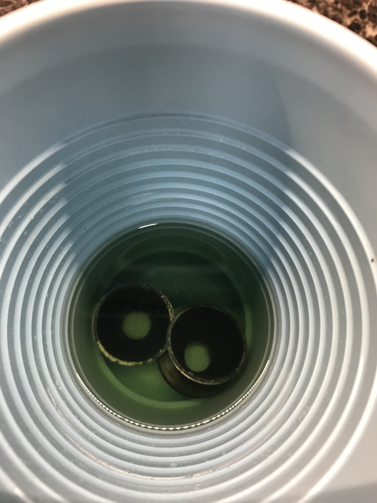

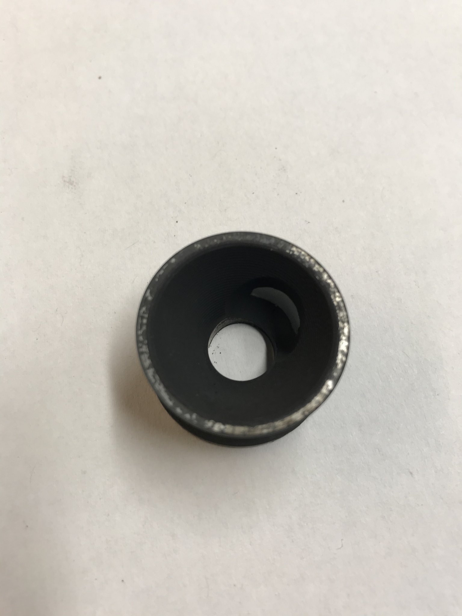

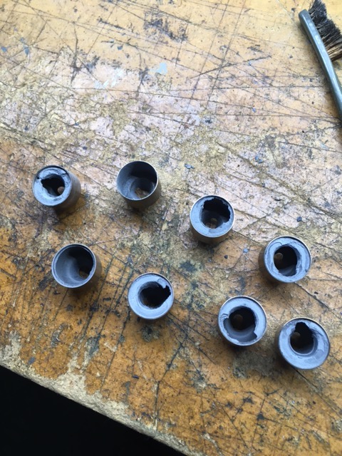

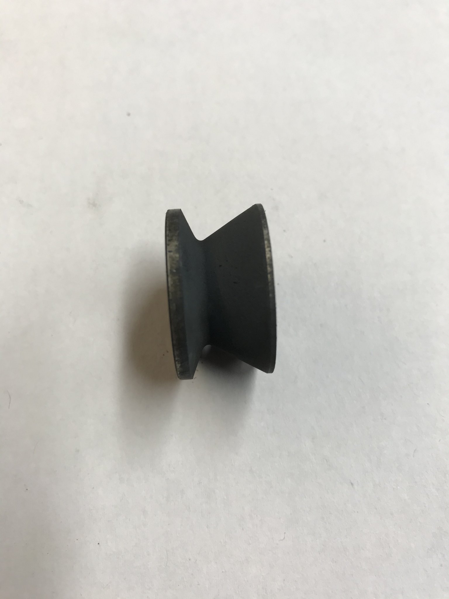

I’m currently running a little experiment. I have 3 solo cups containing 2 aluminum baffles from my 9mm can ( quietbore ).
Going to let them sit for 24 hours and see which one does the most damage, in terms of carbon removal. I’m not looking for squeaky clean, just something to keep up on maintenance.
after 24 hours I’ll pull one baffle and see what i can take off with a plastic pick/paper towel, then throw it back in for another 24 hours again if nothing really comes off.

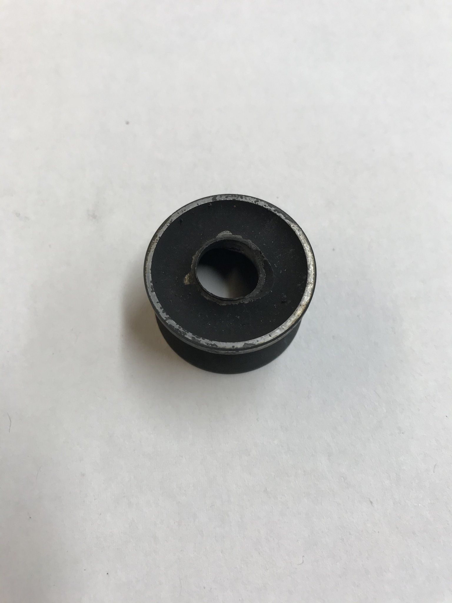

They all look like this currently.

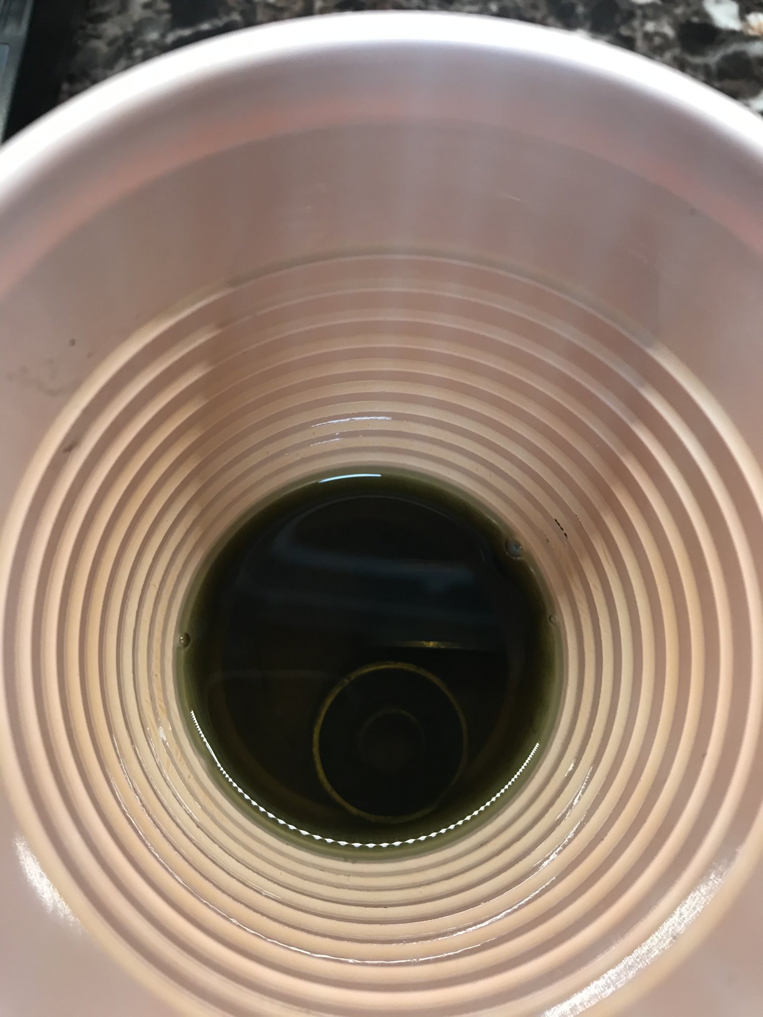

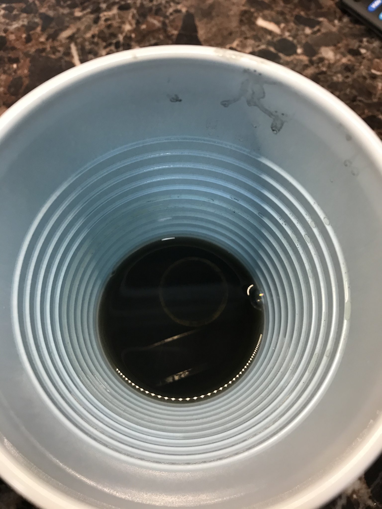

6 hours into the soak...
BoreTech C4 you almost cannot even see them. At the 3 hour mark there were chunks falling off.
MPRO7: this stuff is still pretty clear, with a blue haze and floating white pockets.
Hoppes 9 : darker than the Mpro7, but still clear enough to see it hasn’t begun to really work yet.

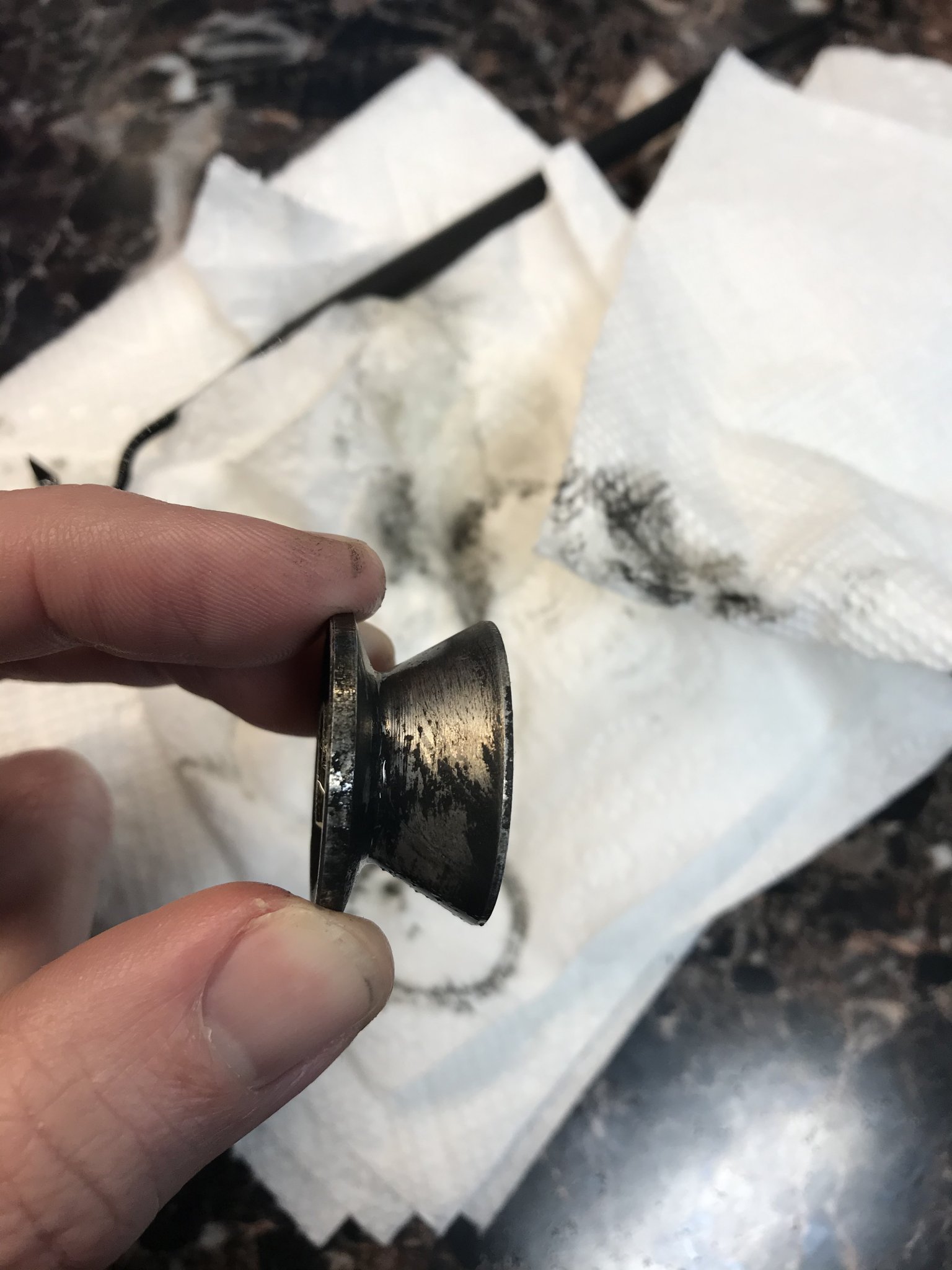

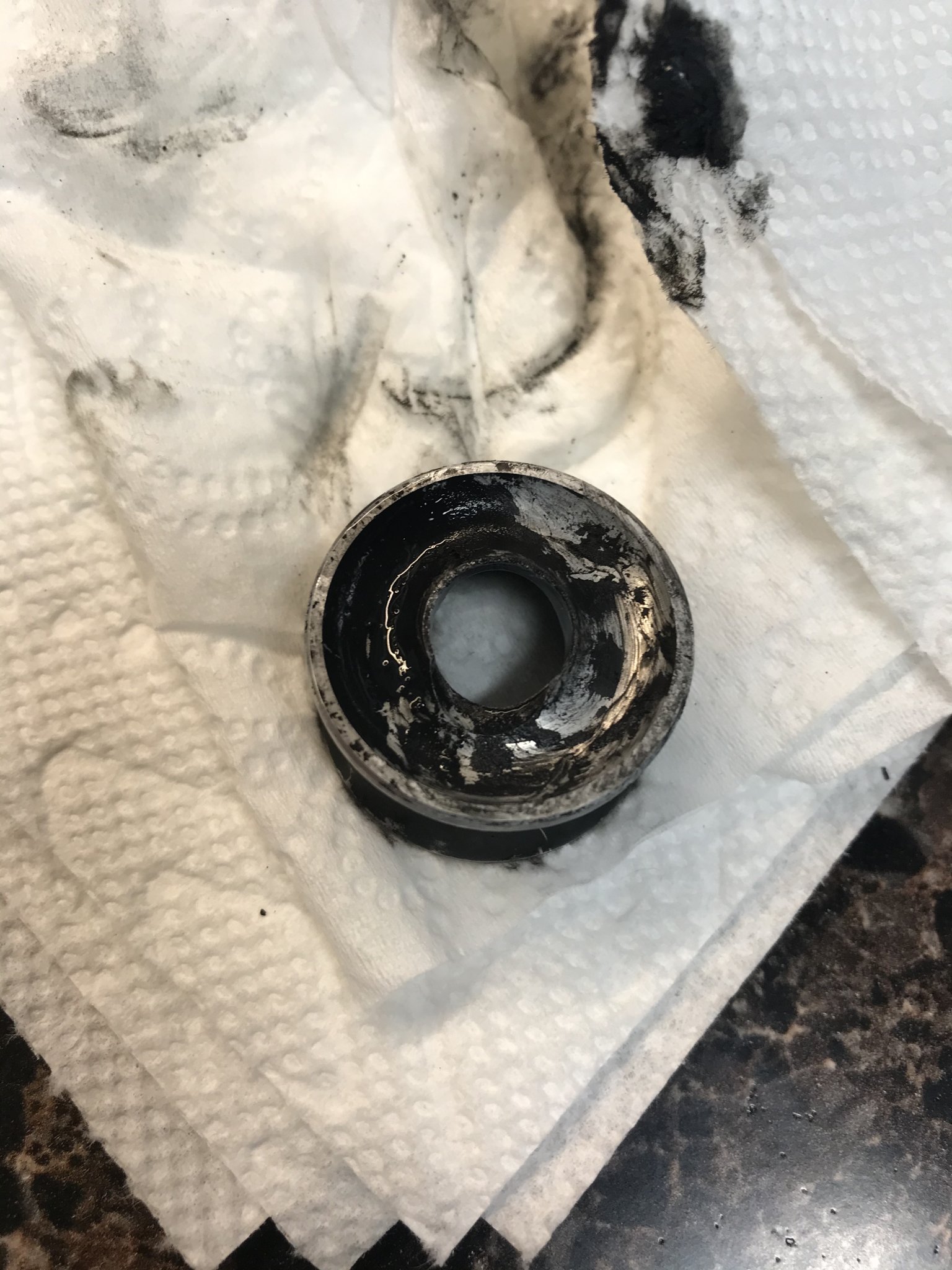

Now, lets see what comes off with a paper towel swipe...
First is the Boretech... this was like wiping wet snow off the hood of a car. Zero effort, clean off. I don’t think this will even need 24 hours.
Next Mpro7... could’t get much off the top as with Boretech, but its coming off the sides pretty easily
Hoppe9... still nothing really coming off. Slight smudges, but this will definitely take longer.
I’ll pull them all tomorrow for the full 24 hours and see then. So far, BoreTech C4 is the clear winner.
EDIT: pulled the boretech after seeing the picture I put up. This stuff wiped right off. Maybe a little longer would have gotten it all, but fuck it... its just going to get dirty again. This is good enough for me. Ill still put up the others tomorrow, but BoreTech definitely works, and safe on Aluminum. Time to order a few bottles to clean my Omega.

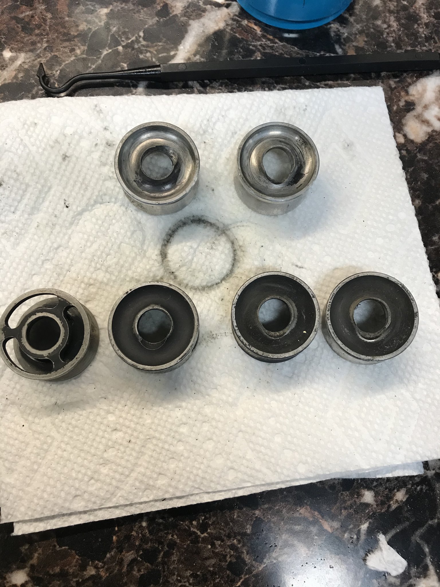

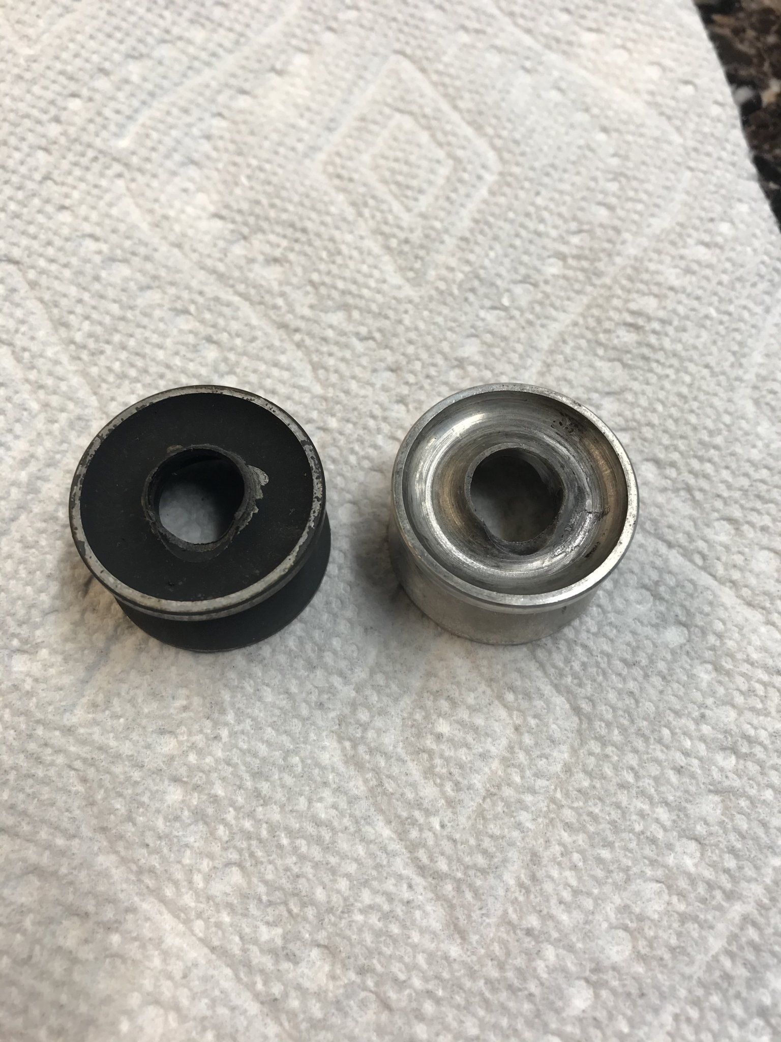

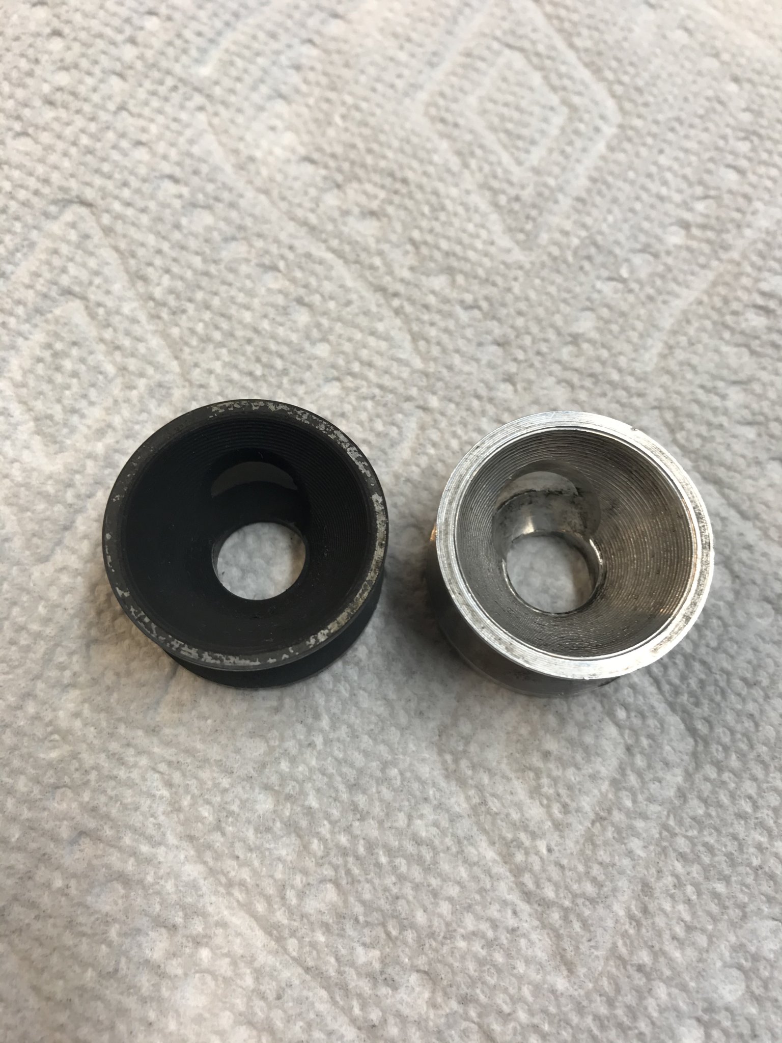

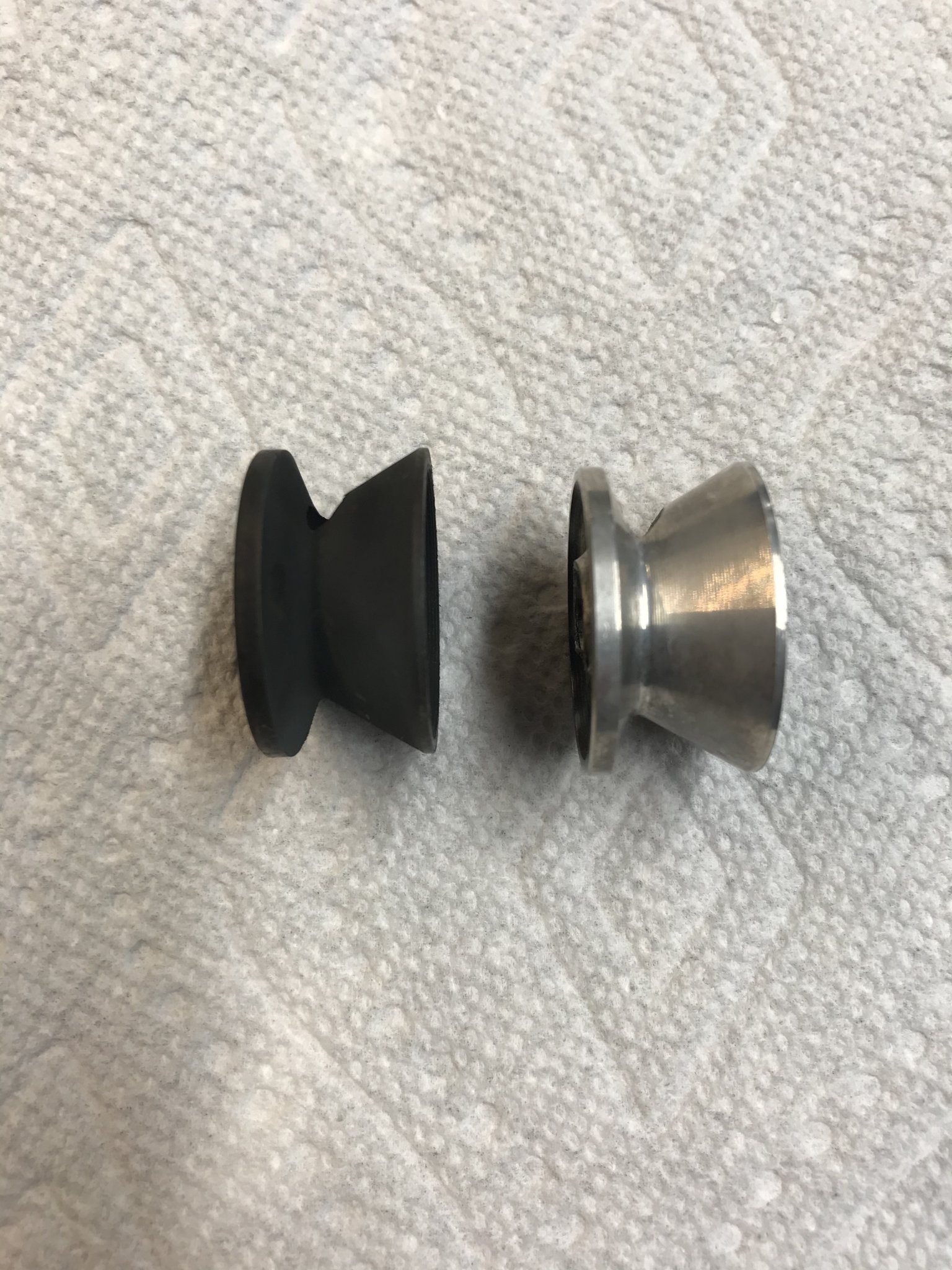

24 hours...
Top is obviously the boretech c4, which again only soaked for 6 hours and wiped off. Perhaps another two would have gotten them squeaky clean, but this is abou cutting down on carbon buildup, not returning to show room finish.
bottom left is Hoppes 9, bottom right is the MPO7. Really nothing to report. They clearly need more time and to be honest, this was only 300 rounds. Imagine 10 times that... or even 3 times... you could be waiting weeks maybe for this to break it down.
Findings: BoreTech C4 works, and again, from the company themselves, is safe for aluminum.
24 hours...
