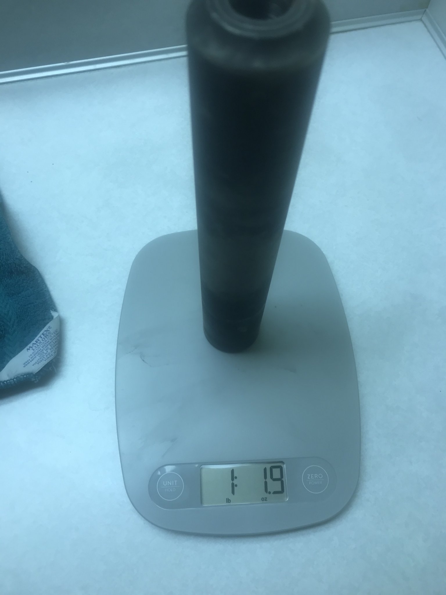

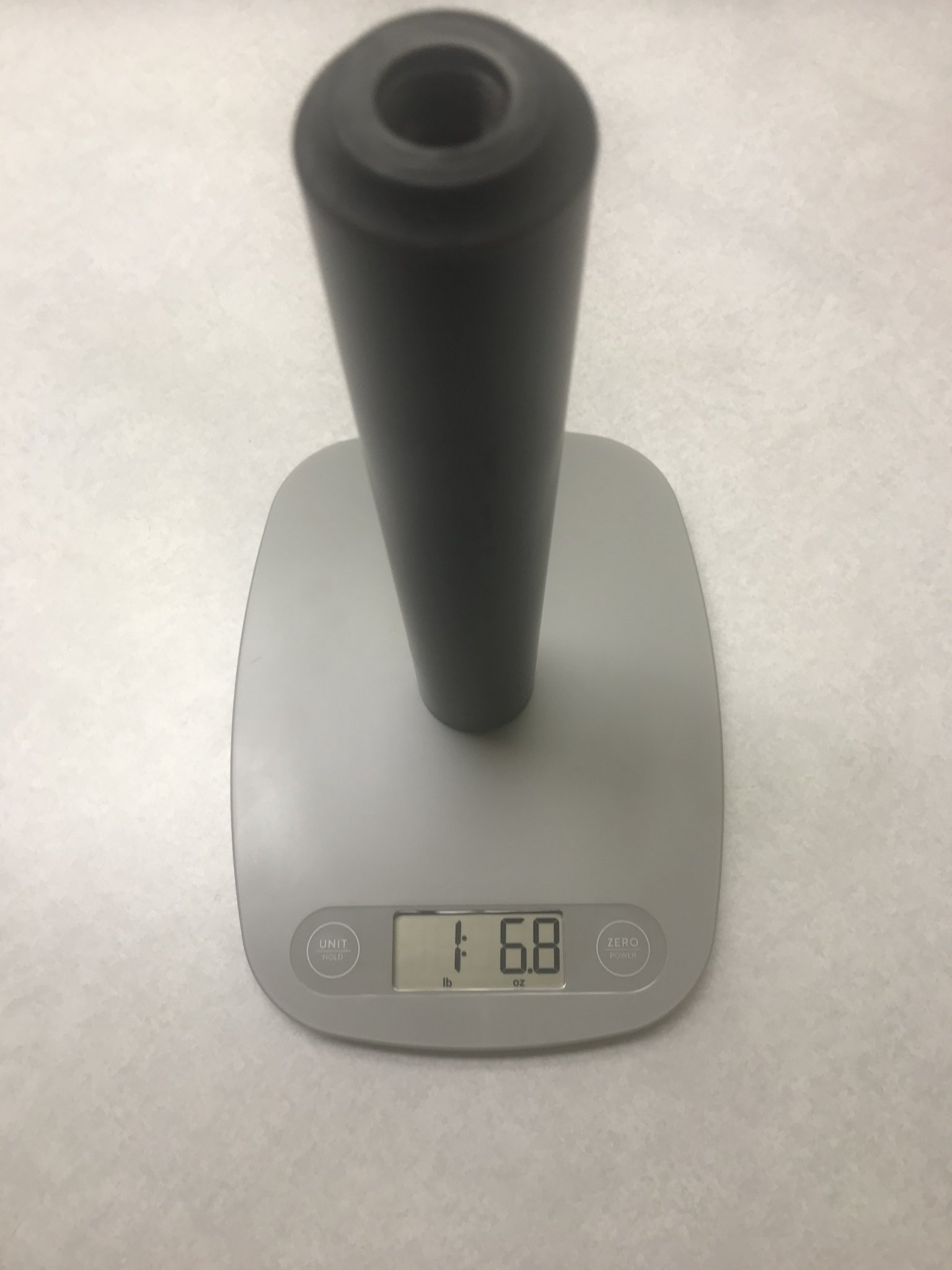

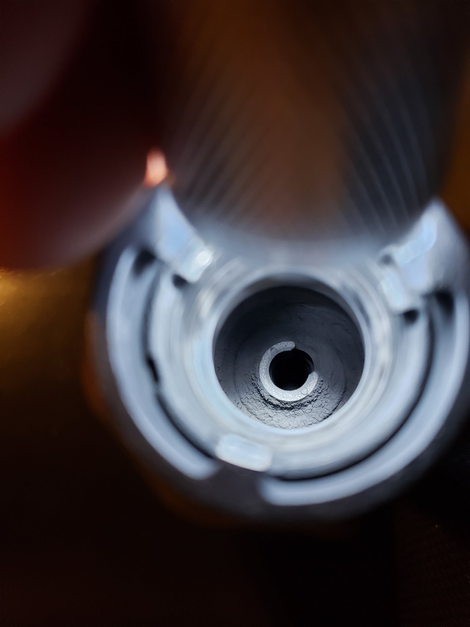

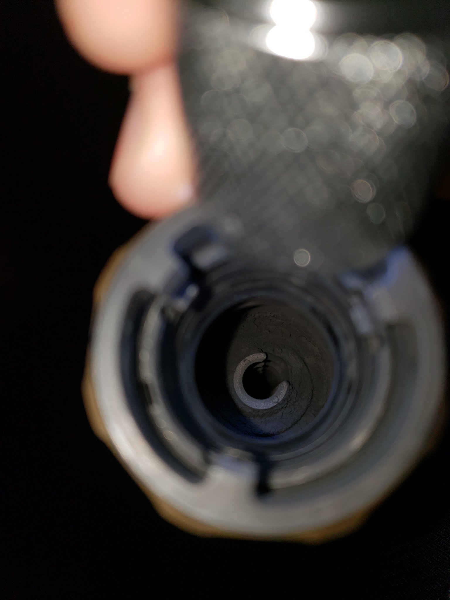

Ok, so I think I’m finally done. Here is the before and after pics. Got about 5oz out and think I’m done. According to the manufacturers weight, I still have maybe .5oz but tired of fucking with it and need to start shouting. Took it out the other day and defiantly noticed the sound difference. I think I’ll just start doing this every year over winter break just to maintain it.

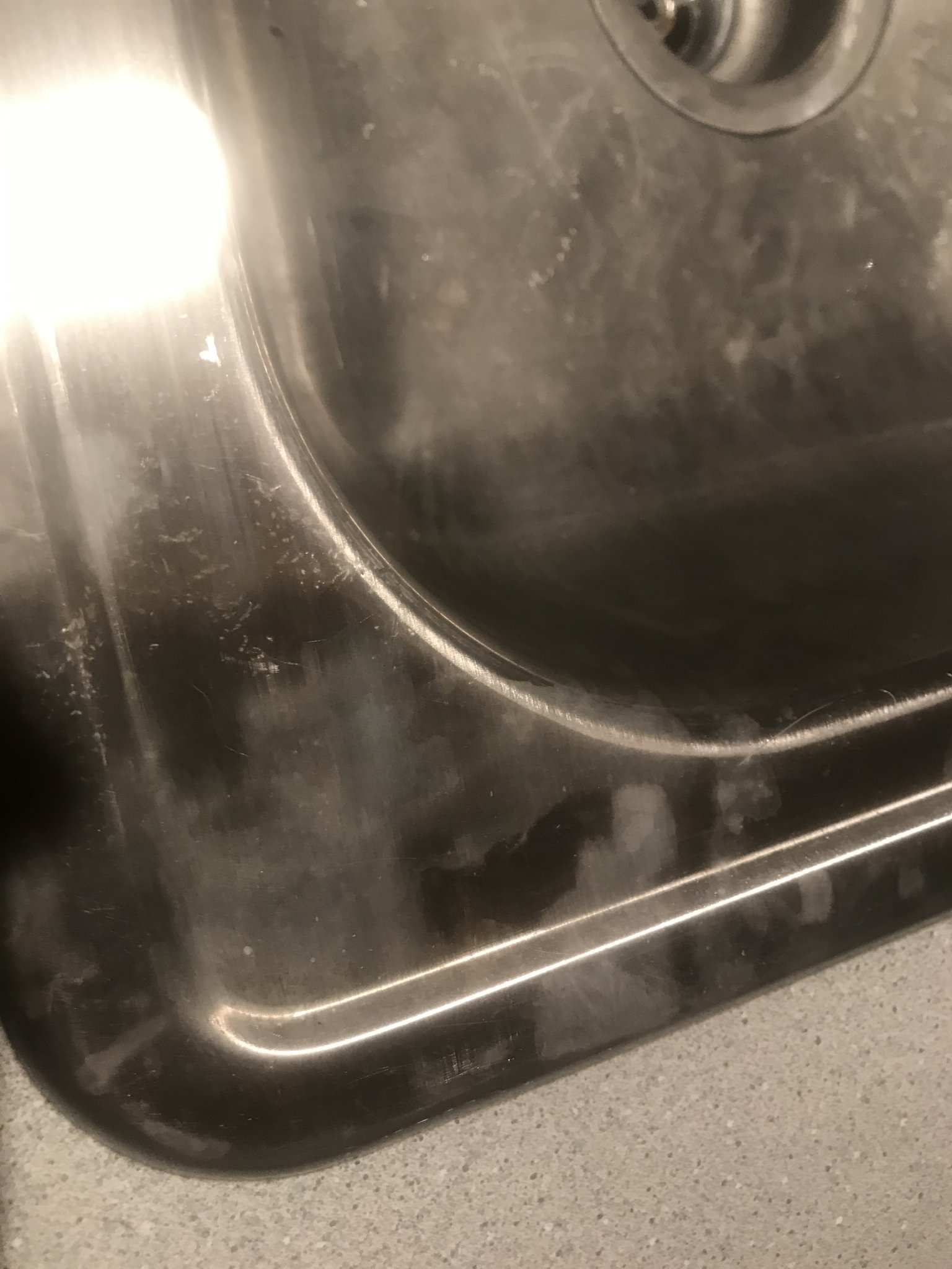

side note, really ducked up my stainless steel sink, see last picture. There’s almost like bleach spots or some discolored marks on there. Any idea how to get them out?
Glad you got it done. What a pita!
As to your stainless steel sink, get some Barkeepers Friend. Works wonders on stainless. Also works amazing on copper bottom pots, brass, enameled pans, showers, and coffee pots.
