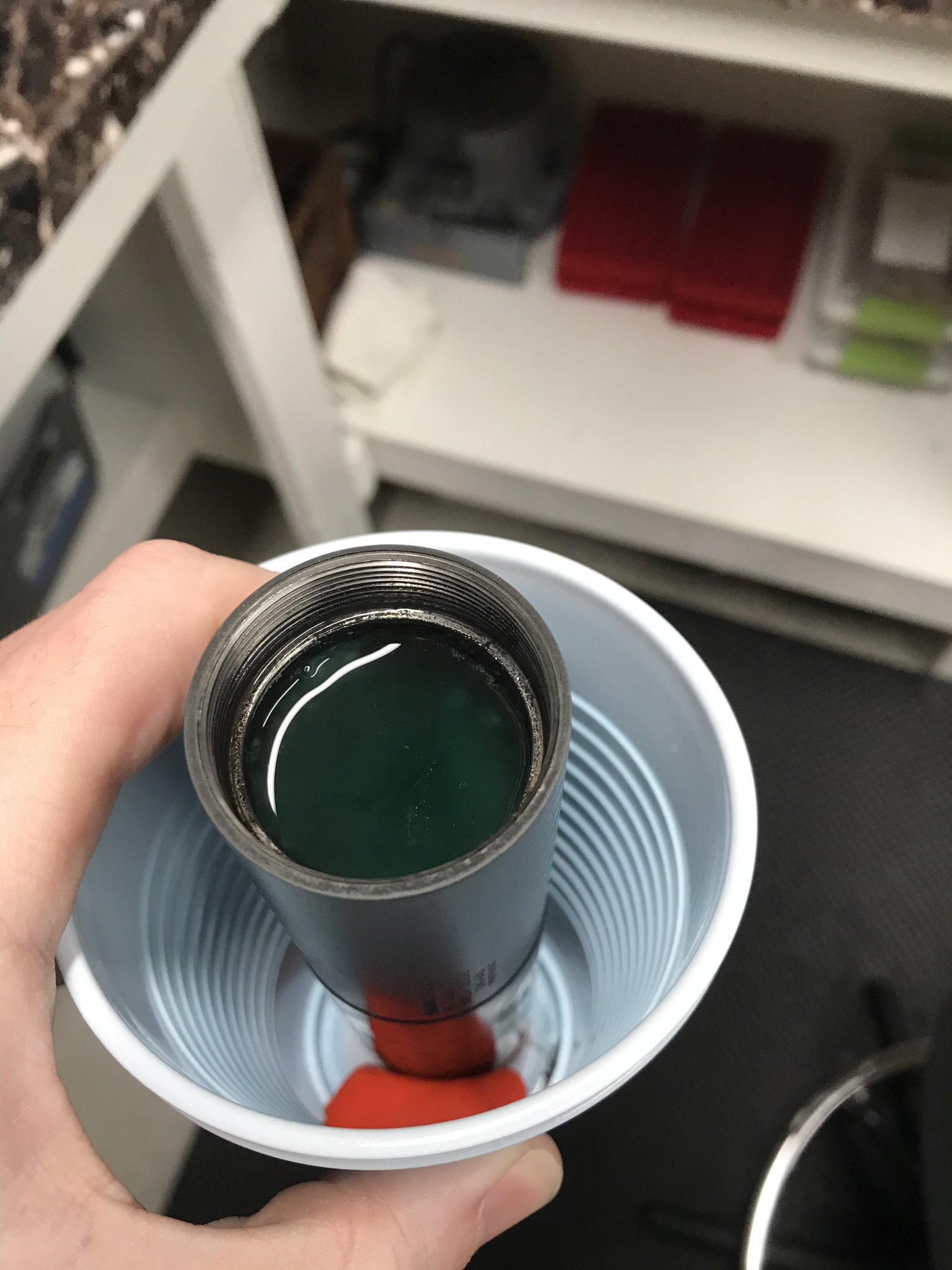

I found some rubber corks at Home Depot when I was getting the CLR so should be good.

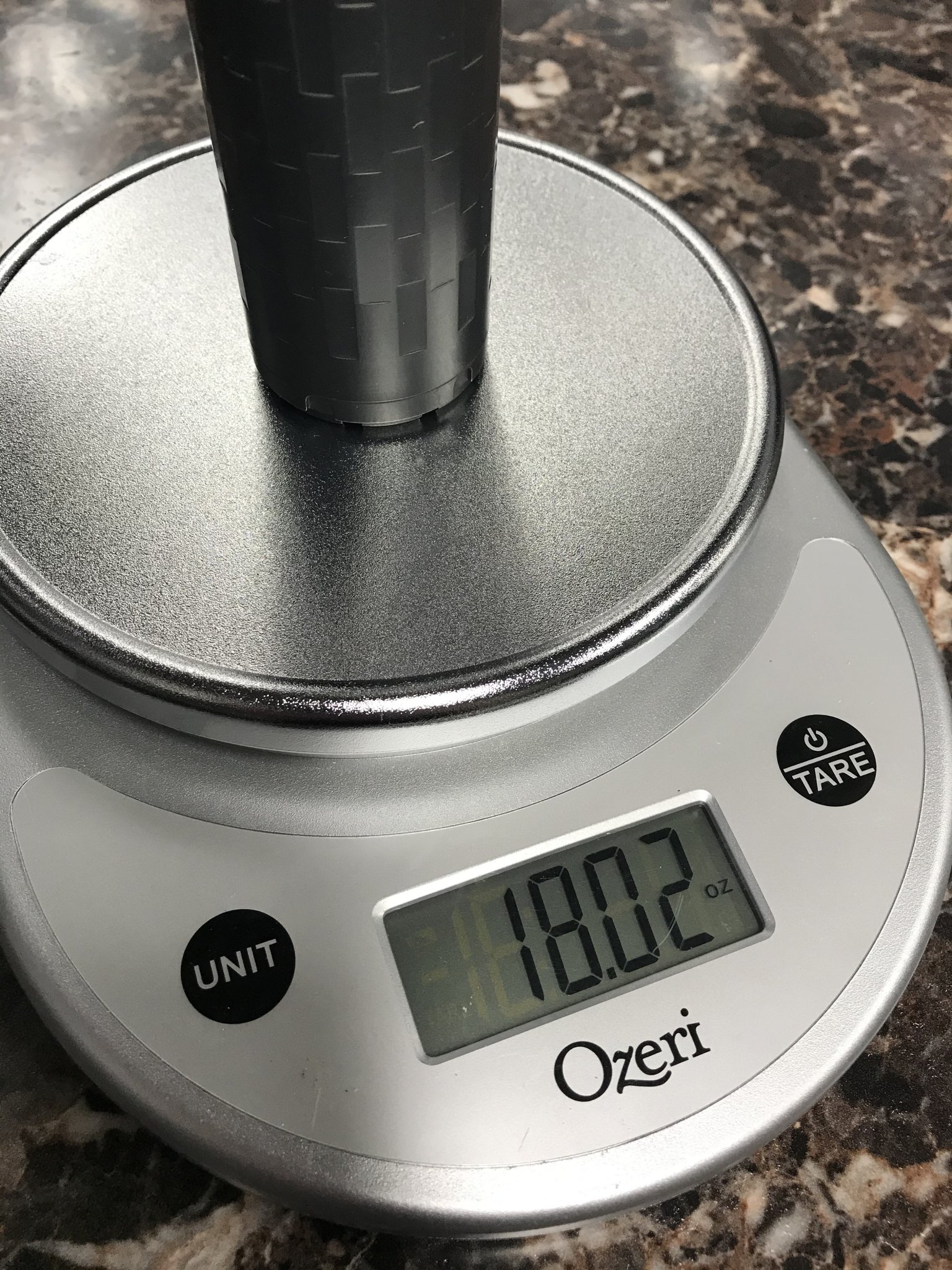

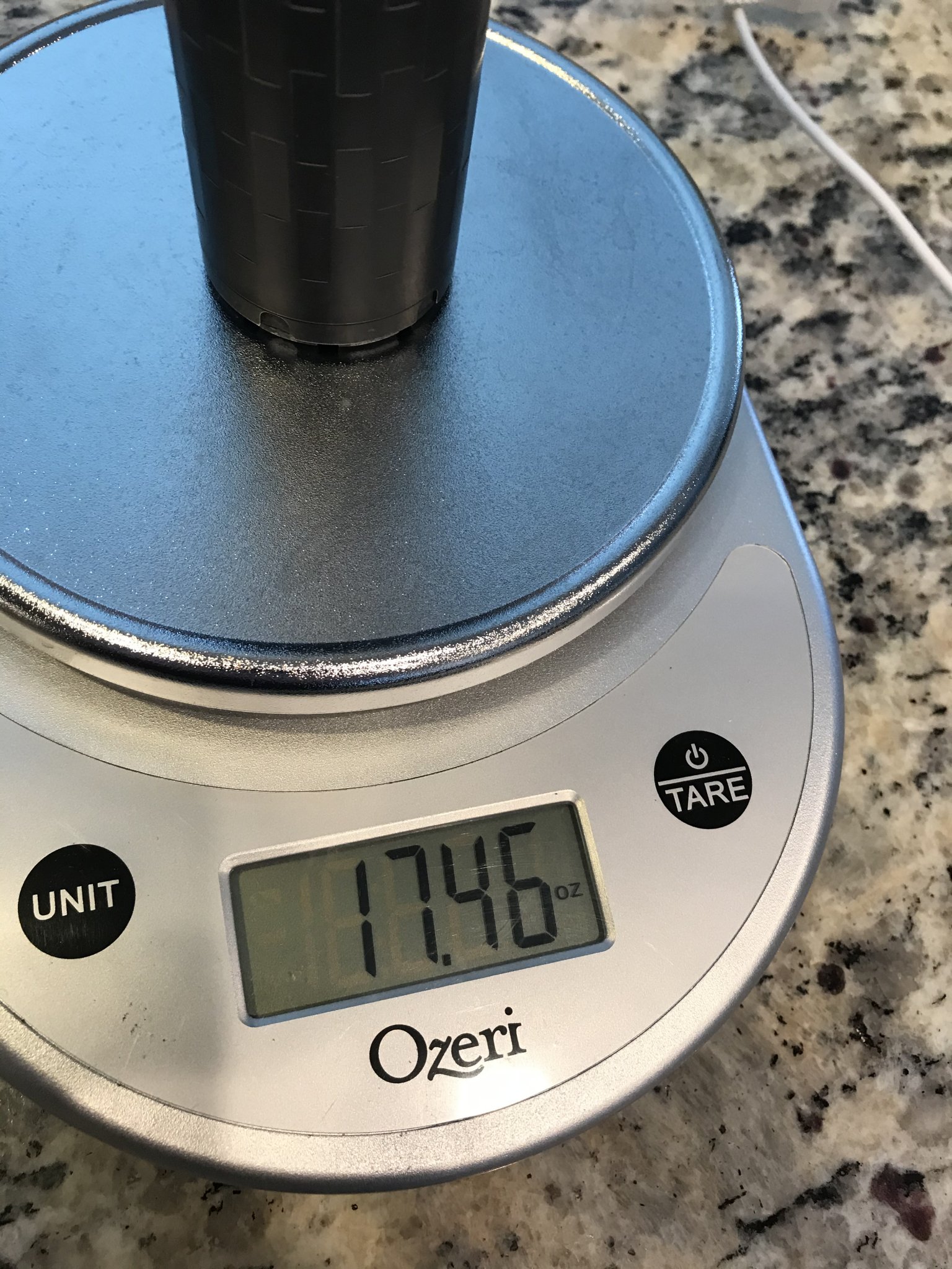

In it goes. 18.02 oz ( thought it was 5oz over but it has been a while since last weighing it). Was a hair over 14oz new.

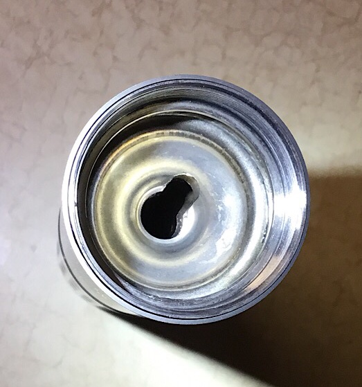

I’ll see what can be scrapped off in 24 hours and decide to let if to let it sit longer. Pics of the last chamber before end cap brake. Cannot get the back as its seized.
UPDATE : 20 hours in... its loosening up, but this might take a few days. I dumped what was currently in there and add more. Came out looking like Windex.

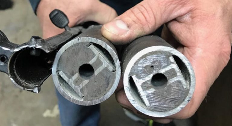

You guys might be interested in this thread: https://www.snipershide.com/shootin...r-serviceable-center-fire-suppressors.6962443
It's an updated list of user-serviceable centerfire suppressors for rifle/pistols.
Please let me know of any others.

I just ordered some Bortech c4 from Amazon will be here Sunday. Let mine soak for about 18 hours with CLR in it and stuff defiantly came out but not a lot. Currently soaking in simple green bow over night and then may do another round of CLR after this tomorrow.
According to what TBAC told me, it could take weeks of 24 hour cycles in CLR to completely remove 4 oz of carbon. Nothing will cause it to come out in couple of days.
I was not able to get my Lane disassembled after four 24 hour cycles in CLR.

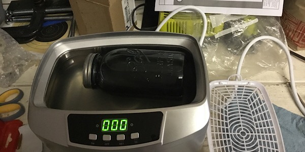

Really guys, the answer for cleaning your sealed can quicker is really an ultrasonic cleaner. Now, I realize that Harbor Freight is cheap Chinese crap, but I have been using this USC successfully for a couple years now. It really shortens the cleaning process. I only use it with the simple green as CLR in a Stainless USC is not a good idea, but it works. Here’s the one I use. It’s plenty big enough for most any can for $80. Plus you can get a 20% off coupon most anywhere, making it less than $70.

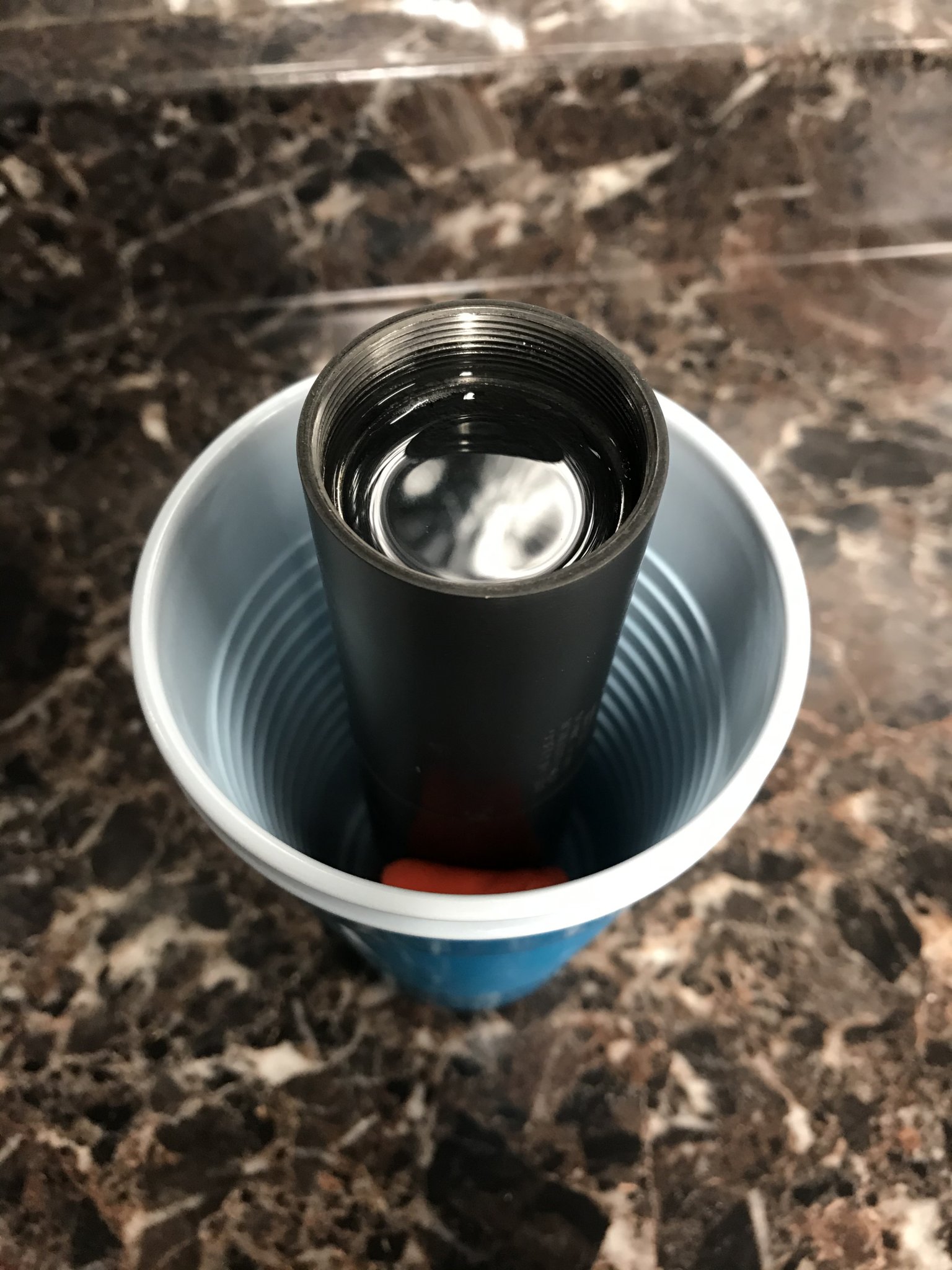

It’s what the manufacturer recommends (TBAC) but I’ve been told to only soak the inside of the can and not to submerge the whole thing in it as it may take off some of the bluing. ?‍♂️
I imagine the same principal would be fine for the omega. Oddly enough I have probably twice as many rounds down one of my omegas as I do my TBAC but it still fairly light on carbon. I’m guessing because I have it strictly on my AR’s and run them a lot. ?‍♂️

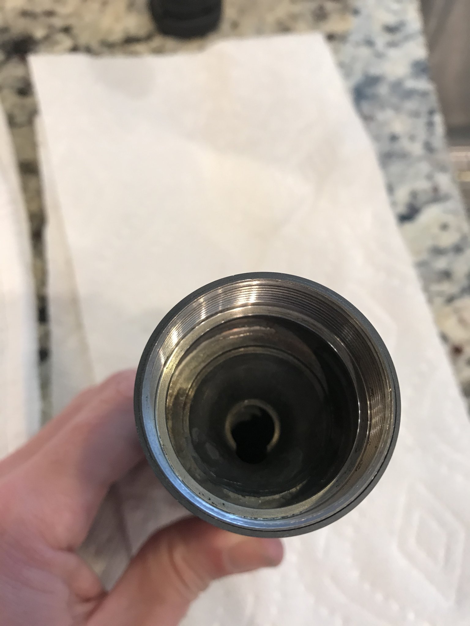

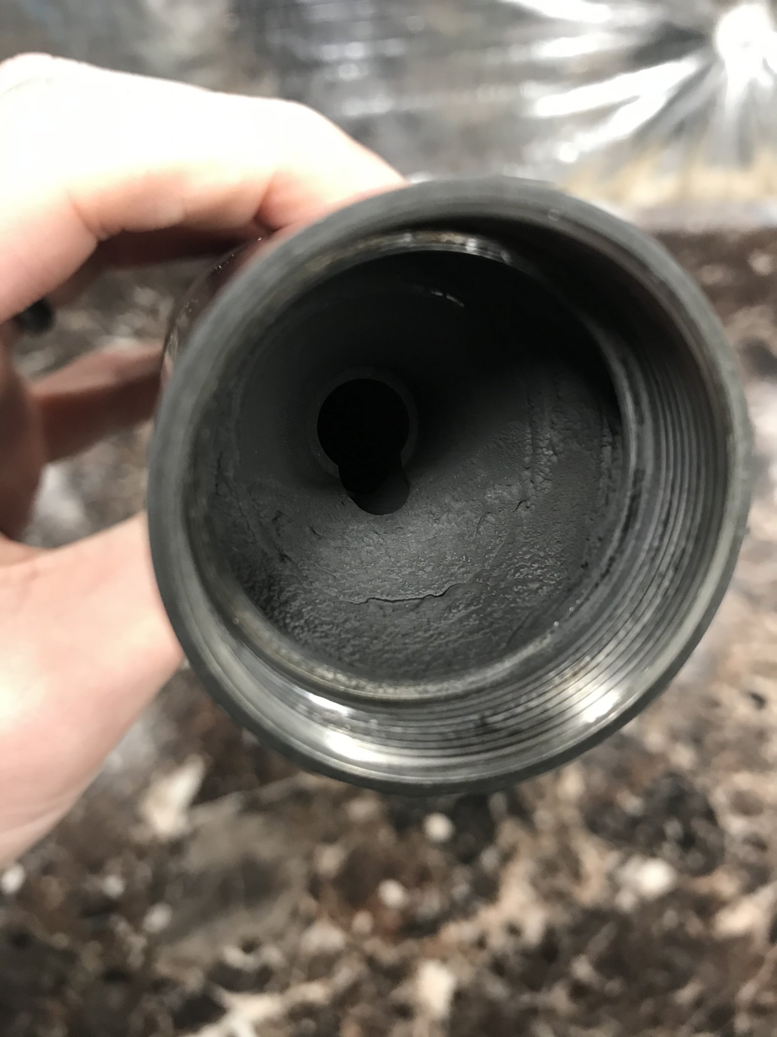

So, 64 hours into the soak, I decided to pull it and see what I could get out. I was able to remove the mount with ease now and it was caked! The soak really helped loosen a lot up, but I can say this needs a good 5-6 days to really break it down. I got a lot out with a pick and screw driver. Some big chunks just fell off.
What did all of this get me in reduction? About 1/2 and oz. So, again, this needs almost a week to penetrate deep ( thats what she said ). For now, it’s cleaner. I’m going to wait and see what BoreTech releases with their suppressor cleaner and go from there.
Rinsed at the sink, wiped out and hit it with my air compressor.
I’ve been using a jar of mineral spirits with the can inside and throwing that into the ultra sonic cleaner. There is definitely carbon coming off as you can see it floating around in the jar. Not huge chunks but more like tiny particles. I plan on doing this all day today before my Boretech shows up tomorrow.

For those using the ultrasonic and jar other secondary container, I noticed I get much better cavitation and carbon removal by putting the jar right in the tub without the plastic tray. After 2 runs doing this the mineral spirits is black now, I cant see the suppressor anymore.

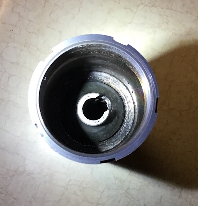

This is the set up I’m using.
The suppressor is in the jar and the jar is filled with mineral spirits. The bath is just just filled with cold water to keep the temperature of the mineral spirits down.

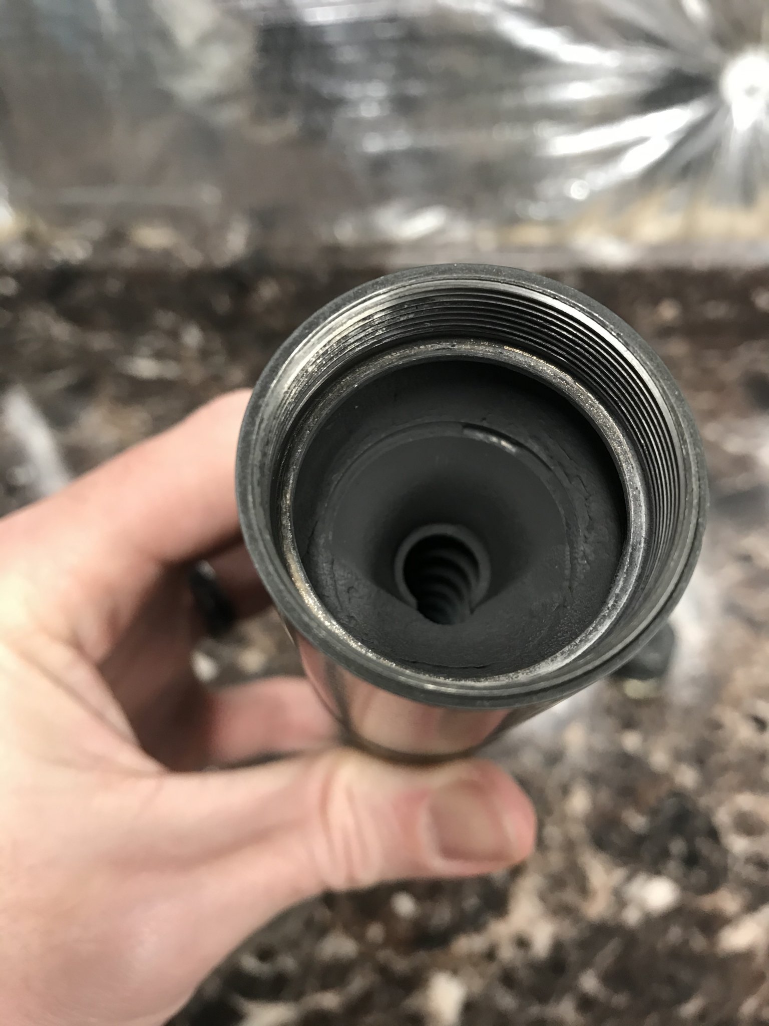

It’s done a pretty good job with the last baffle. I should note that I am using a pick and a dremel with a steel brush to go at what I can access. It is breaking the carbon up on the last baffle pretty well, the blast baffle, not so much.
The blast baffle and chamber is really caked up. The carbon is over 0.125" thick on the baffle. As far as finish goes, the mineral spirits has done absolutely nothing to the finish. This is a good start IMO. I’ll see what the C4 does after soaking that blast chamber for a couple days.
It’s done a pretty good job with the last baffle, the blast baffle, not so much.

Sorry I didn't mention in my post that I'm going over the can with both a pick and dremel with a steel brush. Not a ton of elbow grease, but not zero either. I edited my post to reflect that. But before starting the steel brush or pick didn't do crap. The mineral spirits in the ultrasonic is making it way easier for the pick and brush to break the carbon up.

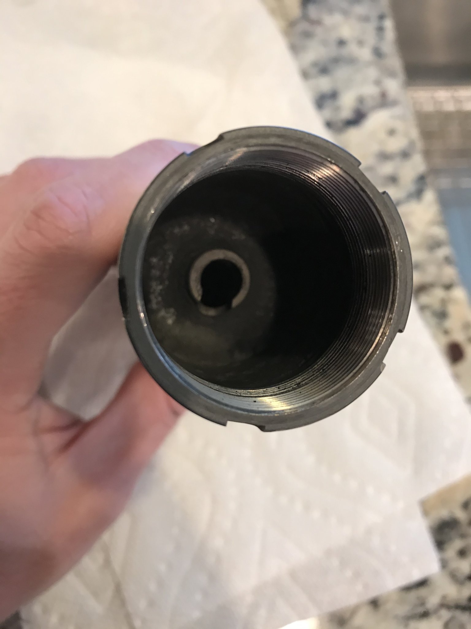

UPDATE: so I’ve been at this for a little over 3 days. Have let it soak over night with CLR for a good 12 hours or so and then started using the ultra sonic cleaner on and off throughout the day. When I first weighed my TBAC it was 22.8oz which is 5.6oz over what it’s suppose to be of 17.2oz. As off today I’m down to 20.7oz so 2.1oz have been cleaned out. I guess if I’d had followed the 2-3oz over is when to clean, I’d be done now. ?‍♂️
