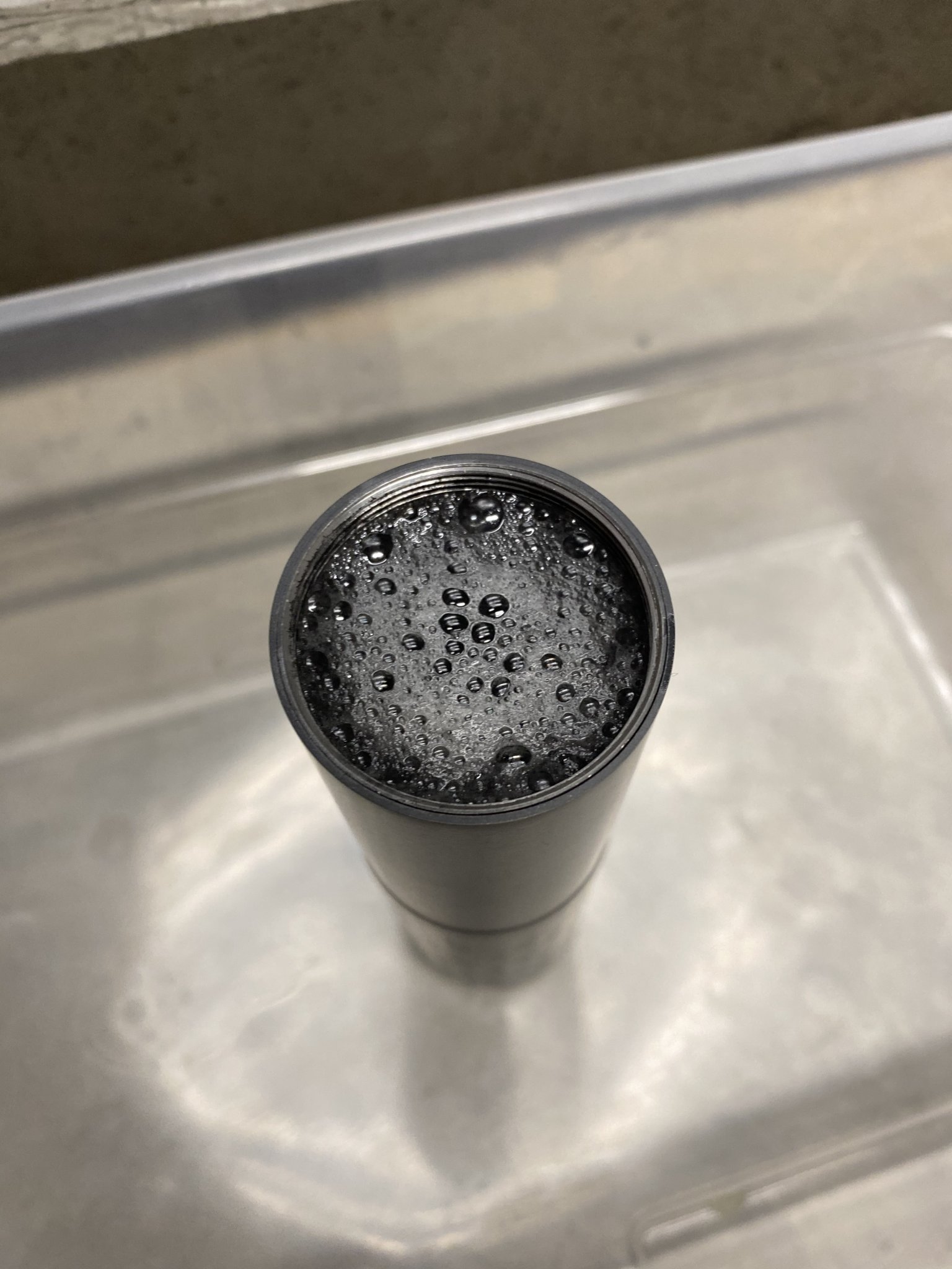

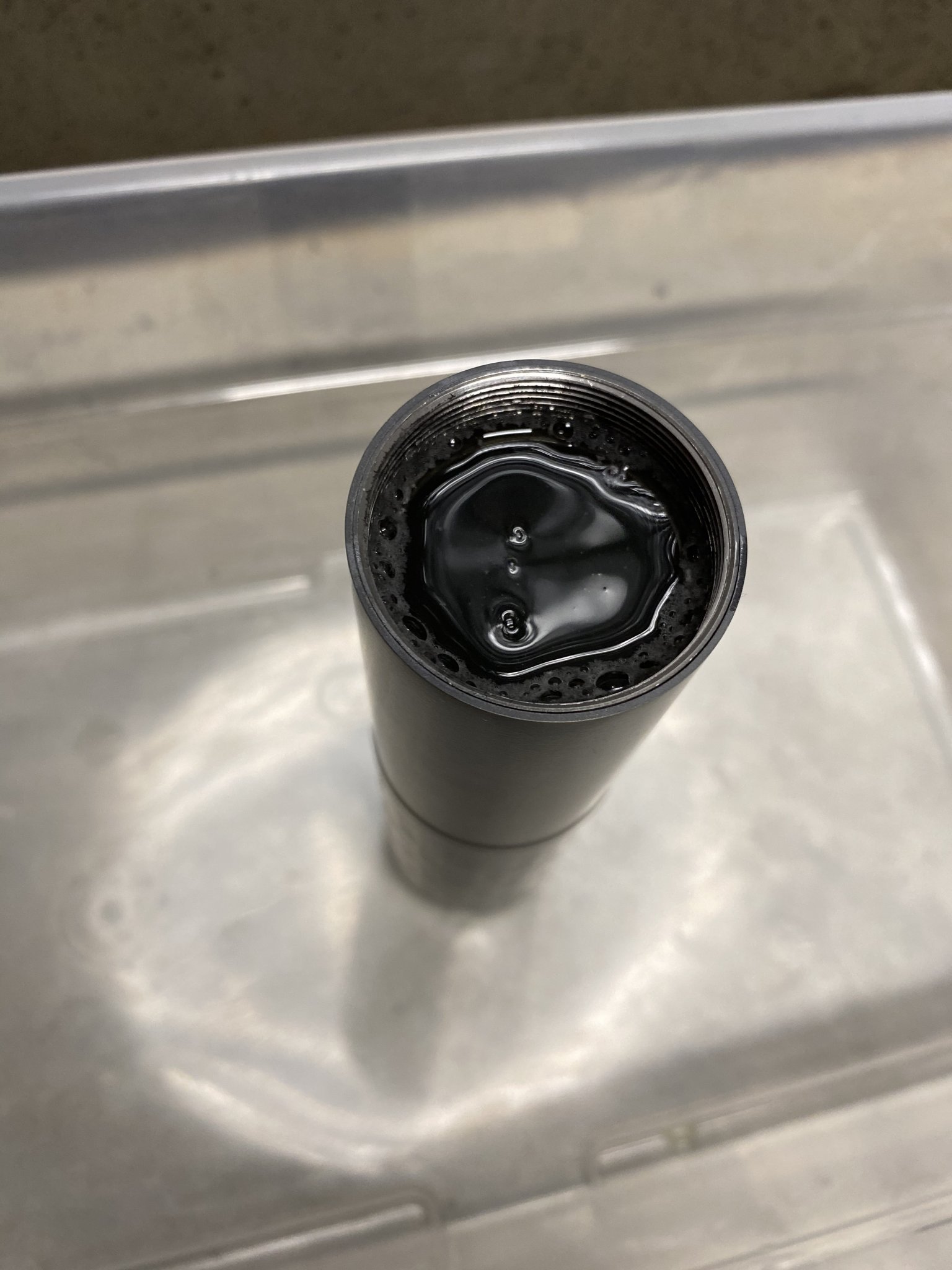

Yeah, mine is just soaking inside, outside un touched for now.
1 hour in...
Lots’O Bubbles

Really curious to see how this turns out for you, fingers crossed for you!
Is the suppressor just sitting in a plastic tupperware? What is keeping it from leaking out the bottom?
Worse case, I gotta still scrape crap out and my ultra sonic will be delivered next week. Best case, it looks brand new.
It’s plugged with Play-Doh at the threaded end and just poured the CLR in.

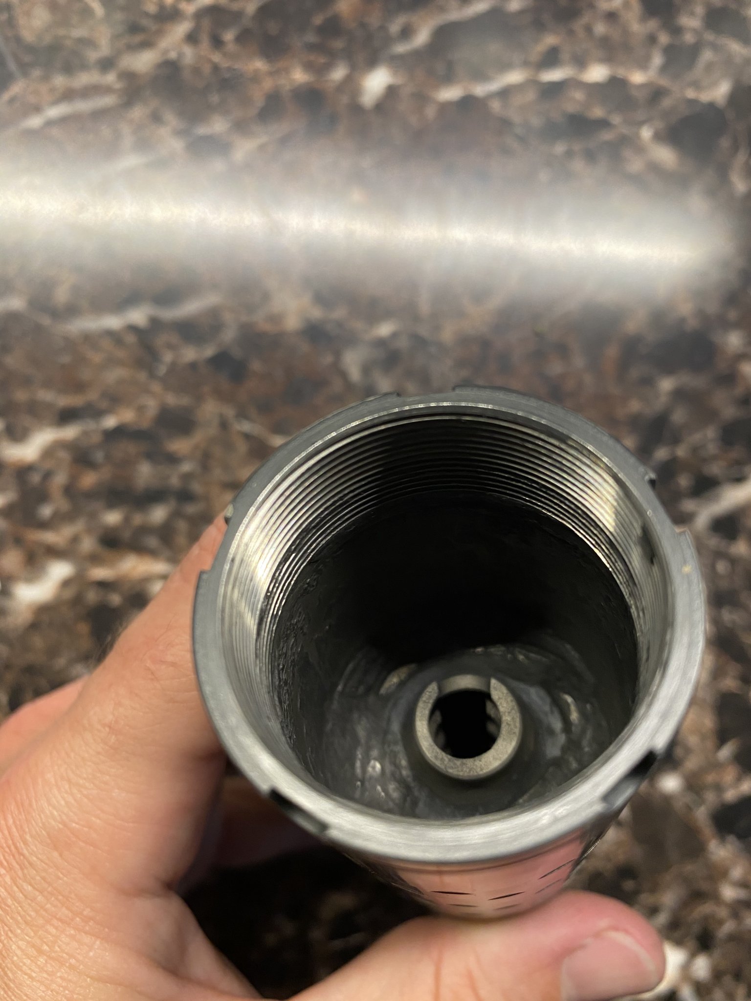

Pulled it after 2.5 hours of soaking. Rinsed with a hose and air dried with my compressor. This is going to take a lot more. Only shaved .10oz off. Some of it I cannot even take off with a flat head, its that caked.
Might do one more soak tomorrow with the CLR, then see what else I can scrape out. After that, Ill see what then BoreTech soak and ultra sonic can do.

Still 3.5oz over the factory weight. I don’t need spotless, but I would like to shave off another 2 oz, then test and see if its suppression is better. It has gotten louder.
FWIW, the water was dark and a ton of black specs came out with it, so its working... but after 5,000 rounds, its gonna take some time.

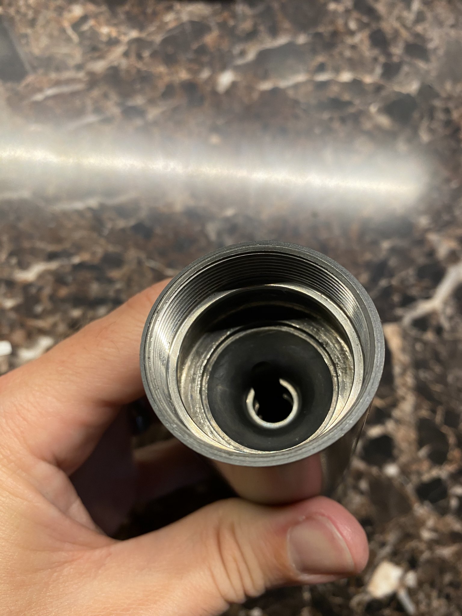

I took my Quiet Bore 5.56MM apart after a couple hundred rounds through it.
I spayed the Hoppes Elite solvent over everything and inside the tube. I worked on something else for several hours than wiped the excess crud off with paper towels.
That took a lot off but there was still a thin layer of encrusted carbon on the metal surfaces.
So I sprayed the parts and a Scotch Brite pad and rubbed it all off except for some faint traces of fouling here and there. It wasn't shiny clean like it was brand new but sufficient enough to apply a thin coat of CLP and reassemble.
Total time to clean this by hand was probably an hour. Remember that I let the parts soak in the Hoppes Elite for several hours which I think does the bulk of the work.
The Scotch Brite pad is great at getting a lot of the encrusted carbon fouling off.

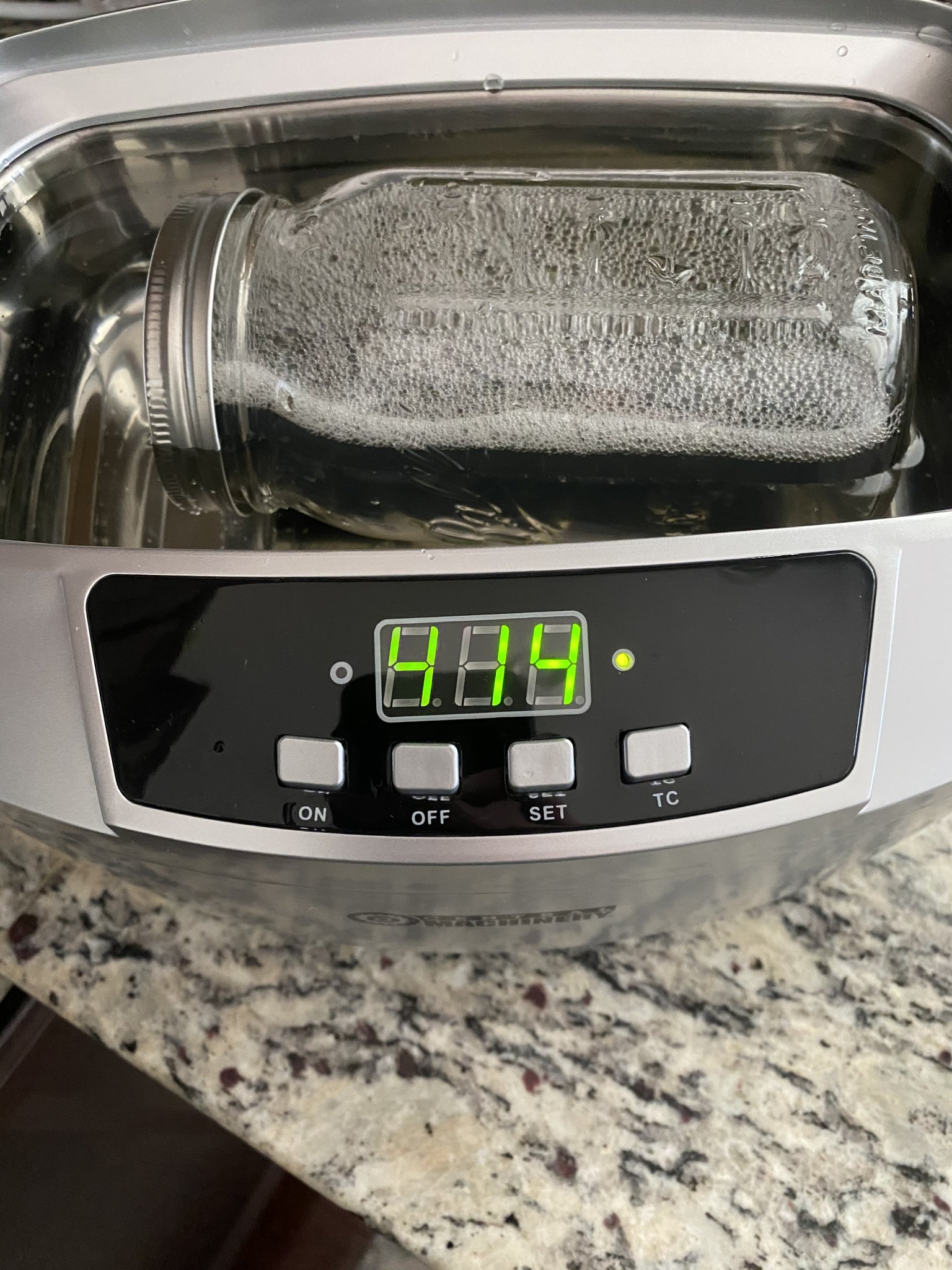

You saw from my posts in this thread, the ultra sonic cleaner and mineral spirits combined with C4, got my Omega as good as new.
My US arrives today. Doing this exact combo since your results were good. I've been trying to get the outer tube off my Omega, but this thing is not coming off. Perhaps the US will break it down finally, but at this point I could care less about the cerakote coming off.
Reactions: nikonNUT

Filled with 80% BoreTech C4, the rest water (in the jar).
Hard to tell from that picture, but if the jar is sitting on top of the transducers, you're not going to get much ultrasonic cleaning action. Additionally, the jar itself may dampen some of the action, even if not on a transducer. Pull that out of your ultrasonic cleaner, put a piece of foil in just the water in the cleaner, and run it. It should eat through the foil (no need to let it finish, just look for little holes to form with it dipped in there). Repeat the experiment with a jar and water and foil. That's a good way to make sure you're not just spinning wheels. Normally there are little baskets with standoffs to prevent items from directly sitting on transducers, or overhead fixtures on larger units that allow suspending the item in the tank with wire.
Also, definitely used distilled, ultrasonic cleaners work through cavitation and the minerals in tap water make it less effective, in addition to all of the molecular/atomic interactions that mineral/contaminate binding prevents. Pre-warm the distilled water, and run a 10 minute cycle before cleaning something, that'll prepare you for the most efficient cleaning you can accomplish with a small/low power ultrasonic cleaner like that one appears to be. Every little bit helps!
