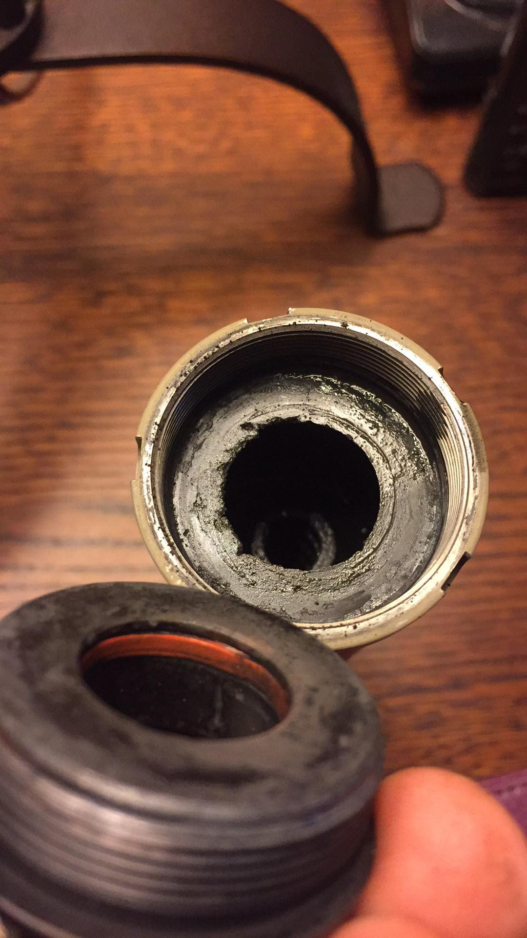

It looks like the outer sleeve has released. What caused that? Do yo think it was due to the engine cleaner? Mine released due to light use after about 2 years and SiCo reglued it for me.
I took the outer sleeve off before cleaning just to make sure it wouldn't get damaged. My sleeve has been loose fore a while. You just have to unscrew the suppressor off your barrel by the adapter and not the body.
Yes, sir. Mine got stuck on the ASR mount guten tight once and I tried cranking it off and it came loose pretty easily when trying to get max grip on the whole unit. This was even after a liberal use of nickel anti-seize on the threads and bearing surfaces. I asked SiCo if they'd send me back an extra wrench after the reglue, which they did, and now a stuck mount or can on mount should never be a problem again as one can use the two spanner wrenches and counter rotate them to break free what you need.
Was more curious if the top engine cleaner would harm the outer sleeve bond. But I suppose a guy could just fill up the inside of the can with it and not soak the whole thing.

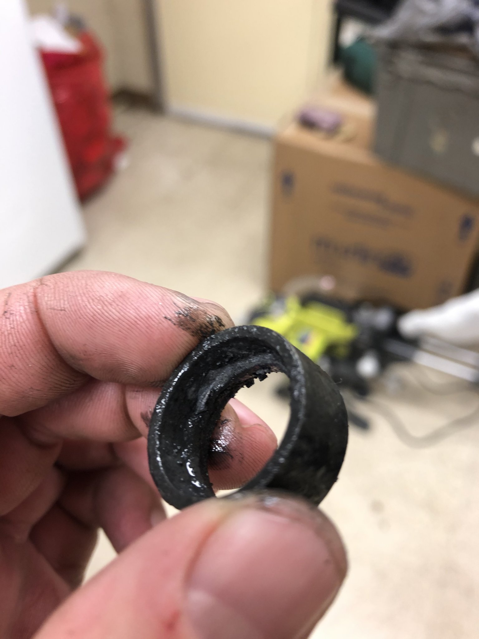

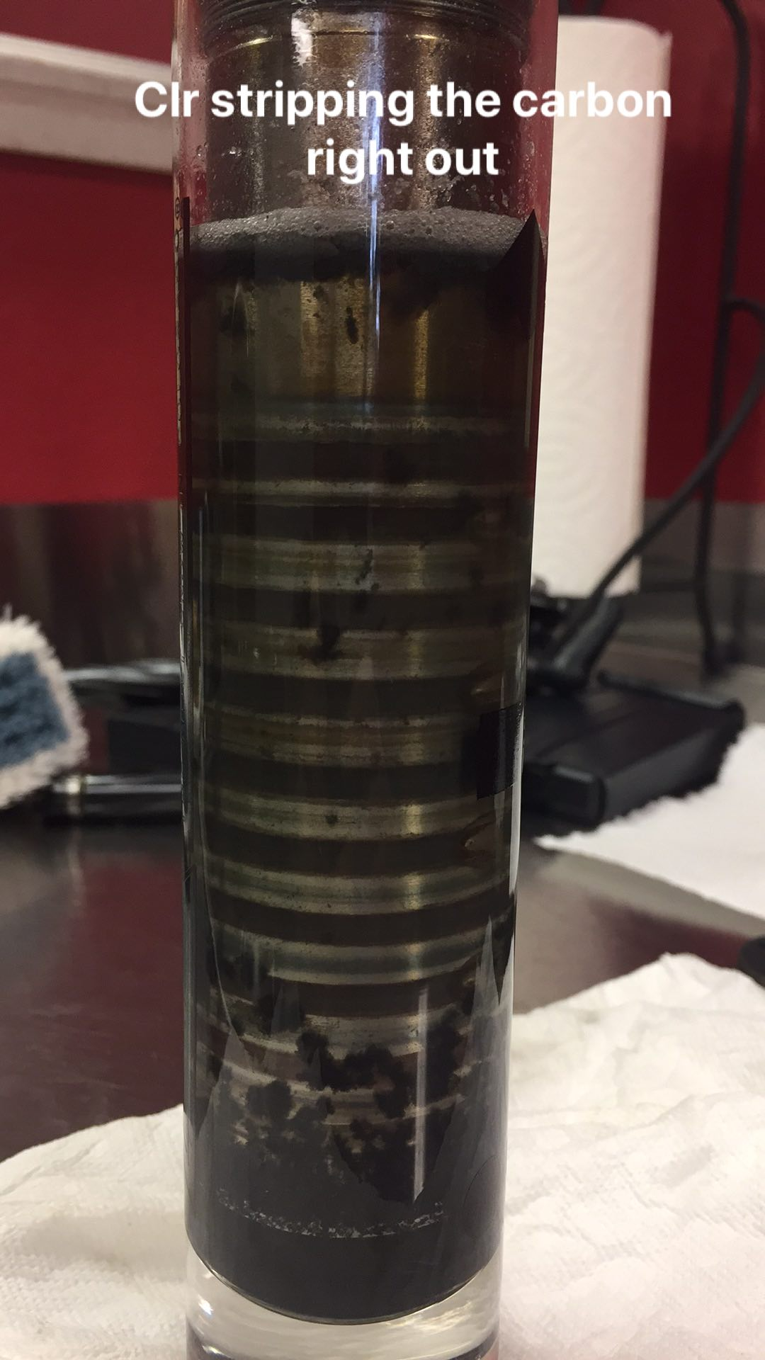

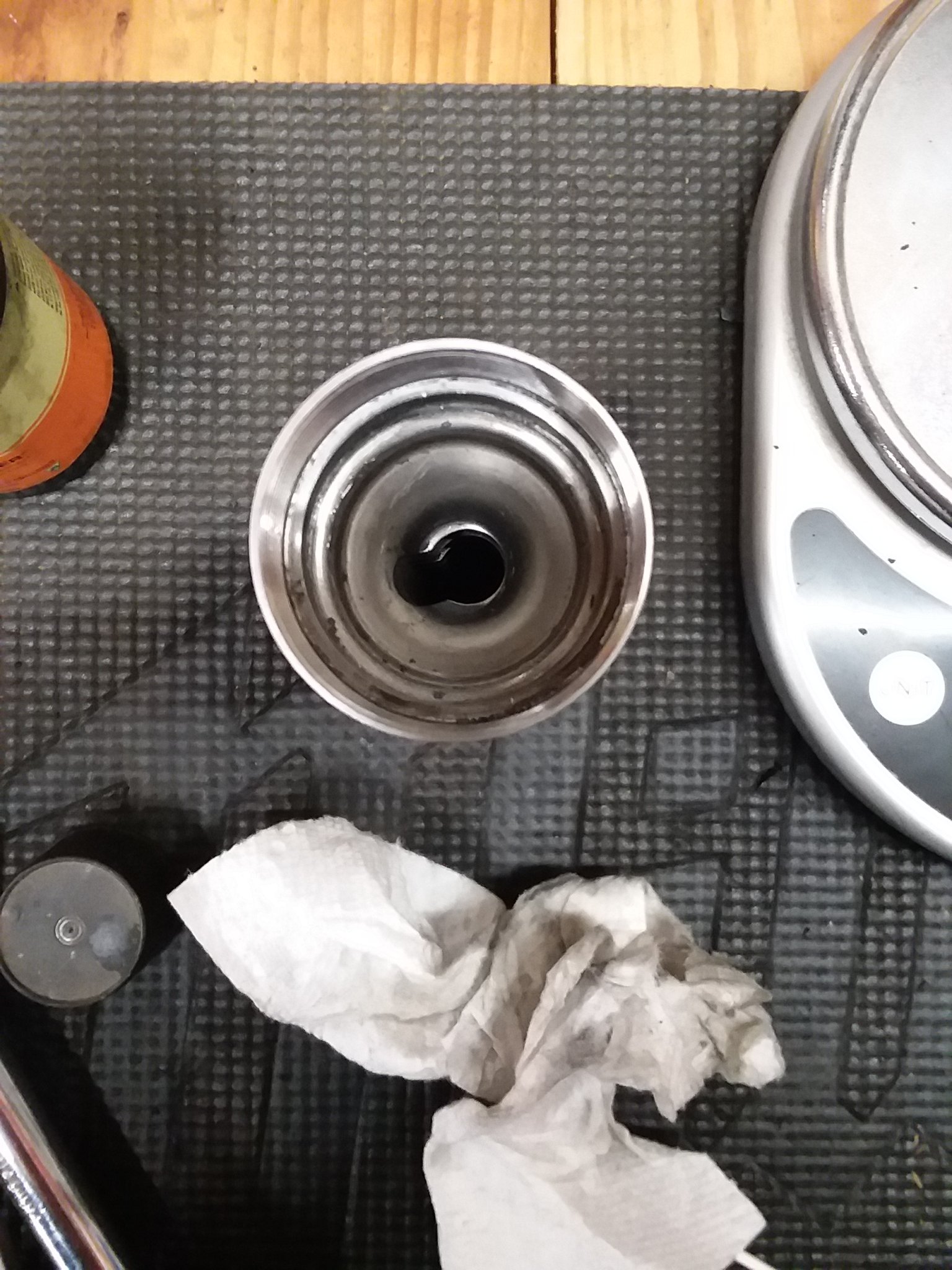

Ended up trying the CLR soak on my Omega over the last three days. Started at 442 grams and ended at 434 grams. With anchor brake and ASR mount, the manufacturer spec for the Omega is 14.8 ounces and where it's at now at 434 grams equals 15.3 ounces. It sure looks a lot nicer inside but 8 grams is not very much so I wonder where the other extra half ounce is? I did try 100 rounds of powder coated lead 300BLK bullets from Leatherhead Bullets through it at one time, weighing first and seeing if there was any lead being deposited, and that is where the weight gain came from according to my notes. But 225 grains of lead deposited in 100 rounds?? That seems unlikely. Seriously considering the 'dip' to dissolve any lead that may be in between the baffles but thinking about waiting until Boretech releases their suppressor cleaning product first. I'll give that a try before the 'dip'.

I would say you can do what I did and let it for a good week (boretech C4)

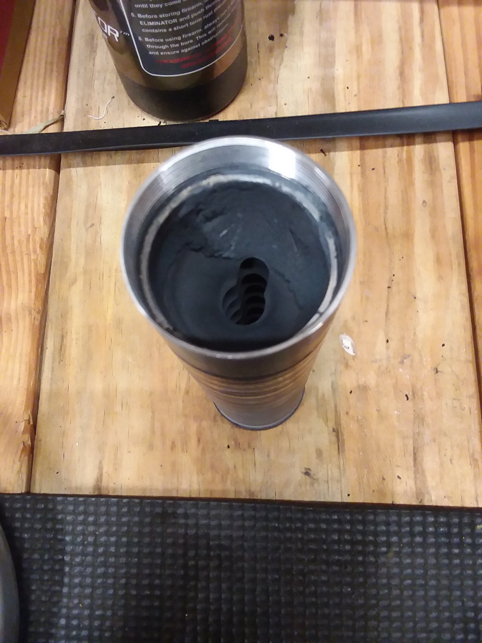

I cleaned it two weekends ago, forgot to weigh the stuff. D'oh!
Its low in that pic because when I first filled the thin whiskey glass that fit the can perfectly the thing started fizzing and foaming and it was bubbling over and going every where, thats how low I had to go pouring it out before it would stop overflowing, as it settled down I would add more to fill it all the way up.
You can see the shit that was bubbling up and out of it leaving the goop behind.
Take the back adapters loose frequently or youll damn near never get it off.

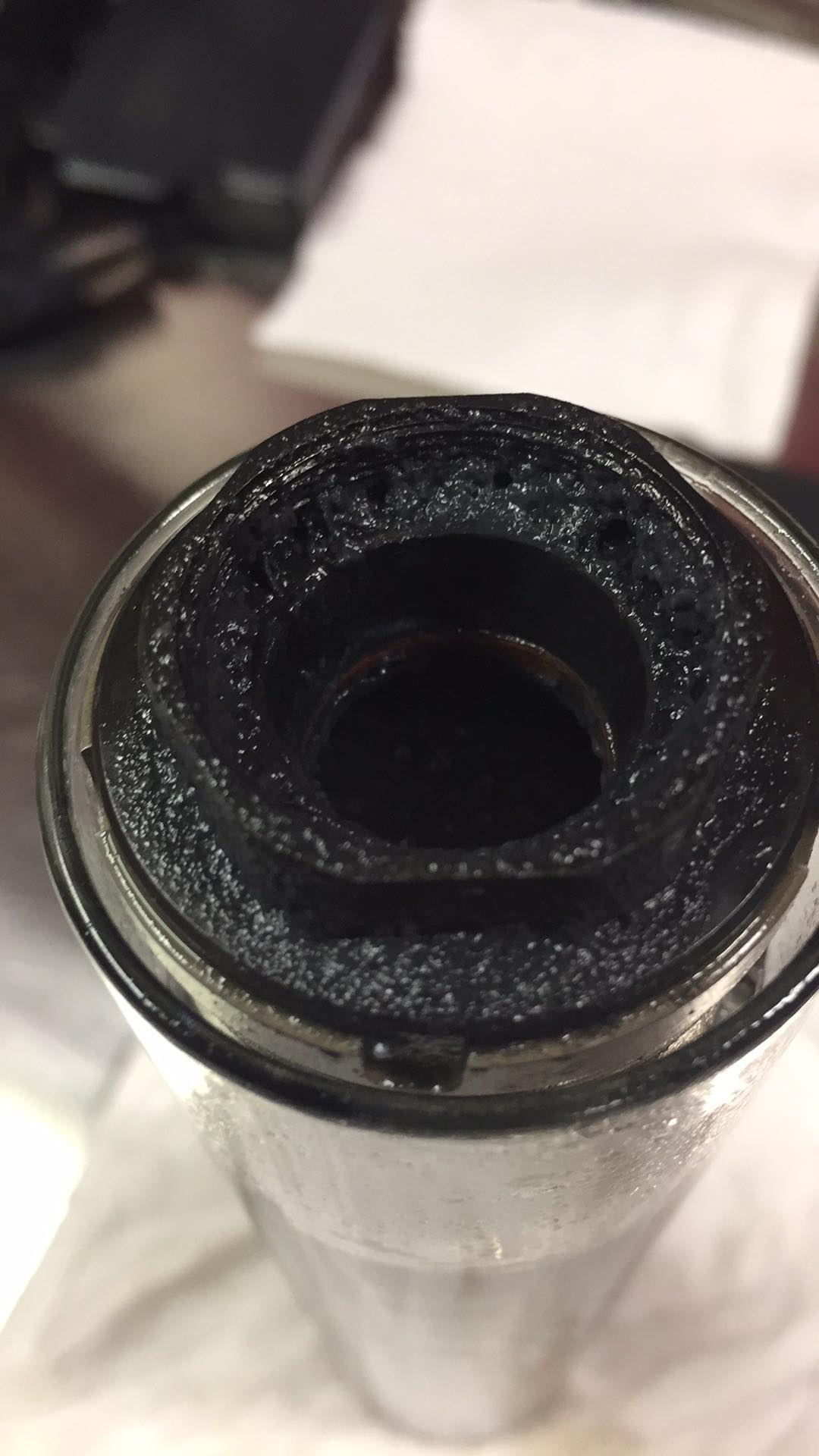

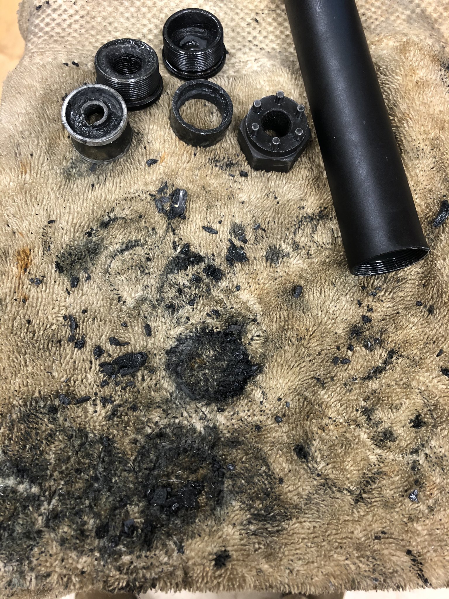

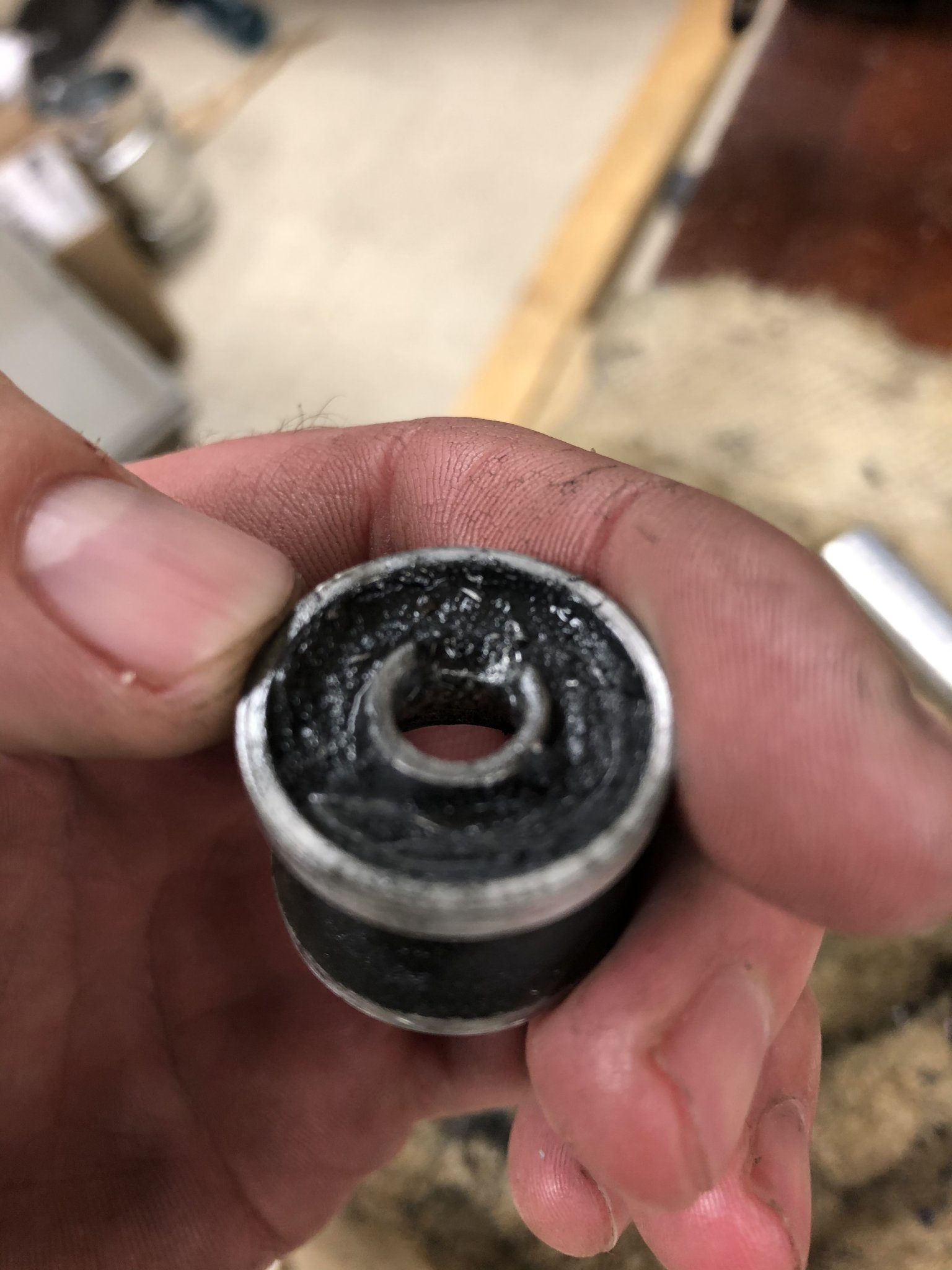

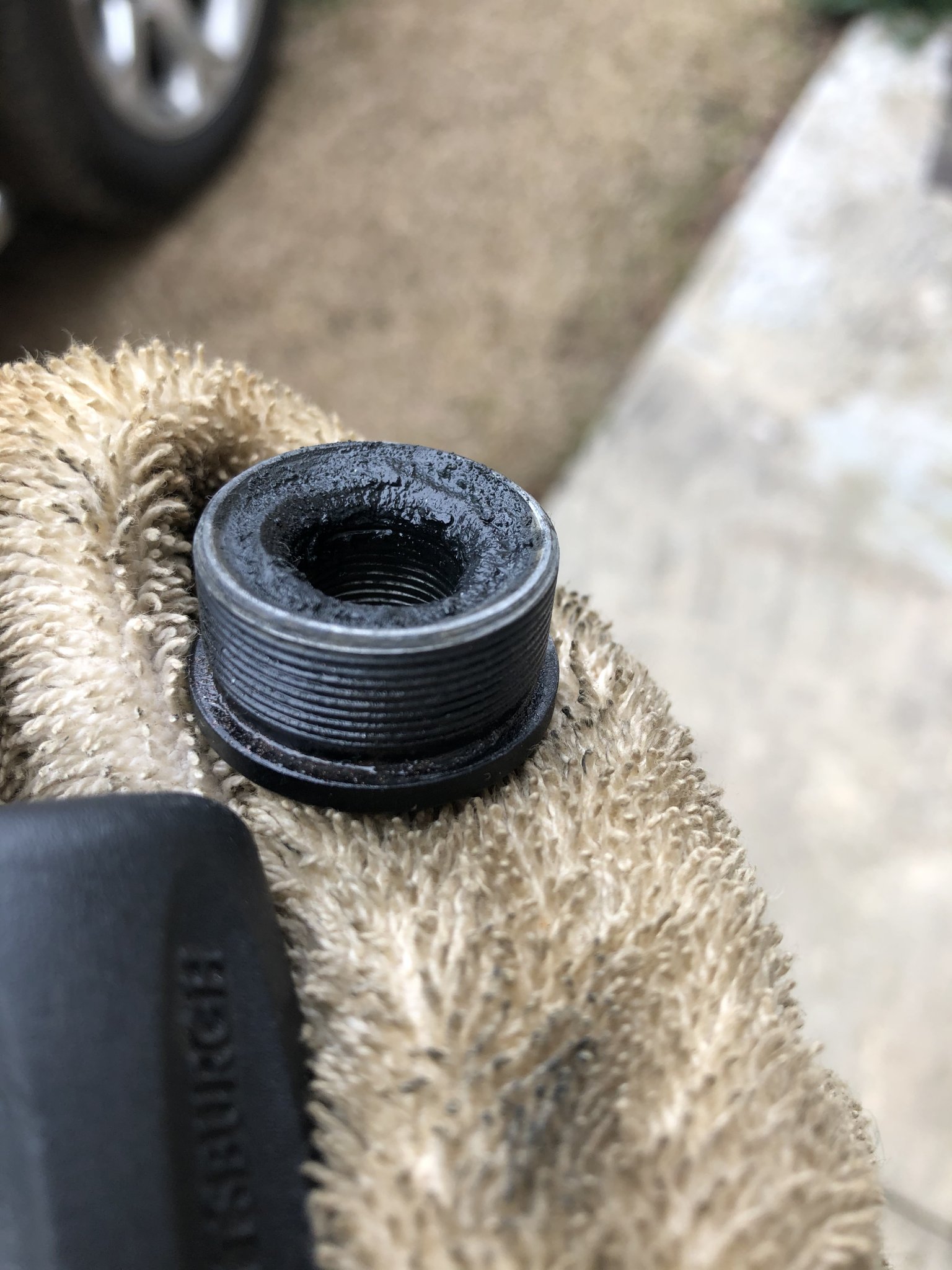

Should have taken before after pics of the insides too. I should do these projects when Im not in a hurry to do something else. After a soaking I took a screw driver and scrapped and popped off the carbon on the inside of the blast and end chambers, cant really get inside to touch any of the rest of it.

I used the mix once, soaked it for a week. Still had to clean it in the ultrasonic cleaner with simple green about 6 times afterwards to get the crap out.
Now, I just use CLR in the Ultrasonic cleaner a couple times, then rinse and use simple green in the USC for 4-5 more times. Takes one evening and does the same thing in my opinion.

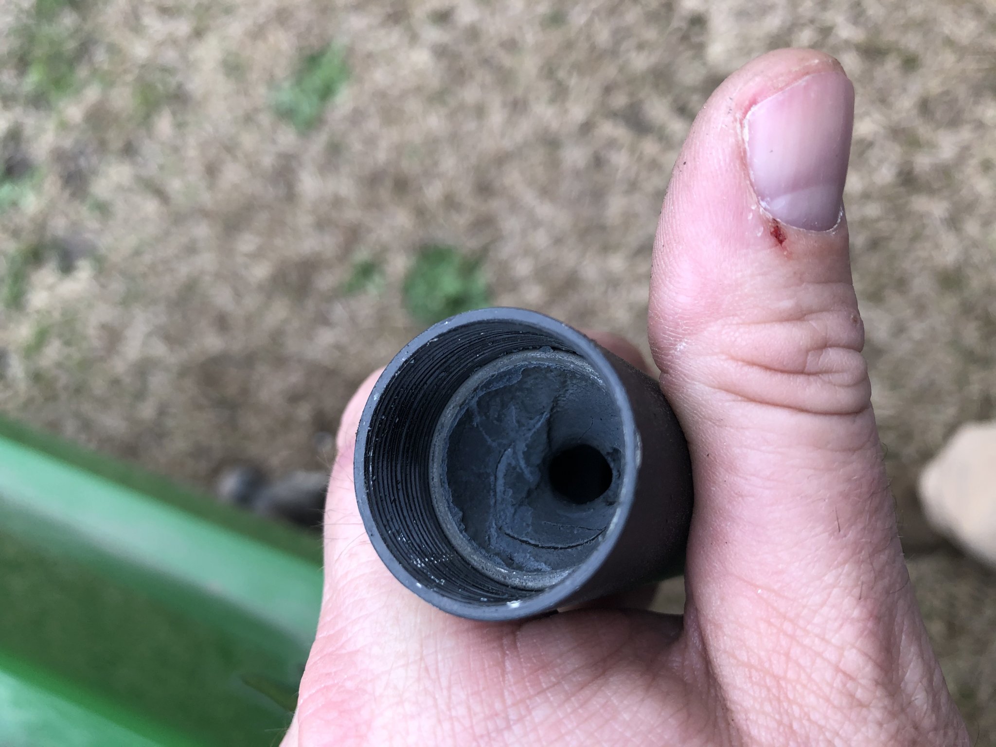

The rest of my cans can all be taken apart so I decided to clean them, too. I was easily able to take apart the two rimfire ones but the other two center fire (Lane) are a bugger. I've got them soaking in CLR now.
