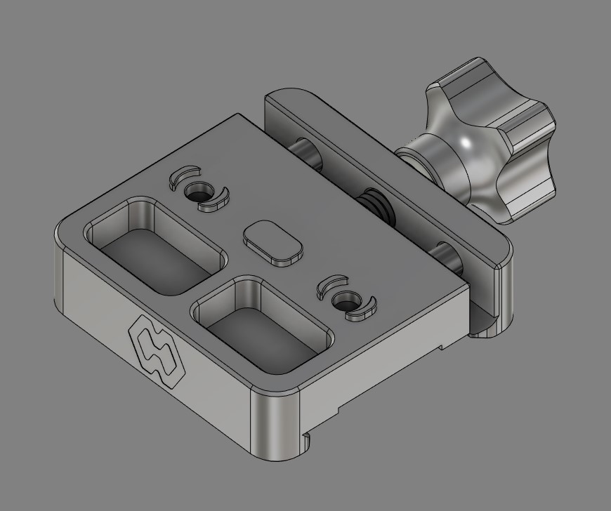

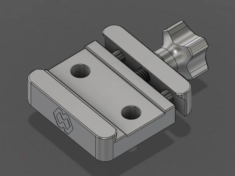

You mean something like this?
View attachment 7684590View attachment 7684593

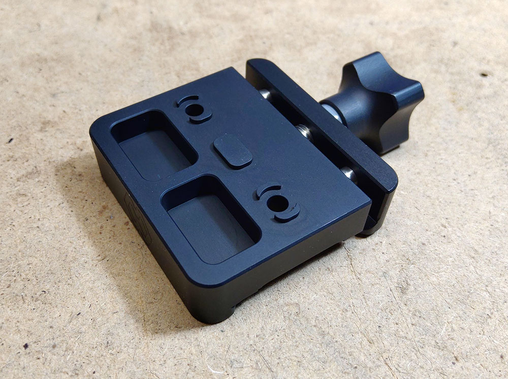

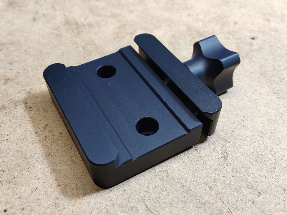

If I make a new main body it can be adapted for alternative M-LOK interface.
Yes exactly! If you make a run of them I'd probably buy 2-3. This would also allow people to easily mount ARCA-railed accessories onto a rifle with MLOK forend or similar. I understand these are a limited-demand item but I'm surprised someone isn't making these with the growing popularity of MLOK-slotted tripod platforms.
I'll make 10 with my next production run, will probably be a couple of months as I'm a small outfit but I see the merit in making these and would be interested in feedback in regards to functionality.
