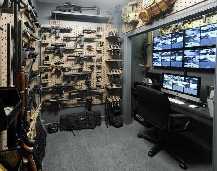

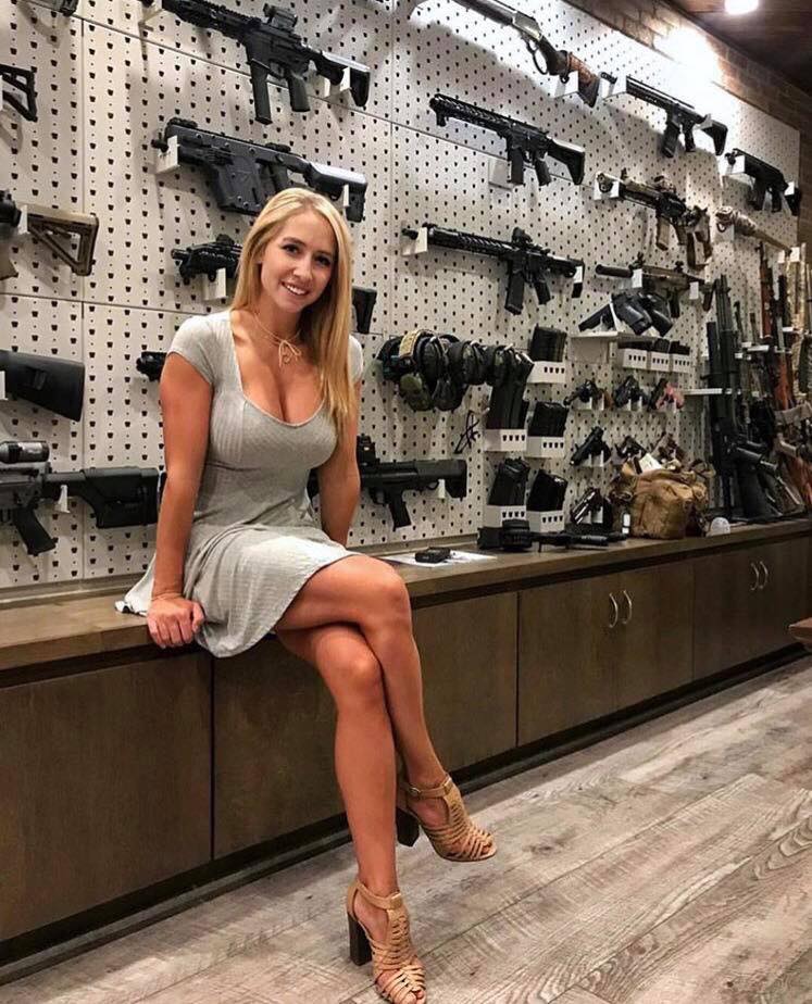

    Gallo’s tech has a great system. I really like the secure-it lockers as well for ammo and soft good storage. My stuff is a mess right now. Someday I’ll get my shit together.
    Agree on Gallow Tech. They did a cool mock-up for me when I couldn’t figure out which panels I needed. From there it was like playing with an erector set.
    I have the under stairs portion in the shop that is going to be converted to a safe, I'm glad i came across this thread and the Gallowtech gear. I was planning on horizontal racking as I'm limited on room width, and figured that would keep things closer to the wall.

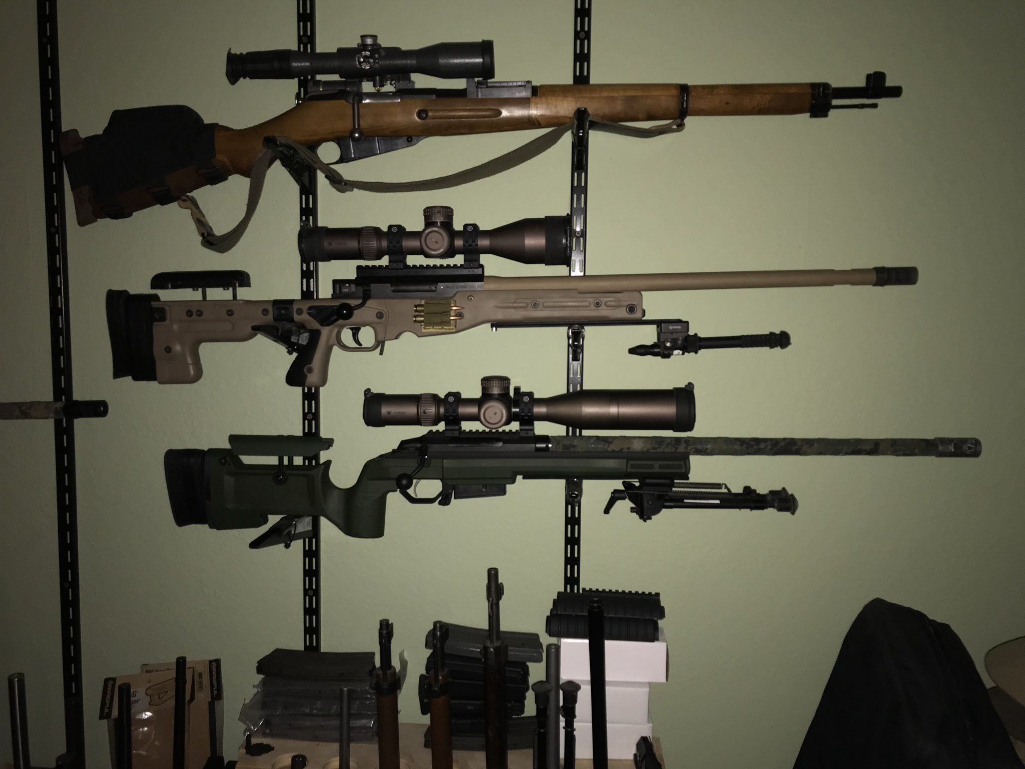

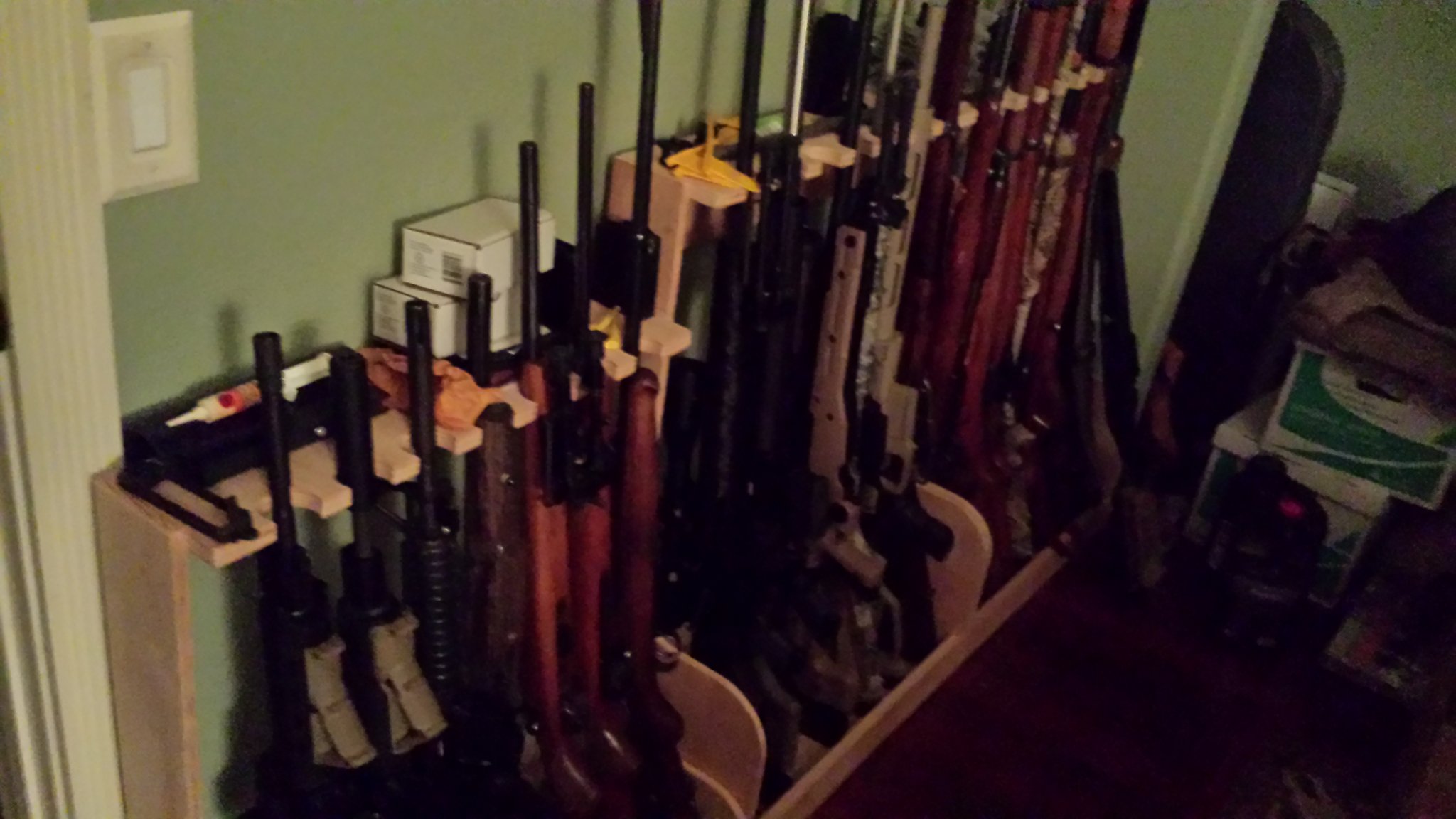

    I've found some simple vertical rifle racks can be made cheaply and stained (if desired) to help keep rifles somewhat orderly. (Sorry for the old, grainy picture.)
    For those rifles that get used regularly, then metal shelving mounts, screwed into the studs (18" apart here in the States IIRC), with shelving mounts that have clear vinyl, split tubing about the arms (to protect from scratches), makes for a convenient way to put some on the wall, utilizing the space above the vertical wall racks. I think everything in this picture cost me less than $200 and a weekend with a tablesaw, drill press, brad nailer and cordless drill.
