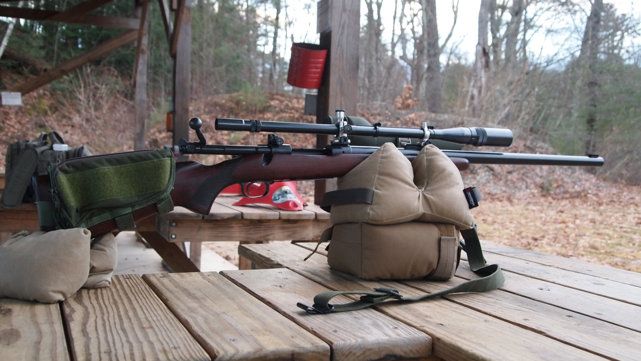

    I have a sweet Winchester M70 USMC sniper tribute in build.
    Im not looking to kick the bag in on the smith so lets not go there (yet).
    The rifle is beautifully finished and bedded. Its actually a great shooter in 30-06 but I had two problems with the barrel work.
    The barrel itself is a Douglas, .308, 1/10 premium grade. was sent to the builder as a blank to have the shank done, extractor cut and finish cut/crowning.

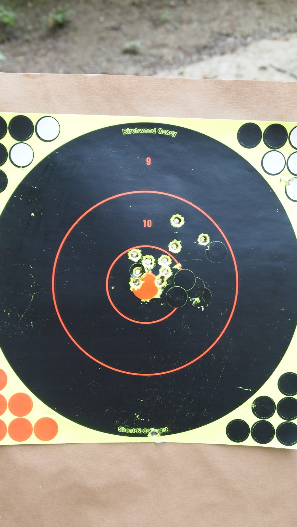

    As concerning as the crown is there is a "rip" in one of the lands just before the muzzle that would have to cause some issues..........yet this thing shot pretty good.

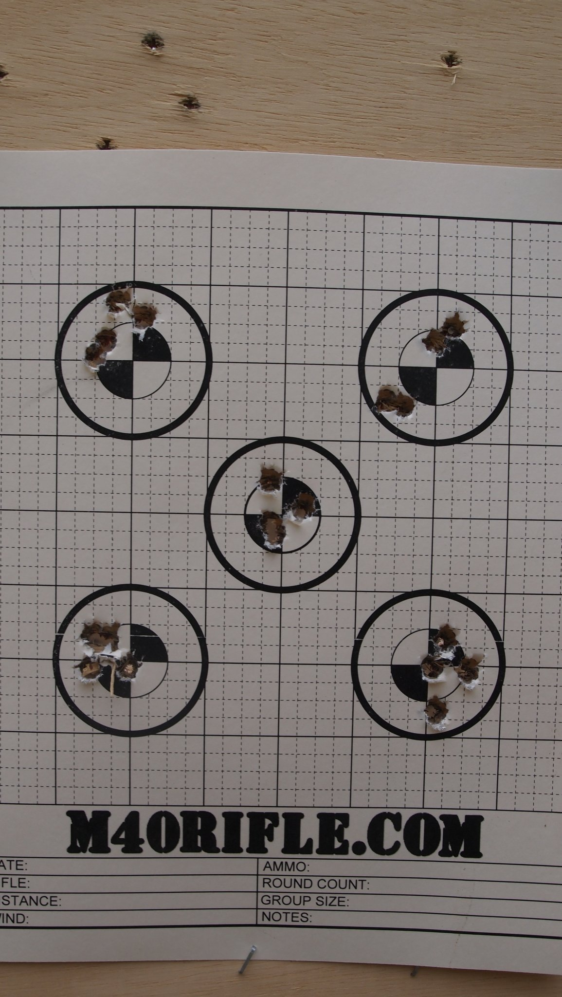

    Sighting in with irons.....
    5 groups of 4 with Creedmoor Sports Lapua brass, Lapua 167 Scenar ammo and a scope...

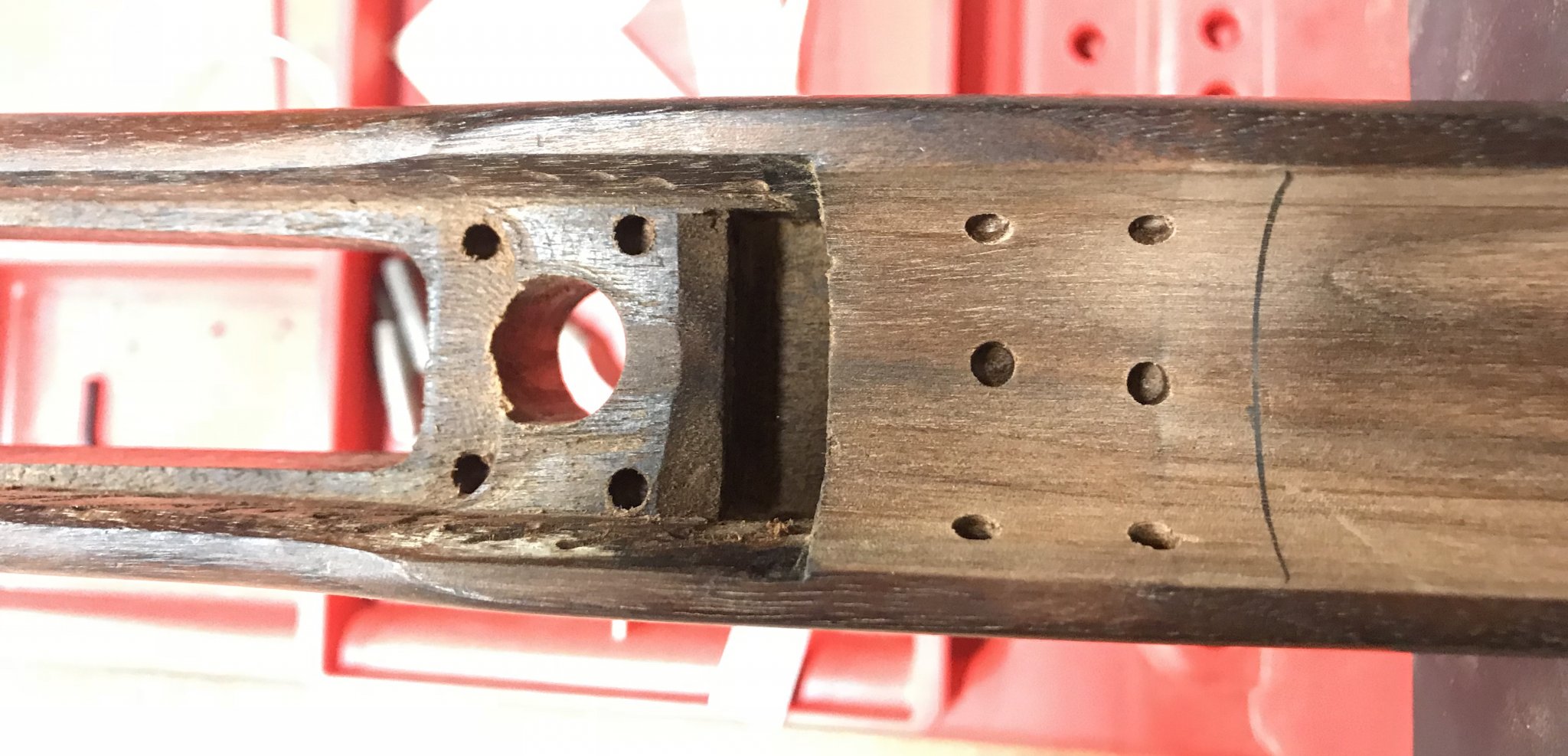

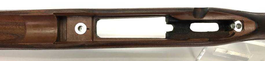

    Really like the builder that did this personality wise, his bedding was beautiful to my uneducated eye....

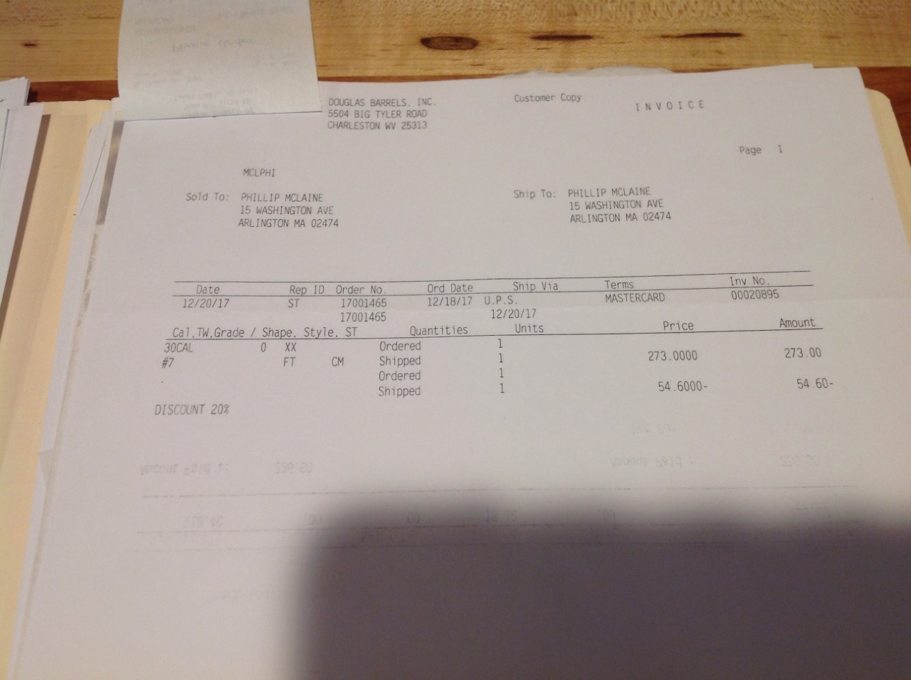

    If I remember correctly you are supposed to cut 1.5 off of a Douglas blank at the muzzle end. Which it is common to need to cut some off on most blanks. That step may have been skipped.

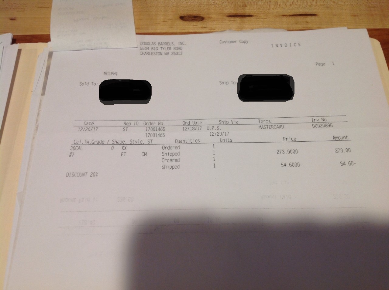

    This was my original Douglas order.
    Kind of spare on information regards length but the idea the muzzle should have been cut back makes a lot of sense.......

    Looks like at least 1 inch wasn’t removed from that barrel muzzle. Some barrel makers even put a saw mark where they want you to remove.
