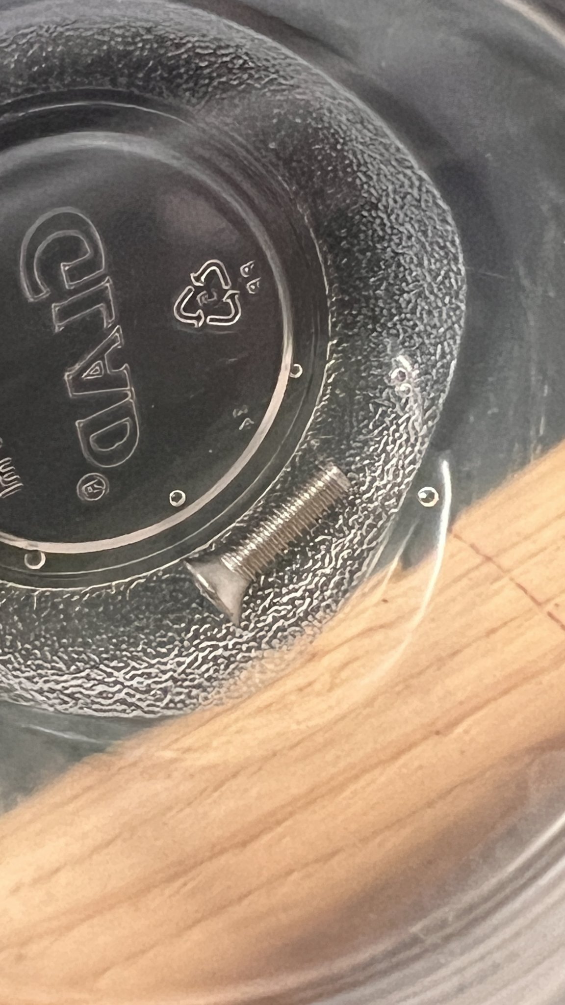

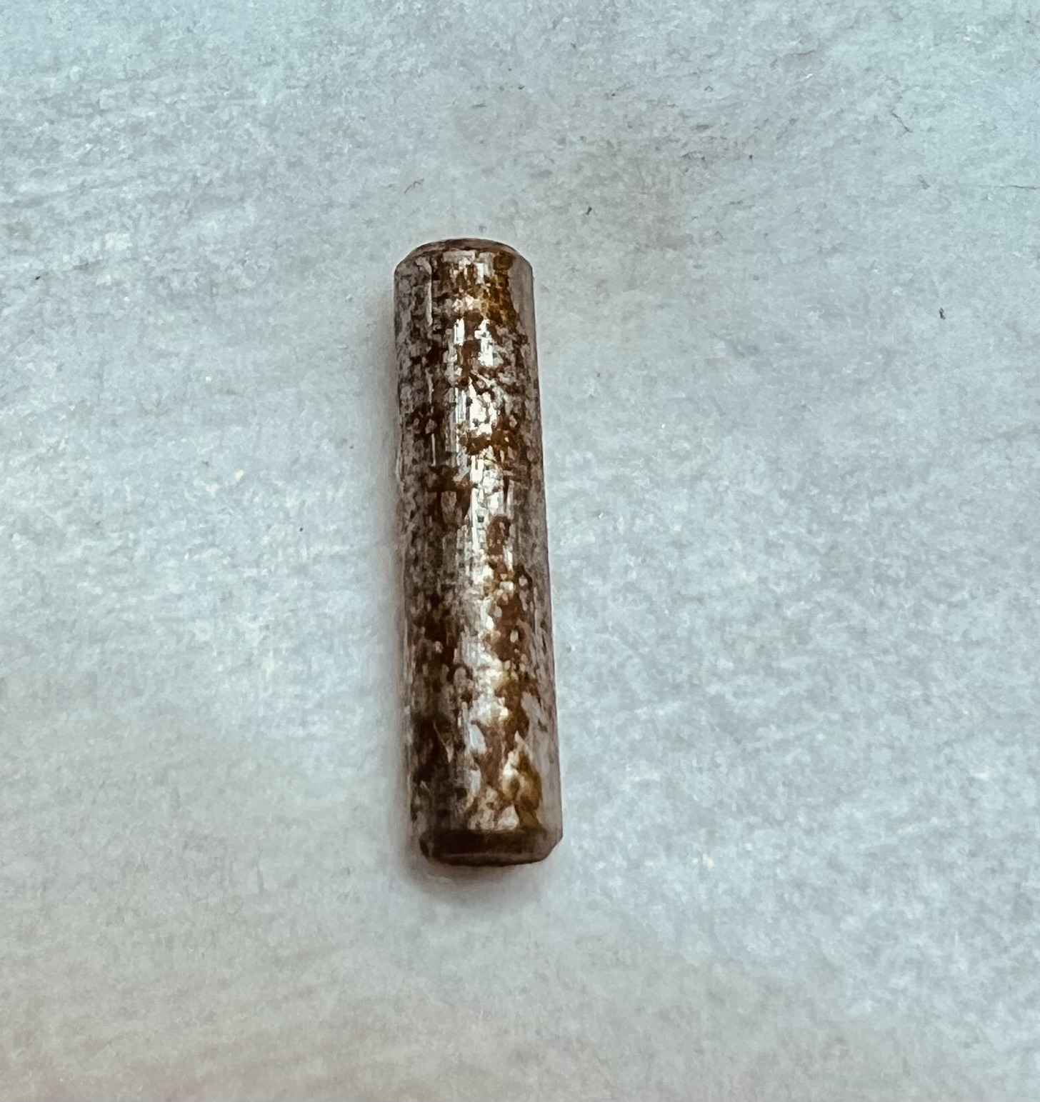

I’ve used Acceleator and Wipeout (liquid) a fair bit. This is a stainless screw submerged in the Accelerator about 1 min in.

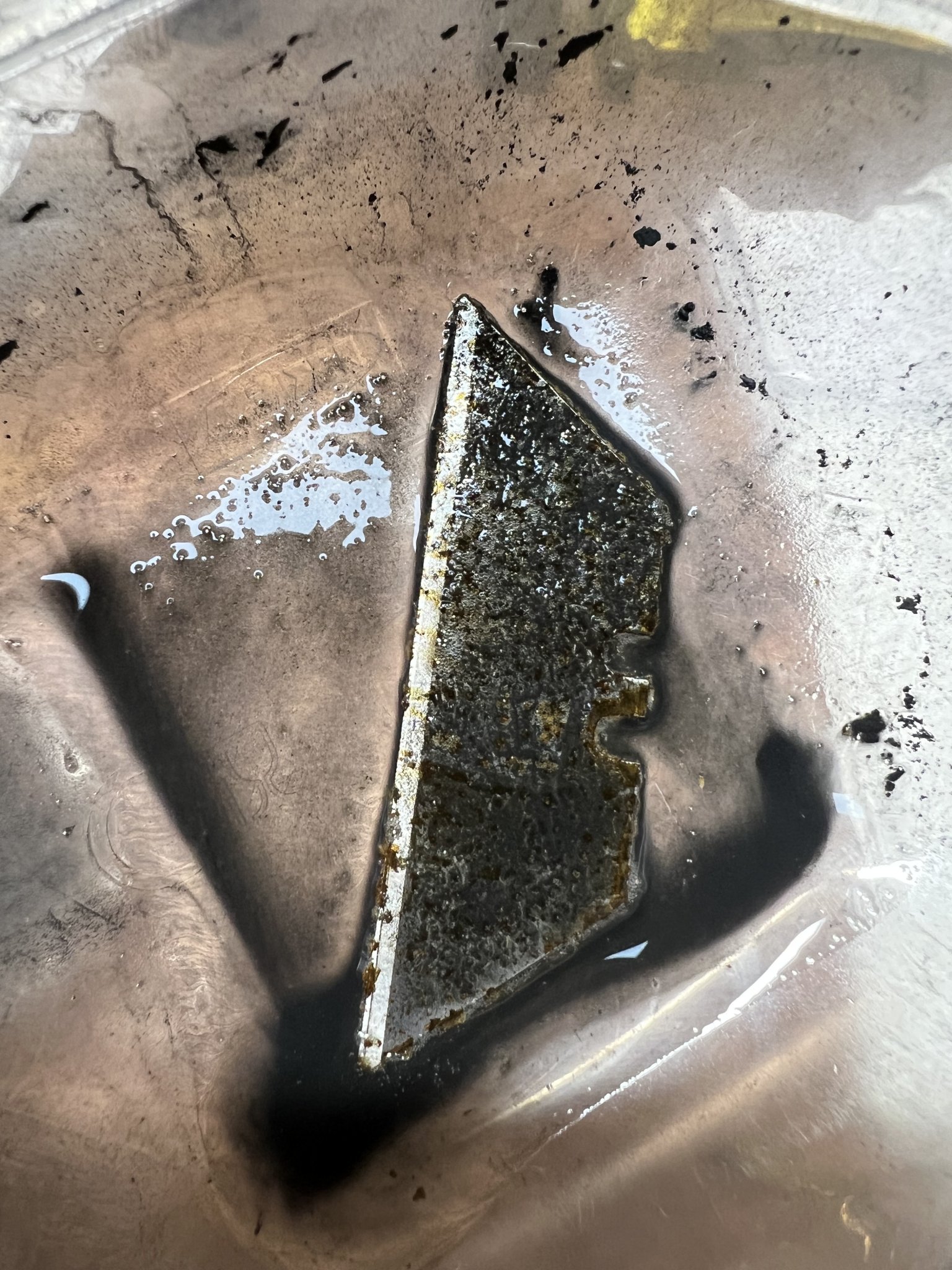

I’m no chemist, but dang, looks like you have a bottle of something like hydrochloric acid. Hope you are wearing gloves.
Looks like @FredHammer has got a Tribble problem.

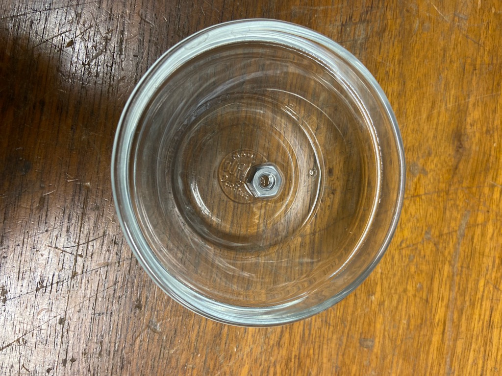

My two bottle don't even have numbers. LOL I just tossed a couple screws in a little of each so will let them sit a while and see.
That said what Fred has is not acting like anything I have seen. I am betting that there was a serious issue with that batch. Where did you buy it?

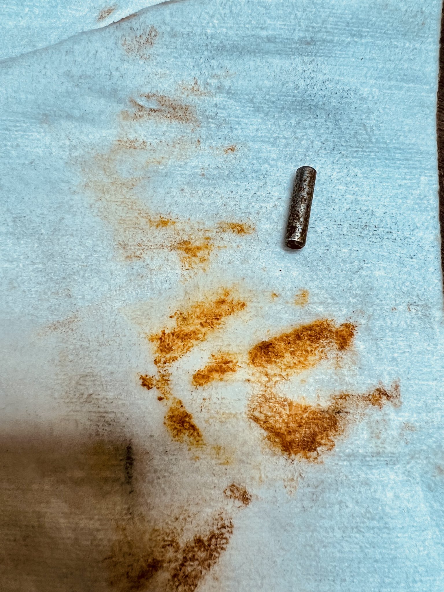

I thought I did. I detected some of the red color on the barrel breach faces, but didn’t think much of it. It was in the threads of the receivers faintly.
These last two barrels I cleaned all rusted hell broke loose. That’s why I wanted to conduct the experiments I did today. To see if this stuff would eat up clean virgin stainless steel.
I suppose the screw I used was 316 SS or 304.
Aren’t stainless barrels 416, typically?
I guess one could buy some 316, 18-8, & 416 SS dowel pins from McMaster for testing.

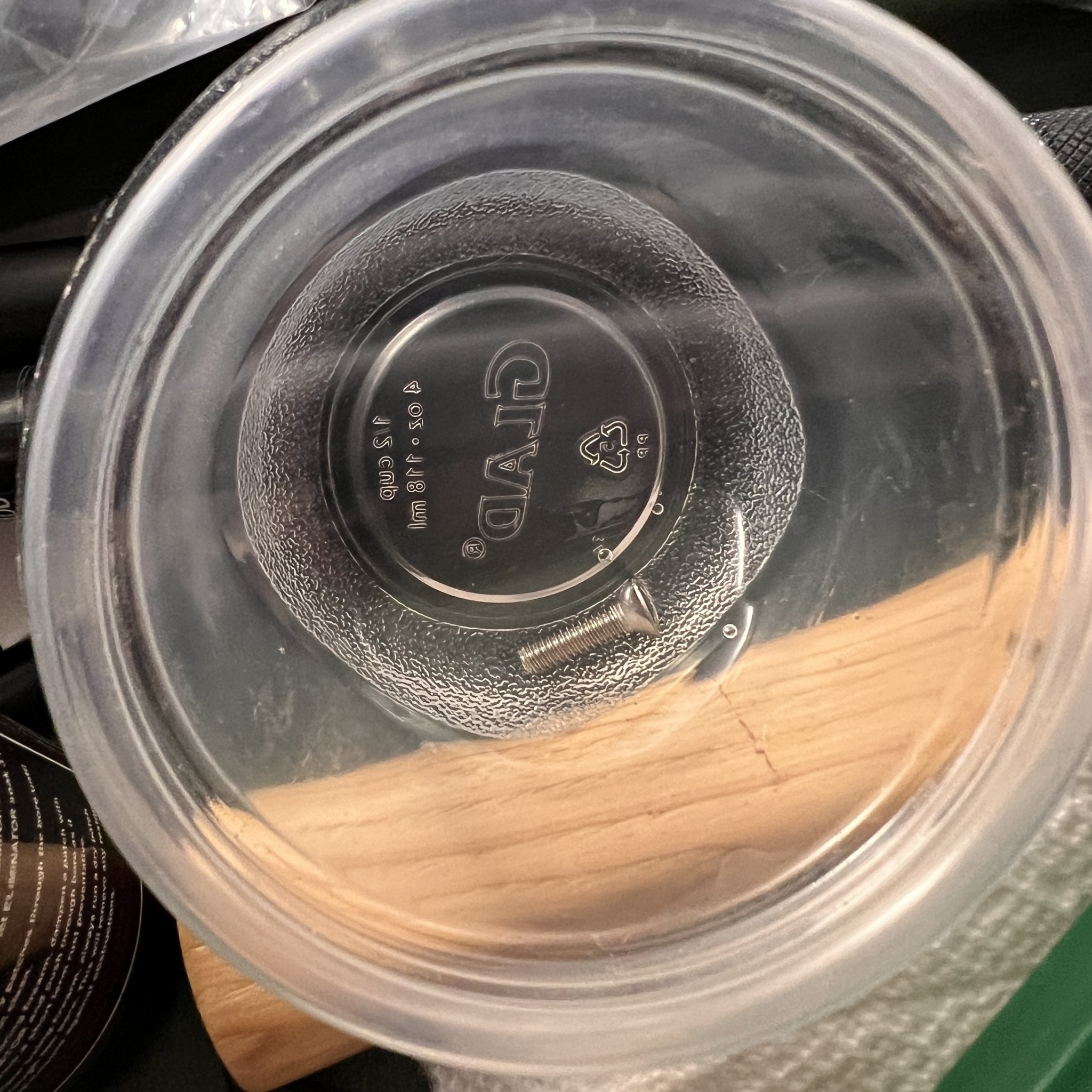

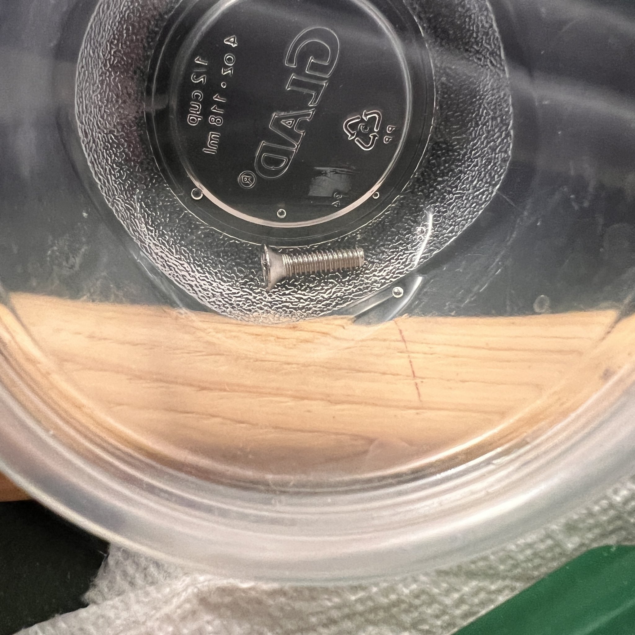

This is after 1hr 5min of soaking. I shook it around a bit. Nothing.
Yup barrel steel 416R. Not sure about metallurgy beyond that as in what would be resistant to this corrosion. I so wish the smith that cut my 30” barrel to 23.5 would have sent the cut piece back. I’d be a Daggum mad scientist by now!

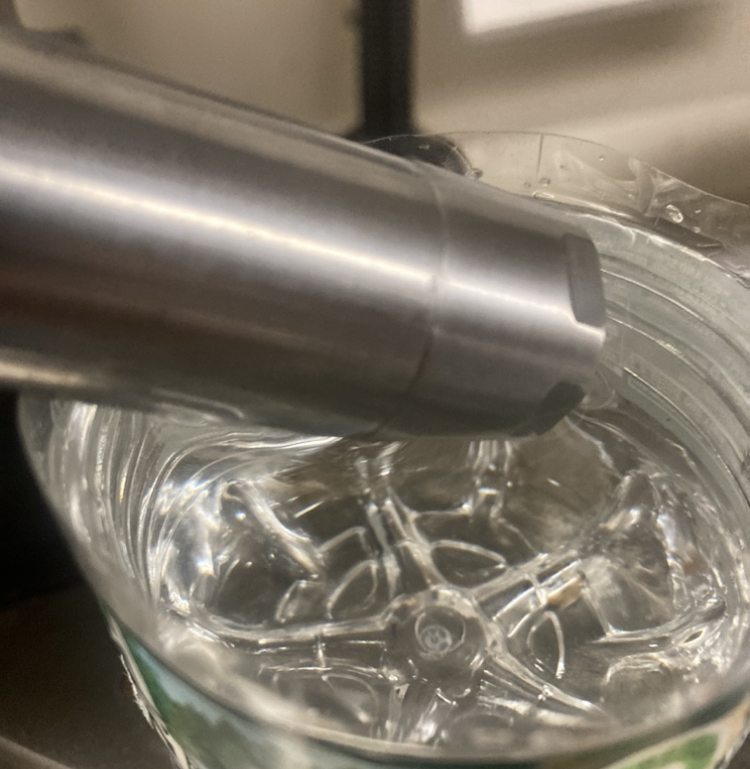

Set the rifle up so the bottom of the muzzle is in a cup of the stuff. From your previous pictures it will not hurt it any more than it already has.

I have a completely fucked up 416R stainless barrel that started this all. Why do I need to dick dance like that?🤣

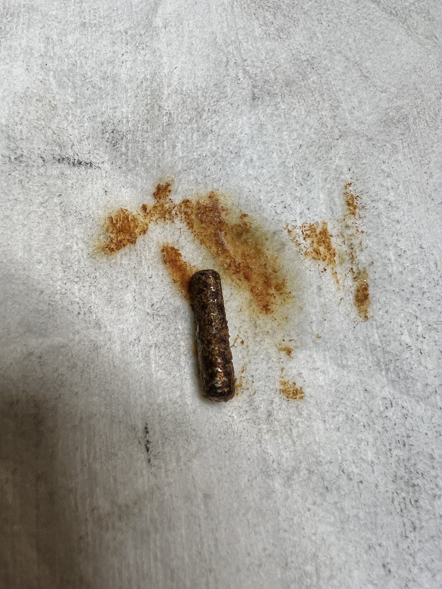

@FredHammer - Fred, you been punked somewhere along the line. That ain't Accelerator in that bottle...or, at a VERY minimum, it ain't what Accelerator is supposed to be.

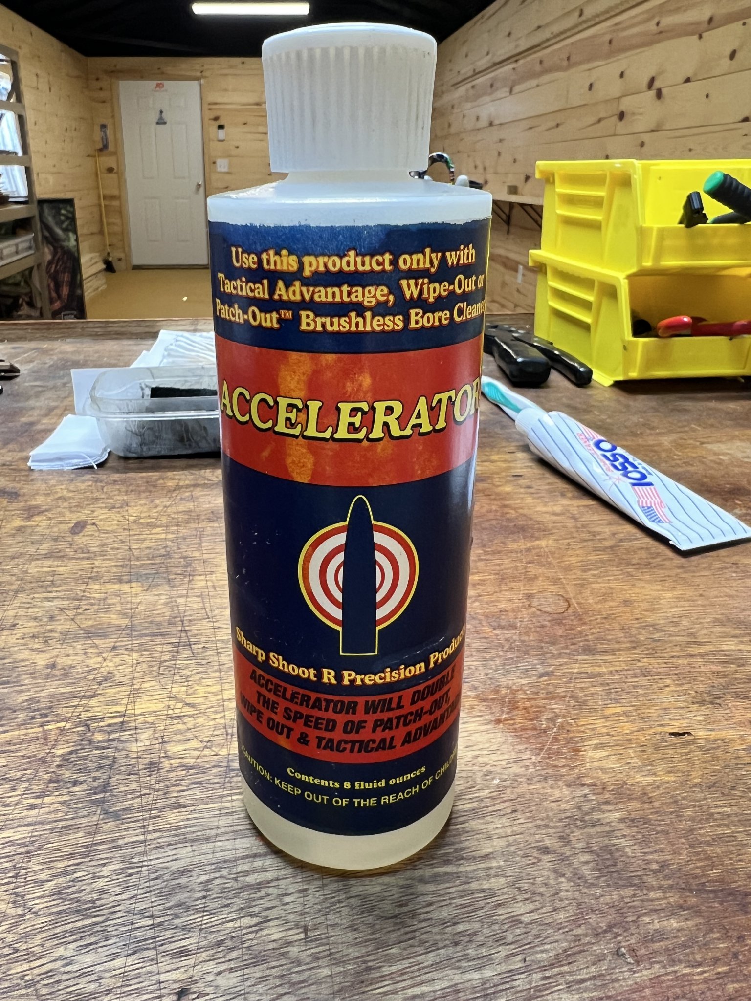

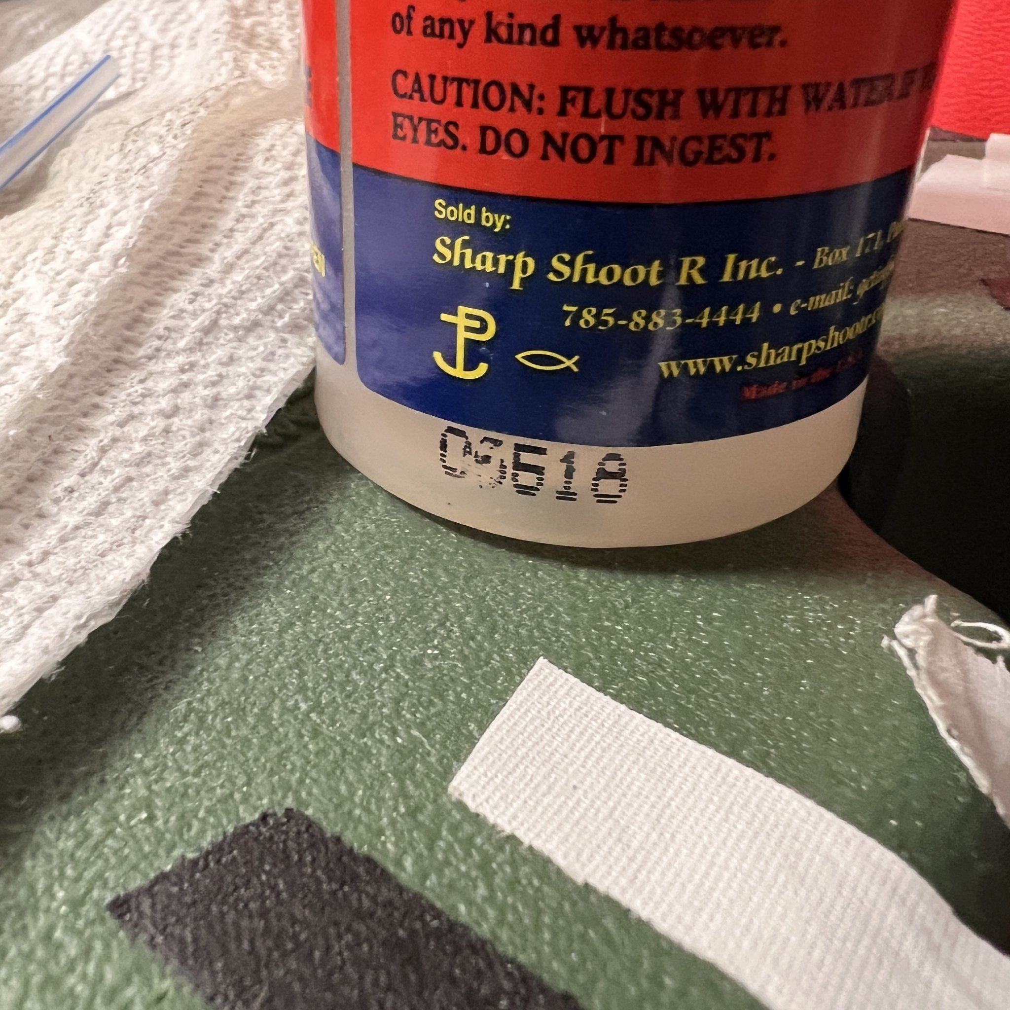

And hour now in my Accelerator which was bought three years ago...pretty sure I bought it direct from them. Zero negative impact....actually, no impact at all (well, it might be a tiny bit cleaner! haha). Seriously, there is no way in god's green earth that any cleaning product could do to that pin of yours in just a few minutes. Just speculation, but either some disgruntled employee (or perhaps someone of your acquaintance who had a grudge and access to your cleaning supplies) filled a bottle with acid or Sharp Shoot-R fucked up production in a way that's kind of hard to understand. As to the later, if they fucked up a production batch such that it did what you showed then it would be all over the net as there would be $100k's (maybe millions) in ruined rifles. Just have a hard time believing that scenario.
Here is my bottle of Accelerator...no number on it aside from the bar code. My Patch Out, bought at the same time, had a five digit number on the bottom of the barrel...16689, I believe.
I don't know what else to tell you but what you have in a bottle labeled Accelerator ain't what all the rest of us have in a bottle marked the same.
