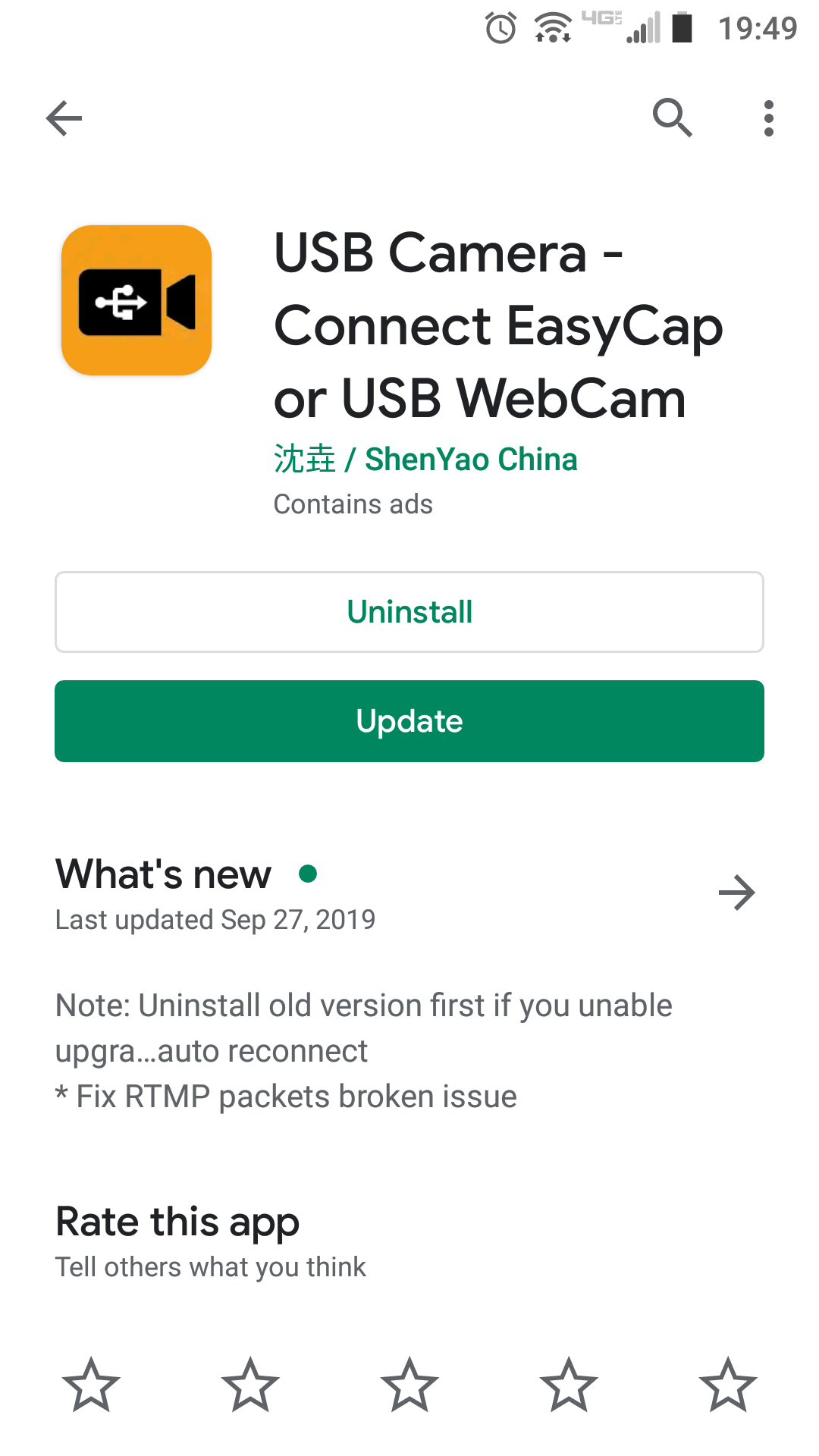

Just recieved mine, and everything works as it should, but I'm getting lines scrolling down the video. It's similar to what we used to experience watching VHS tapes. It's not a big deal, but just want to know if anybody else is seeing the same thing.
Samsung s7, with the recommended USB app.

I got mine Monday but didn't have time to play with it till today! It took some fiddling on my part to figure out the plug hardware to attach it to my Samsung/Android phone. It worked as advertised and had a caution flag about rolling up the optic cable too tight. I've opted to hang it from my caribou antlers till I build a rigid pvc holder that can protect and store it straight. Has anyone come up with pre-machined nylon or delrin spacer/lock rings for different calibers? My A. D. D. won't permit me to try and read back through this entire thread.

My Teslong rifle borescope was delivered last Friday; struggled to get it to work on my Samsung Tablet, but it worked perfectly when plugged into my Desktop PC. Attached photo is the gas port in my AR-15 barrel. I always wondered if I had the gas block properly aligned, now I know [not!].

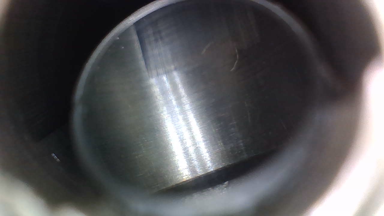

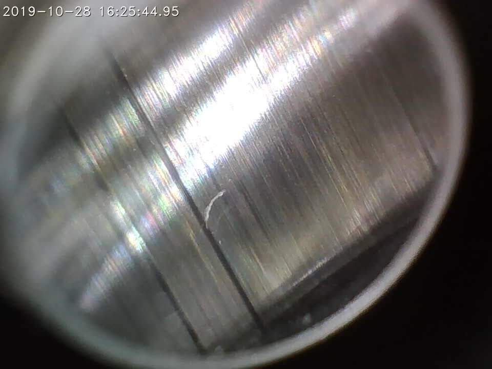

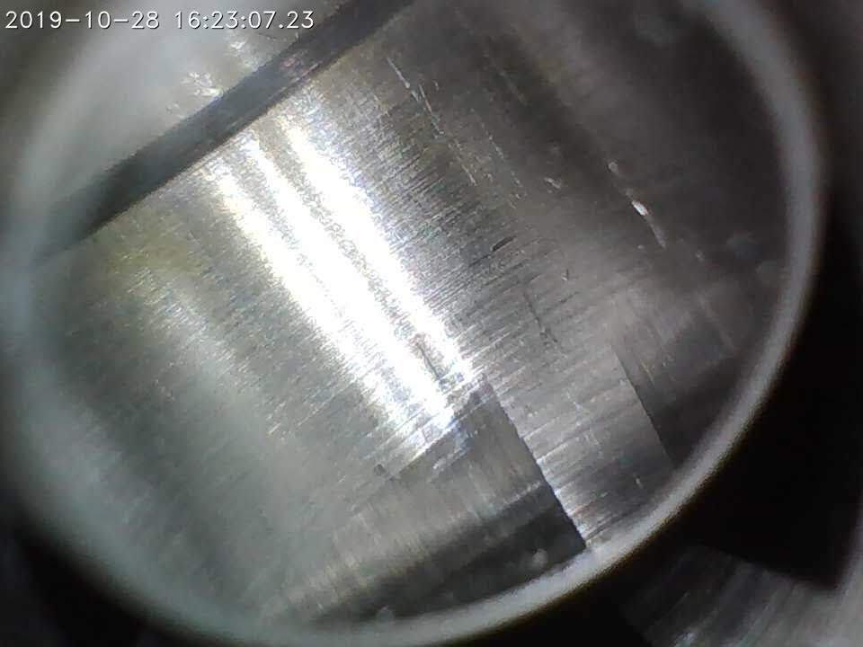

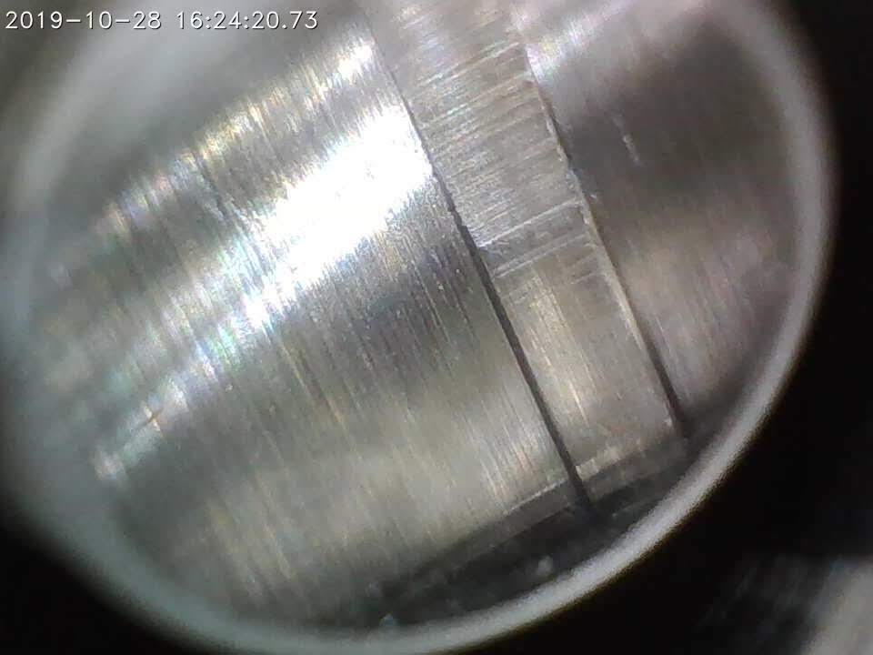

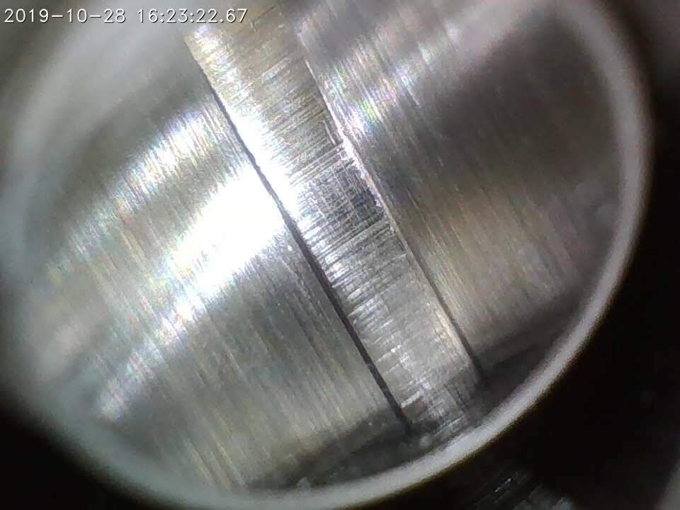

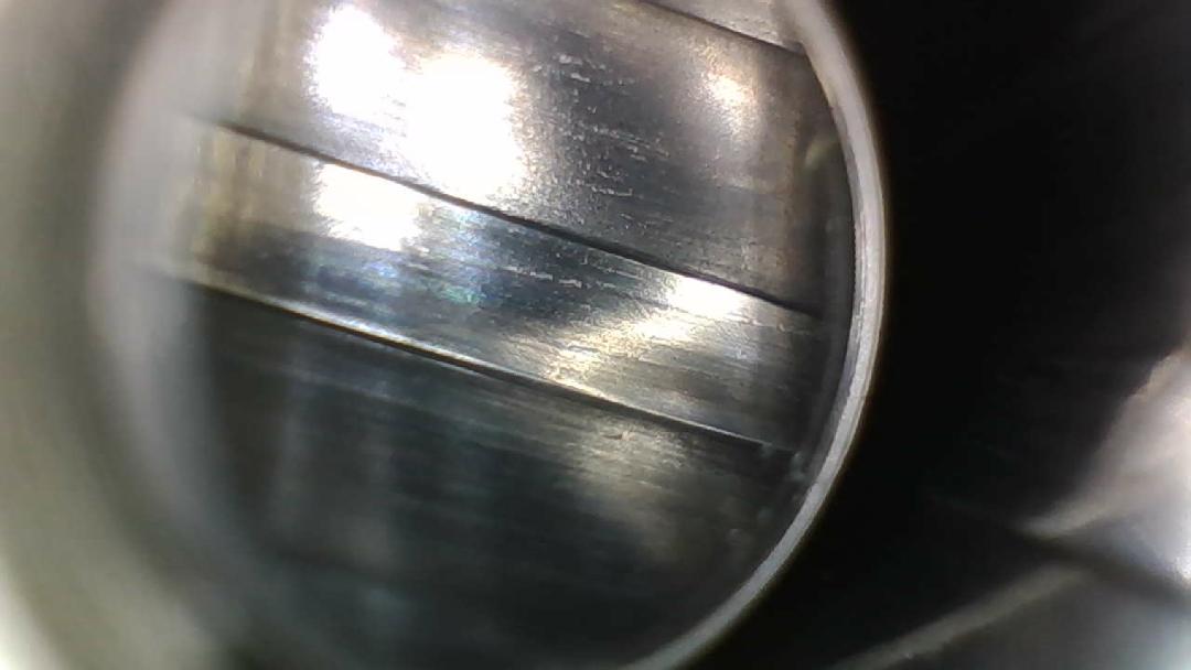

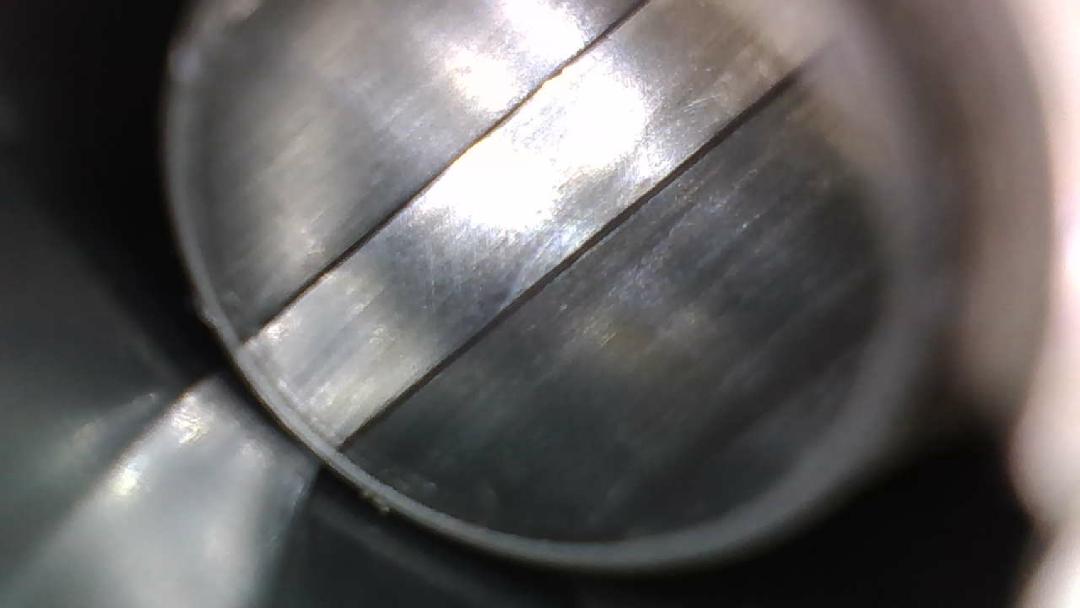

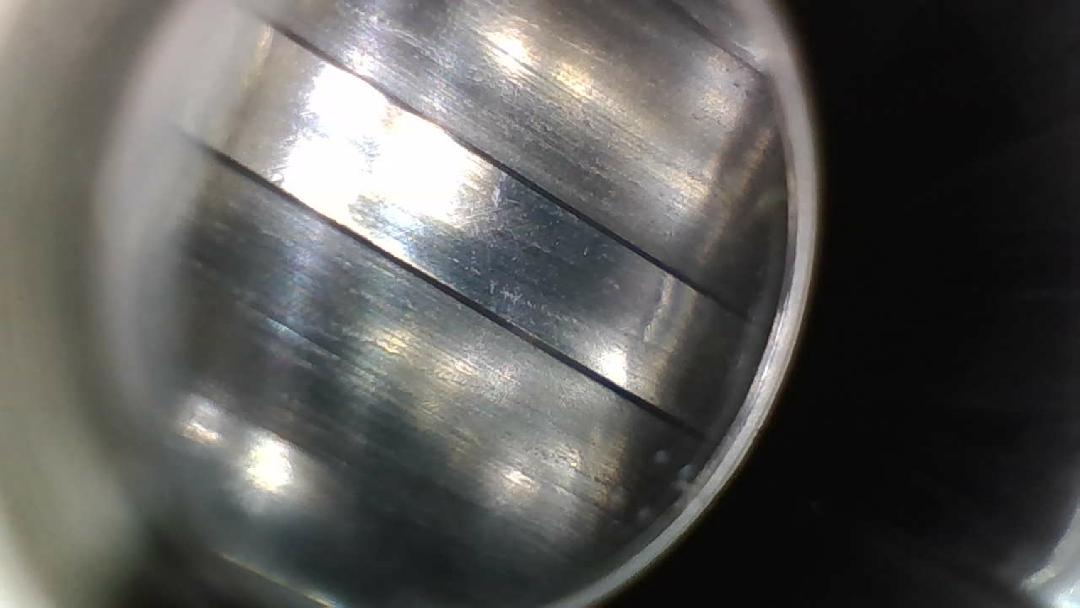

Here are a couple pictures of brand new barrel that was just chambered.

I have been looking through a lot of bore pictures on this thread and the main thing that stands out is the rough looking tool marks . I have had a lot of questions in the past about barrel maker lapping. These pics show that there is no such thing as a mirror finish in a bore. "This Guy's" pics above are a perfect example of a new barrel I'm sure that it does help barrel performance, but for an OCD like me, it looks like they missed lapping all the barrels I have seen. I would hate to cull a barrel for apparent imperfections and see worse on the new replacement barrel. Just emphasizes the need for educating new bore scope users to the realities of bore life. The main use that I need a scope for is throat erosion and muzzle condition. The rest of the barrel is as shown, a means to an end. in this case both ends of the bore. Just an old man's thinking. Life is good but too short. Enjoy it to the hilt while you can. By the way, I am very glad to see an inexpensive bore scope of this quality.
That is a new Krieger barrel.

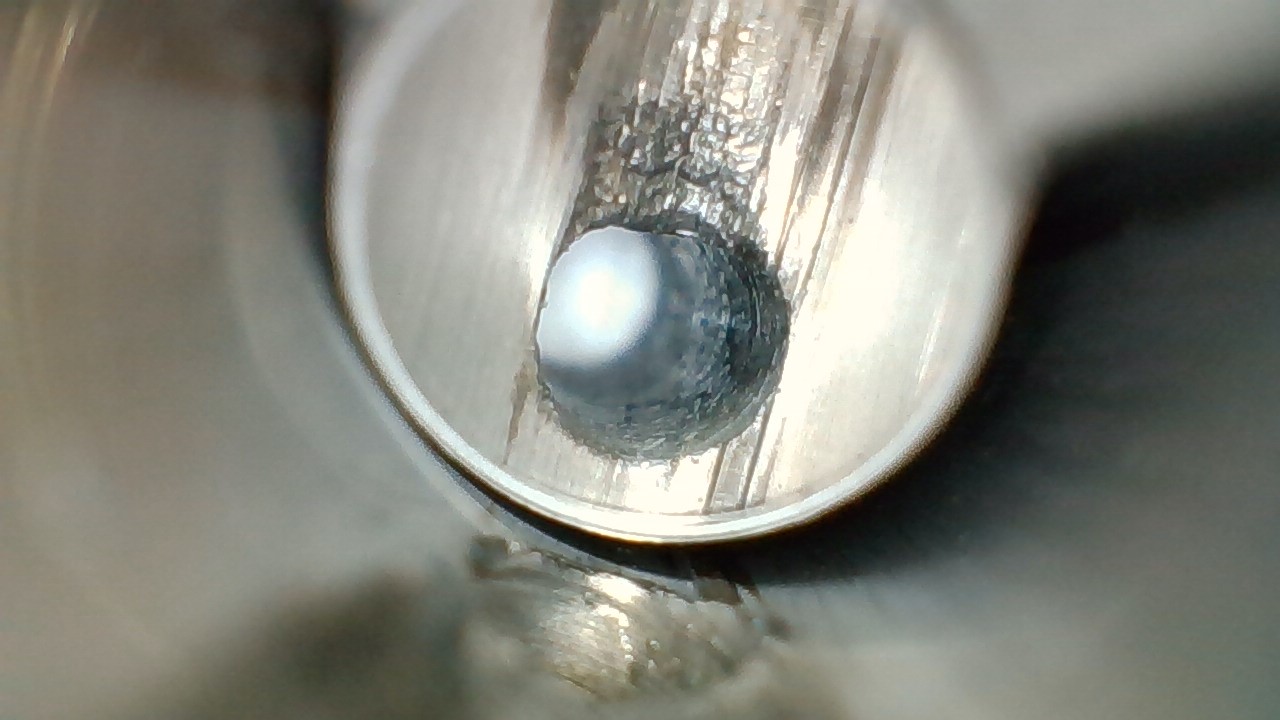

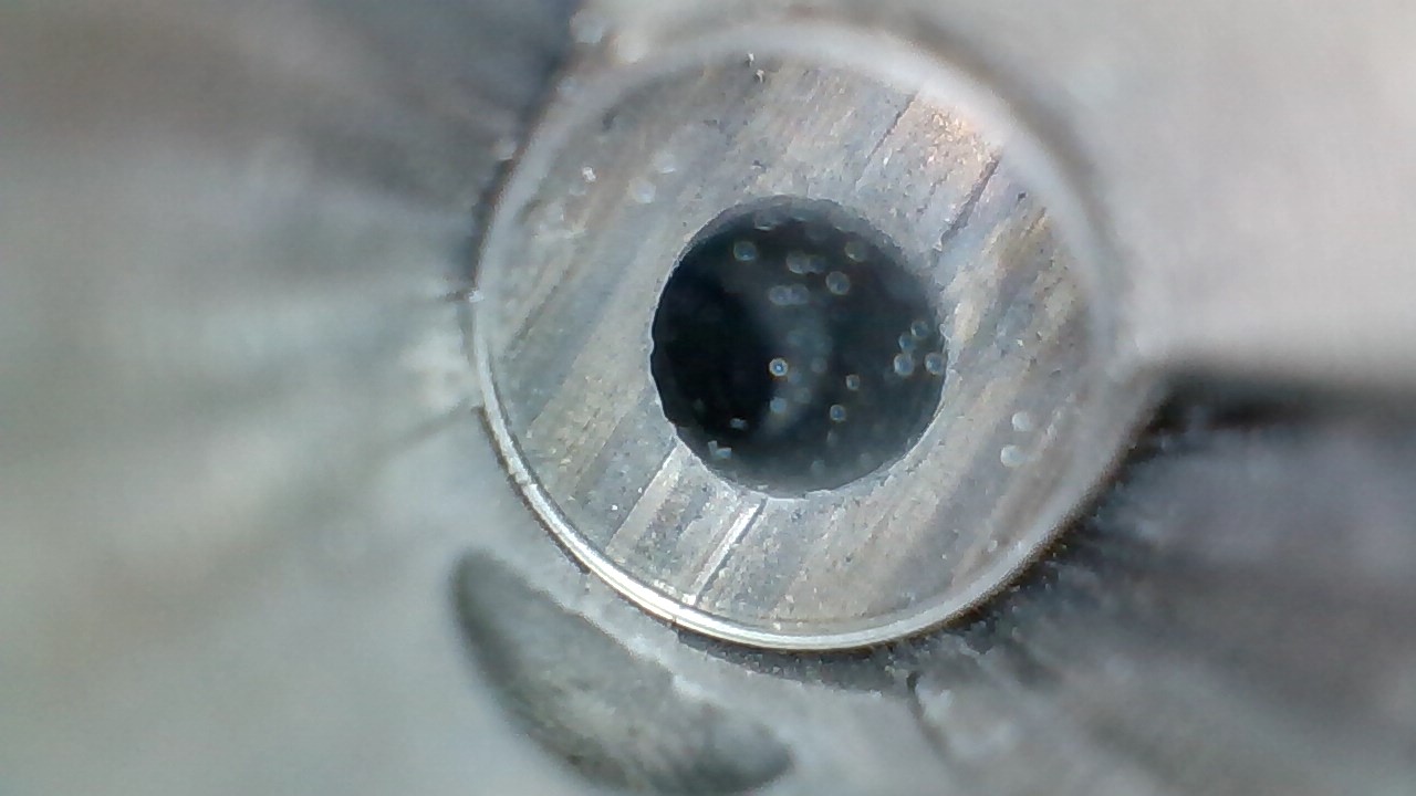

Looking for opinions on the below picture. This is the gas port of a 6mm Creed barrel that has about 1200 rounds on it. Is that fire cracking / erosion around the gas port considered "normal"?
It's been shot almost 100% suppressed, and mostly handloads that would not be considered all that hot.
Note: I ran the scope in from the muzzle end, so the erosion is on that side of the gas port.
How does it cycle?
What is it about the Krieger above your post that you don’t like? The barrel finish is correct. Did someone tell you the finish is supposed to be mirror shiny? The perpendicular marks in three of his pictures are caused by the chamber reamer.

It cycles just fine, and shoots pretty decent too. I'm more curious than worried.
There's fire cracking for the first few inches at the chamber end, which I expected, but this just seems odd...
Think about the hell that orifice is subject to.
As an analogy think hot habanero and anus.
There will be damage.
I thought the barrel in those pic looked pretty nice.
