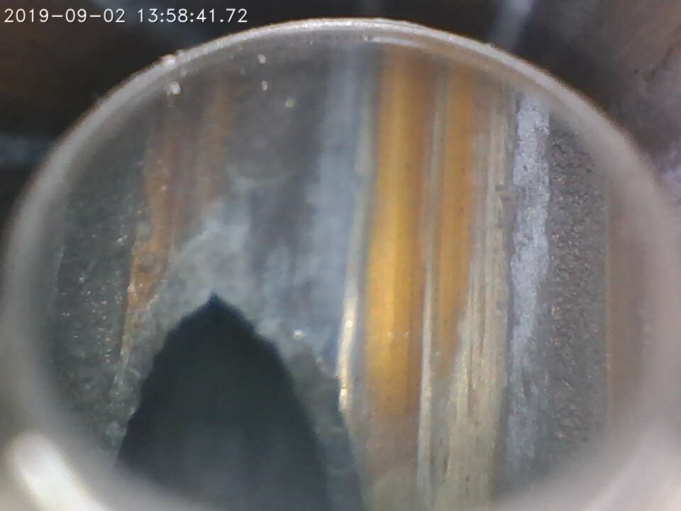

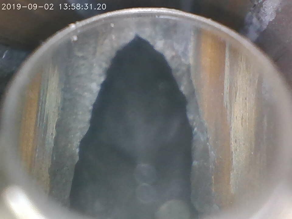

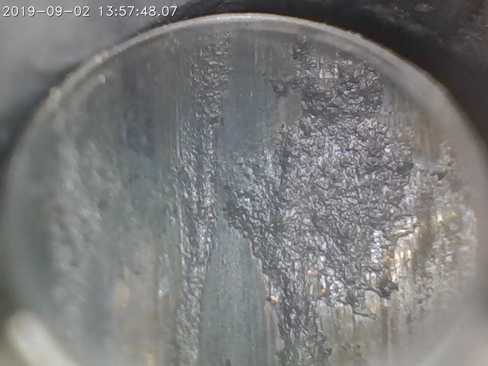

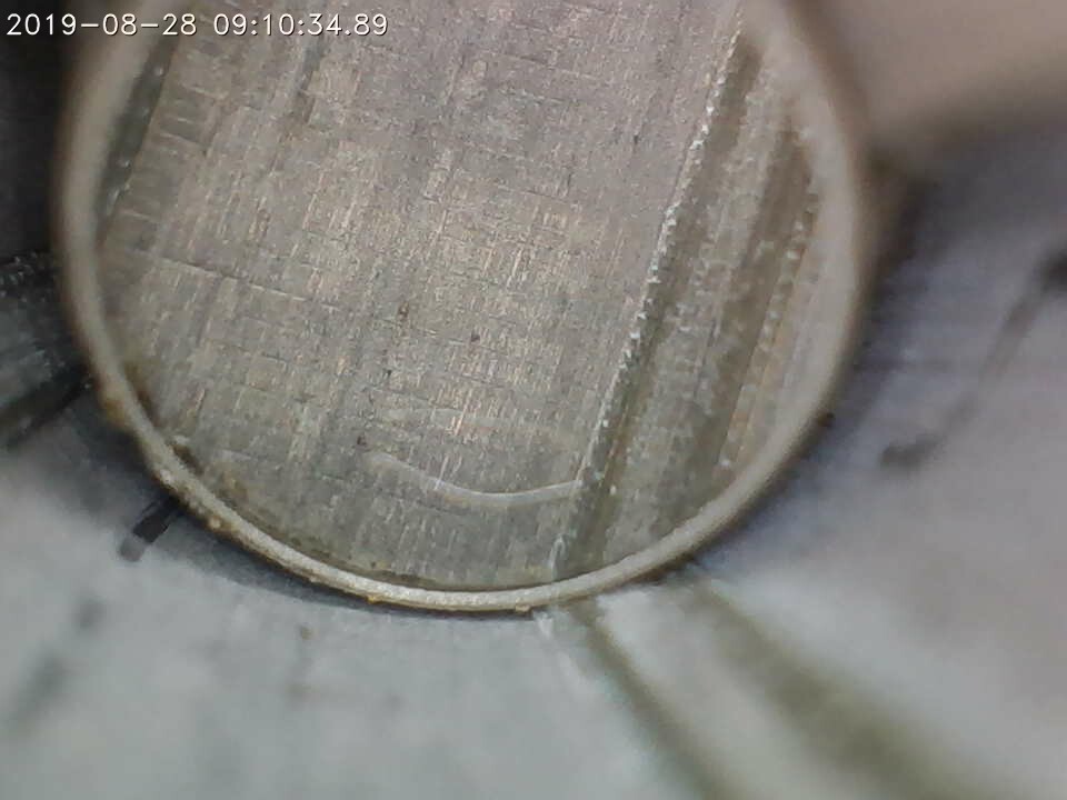

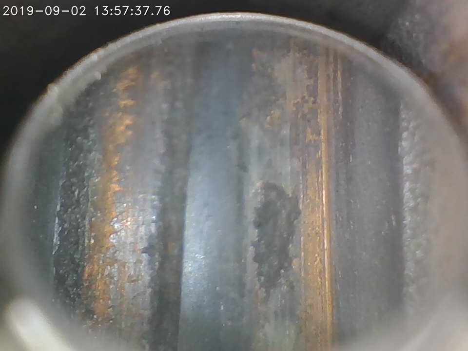

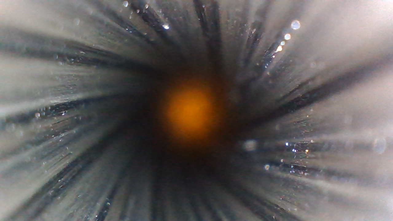

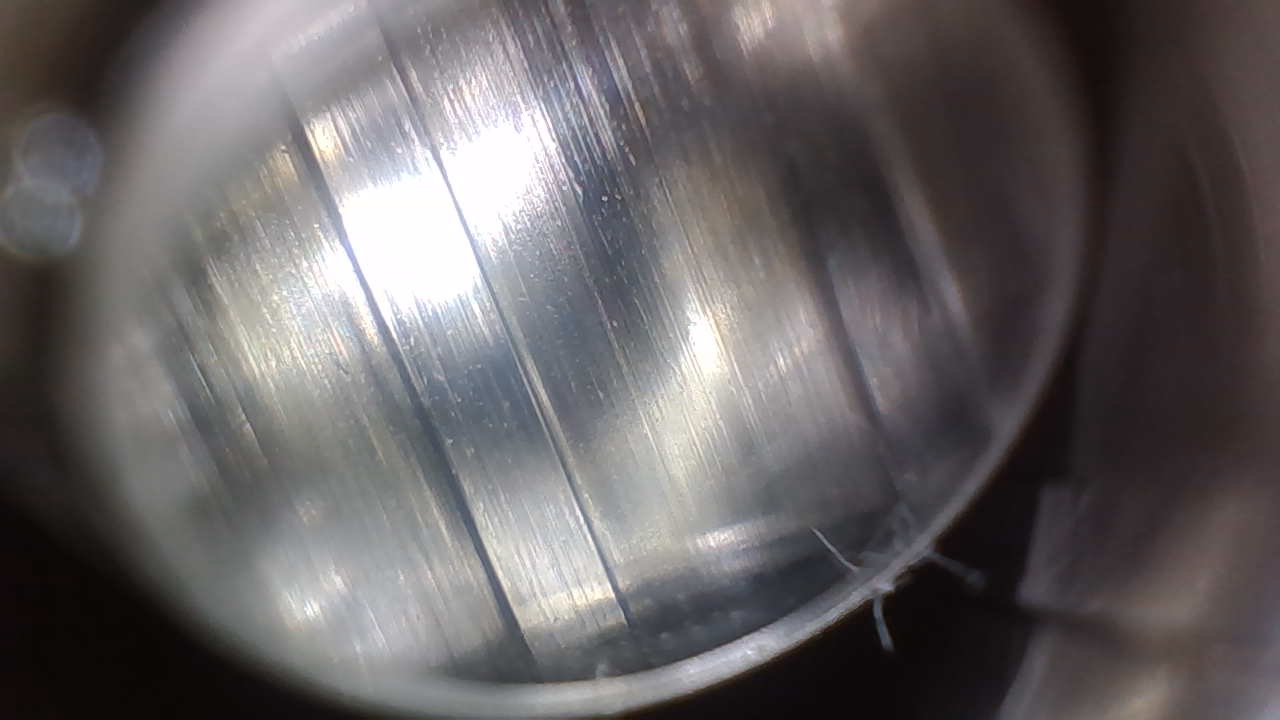

Well, as usual you guys were right-ordered and received it in 2 days. Plugged it into my HP laptop and boom, there it is! Awesome resolution.
Now a question regarding what I've found. Picture 1 is about two thirds of the way down the barrel and picture 2 is pretty close to the chamber and picture 3 is even closer to the chamber. It looks like carbon to me but what are your opinions?
I've spent two days scrubbing the dogshit out of this thing using bronze and soft brushes with Bore Tech copper remover, Bore Tech carbon remover, Bore Tech Eliminator, Montana Extreme copper killer And Sweets 7.62 and I STILL can't get this shit out of the barrel.
Any thoughts?

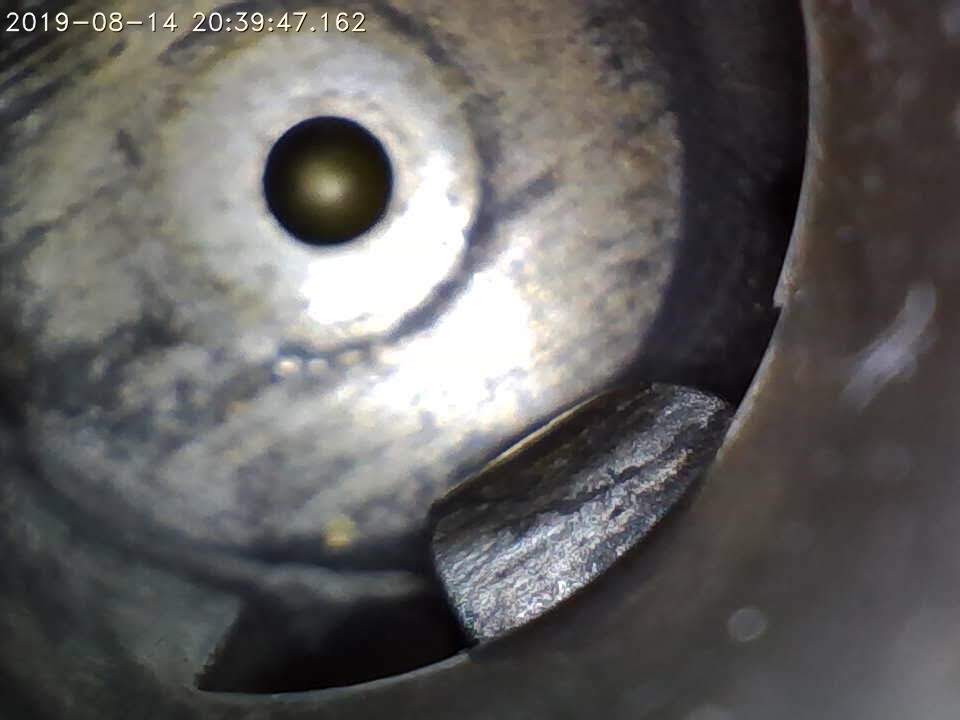

Well, it looks like part of my issue was caused by operator headspace which is defined as a total lack of cranial matter between the ears.
I was using the "straight down the bore" view to check the barrel and THEN I put on the angle view tip and saw something totally different. The difference between the two views is dramatic. The pictures are from the same location in the barrel. Wifes been on a business trip overseas and gets back tomorrow and now I can get all this cleaning crap off the counter before she gets home!!! ;-)

Actually, when I hooked the unit up with the tip for the first time the image was terrible. I looked closely at the tip and there was no "mirror" attached to it. I realized that other pictures that were posted showed excellent imagery and I finally decided that the mirror had not been attached when the unit was assembled.
There was no evidence of any adhesive having been applied to the tip so I figured it made it out of the shop without it being installed. Two days later I saw something that caught the light laying on the floor near the area where I unboxed the unit. Sure enough, it was the mirror. Just like the tip, It had no evidence of adhesive on it so I'm guessing it fell out of the package when I opened it.
A little dab of epoxy took care of it and it works great now. I really don't think that you carefully running this unit through the bore has any potential at all of damaging the threads

That's what I figured after taking a closer look at your picture without the mirror that unit was not designed to be run without the tip and it just came loose on you.

I'm actually glad I spent the time working on the bore and finishing it up with a good run of Bore Bright-a patch goes through the barrels like it has grease on them .
I was actually working on two rifles at the same time and they basically looked the same, a 224 Valkyrie I built on a trued PTG Rem 700 action and a 6mm Creedmoor I built on a Rem 700 action using Criterion Remage barrels. I'm a Lefty so I didn't have much choice regarding the 224 Valkyrie setup as I couldn't find anyone but PTG that had it available. I actually really like it, it's stainless steel with a fluted bolt and an M16 extractor. They did as good a job as I do lapping the lugs so I can't complain...

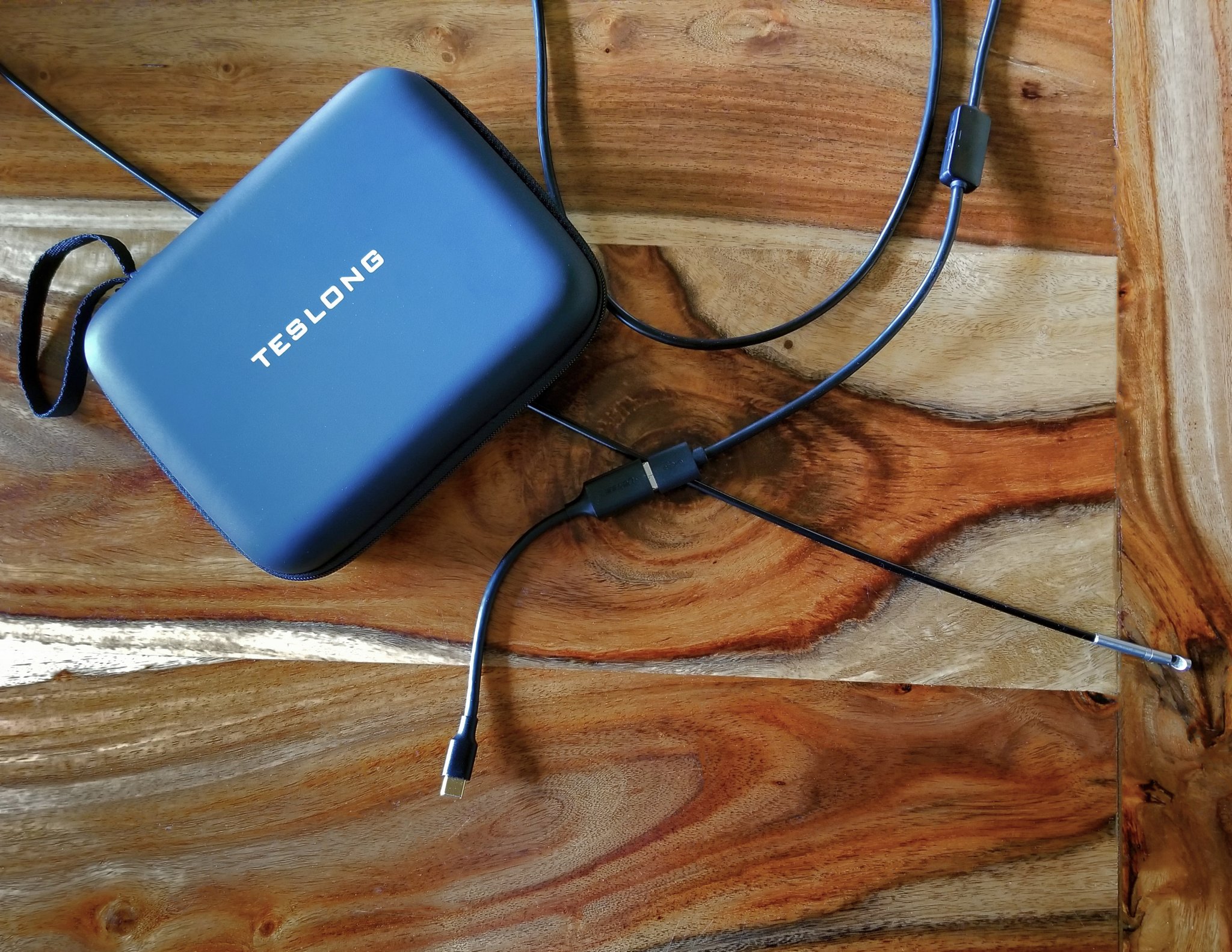

Got me a different adapter that beats the one that came with it to pieces. Before the adapter constantly lost contact and would slide out of
the android, now this thing is solid like the Rock of Gibraltar worthy of the rest of the bore scope.
If any one else desires to fix their scope and make it a pleasure to use I recommend this:
UGREEN USB C to USB Adapter Type C OTG Cable USB C Male to USB 3.0 A Female Cable Connector
Cost me $5.99 on Amazon and well worth it.

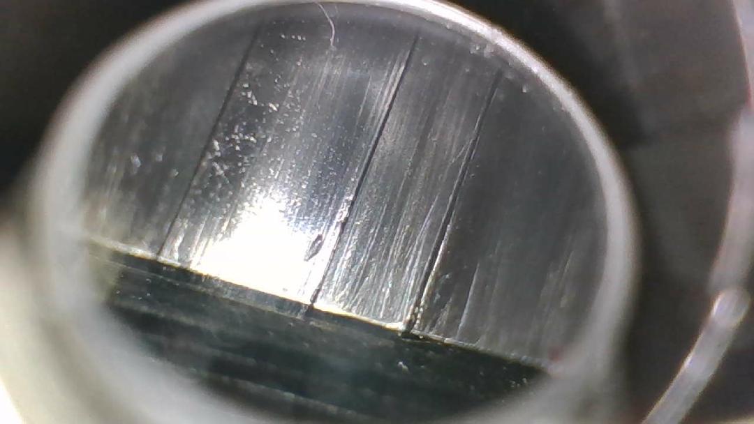

Mine came this afternoon. Got it working on a win 10 laptop in a few minutes and scoped my 65CM. Seems to work really well. I don't have time to write a really long review, I need to go order a gallon of everything Bore Tech makes, a case of brushes and a couple of boxes of patches.

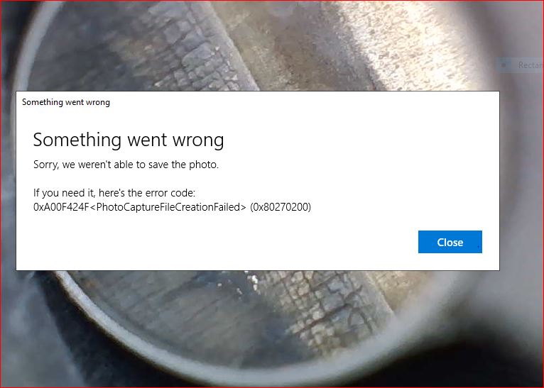

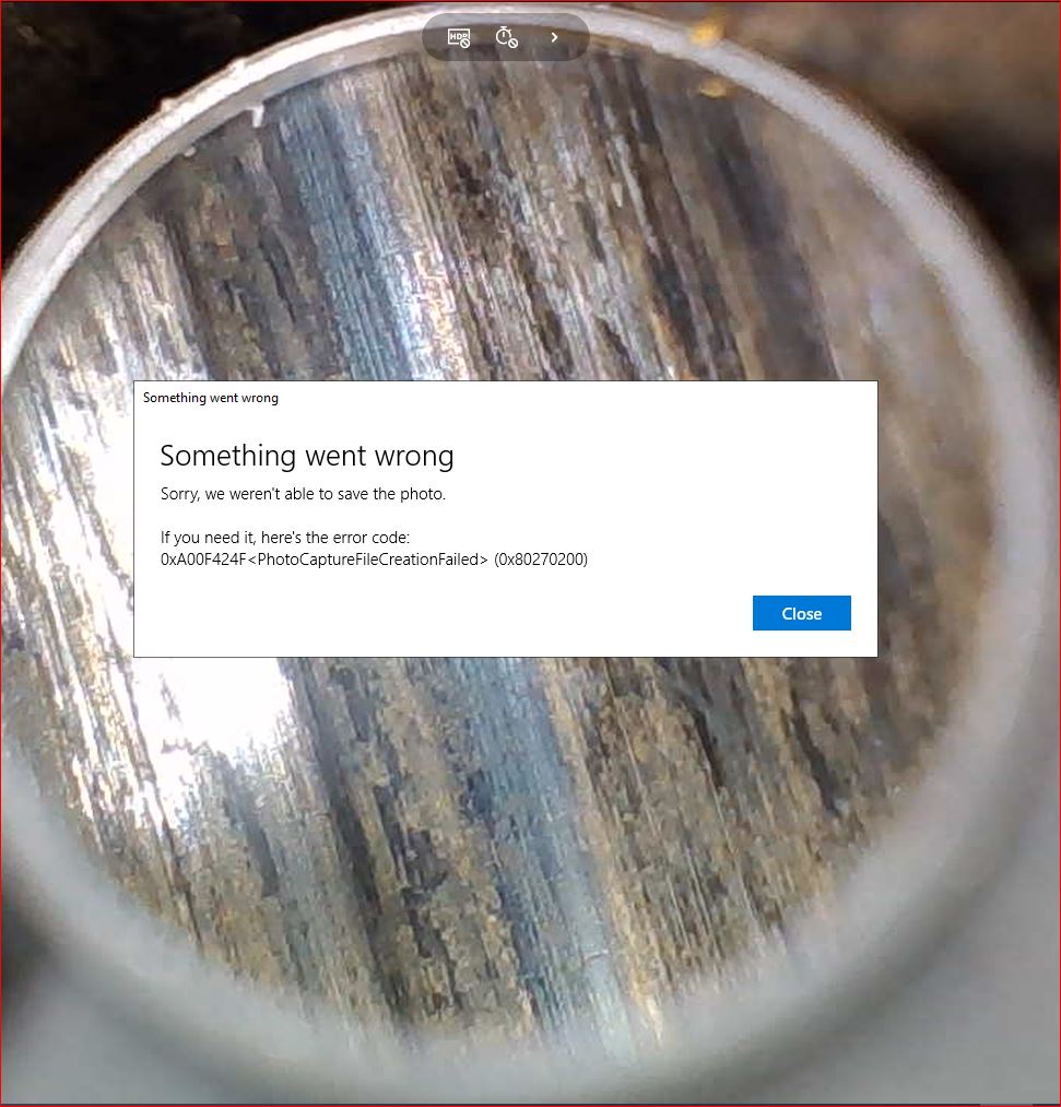

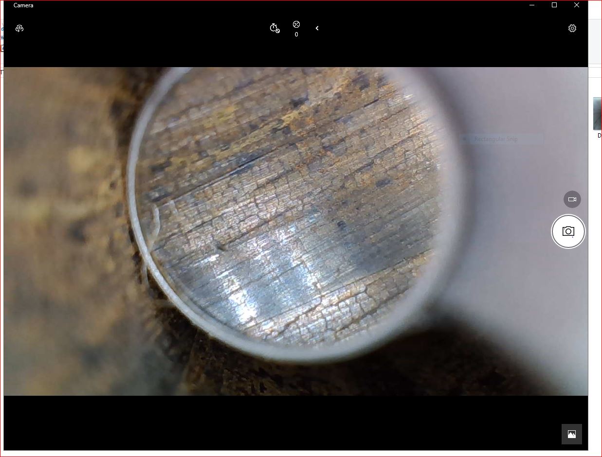

Received mine today and was and am impressed. Except for one thing. Using Win 10 and screen snip I captured the error code. How fix?View attachment 7138037View attachment 7138038
OK. I should have stated that was ONLY on Win 10. It works magnificentlyTerm2.jpgTerm1.JPGTerm3.jpg on my Android using the Shen Yao APP as suggested here. Today I've had some time to use this Teslong Borescope and so far I can't imagine what more anyone would want with its clarity, ease of use, applications beyond expectations, etc. Maybe barrel manufacturers will come to love--and loathe too--this borescope; ditto for chemical peddlers...
Great piece of equipment. Thanks to all for making it and publicizing your experiences...

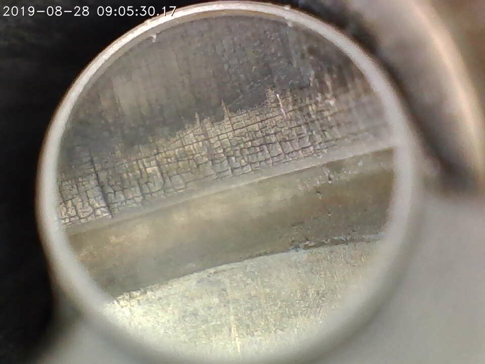

I just want to confirm a carbon ring - what the rest of the barrel is doing is meaningless to me.
After 1000 rounds, any I’ve seen look like a dried, cracked lake bed.
