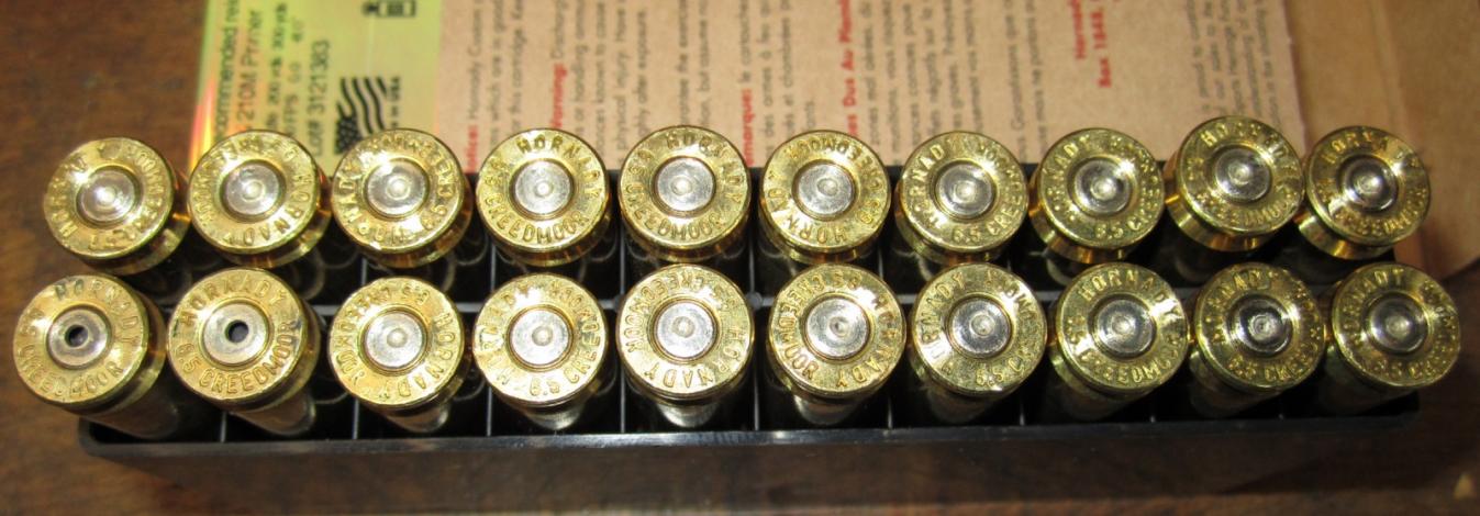

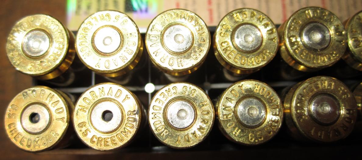

Here's pictures of the fired brass.
Headspace measures OK using my Sinclair gauges-- the once fired brass is only .003" longer than unfired.
I have the same rifle and same caliber and mine does it as well with factory rounds. I have an adjustable gas block and it still dings the brass. I am going to work up a load for it and see if that makes a difference.
Pierced primers would scare me and I'd definitely call GAP to get their opinion on it.
In my limited experience, usually when I see cratering on primers the entire primer is perfectly flat. The edges of the primer still look rounded to me. Even the ones with the pierced hole. Almost seems like maybe it's something with the bolt face or firing pin hole diameter ?
I'm not certain that 0.003" of headspace growth would not concern me personally. If it was 0.007", sure, but not 0.003". As long as you aren't seeing rings above the case head after the first firing (indicating a potential case head separation) you should be fine. Some guys bump their gas guns back 0.003" for loading. Personally I only go 0.0015" for either a bolt or a gas gun. I don't recall how much mine grew from factory but I'll measure when I get home.
Interested to hear what GAP says.
I'm not worried about the datum shoulder moving forward .002 to 003" after firing compared to unfired factory rounds-- the .002 to .003 growth I'm measuring is safe IMO. I've had factory Remington 700's with far looser chambers and measured substantially more growth between unfired factory rounds and fired rounds. When I reload I typically FL size and bump the shoulders back .001-.0015 for the bolt rifles and .0015-.002 for the semis.
And yes, I do agree the primers look somewhat odd. The firing pin impact itself looks very rough with some material flow to the cratered edges and the rim on the brass shows heavier ejector swipes than I would expect for factory loads-- but as you pointed out the edges of the primers are still nice and radiused and don't appear to be flattened much, if at all, from their unfired condition.
I need to bring a couple of pin gauges home from work to measure firing pin hole clearance but it feels minimal, about .005" at most would be my guess. There isn't a substantial raised "ring" around the firing pin impact as I usually see with bolts with excessive firing pin clearance. I'll also measure firing pin protrusion.
I've got a message in with Ken-- looking forward to GAP's input on the symptoms and the pictures.

Friends GAP 308 was blowing factory load primers because of too tight bore. Bore was measured.
Mil spec or otherwise, it doesn't make sense a smaller tip not being able to ignite a heavier primer cup. There would be more pressure/penetration w/ the smaller fp tip. One problem is, and this is a good thing, is the Armalite doesn't have the free-floated firing pin and has a spring retraction on the bolt/ carrier....same as the M110 we have in the military....and that's about the only mil-spec I know about when it comes to the 308 AR's. those rifles need a heavier hammer strike, and some triggers will not function properly, I had problems with the Jewel trigger in one, switched to the Armalite match and all was good with the world. George, you are right about the large fp w/ small primers, it just doesn't give the support needed.
Oh, and rounding the corners on ejectors and polishing along with lightly chamfering the hole can help the ejector mark/brass wiping issue.
Before Using Bartlein we used to use a lot of Obermeyer tubes, Boots uses a .298 bore but widens the groove to supside pressure, all the Mk11 Navy rifles use the Obermeyer barrels. a "tight" bore does not always spike pressure. And a lot of factory ammo is still too hot for Gas Guns.
There seems to be a misnomer that just because you buy "factory ammo" that that somehow means its 100% for sure solid perfect ammo. I could give countless stories where factory ammo is the culprit and to blame for some rifle problems.
Ill give you a couple. Large Government agency over 30 AR-10 rifles that we maintain and Re-barrel. they switched from one lot of ammo (big name factory ammo) to another and the rifles cease to function go back to the old lot back to running like champs.
A California Department was having problems with M-14 rifles we built started having erratic problems. They came out to the shop with their guns and ammo, again 2 different lots. I had a 3rd lot of the same brand. just for shits and giggles we pulled the bullets from this 3 different lots and not only was the charge all different they were 3 different types of powder. 2 of the lots worked great one would not function the rifles.

I'll second George's comments on factory ammo issues in a gas gun, and especially suppressed you see a lot of dropped primers etc as it was never designed for gas guns. Even in today's world the majority of companies make ammo for bolt guns, as they don't need to deal with chamber and port pressure relationships.
Excellent point Kevin and I do agree with you.
I stated early on that I don't hold the factory Hornady ammo to be the end all, be all of 6.5CM ammo (although my experience with it in my AI AE shows it to be amazingly good for factory loaded ammo.) I normally reload for everything except .22LR and .17HMR; the only reason I was running the factory Hornady ammo through the GAP10 is I was given a smoking deal on 500 rounds of the factory stuff. At the price I picked it up for it didn't make sense to buy all the components and load the first 500 myself-- I figured I'd shoot those 500 and then have brass for reloading. I just didn't expect the amount of problems I encountered with the factory ammo when the factory load is very safe if not a bit on the conservative side when run in a bolt gun.
Then again, as George mentioned the pressure curve for H4350 certainly exacerbates any problems when run through a gas gun.
While the 140s pushed by H4350 seems to be a consistent and accurate combo for 6.5CM I wouldn't mind swapping the 210M primers for something a little tougher for the gas guns just for some extra safety margin-- if only I could find some in stock!
