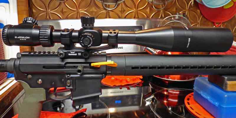

    Pictured is my entry into F-Class. It's a 22 Nosler so I'm stuck in F-Open with it.
    The list of 'High End' components :)
    X-Caliber 28" bull, 1:7 5R, No Gas port (25% off sale)
    15" ebay Float Tube
    BCA side charger and BCG
    Plain cheap lower
    MBT trigger
    Athlon 8-34X56 FFP scope (price matched, thank you Doug :) )
    TI-7 stock (was a return/clearance)
    Everything in the picture was a tad over $1000
    Including the home made wide bipod.
    I'll cover some mods I made in later posts.

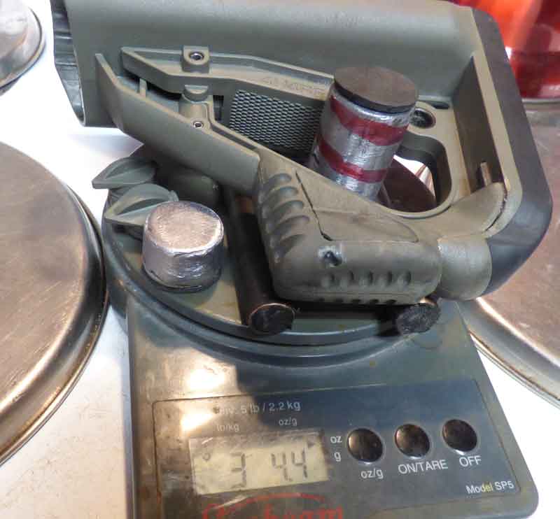

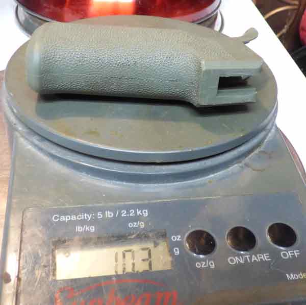

    I cast some lead to fill the unused space in the stock.
    and some lead in the grip. Weight is a little over 20 pounds so I have some room in F-open.

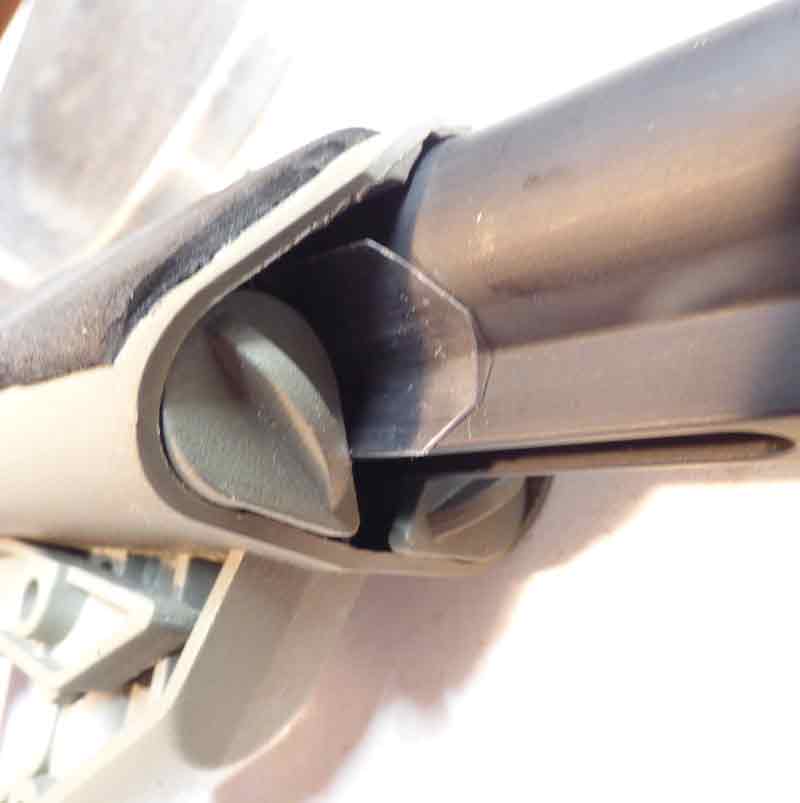

    I also put a plastic shim between the stock and extension tube.
    Takes a good bit of force to move it now. locks in and don't got no wobble.

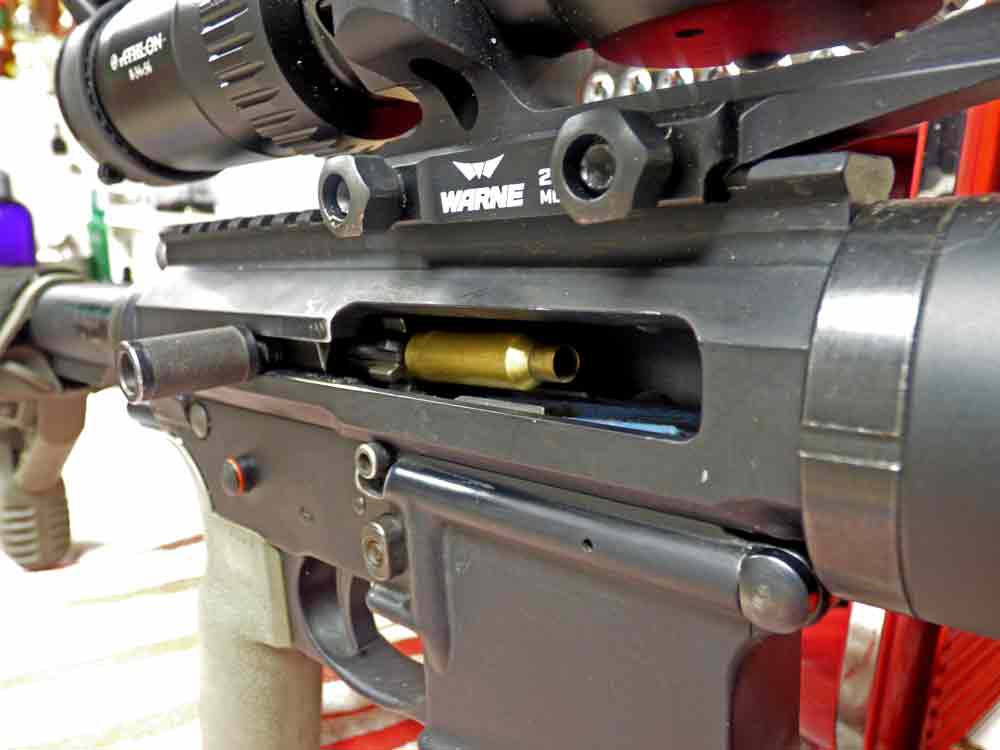

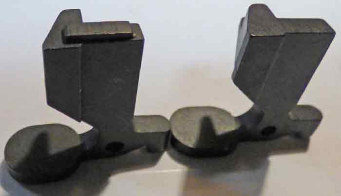

    With No-Gas I'm using a sled and single loading long. I use my firing hand to pull back the BCG, remove the spent case (cut ejector spring), load a round, and drop the BCG with a home made ambi bolt release.
    I can hold the bolt handle and push the release and ride the bolt and push it in just to be sure.

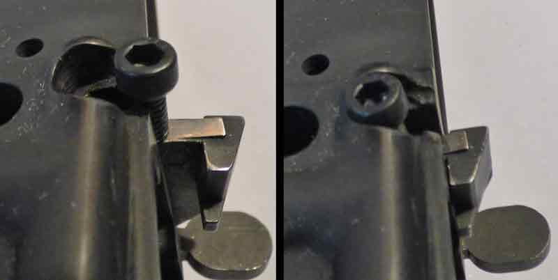

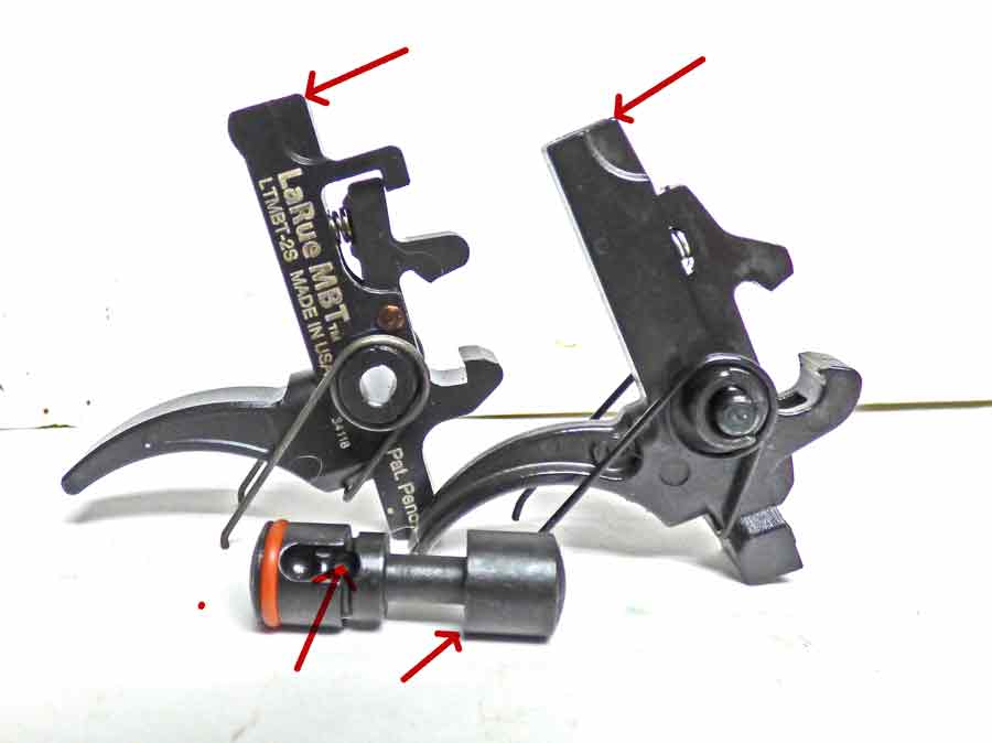

    I also installed a push button safety but a clearance issue between the trigger and the left shoulder of the safety (fire position) caused some drag I could feel with the Larue MBT trigger. Had to relieve the shoulder just a little. BTW, I just LOVE the MBT. Installed one 0.005" shim on the forward pin and one of those little plastic thingies at the rear pin.
    I'm running a H3 buffer (for weight). Range experts claim that is why I'm having a failure to cycle and eject :)

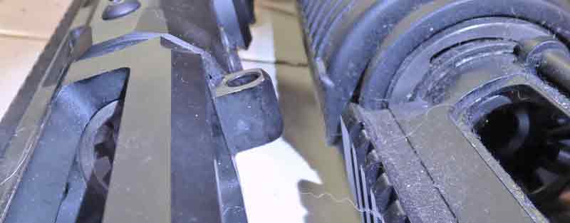

    I lapped the front of the receiver (looked like it needed it).
    I know, we had a long drawn out discussion on lapping.
    I do it. All the time.
    I picked the BCA right side charging upper since I would be prone, No-Gas, and it seemed stronger.
    There where other but more costly options.

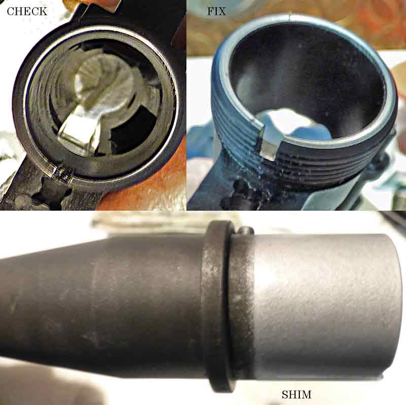

    I check for squareness by lapping a little with polish. Break through the anodize.
    Then lap for 360 contact. Not the 28" barrel in this pic.
    7051523

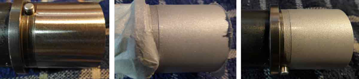

    For diameter fit I measure OD of the extension, check extension slop in the upper, then mask and spray a thin coat of High Temp paint. NO ONE Does that. Really thin shim stock (half thou or one thou) is hard to work with and if you do a thermal fit, LockTite is messy.
    Let that dry well and burnish with 800 grit paper for about a .002" increase (about 0.001" of paint).
    Do a warm/cold fit up then lock in place with a barrel nut with just a heavy hand tight. Let it sit.

    Caught a 20 MOA mount on sale ($75) and put it on the receiver.
    index.php
    I originally started with a Bald Eagle mount and a home made 3.5 pound bag rider (lead filled), but now use a home made bipod (pics of that later).
    In the next installment :) what I did to make charging and extracting easier with a straight pull no-gas AR.

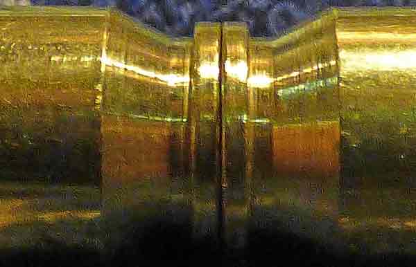

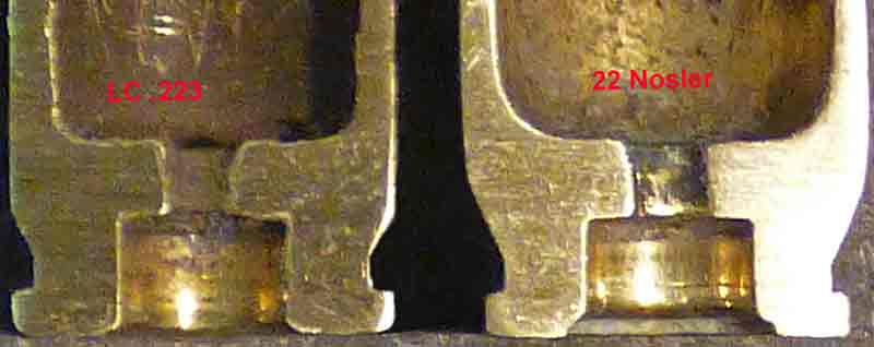

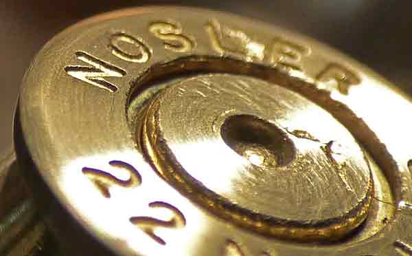

    The No-Gas aspect of an AR rifle does take some getting used to. A rear charging upper is a pain to pull out a stuck case. Gas operation generates a lot of force to open the bolt. So much so that many folks dissed the rebated rim, soft brass initially made by Nosler. Complaints about swipes, blown primers and pulled rims.
    I've had my times with brass that was hard to extract. The side charger seems more suited to prone shooting.
    Early brass from Nosler often had Sharp rims, like they missed a processing step.
    They said "it's made like that just for the AR" (a Blond said that) :)
    I tried the 6mm Hagar/Nosgar necked/bumped/trimmed (with a 6.8 bolt) but now that I have some experience with the 22N case that's what I shoot most of the times. So far 5 and 6th fired cases only have a few culls due to loose pockets.
    Then brass started showing up with beveled rims and things got better.
    Some Factory ammo orders from vendors would still have sharp edges and require beveling at home.

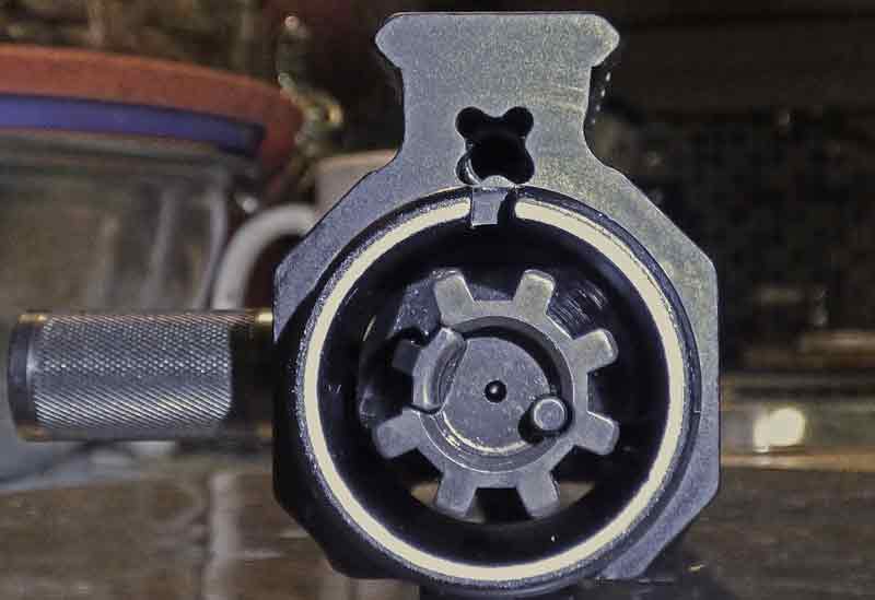

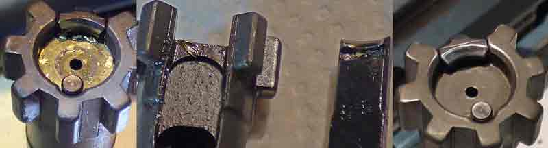

    I still have some 62gr ammo that WILL get the treatment before being shot. The sharp edge gets knocked off when the extractor snaps over going into battery. Beveled brass, and some smoothing of the extractor, bolt face and ejector edges eliminated the brass shavings jamming up the bolt. I can now just blow the brass off with Brake cleaner. I'll post the other stuff I did to the bolt to help with extraction.
