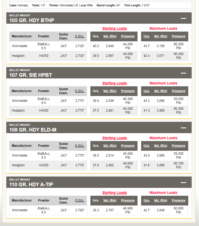

I’m also about to start loading with Hornady brass and 108 eld-m, but I’ve been looking into the StaBall 6.5 powder. Anyone have experience with it and h4350? Any insight is welcome.
Based on this I would say that staball is a bit slower powder for that bullet than the h4350.
But Ive also seen reports in the staball thread, mainly with this one starting here and ending here, that maybe bumping the charges up on the ball powder a bit more to get better case fill may be a good idea.
So what I would do is to load your initial load test up from 40-45gr in .5 gr increments and see where you find pressure. Im hoping you find it and then we can stop there and pull the remaining rounds. But, since this is a newer powder, testing a wide range to discover exactly where your safety margins are will be a very reassuring exercise for your reloading with it in the future.
