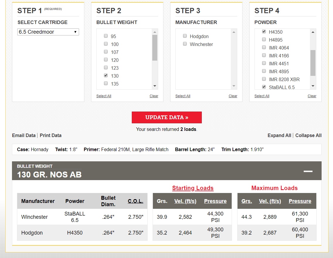

On a side note, did Hodgdon lower the H4350 numbers in their online reloading database when staball was released? I don't remember what their numbers were before but I really think they lowered them to make Staball look better. After Staball was released, the current max charge listed on their online load data for a 130 gr bullet in 6.5 Creedmoor with H4350 is 39.2 gr which is laughably low.
Hodgdon Official Reloading Database
Yea, after my very premature and short testing, it's looking like the only benefit is metering. And if I can get the speed up and SD down, that's a pretty big deal. But I'm not holding my breath right now. I had high expectations due to the claims from Winchester, but my first ladder severely tempered those.
I think you’re right, usually hornady book is below the Hodgdon website and they are listing 42.8. Which seems more accurate. I load 42.4 in my 140 loads for my creed and 41.6 for my 147s. Why would they do that? Are they trying to push the staball? Or? It doesn’t make sense, they stand to make money no matter what powder they sell am I right?
Also they list the FPS at 2687? Why the fuck would you want to run a 130 that slow. Isn’t that Grendel numbers with a 130?
Also I looked up 140’s on the site with h4350, they now say max with a 140amax at 2.82, is 40.6 and it’s a compressed load. Something is wrong with the site
Book (grains) is more like a guideline. If you had a way to measure pressure you would see that it takes a different amount of grains to achieve the same pressure as book with your rifle and loads. That's why it's a good idea to load up to find "your" MAX. And make sure you're jamming the lands in doing so.
Jamming in the lands will result in a different max than when using an OAL 50 thou off the lands. Jamming in the lands may result in premature blown primers.

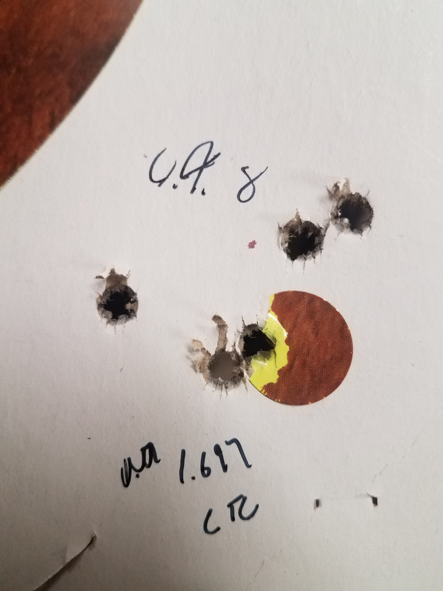

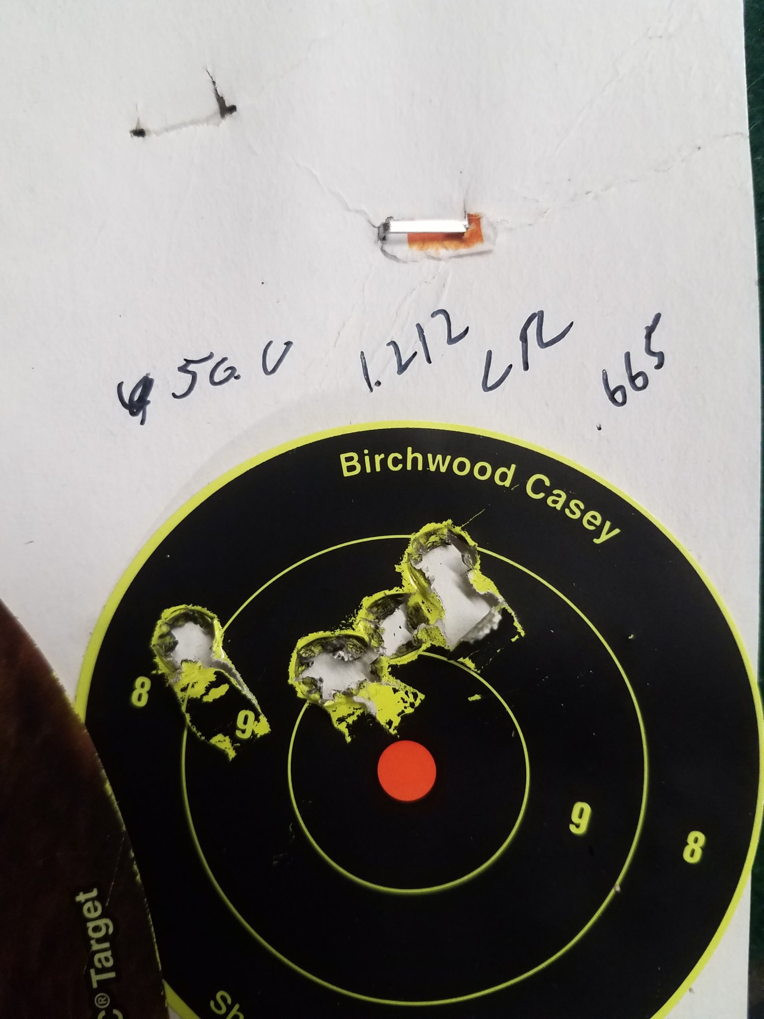

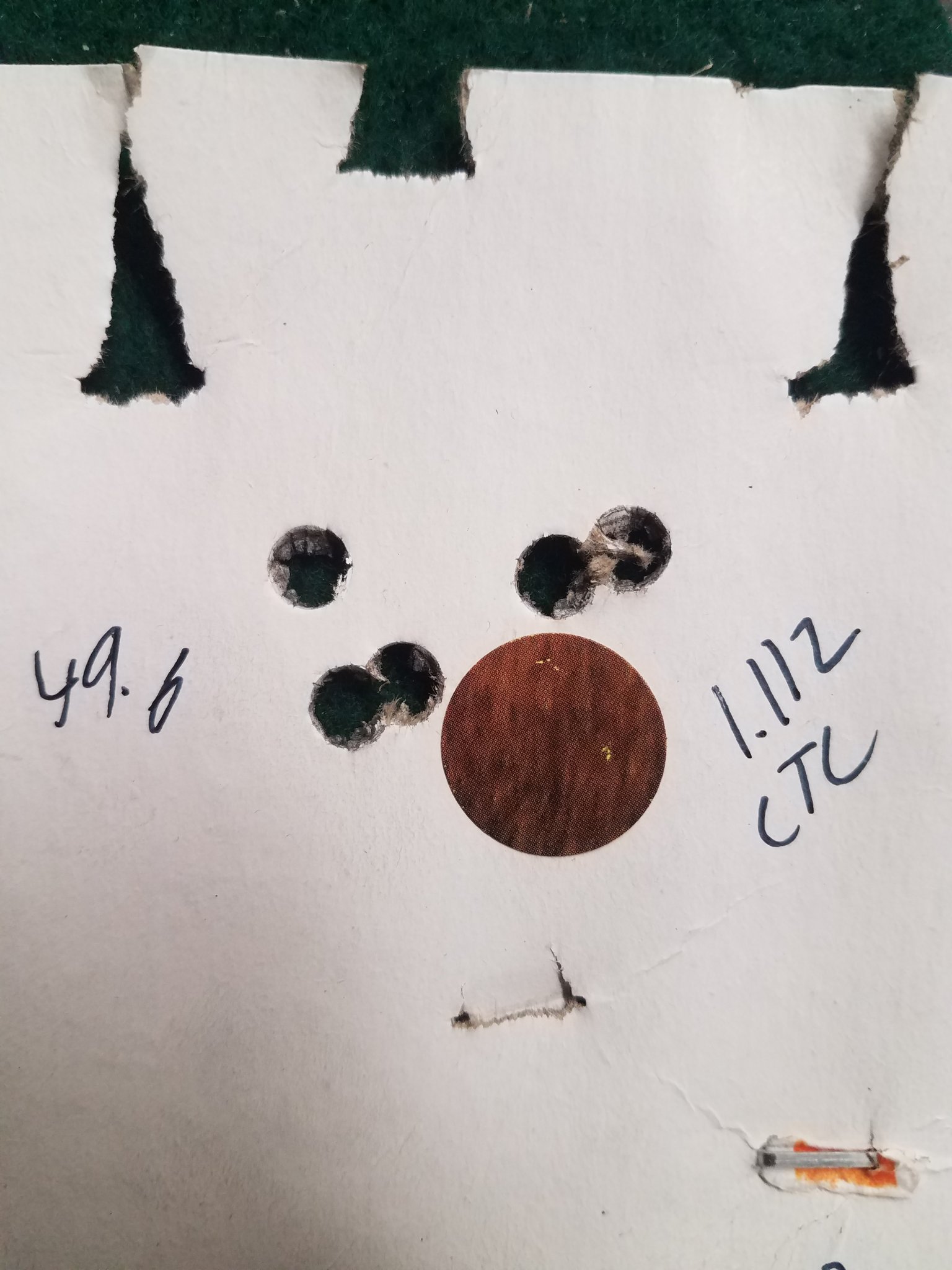

7mm-08 Ackley
FC 12 brass
162gr ELD-M
2.9 COAL
Staball
45°
107yards to target
49.6
2889
2886
2875
2881
2887
Average 2882
SD 5
49.8
2871
2885
2896
2887
2909
Average 2889
SD 13
50.0
2882
2905
2904
2906
2907
Average 2901
SD 9.45
Accuracy was ok. See pictures below. The middle load was weird. Had hard bolt lifts, worse groups and higher SD. On that last group, I pulled that one to the left. I was getting nervous. I feel like it would've been under or a round 1 MOA
