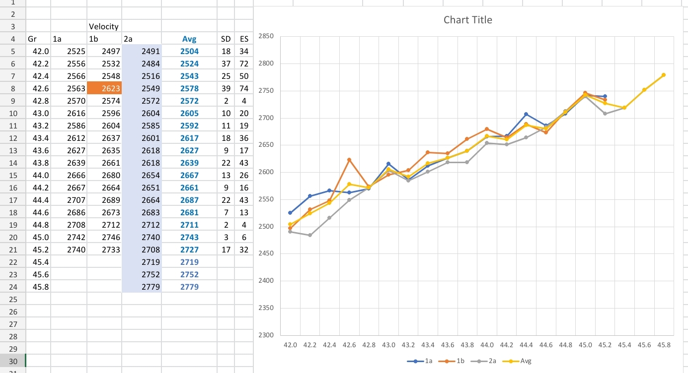

DISCLAIMER. It's technically 2 ladders run together so the ave, es, and sd are skewed. I had some old sized and primed brass that I wanted to shoot so I loaded that up along side my new norm. difference is
1a,1b (Full length sized, Win primers, -.004 neck bush)
2a (shoulder bump, 210 primers -.002 neck in blue)
