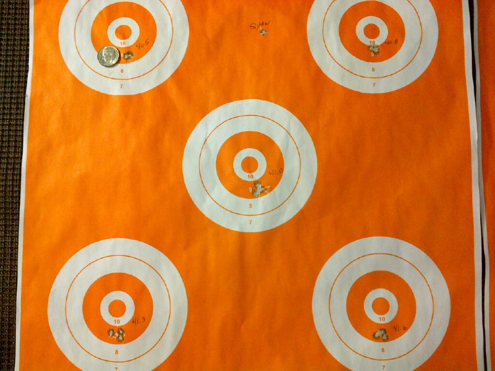

Here's an OCW test I did with 142SMKs and H4350. Not a gas gun, but will give you some ideas on charge weight.
2.81" COL and brass was fully prepped to specs.
3-shot groups...
