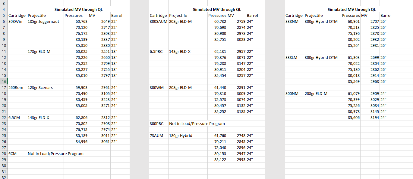

Hi,
I have gotten several questions in regards to expectations of increasing cartridge operating pressures.
So for purely Academic discussion (DO NOT ATTEMPT TO ACHIEVE THOSE PRESSURES) I ran some common cartridges through a QL type simulation program for pressures and MVs and this is what a few of them looked like.
Note: That I did not go through the program testing various powder mfg/types...I pretty much just used VV across the board.
Sincerely,
Theis

Hi,
Sincerely,
Theis

Hi,
Well I left Concept #3 purposefully off the list and I did not use specialty monolithics for comparison of the traditional cartridges on purpose too.
Now...going to the faster twist rates for the specialty monolithics in either Concept #1 or Concept #2 puts the numbers in another arena :) They become even more impressive.
Sincerely,
Theis
Pretty decent speed gains that could be achieved using the option 2 then as compared to a standard factory conventional bullet load in similar weight class.
I'm assuming if you go up to a 27" to 30" barrel, possibly just a bit more as well.

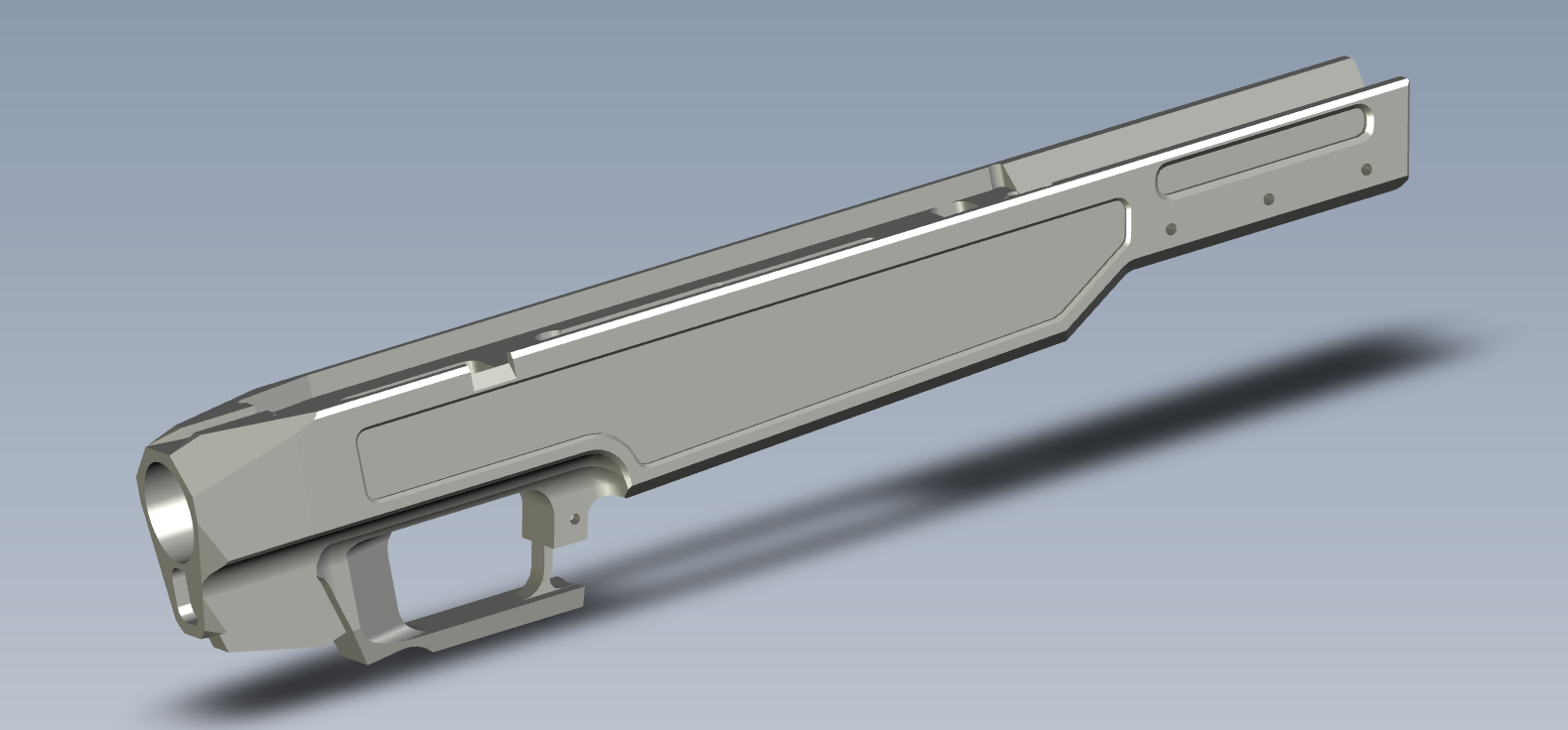

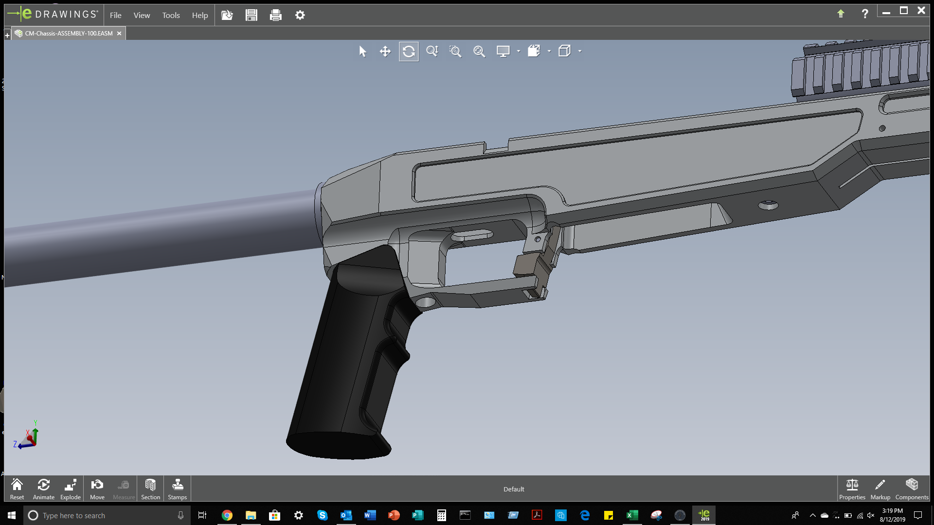

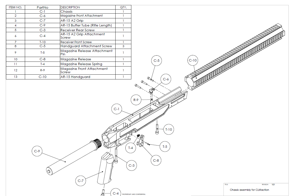

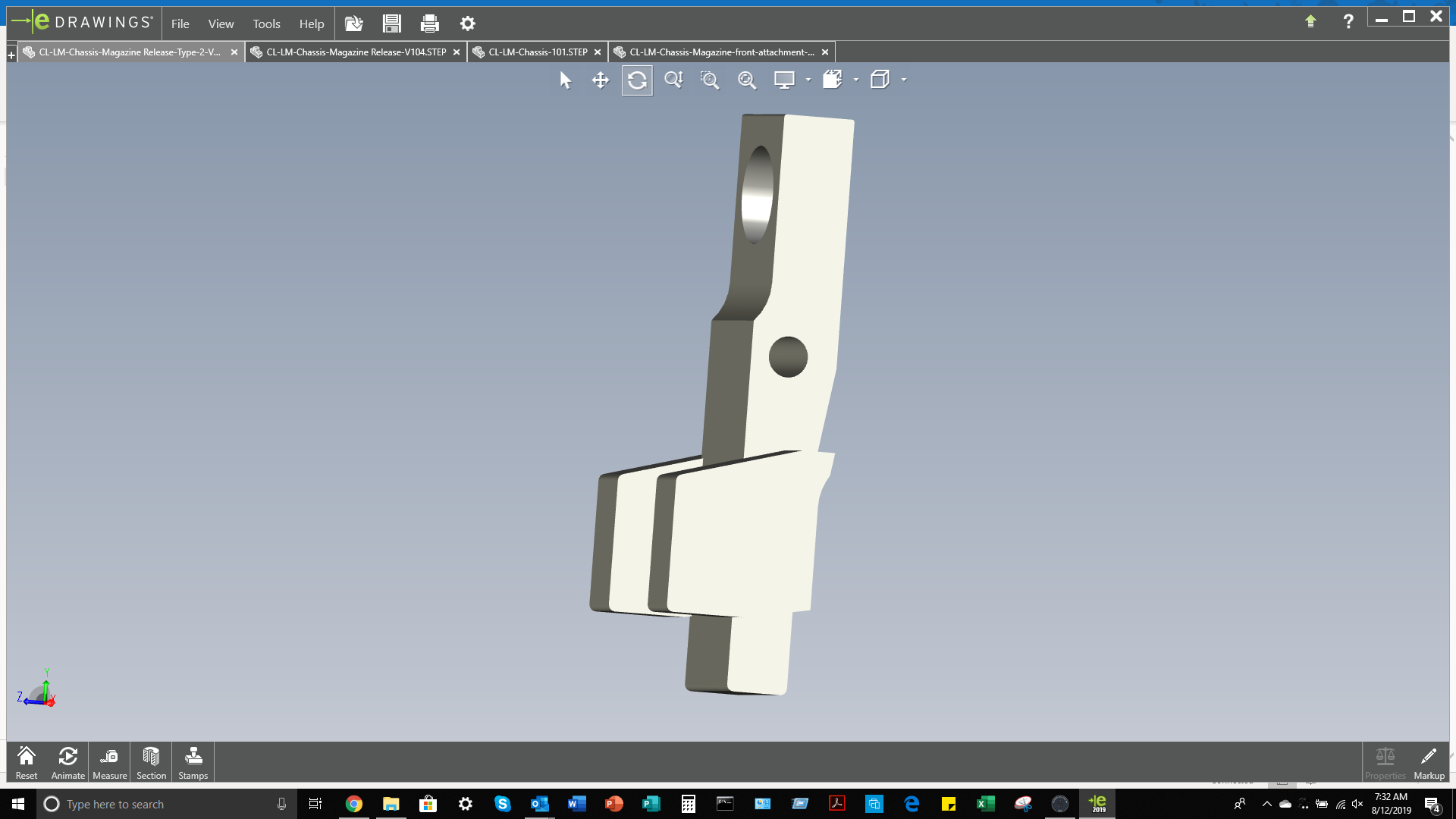

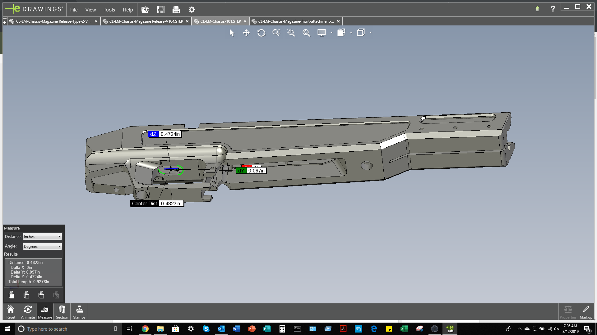

So I spent the weekend working on various magazine release designs for our Doru chassis system and wanted to see which style of magazine release you all like better..the blended release or the "grab a tab" release?
Sincerely,
Theis
I’d be happy with either.
First pick would be the first one.
Ambi design kinda negates the need for a tab.
Reactions: THEIS
more of a blade guy myself
for those who have used the blended design, how does it work with gloves and cold fingers
i can be persuaded
Reactions: THEIS

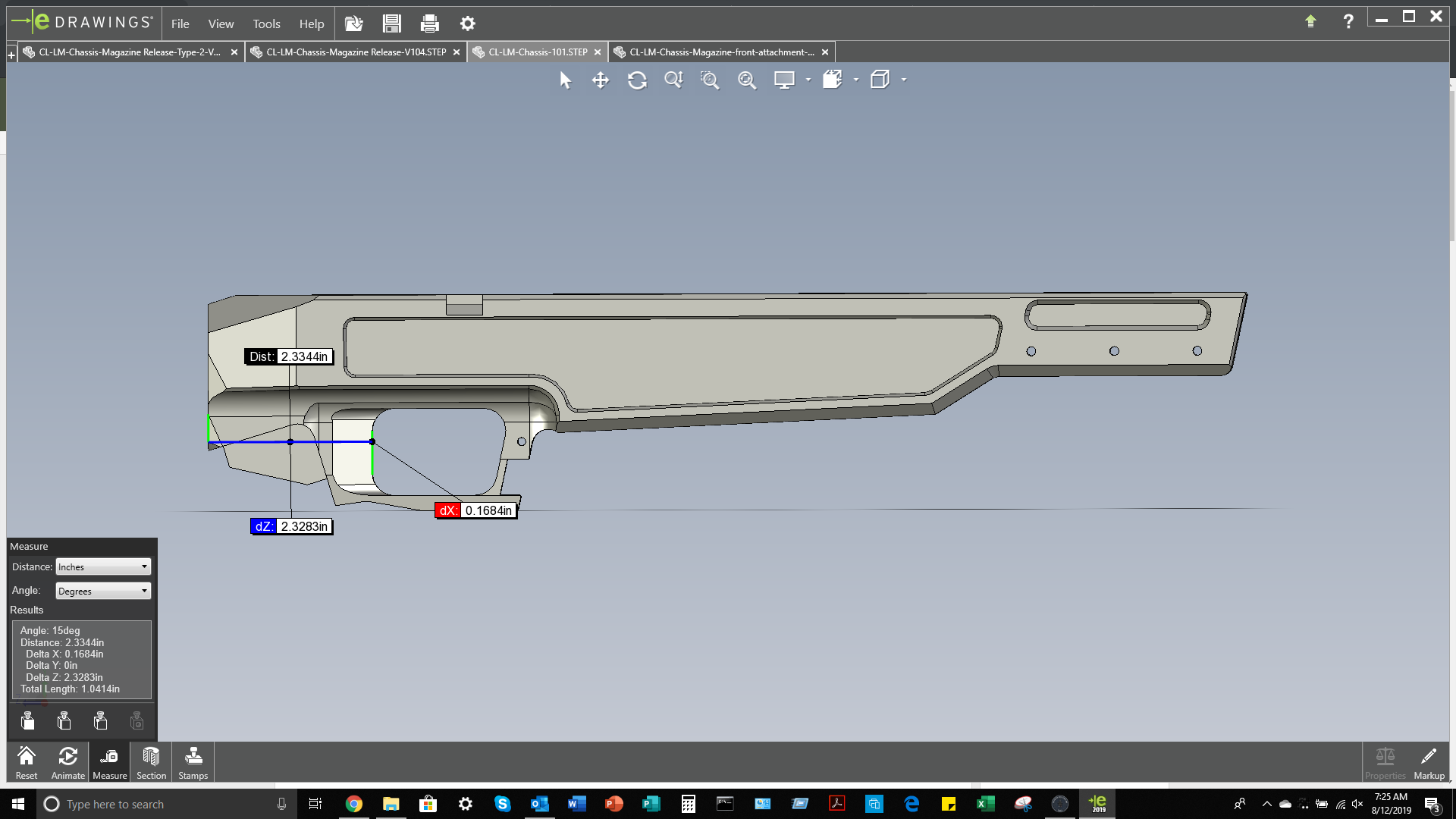

Hi,
I actually personally like the "grab a tab" design because it allows the user to press the mag release and grab the magazine itself in 1 motion...especially with gloves.
Trying to grab the magazine with just the blended mag release is not as easy.
For pure dropping of magazine both designs function the same IMO.
Sincerely,
Theis
Hi,
Sincerely,
Theis

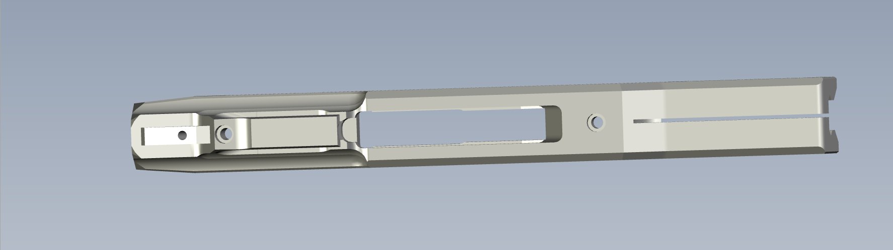

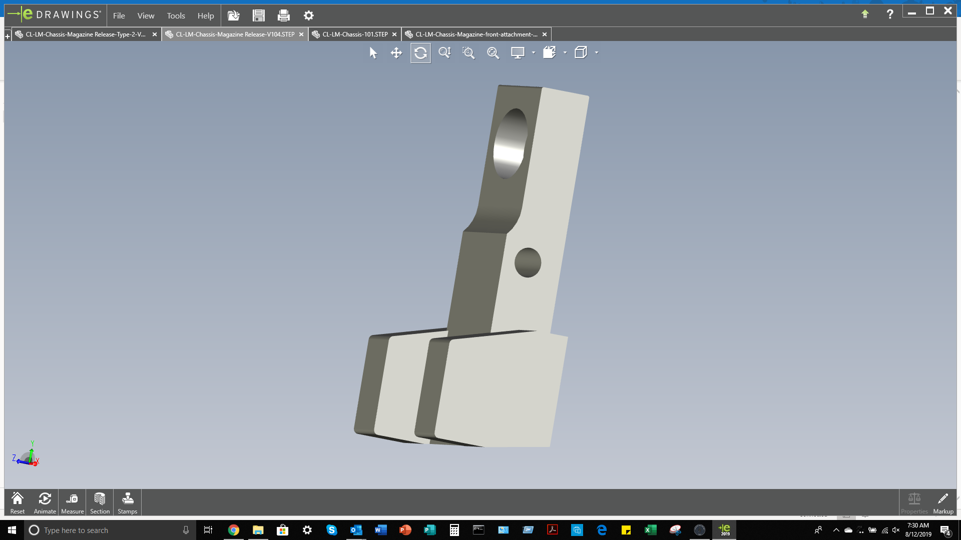

Question
Ambi mag release pushes away from trigger correct?
The pivot pin seems to dictate that so you can grab the mag and pull inwards with thumb?
Hi,
Pushes, both designs push.
As can see here, the "blade" does not protrude past the trigger guard but rather the trigger guard is designed with enough space to "grab a tab" to release while grabbing magazine itself at same time.
Or
You can just push either side of the magazine release for drop out.
Sincerely,

That grip/ trigger LOP is definitely turning into a personal preference thing. I have big hands and can't abide the original Foundation Manners MCS T4 LOP. An adjustable, universal AR grip would accommodate the most amount of people but sounds like a giant PITD to implement.
Is it just me or does that AR interface look downward canted?
It is downward canted to make many AR grips more vertical.
Reactions: THEIS
Hi,
The grips can definitely be changed out for fitment of different hand sizes, I was referring to the actual distance specifications from mount to trigger opening.
Hi,
Correct and my personal preference is the Ergo TDX-0.
Sincerely,
Theis
Hi,
The problem with grip to trigger LOP is that by its' very nature nobody is really the same, even when they have gone through the exact same school house and assigned to the exact same units...techniques will vary.
A shorter grip to trigger LOP can always be increased via different grips IF the system is built with "shorter" as primary.
A longer grip to trigger LOP can be decreased via different grips BUT only to the distance the mounting interface to trigger will allow.
These 2 guys are from exact same MEU on exact deployment and look at their different techniques..so my measurement was to get conversation started with trigger pullers such as yourself; to get thoughts, ideas, why and why not type concepts going.
Sincerely,
Theis
Reactions: brianf
