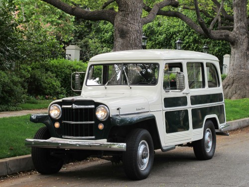

Holy Moly! that is a'mazing!
I have a 57 Willys Wagon I'm bringing back bit by bit... That's why I bought it thou.. it's my bug out vehicle. the baeuty is --it gets rough and I still got a roof over my head.
Sadly having to pay mechanics to do it part by part! Every time I blink it's another grand.
Wish you were closer hahaha...
Where do you get your parts?
Walcks? Kaiser's? Ebay?

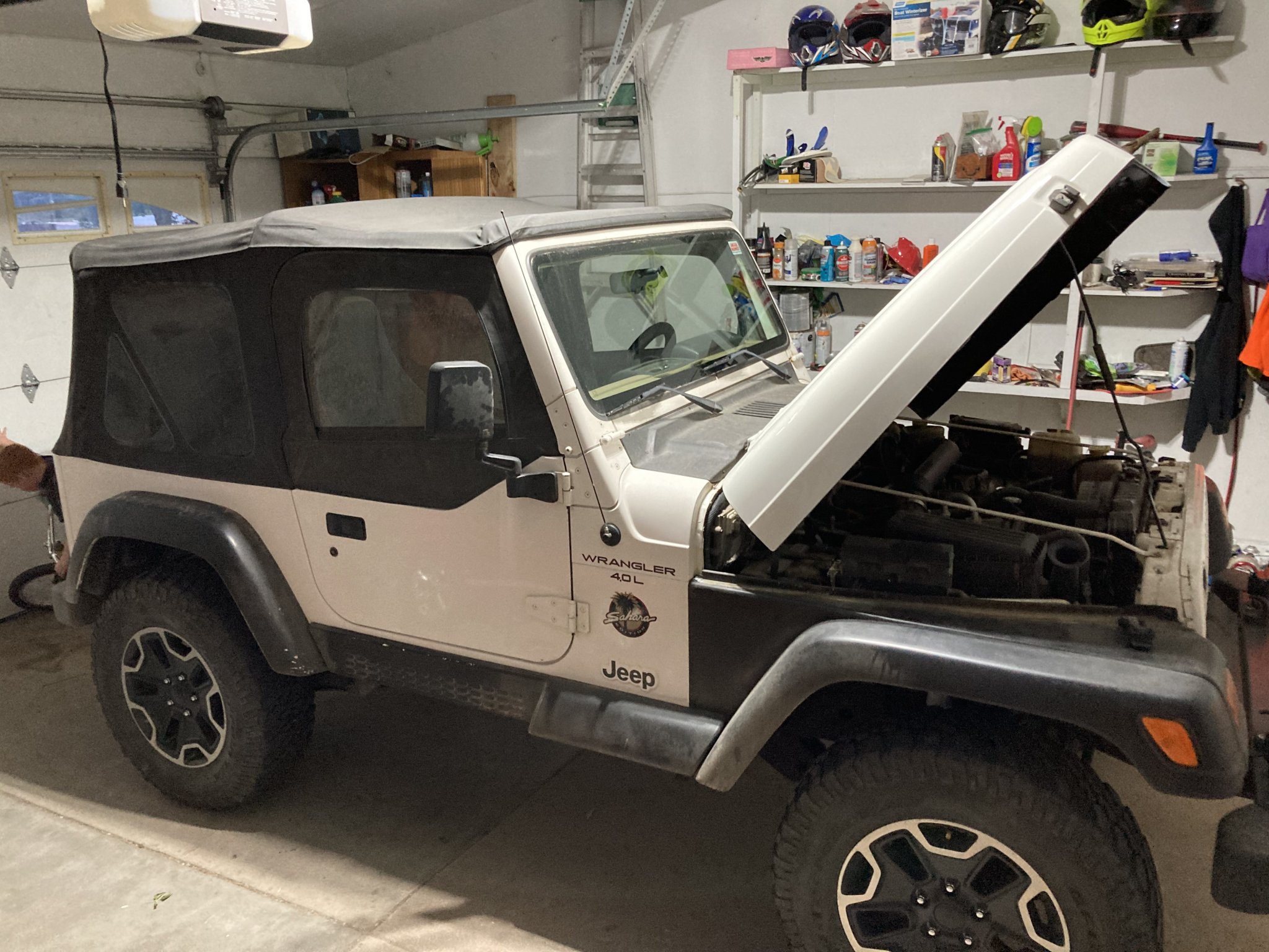

Depends on @gayguns living situation as well. I had the tools to fix some stuff on my cars (worn out suspension parts, alternator, and a few other parts) but couldn't do them at home cause I lived in an apartment at the time. They wouldn't let you work on anything there. Suspension stuff I did at my sisters house 20 minutes away with the jack and stands that I bought and stored there til I bought my house. Did the alternator in a church parking lot.
BTW @Daddyusmaximus great work. Looks great.

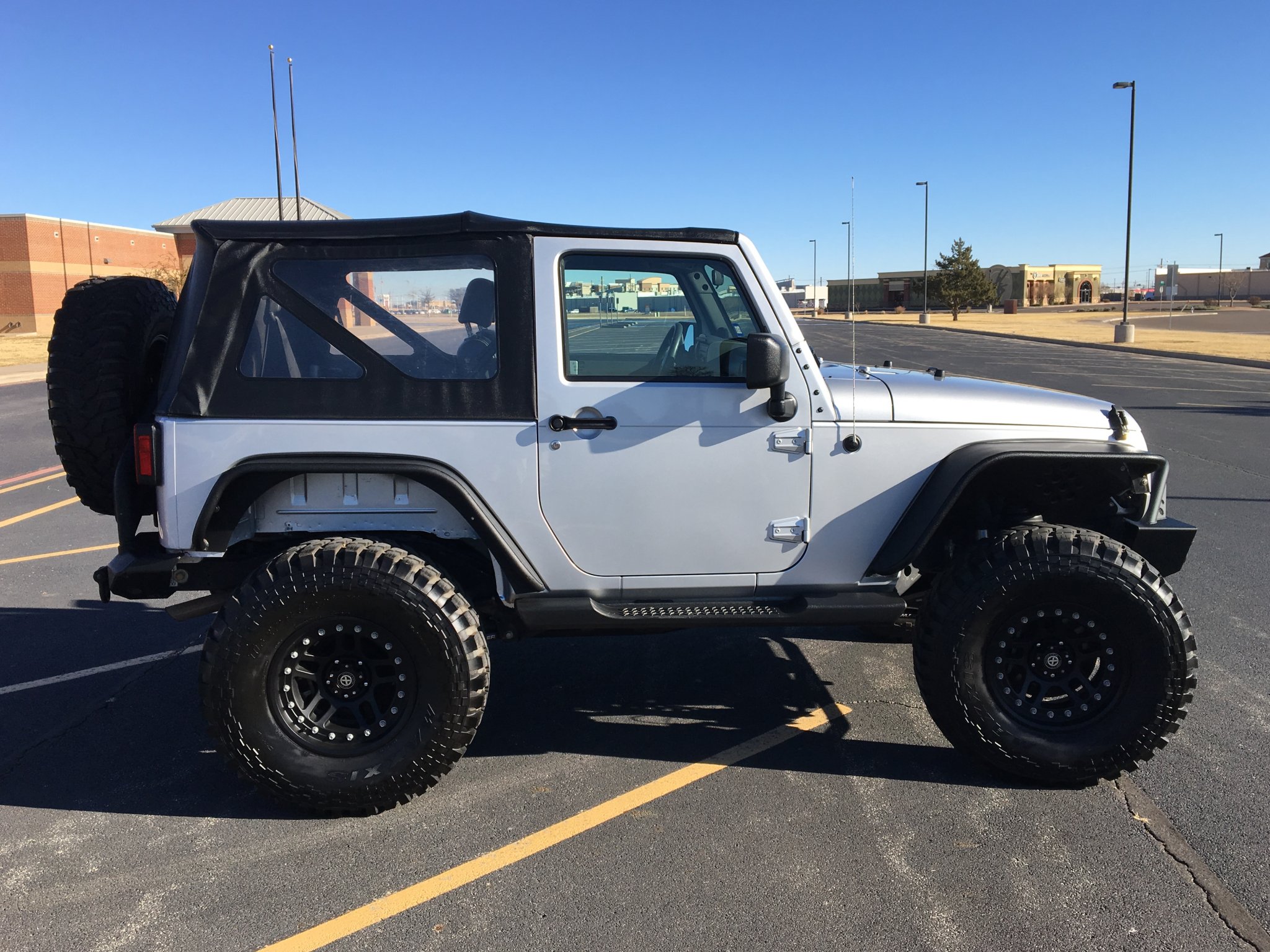

Parts are where you find them. Some have come from ebay, some from facebook Jeep pages, but most of the aftermarket stuff like springs, motor mounts, bumper... are from online. Summit Racing, and 4 Wheel Parts are a couple good sources.
I have new LED lights coming now from Rigid Industries. I got them from 4 Wheel parts back in 2011 for my old truck. (the ones in the bumper)
I took them off when I sold it, but they are being replaced under warranty. Had to go back to 4 Wheel to get them to print off an invoice though because I didn't save mine. I love a company that honors a lifetime warranty. They were sitting in a cabinet in the garage for the last 4 years, now they don't work, so I get new ones...
Remember those front spring plates where I had a machine shop modify one so I could use the factory swaybar? Well, that wasn't gonna work. It did bolt up right, but on the passenger side that made it in the way of where the U-bolt comes up. Dodge truck Dana 44 too different. Had the shop weld tabs on them to move the mounting spot a bit forward, then painted them. Want to be able to mount them up once the axle comes back and goes together.
Also trying to think ahead for once, and get ready for winter, so I took the tub out to the car wash to spray off the mud so I can work on it. Once home I set it up on my horses rather than down low on blocks. Cage almost hits the rafters... I'll be rolling it out on rims with no tires when I get done... lol.
