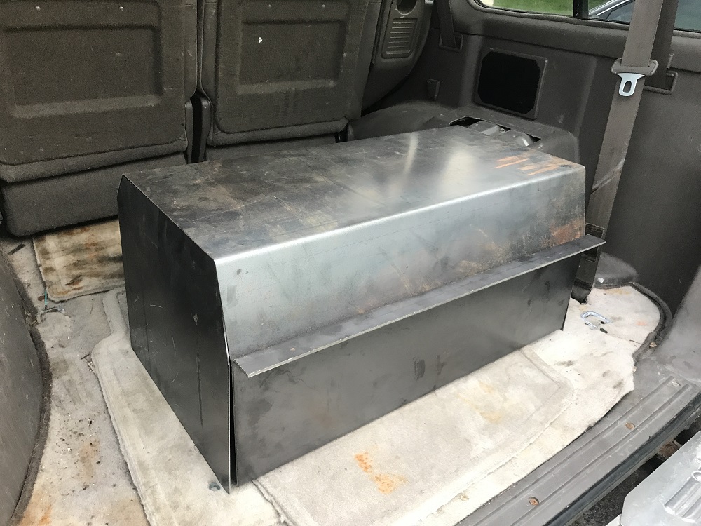

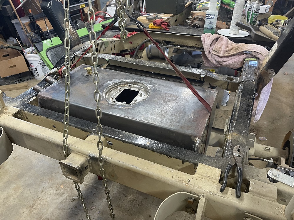

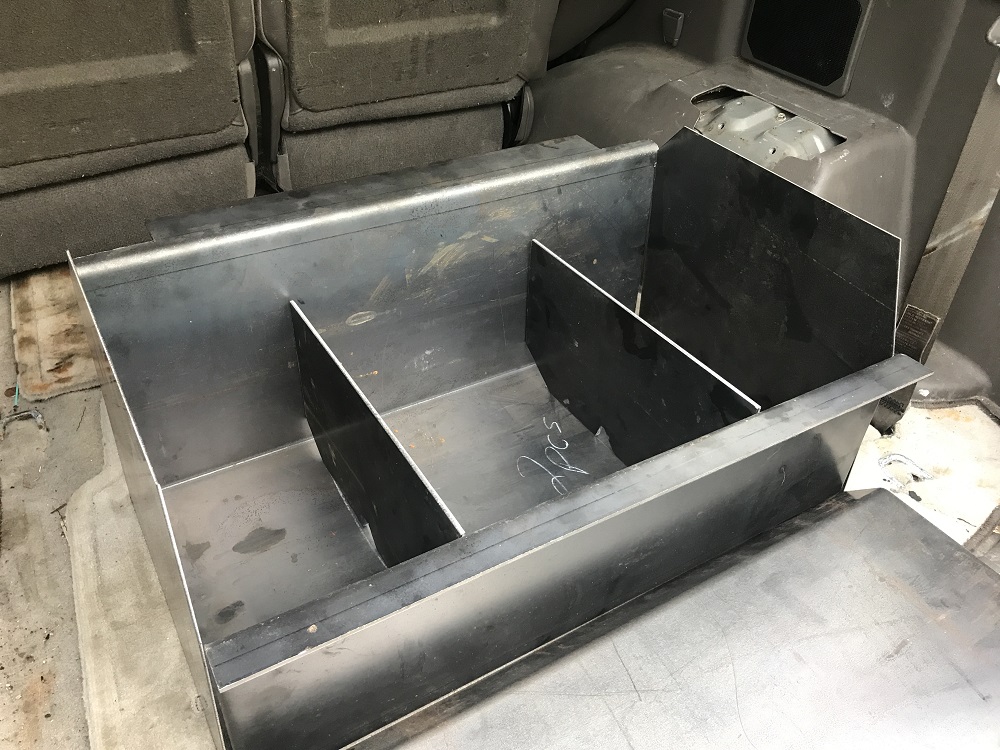

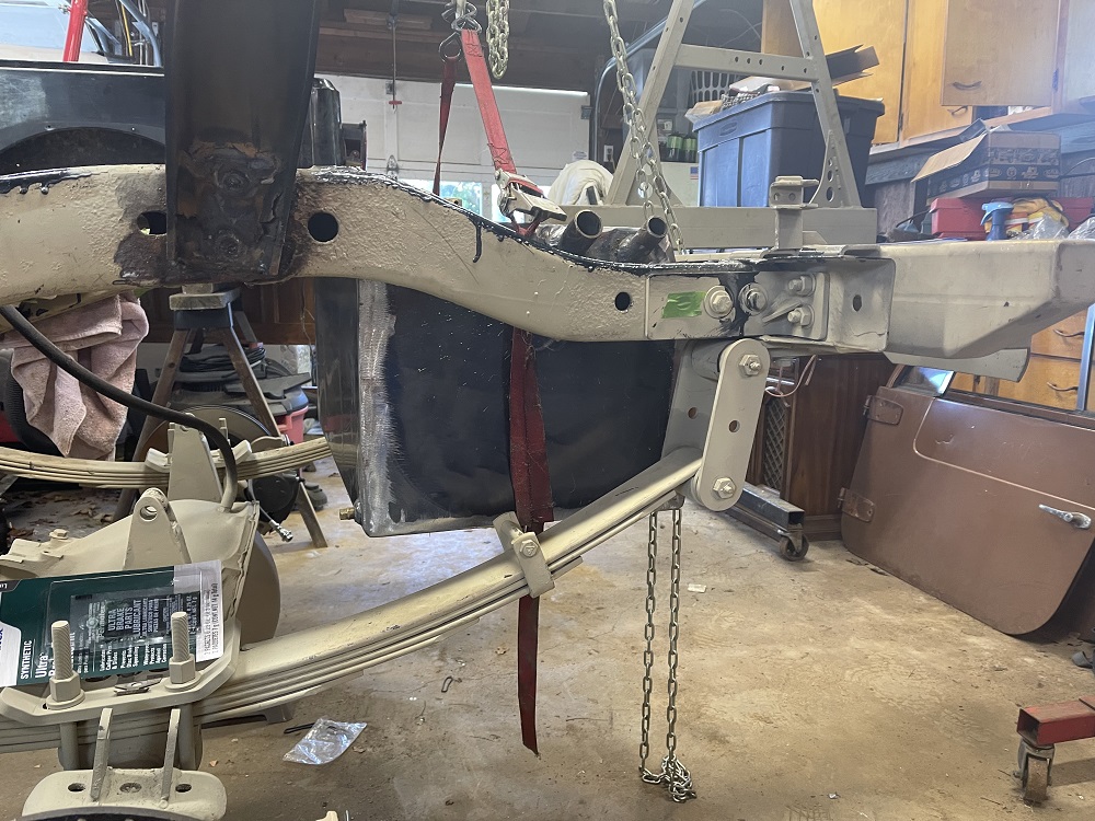

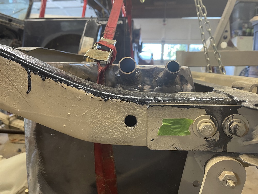

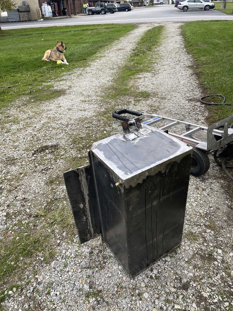

All the pieces of the fuel tank are done, and ready to be stitched together. Loaded them up for the trip to the welder. There will be no skid plate. However... the bottom "U" shaped section of the tank, and the baffles are made of material that's equal to the thickness of the factory skid plate, and thicker than the one from the YJ. Sides, and top will be standard fuel tank sheet metal to save weight. (and money) This will be a general purpose off road/overlanding/daily driver Jeep anyway, not a hard core rock crawler.
Reactions: camocorvette

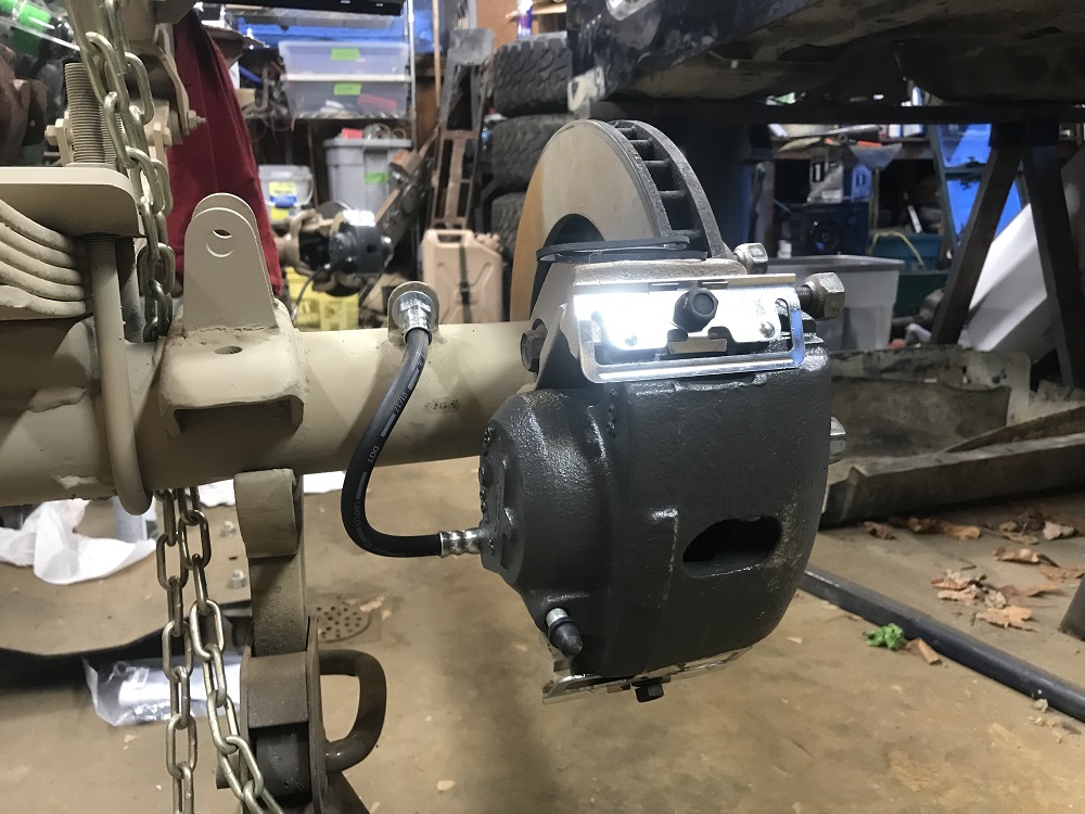

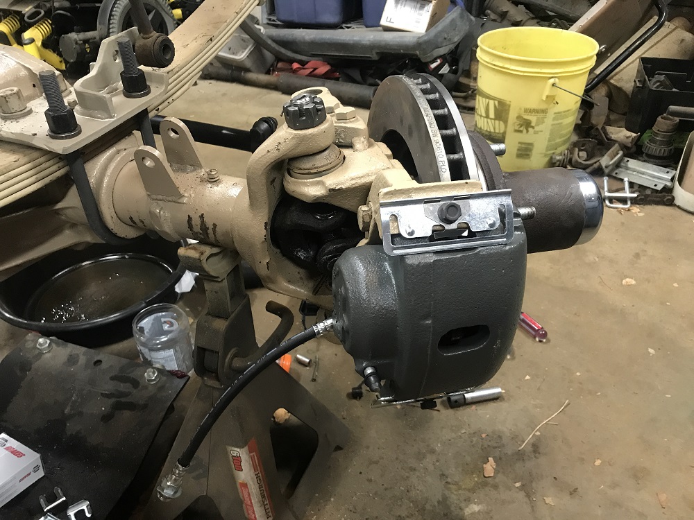

Also got my new calipers in for the 4 wheel disc brakes. Yes, I know they're on the wrong side with the bleeders pointing down... Just slapped them on for test fit. No brake pads yet anyway.
Front.
Rear.

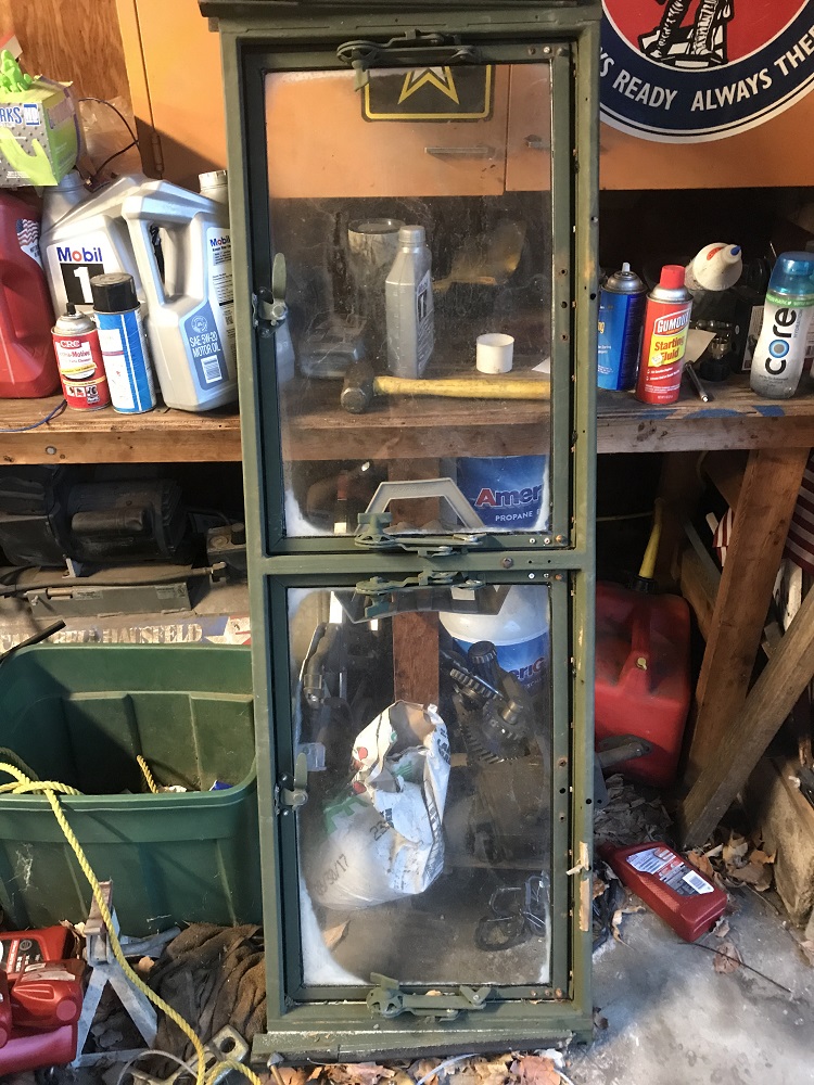

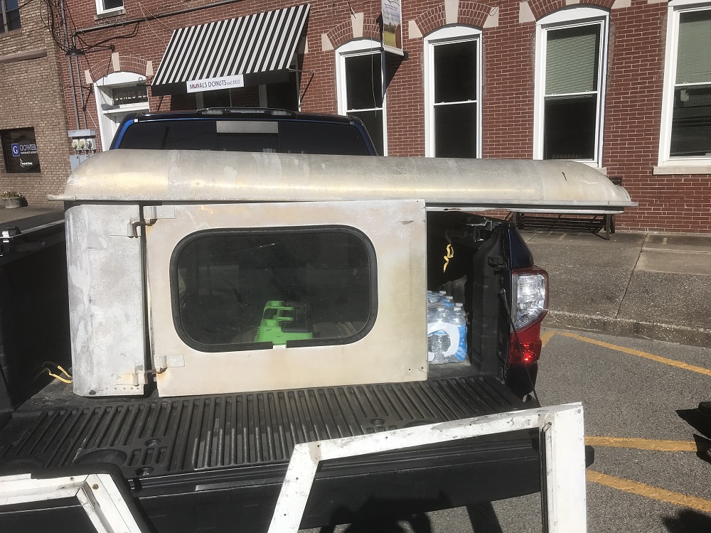

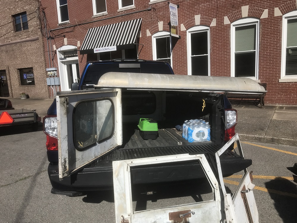

Looking ahead to after I get the tub back on, I picked up this baby..
If that looks like a deuce & a half windshield, where each side opens up... that's because it is. It will need to be cut down in booth height, and width, but plan is to build that into the windshield frame. One of my best memories (fun things) is just cruising in a deuce down the road with the breeze blowing in through the bottom of those windows that are opened several inches. Plenty air, no bugs. A lot of times I would set my canteen (or Pepsi/Gatoraid) right on the hood out in front of the windshield frame just behind the open glass as I cruise down the highway.

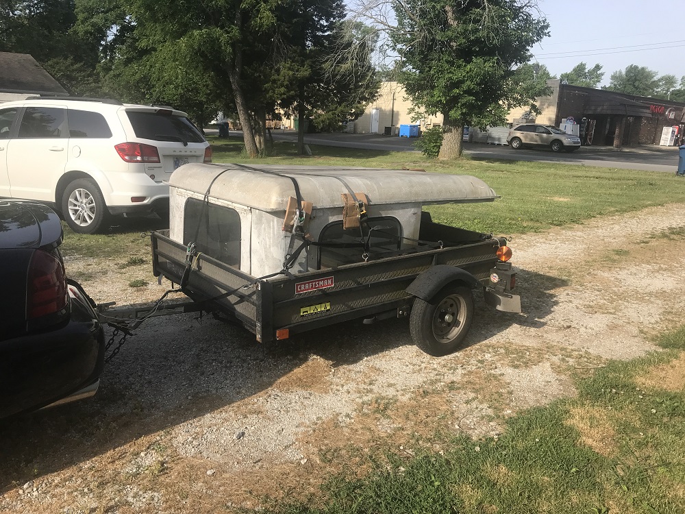

Wasn't sure how or when I was ever gonna get down to TX to get that top, but the guy who had it hooked me up. His buddy was coming up to Metropolis, IL (Yes they have a Superman statue) for an archery competition, and would bring it with. Met him down there yesterday. Still spent 10 hrs on the road going down there, and back, but that's a lot less than 17 each way to TX, and with premium $3.75 a gal... I jumped at the chance.
Here it is in Metropolis.

Safe at home this AM.
That looks awesome!
Score on the transport too.

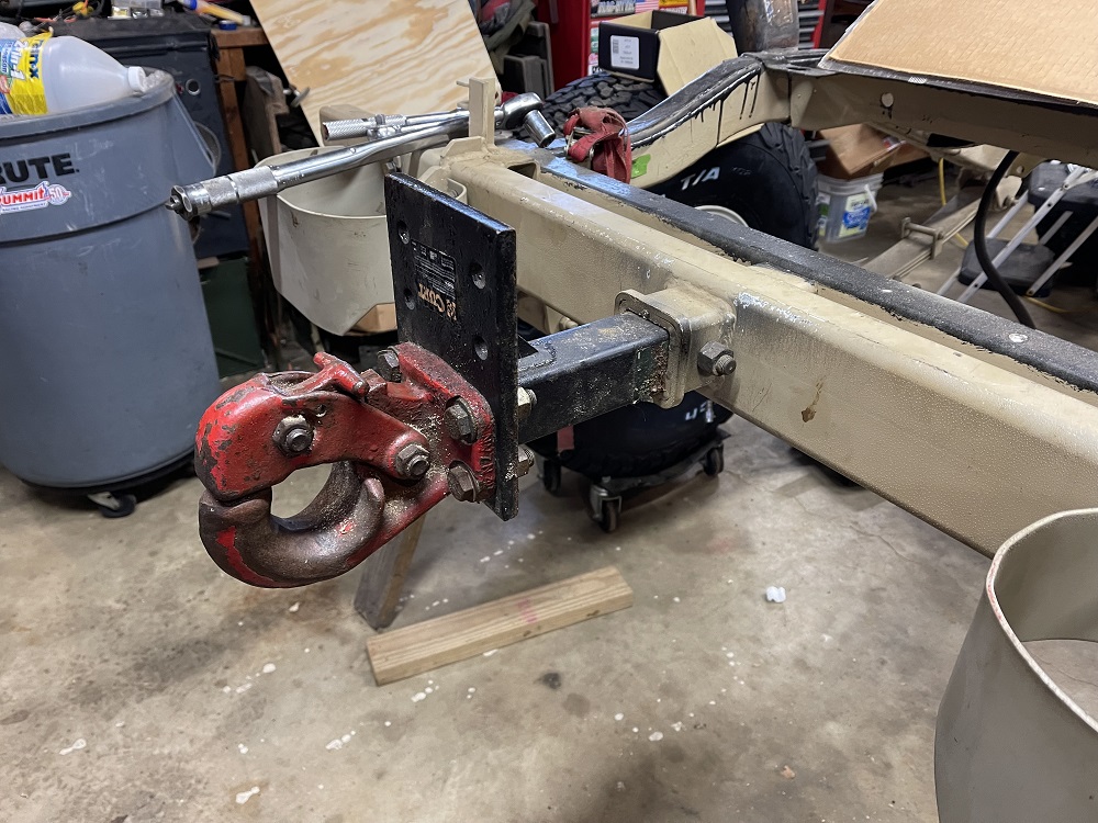

100Mph missile with that Dee shackle and snatch strap in the pintle hitch
That d-ring shackle is off an M1009 Cucvee, I think it can handle a CJ5... That is the propper way to put a strap in a pintle hitch... with a d-ring. You don't just put the strap in the hitch. As a matter of fact, prior to this, I used that d-ring many a times on my old F-250 Super Duty, and prior to that, my Suburban Cucvee look alike... to pull out others.... I'm aware it's not a screw type, so I don't side load it... As it is in the photo... That little green CJ5 rescued a Ford Ranger, and a Jeep JK the day after that photo was taken at The Badlands Offroad Park in Attica, IN...

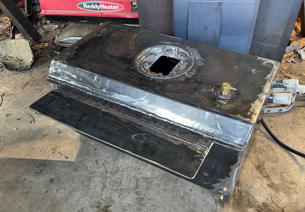

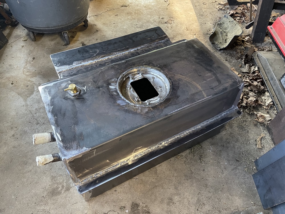

Hot damn! Been waiting on this forever... Welding guy finally fished stitching together my fuel tank. I'll get it cleaned out this week, then seal it, and get it painted, and ready to go in. I have to do the fuel lines, rear part of the brake lines, and move the rear shock mounts for the YJ tub, and I'll be able to get the tub on it to start the wiring. Probably get somebody started on the front bumper too, but I'm thinking I'll go with someone who doesn't take 2 months...
As is par for the course... I haven't done anything for a spell on the Jeep. It seems to come in spurts. Small spurts that are all too often, months apart. In any case, the heat of summer, being busy at the VFW, and my arthritis have all combined to keep me out of the garage. With the new fuel tank, I had hoped to get back at it. Come to find out, the fuel take was made incorrectly. The vent, and filler hose hook ups were just low enough to hit the frame... (but of course)
The guy said he'd fix it soon as he can, but a week became two, then three, then I took it elsewhere.
It's fixed.
So, then I go grab my bottle of Eastwood fuel tank sealer I got online to read how to apply it. Guess what? That's not a 1, or 2, or even 3 step process... AND, they want you to start by using their Eastwood Metal Wash #10120.

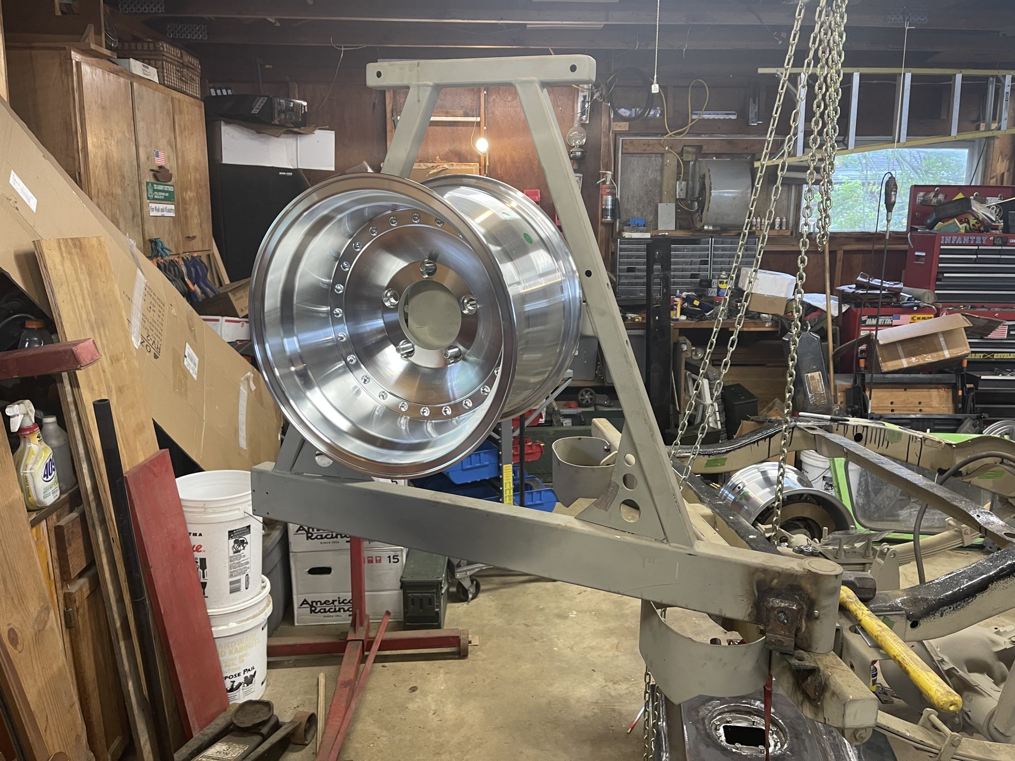

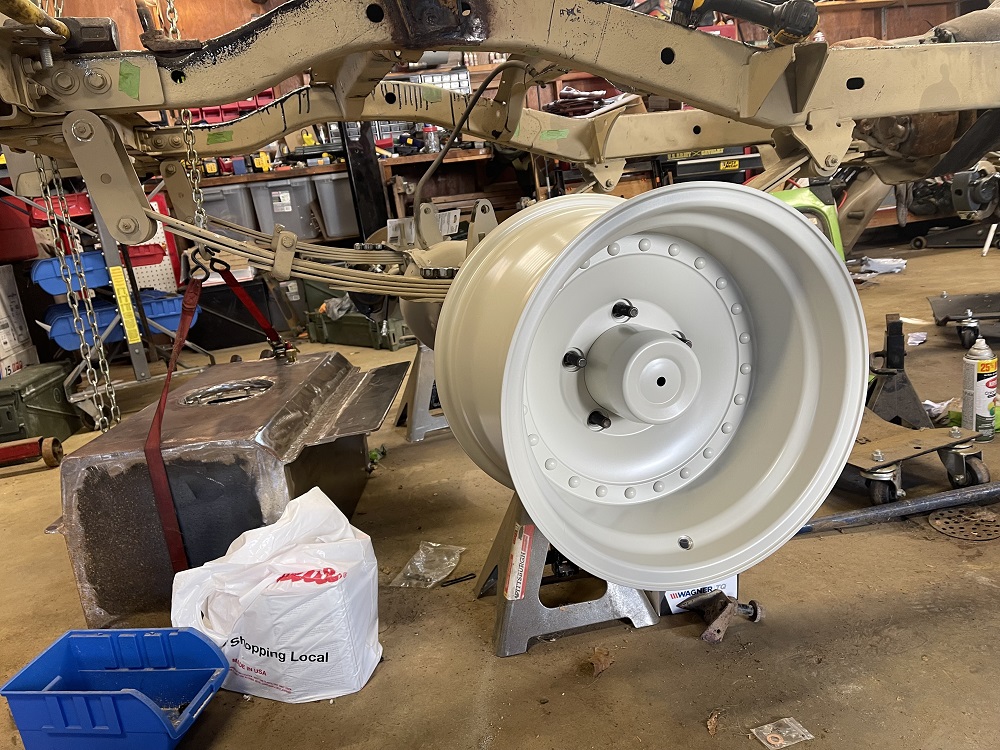

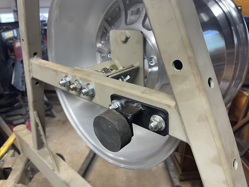

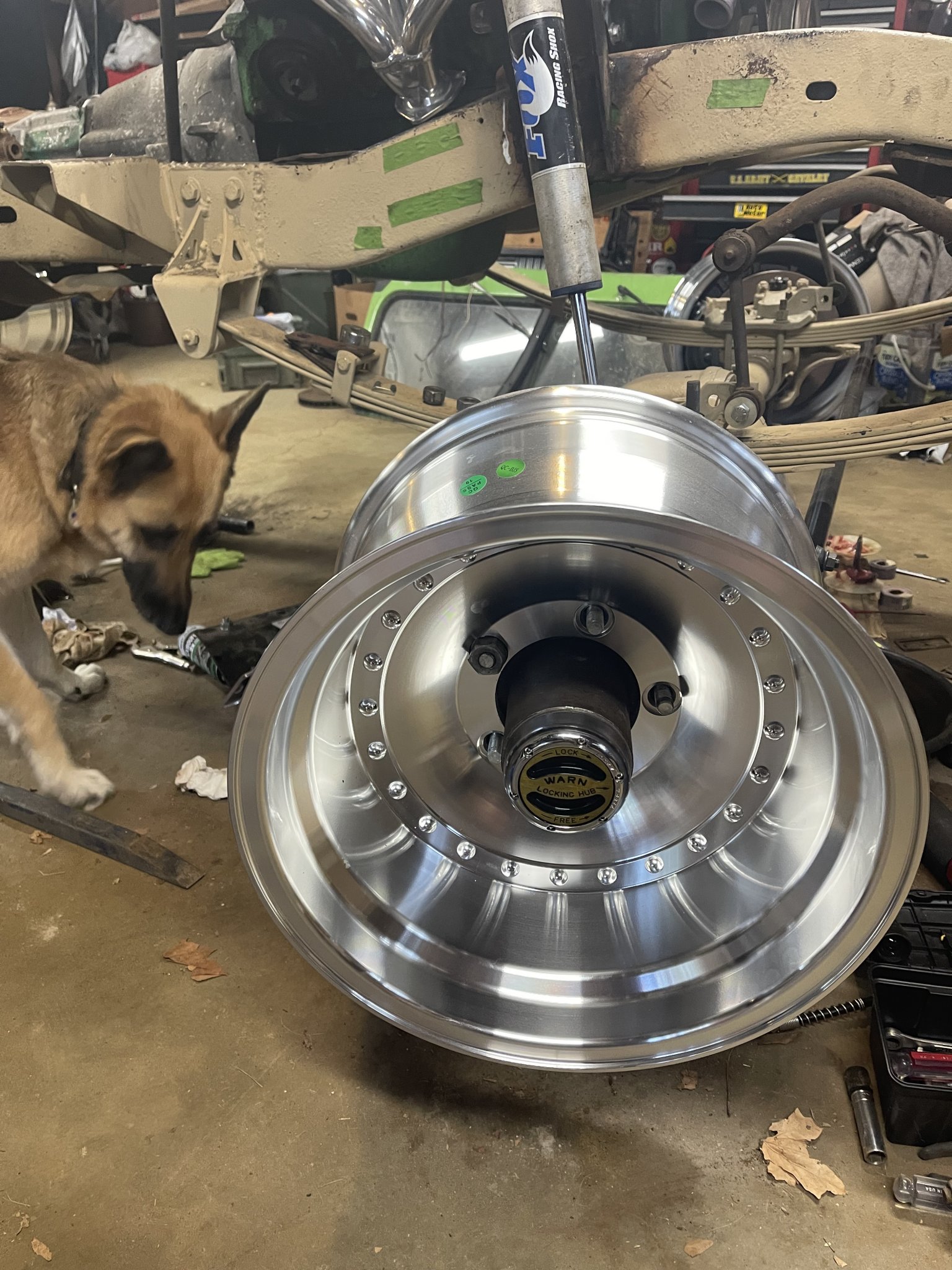

Wheels are back from powder coat. They look awesome except for one thing... The powder coat is a lighter color than the rattle can. Looked different on the color chart in the brochure. Probably close enough not to worry about. It's not gonna be a show vehicle or anything, but I may try to look for a lighter color or spray paint to match. I'll have to think on it. It's not like our military vehicles always had all matching parts anyhow.

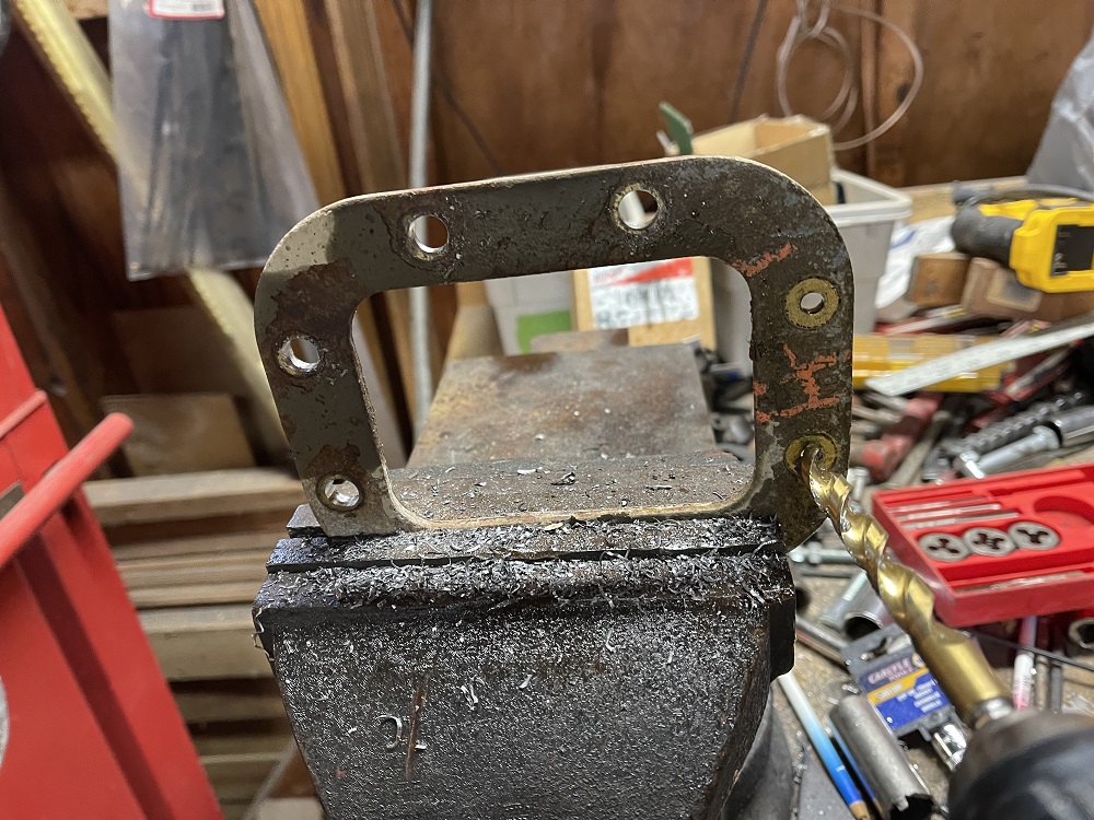

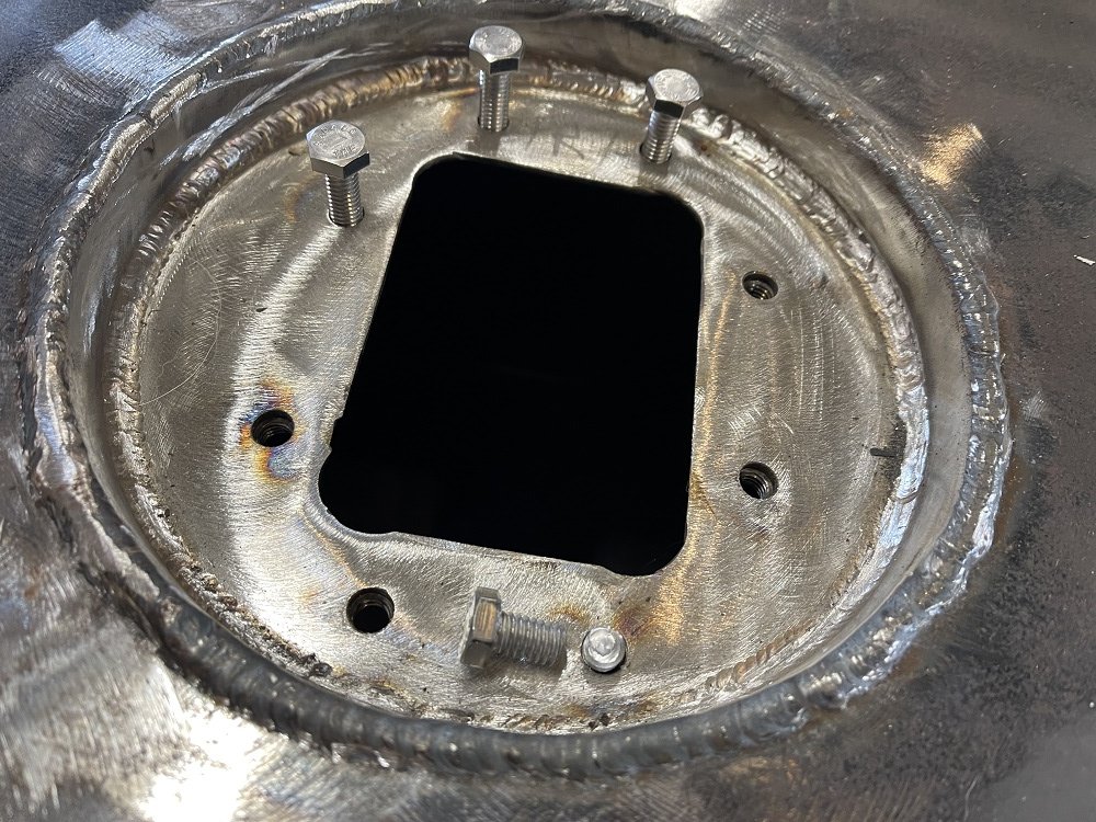

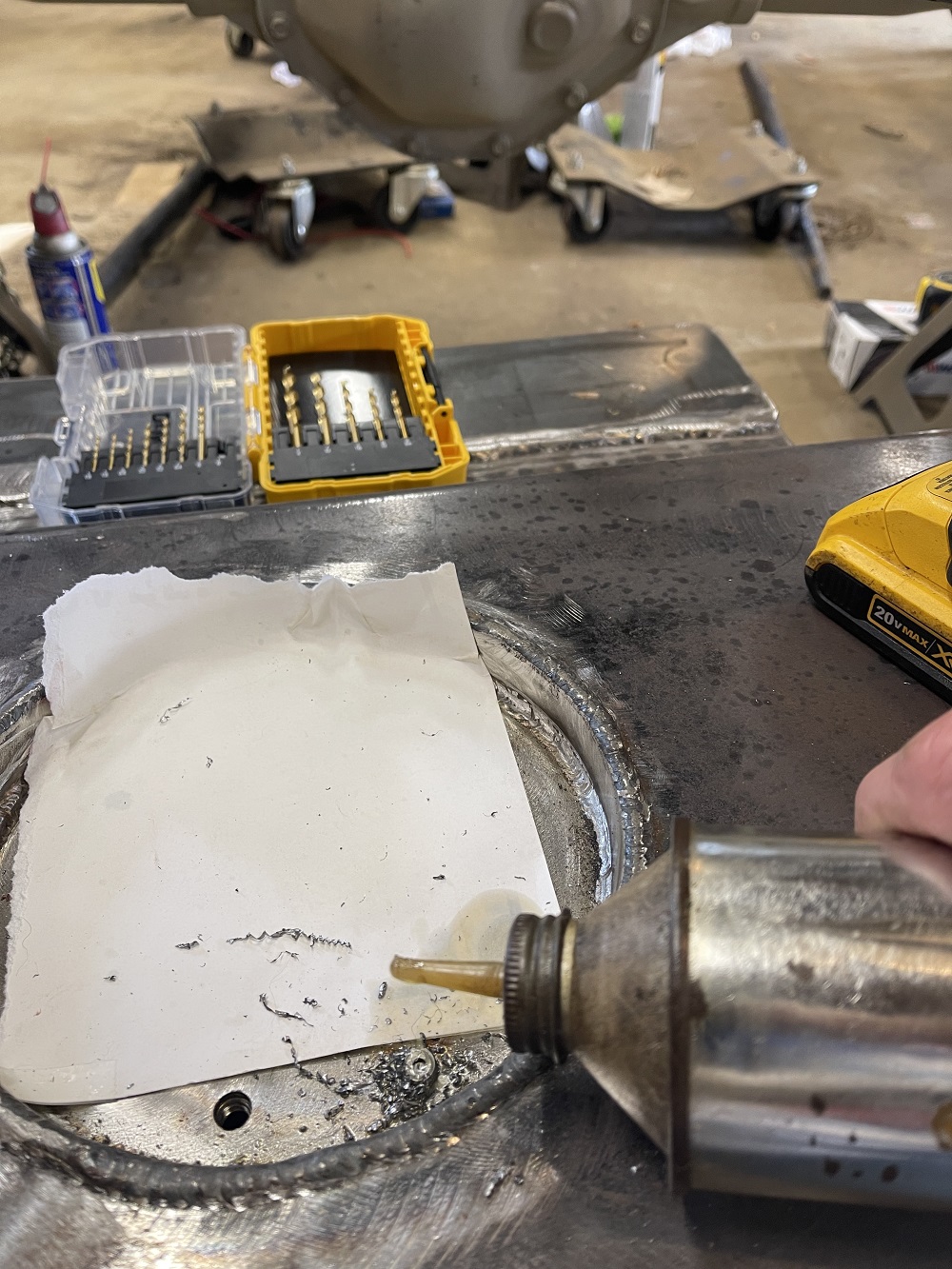

I started in on the procedure for the cleaning, and sealing of the fuel tank, following the instructions of the Eastwood sealer. Went to take the bolt out of the tank where the sending unit goes. The guy who welded it up stainless screws would be cool given the recess would collect water. Not sure if one was cross threaded, or the dissimilar metals caused it to seize, but this happened...
Nothing like the fun of drilling out a broken bolt again...
I get out the cutting oil I "borrowed" from the motorpool at Ft Hood back in 1985.
In order to wash out the tank with the metal wash, muratic acid, rust remover, then put in the liner, I need to be able to plug that big hole in the top. Well, the bolts the new tank is made to use are bigger than the original was designed for... More drilling.
Then, so many minutes on each side, for each step...

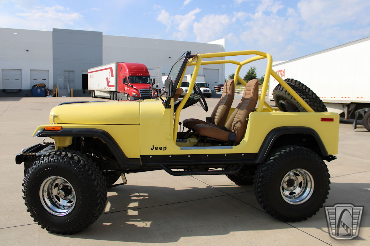

So with virtually no regrets, I sold my JK Wrangler last month... 10,500 miles on it... sold it for $4k more than I paid for it!
Was going to buy a Gladiator. But those things are pushing $50K plus... and it's just another box of computers and future electronic failures.
Instead, just bought a reprise of my High School Jeep... or at least sort of the version I really wanted. 1976 CJ 7.... but this one has a 401 in it. Which was a swap I always wanted to do. But trying to find a 401 in Vermont was about impossible. And doubt I could have afforded to do it on a high school farm slave labor paycheck anyway.
My plan is to drive it for the summer next year (winter closing in here) and then probably pull the engine and do a 3/4 race cam and some Edelbrock heads, headers, etc. NO fuel injection. Just a nice big Holley 4Barrel. Figure with some gentle poking and stroking, 400 HP is not going to be hard.
BTW, it's got Dana 44's, a TH-400 three speed. Frame off. Brand new steel tub. Guy who built it got bored with it and is selling to fund his next build.

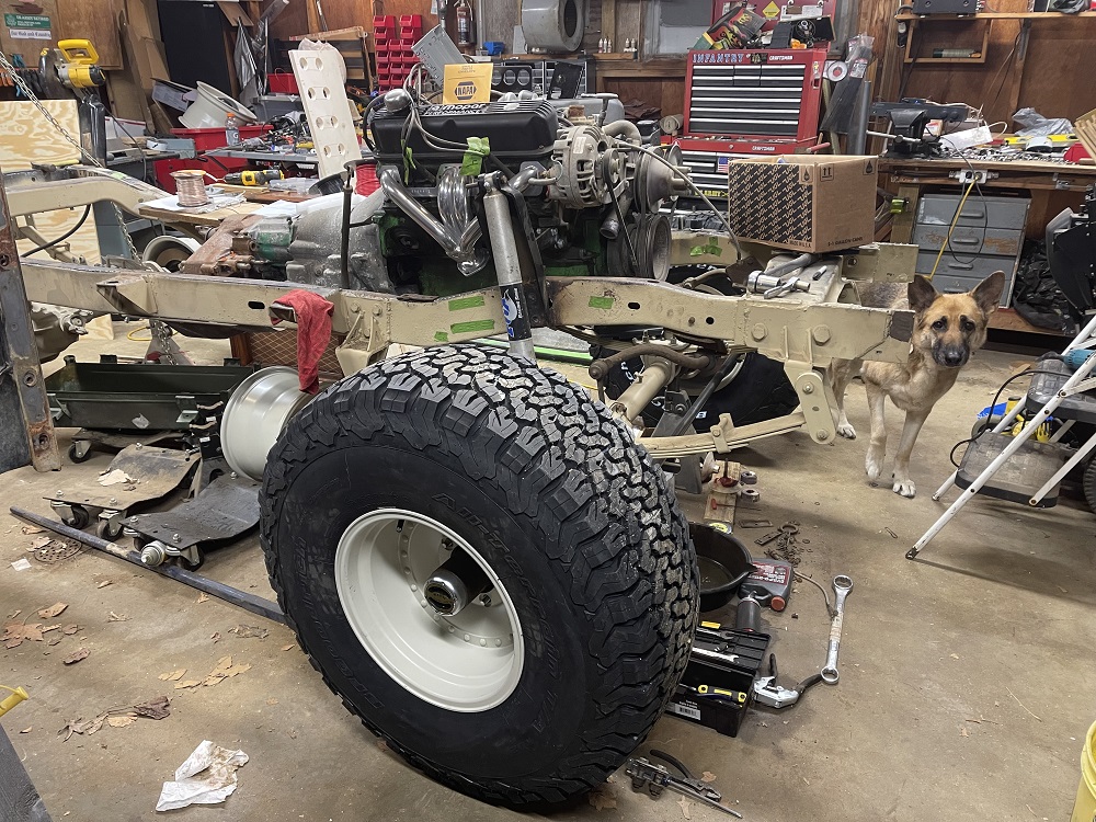

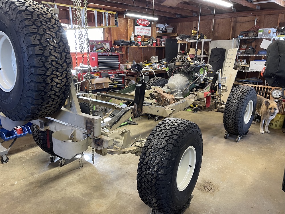

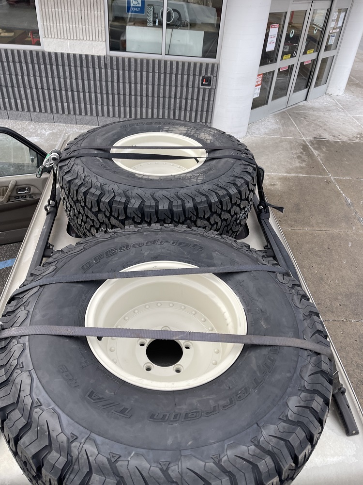

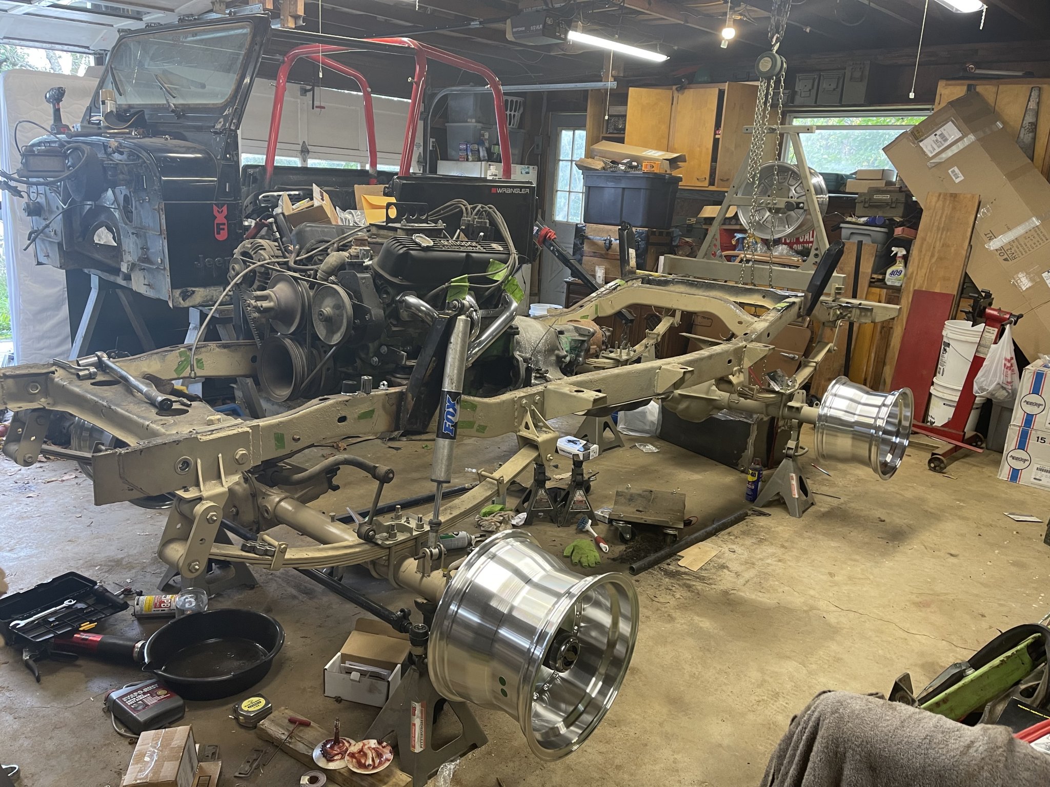

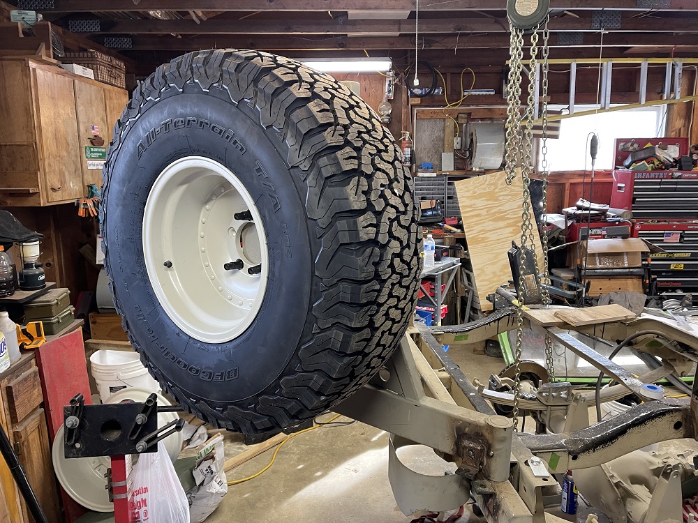

Sweet Lord this is taking too long. Had a little bit of money, so I picked up the first 2 tires today. Word is tires are gonna be hard to get here soon, so I want them while I can get them. Hell, EVERYTHING is hard to get. I got one type of fish out of 4 ordered for my VFW fish fry supplies I picked up today. Two 35x12.50 BFG KO2 tires pretty much take up the entire roof of my little 2000 Mitsubishi Montero Endeavor... that only rides on 31s.

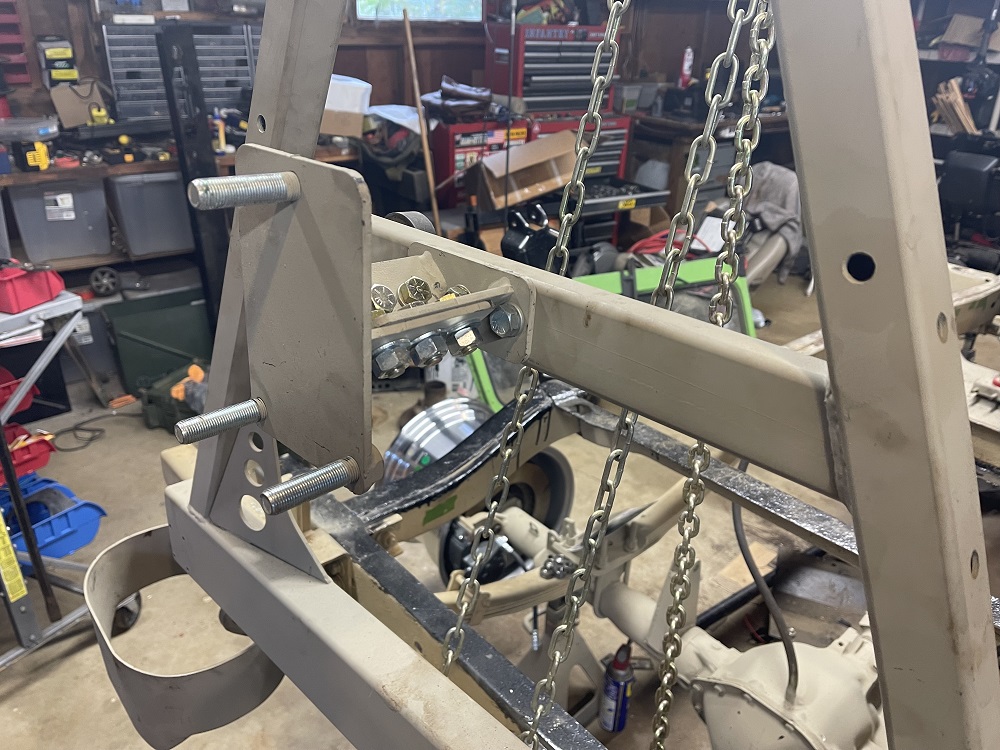

OK... problem.
No easy movement. Months of dirt, sand, leaves, metal shavings, sawdust, broken bolts, and such debris have collected on the floor (not seen in the above photo) meaning the little rollers, they no roll. This prompted a long overdue cleanup that netted what seemed like somewhere around 6.2 metric tons of trash.
Now having cleaned up some. I felt like doing something... but no more new parts.

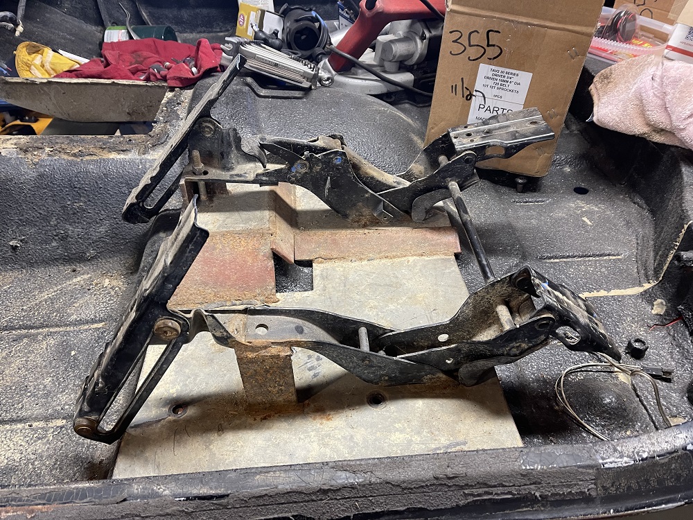

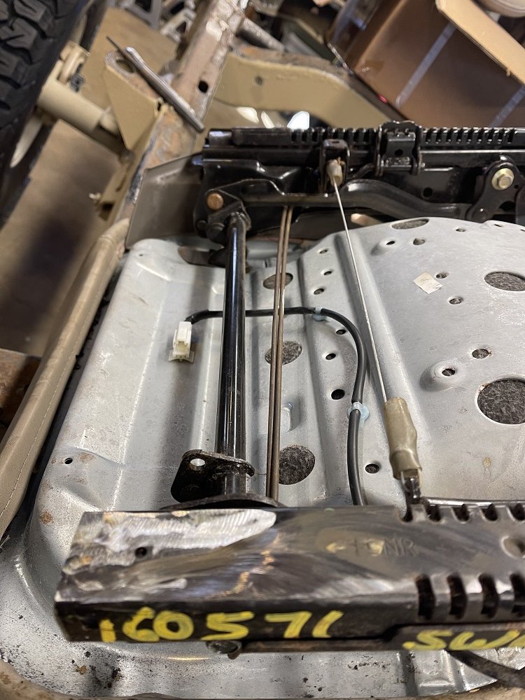

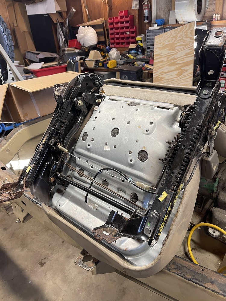

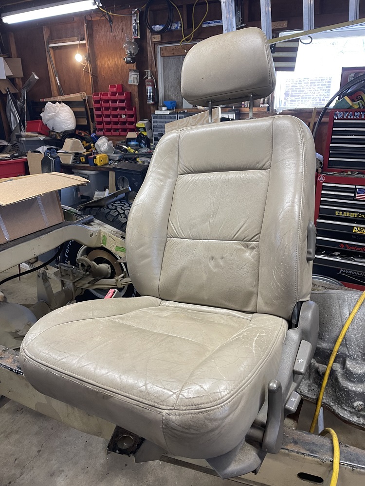

I looked around for something I could do with what I had in the garage already, and found a seat. It's one I got for the Montero some time back, but it turned out to be the wrong year, and wouldn't fit, so I had to make a bracket to fix the old seat. AND... it's kinda desert tan looking... hum. It's not gonna fit in the YJ Tub either, but I can try to MAKE it fit. So out came the cut off wheel, and grinder, and off came the mounting tabs.
Then I got out the custom home fabbed seat bracket that came with the tub. The previous owner made it to fit TJ seats to it. It has a real beefy bottom plate for welding to, so I'll just reuse that. First, the old brackets need to come off. They're about 12.5" apart, and the new seat rails are 16" apart. This is as far as I got before I was too sore to anything else, so that's it for the time being. I can build wings off the very strong front posts, and then build all new rear posts.
