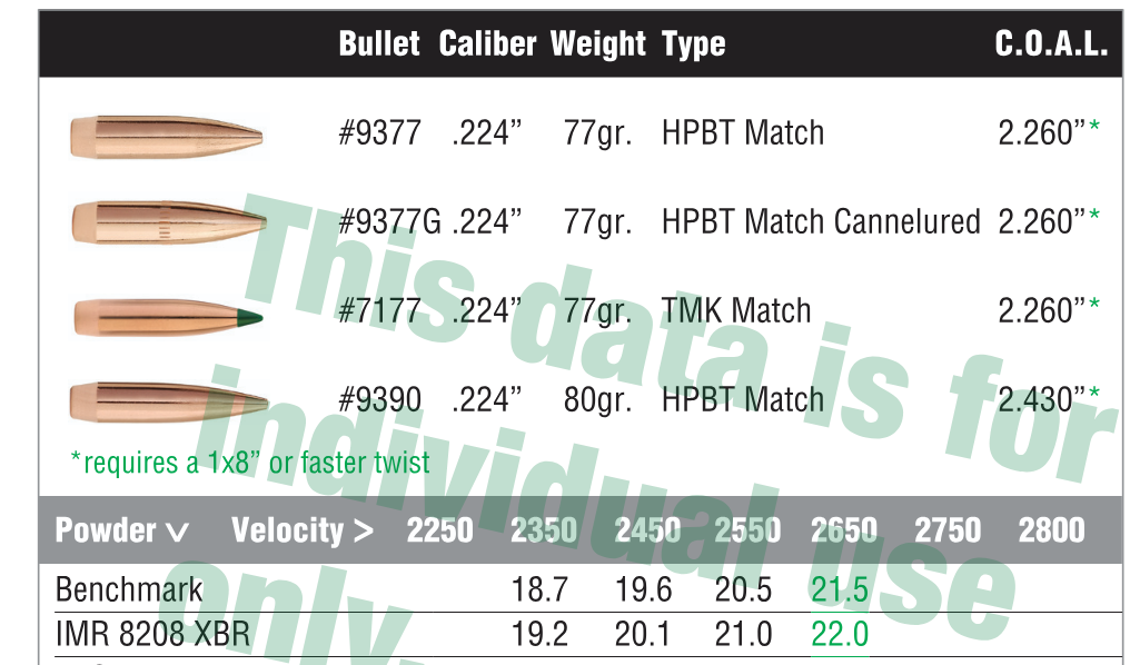

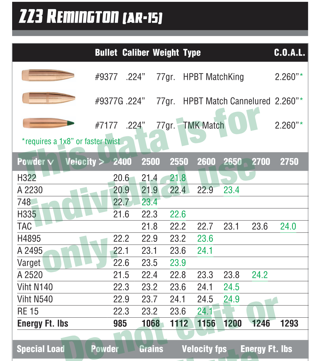

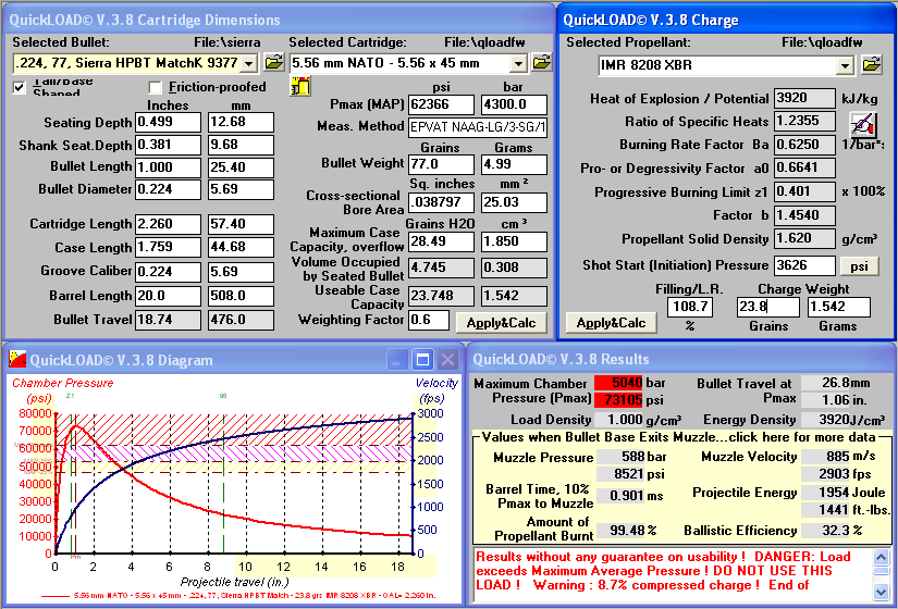

Just wanted some opinions on this powder and bullet combination for an AR with a 20” barrel and an adjustable gas block.
Typical loads I see online involve charge weights between 23 to 24 grains with a 77gr SMK at 2.24” for Mk262 clones (23.8 grains typical).
From what I can see, this is an accepted norm.
QuickLOAD suggests pressures in excess of of 73,000 psi using this combination, putting it deep into the red zone.
Safe to go this high?
Starting at 23 grains.

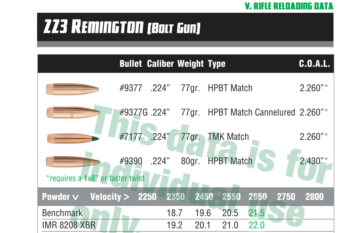

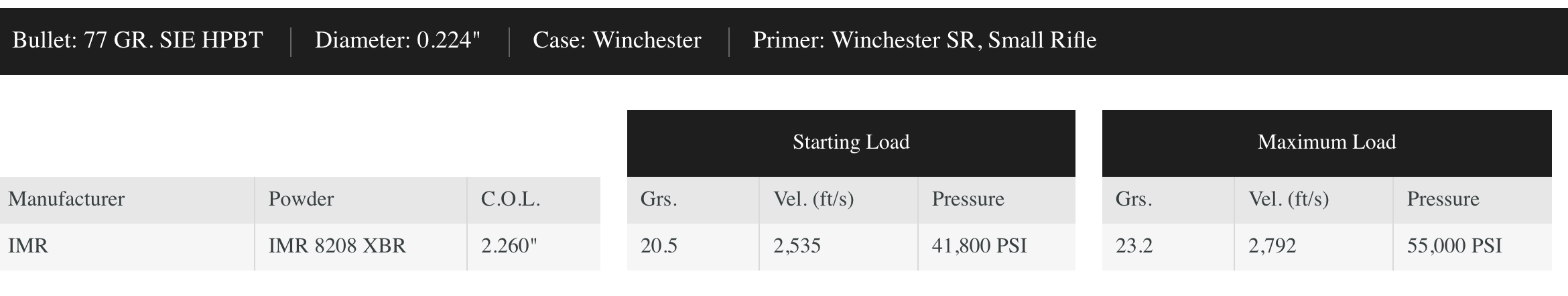

Have you considered looking up load data from the manufacturer of the powder? That would be a better place to start (rather than starting a thread about something that can be looked up in about 3 minutes)
They are much more conservative than the range stated.
However, many of the Mk262 “clone loads” fall in the range as stated above.
That is my concern.
All I know is RP, LC, Hornady and Lapua cases have all looked fine with 23.5-23.8gr XBR under a 77gr SMK from a whole bunch of different barrels for me. Using CCI450s, primers don't look flat and there isn't cratering.
24.0gr duplicated BHA Mk262 velocity, but 23.5-23.8gr shoots better for just a skosh less speed.
YMMV, etc
Who cares what QL or GRT says - no way to know for sure until you engage in RTDE with your rifle and aforementioned components.
Let us know where you ended up once you do so.

I have read / heard from 6.5 Grendel users that 8208 recent batches (last 1-2 yrs) carry more energy than in years past. Have not reloaded long enough to say I've seen it myself. I've worked up a few recipes in GRT for 5.56 and 77gr, I will check those for what GRT suggests.
EDIT: GRT with 77gr Sierra HPBT and 8208, with case volume 31.8gr water, shows 23.9 gr at 56,944 PSI and 2626 fps in a 16" barrel. This is not confirmed by live fire, just a GRT prediction.

Is the case capacity in the OP quickload calc accurate? 28.5 grains h20 seems on the small side.
That said, my current bolt barrel (ACE 0.219 bore wylde chamber) seems to build pressure fast. Much over 23.0 XBR gets hot in lapua brass with 77s.
My 28" 219 ACE TL3 barrel has Manzella longer 0.100fb 223 chamber and its the complete opposite of what your seeing.. slinging 80smk @ 2959 and shooting in the 0.1s no pressure

I'm under the impression that this combination of IMR 8208 XBR for 55gr and 77gr bullets is rather slow.
It's something like 100 to 150fps slower than QuickLOAD estimates.
When I "true" QuickLOAD by adjusting the Brisance value - it suggests that my pressures are on the low side (!).
I already have some loose primer pockets with the hotter 77gr loads.
You are certainly up there in pressure if not over. Trust your primer pockets, not an untuned software.

OEM for XBR powder here is Hodgon (ADI), their book max is 23.2 which is nominally 2,792 fps but only beause the extra 4~ inches of test-barrel (24in test bbl). Most mk 262 clone loads, in 18-20inch barrels, are around but just short 2,750 with XBR, final results of course depending on your specific bbl/chamber combo etc.Speeds approaching 2,800fps in only 20in of bll is almost certainly overpressure, as are loads using loads at 24.0+ grains etc.
Sierra 6th Ed. Manual for comparison. Note this is 'bolt gun' section because Sierra doesn't publish XBR in the AR section for .223 rem. Either way, Sierra shows a much lower level of charge and accordingly slower speeds vs Hogdon, but its showing somewhat similar data in terms of grain for grain velocity. 2650 at 22.0 is 100fps over their load of 21.0gr, so presumably 23.0 grains is around 2,750 which starts to track pretty close to the above Hogdon book max of 23.3 @ 2972 in 24in pressure barrel.
Reactions: spife7980
Sierra Matchking 77 grain HPBT 9377 at 2.240"COAL, Lake City American Eagle XM193 LPC120 Brass, IMR 8208 XBR, Remington SR Primers No. 7½
23.623.723.823.924
AVERAGE SPEED2785.4232789.0292808.3092807.7182820.891
Discrepancy, though between a bolt and a gasser, seems a bit much…
