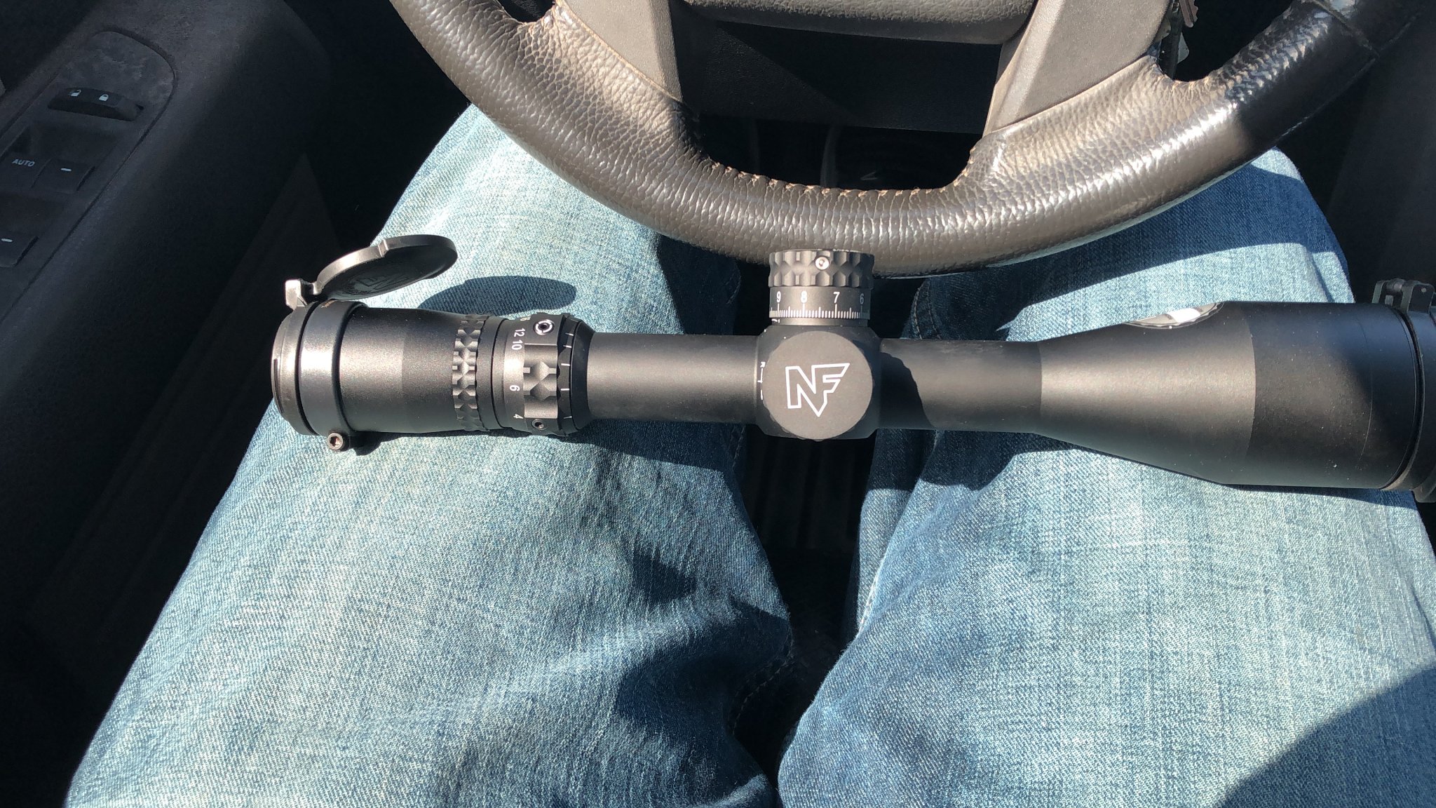

It’s always the professionals who assume their rifle demands are above and beyond anyone else...funny, I’ve met plenty “professionals”
He’s the only one who’s ever gone off road shooting lol
I’m just a vortex fan boy tho (hint: I don’t torque the set screws the same on this one because they’re different optics so the way this one works is irrelevant)
