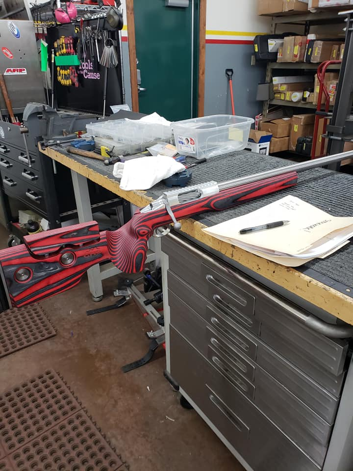

    Kelbly F Class
    GRS wood
    K&P barrel blank
    Jewel bang switch

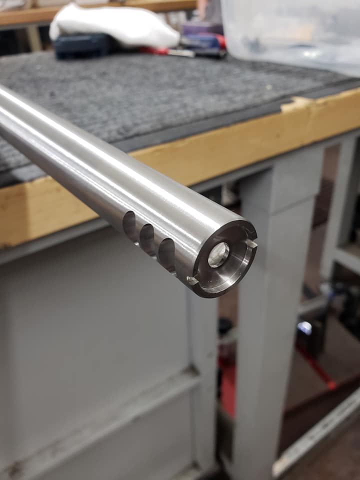

    LRI brake

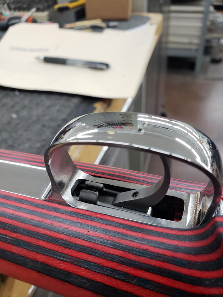

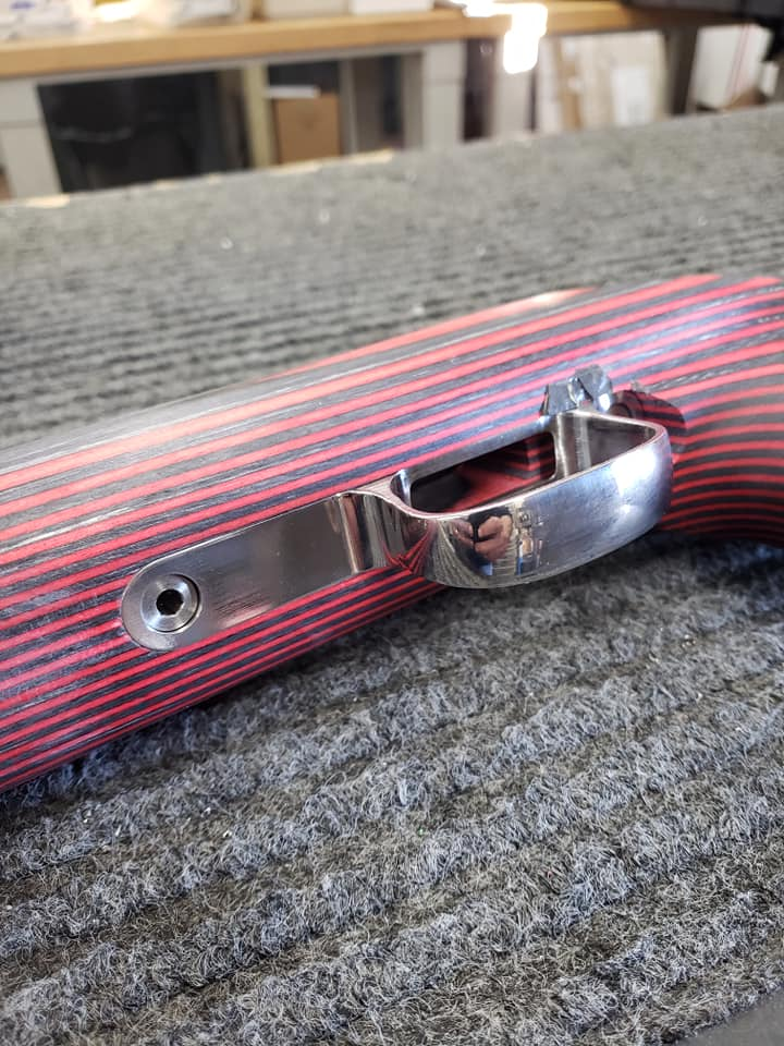

    LRI billet SS trigger guard (new!)
    LRI stock work and barrel fitting.
    Fun little paper puncher.

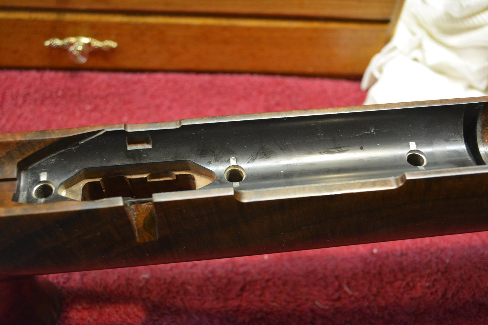

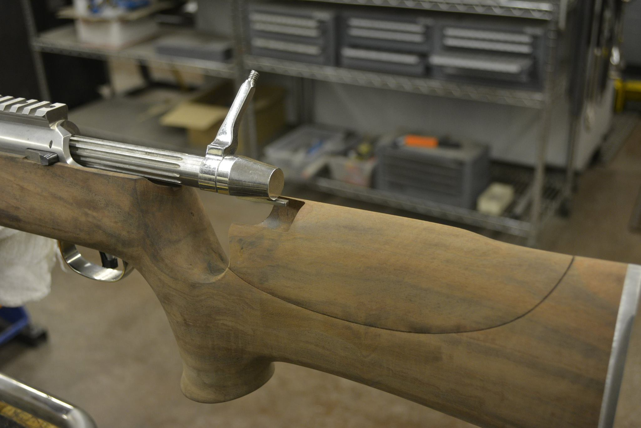

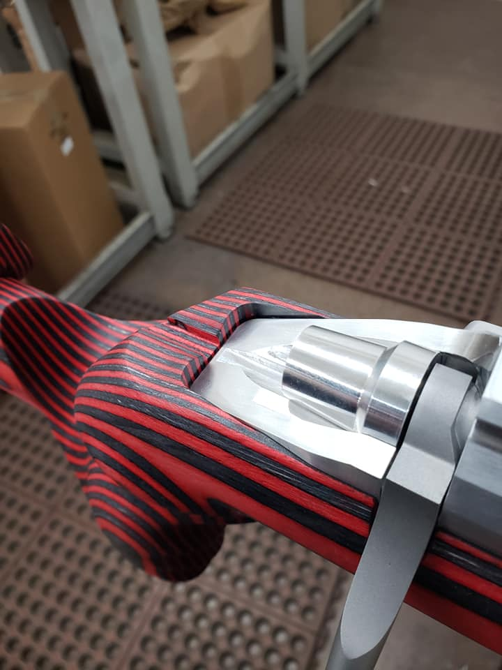

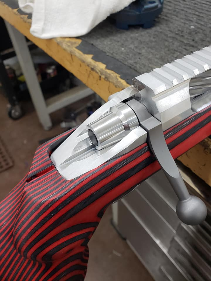

    It seems that most of your work has the stock / rear tang blended. Is there a reason this action sits down into the stock?
    A very good question.

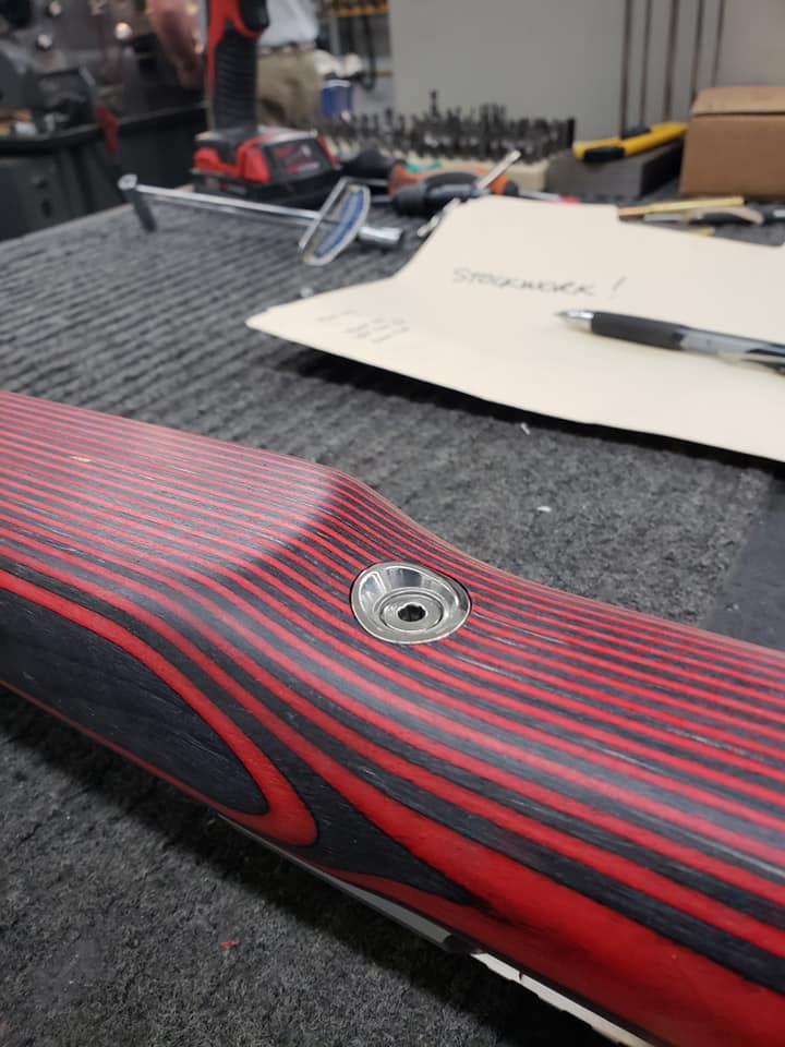

    Target stocks made of wood, be it laminate, or a single piece, typically have a fairly vertical grip profile. This creates a near impossible problem if one is to attempt to blend the tang. You end up with a pretty abrupt/strange appearance. The added complication is that the grain typically runs parallel to the recoil impulse. This shearing effect can literally split the stock in half right at the transition from tang to grip. One reason why we pin these things prior to bedding.
    So, the compromise is to leave the "girth" alone. I do my best to elegantly fit the two by contouring the back half for the bolt shroud/handle and clearance the tang a little so that they go in/out without too much fuss.
    Other examples:

    Awesome looking work, the blending of the eschuchen looks flawless.

    As for the polish and fit. Just sent a PO for a new batch of form tools used for contouring the guard bow. I had one of these left and we wore it out good making our side bolt releases for M700's. I'm lucky I got as good a finish as I did making this trigger guard.
    $1400.00 bucks later we solved that with some new tooling on order. Good as were close on a DBM, we'll use em for that too.
    See here on how the guard bow came about for this thing:
    https://www.snipershide.com/shooting/threads/trigger-guard.6916508/

    Regarding the eschuchen work maybe I'm a tad wet being the ears but don't recall many blended and profiled to perfection like that. The majority I've seen are flat and inset on a single plane so ?nailed it in my book.
