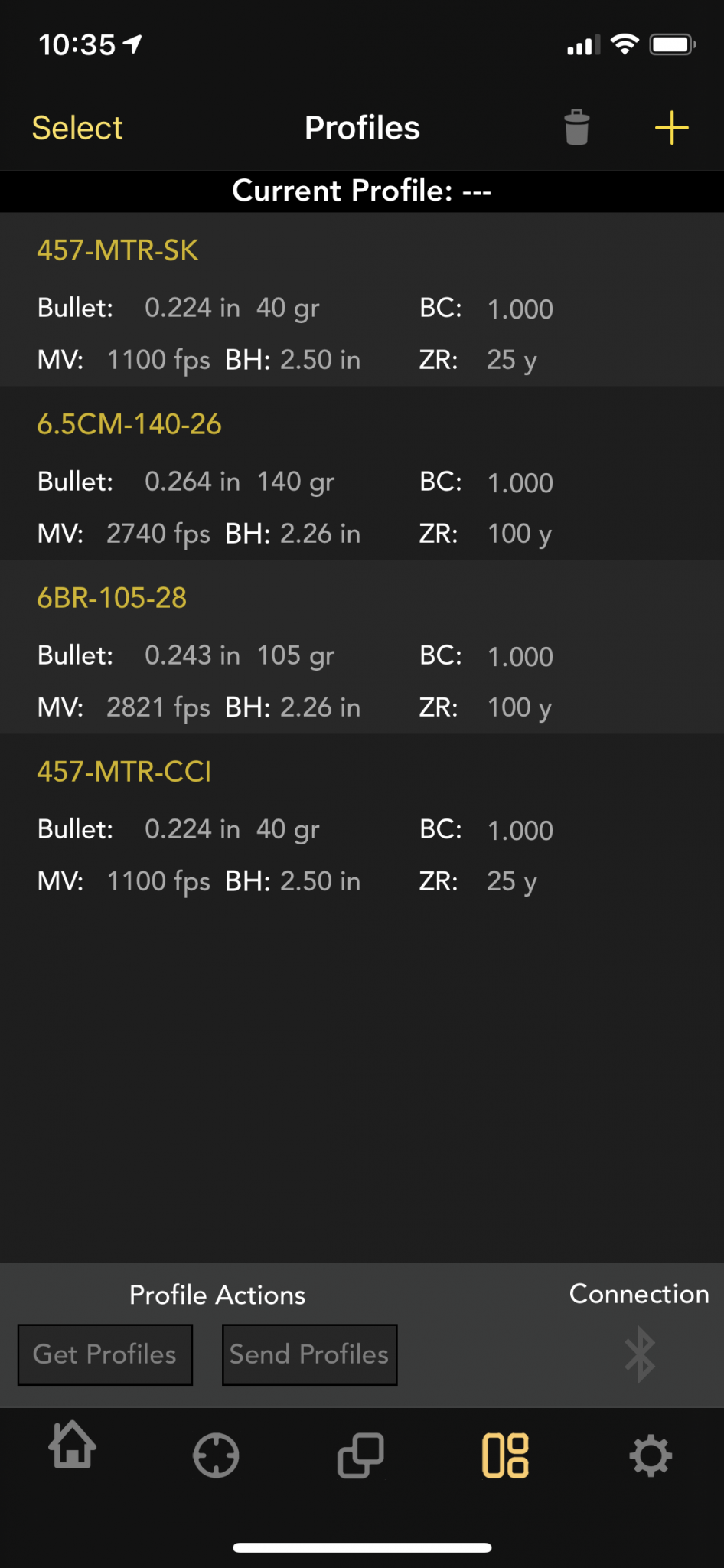

Save it where? It exists in two places. In the app, and on the Kestrel. Is it not saved simply by existing and being able to be used?
If you use the Kestrel link to enter your data then in the upper right corner you will see three little squares. If you tap those it will show save profile.
You must save profile before sending to the unit or nothing will change.

When I press save, and I’m able to send the profile to the Kestrel and use it, I assume it is saved.
Are you saying there is another screen with 3 squares I need to save profiles to?
The other screen I was referring to was for the Kestrel/Hornady 5700 4DOF. I should of ask what unit you were using first. Sorry. The key is to save the profile each time before sending it to the unit. Hope it works out ok for you.

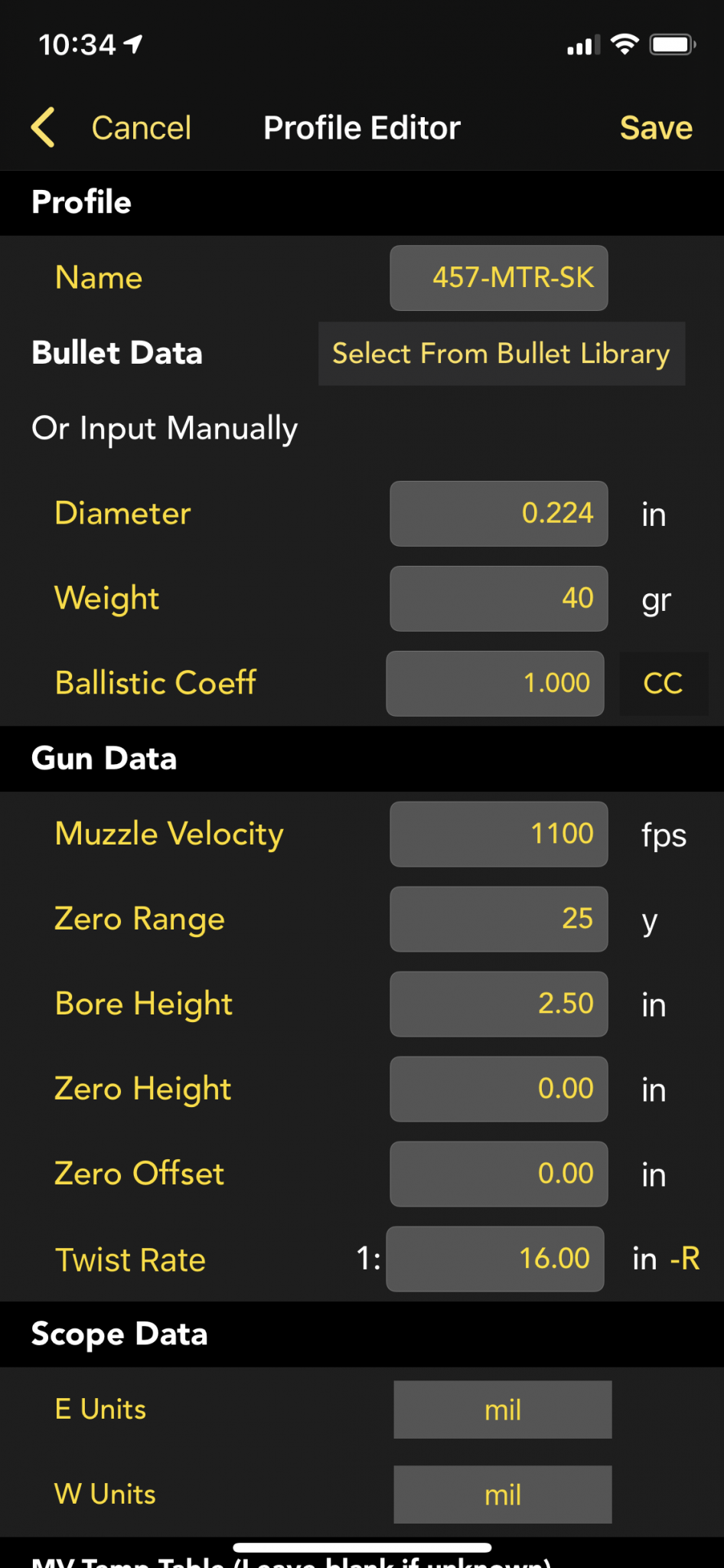

With the risk of asking a stupid question:
I have an AXMC with 3 barrels and one fixed scope. The 3 barrels have a slightly different POI so when I change barrel I slightly adjust from 0 for 2 of the 3 calibers (obviously one of the three as 0/0 on the scope) . Should I use "zero height" and "zero offset" in the "gundata" for the other to calibers that are not 0/0??
YES, set up separate profiles and us the ZH and ZO to indicate the variance from dead center for the two not zeroed dead center - high and left hits are + number entries and low or right hits are - number entries.
Thanks for quick response.
So just to be 100% sure: If my .308 barrel is 0/0 and my 300 norma after barrel switch is +.5/-0.2 MILS (zerood) that is also the value I enter in the profile for the 300norma barrel? And the value the Kestrel then gives -for the 300Norma gun profile- (let's say 10Mil up for 1000meters) that is 10 MIL up from 0. Correct?
Correct

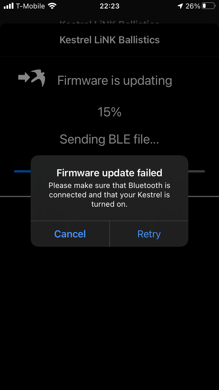

I use 1.43 software and cannot upgrade it to 1.45. Kestrel 5700 Elite Applied Ballistics iLink
Model 5700AL
FW 1.43
BOOT 1.01
BLE 0.06
BAL 72
HW Rev 11B
Any idea how to upgrade it?

First, there are no ballistic changes between 1.43 and 1.45, the changes impact non-ballistic meters, so upgrade is not required.
Secondly, make sure you PIN is turned off.
I was wrong, fw 1.44 had no ballistic changes, 1.45 did fix some profile transfer issues. Upgrade would be beneficial.
