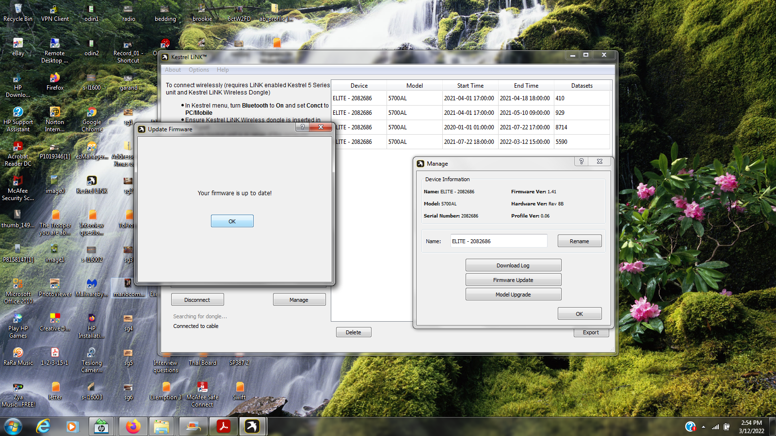

My kestrel is a Conx Sportsman updated to 5700 Elite.
Went in to update firmware....looks like I am still running 1.41
Got this screen......still 1.41. Any help you can provide?
In the main Kestrel LiNK window click Help>Update your Kestrel
You will then get another window with a link for the latest firmware. Download and run the exe.
When you then reconnect your Kestrel and click Manage it should have the newer firmware version available.
Worked as stated.... thank you.
