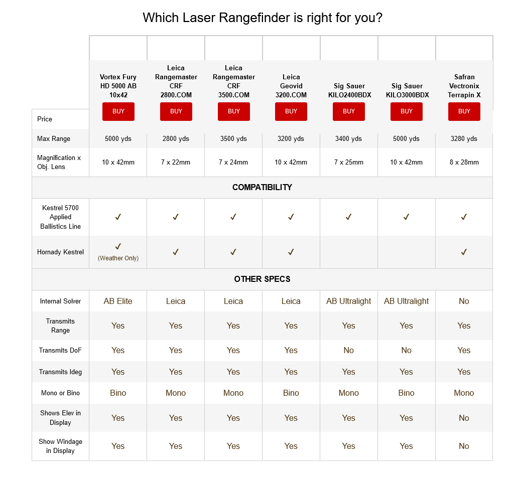

@Kestrel Ballistics sorry if this has been already covered, but is the Terrapin X passing the DoF to the 5700E while ranging? Is there any other LRF bino doing that actually?
ref: https://kestrelballistics.com/compare-laser-range-finders

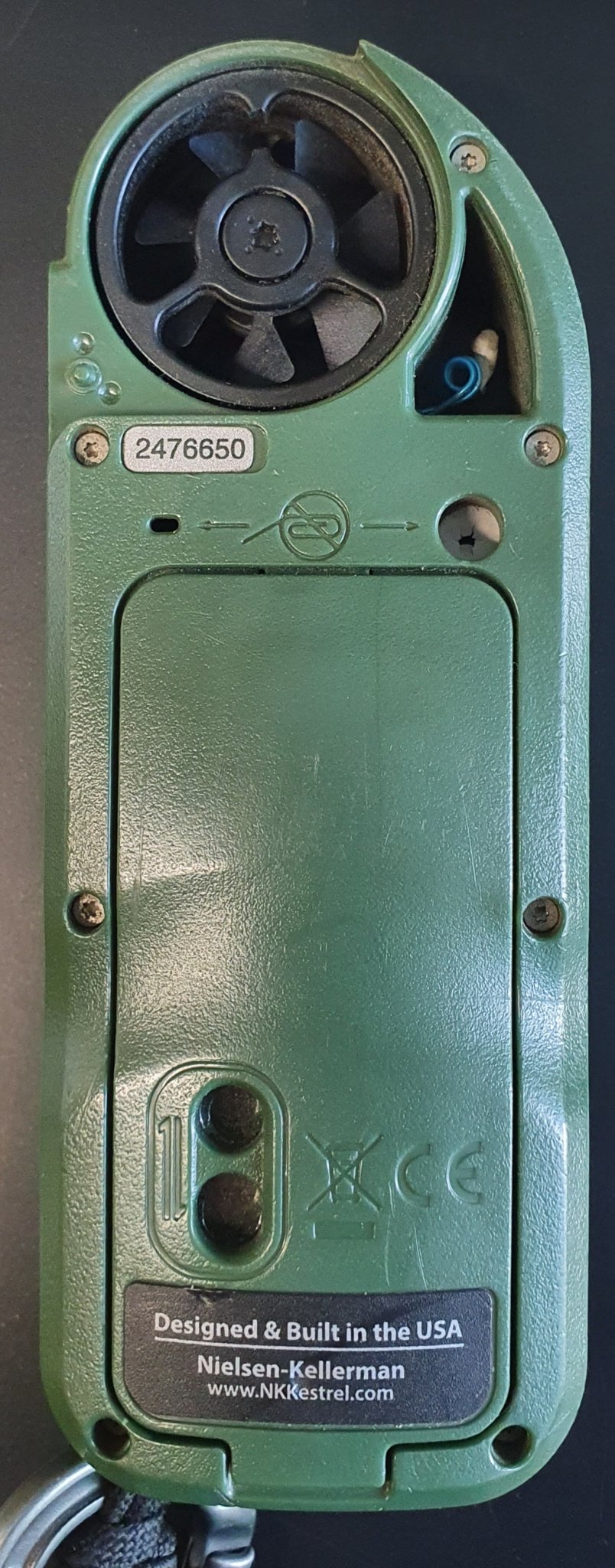

I have finally managed to screw up my humidity protector film. I only noticed it now, it has probably catched a small twig somewhere during last few months.
Do you have some repair set for 5700? The impeller also came apart but got it back together with full functionality.

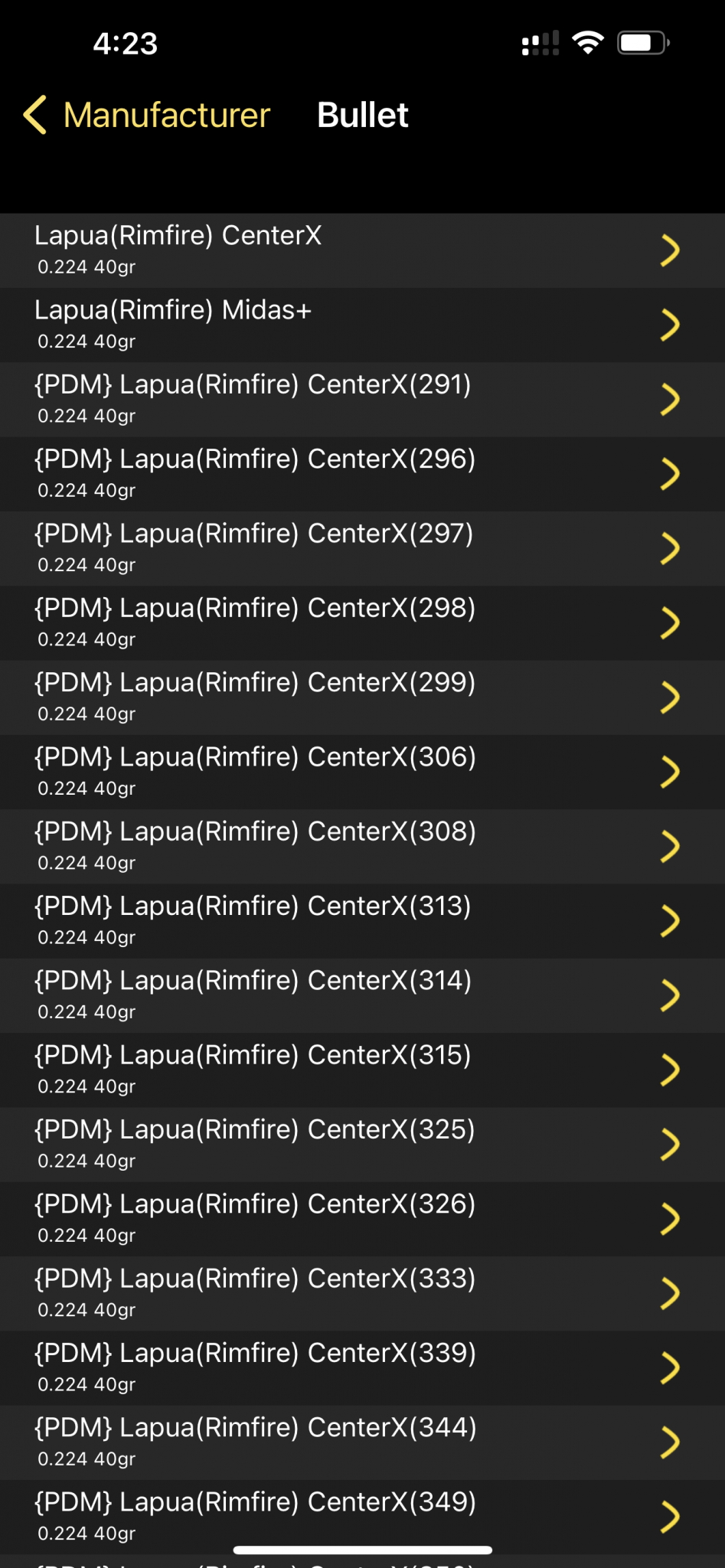

I’m shooting 22 lapua Centre X. When I select this from the bullet library I get all these options.
Using the top one I get excellent results. But what are all the {PDM} Lapua(Rimfire) CenterX(xxx) options? I guess I’m asking what does the number mean. Is it distance in yards?
Thanks!
Thanks!
Those are personal drag models. Basically ballistic data obtained from the AB Mobile Lab at various matches across the nation.

I spoke with Bryan at the NF ELR last year about the CDM for each bullet. He said they 'update' that curve based on all the PDMs they gather. The more PDMs = more 'accurate' CDM. I asked him if I had the CDM dialed for my specific rifle if it would change when they update their CDM. He said the CDM would be used if you created a new profile on that bullet.
Just more info.
Reactions: Ausvette
Just more info.
i wonder if they have significant outliers and how they handle them in regards to the CDM
