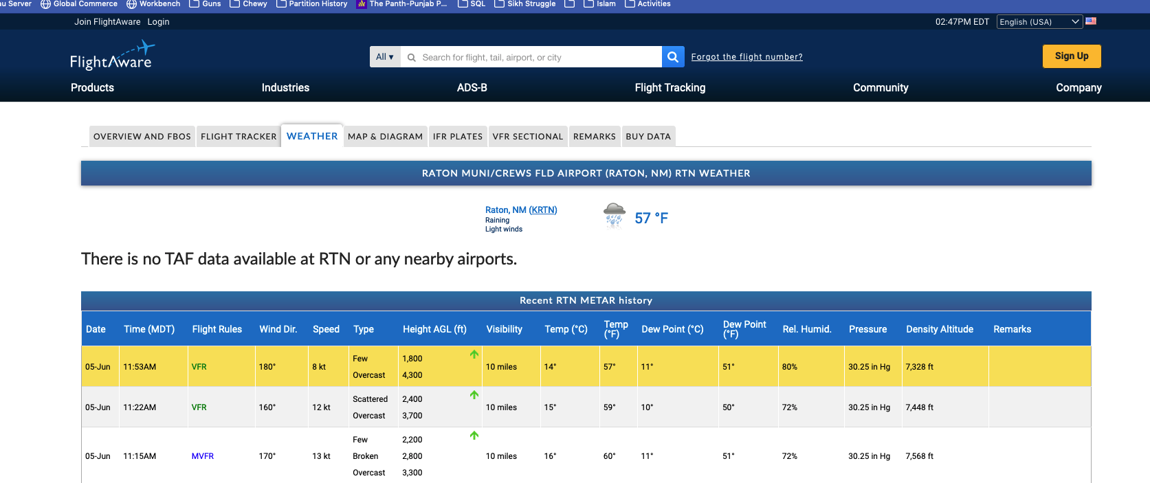

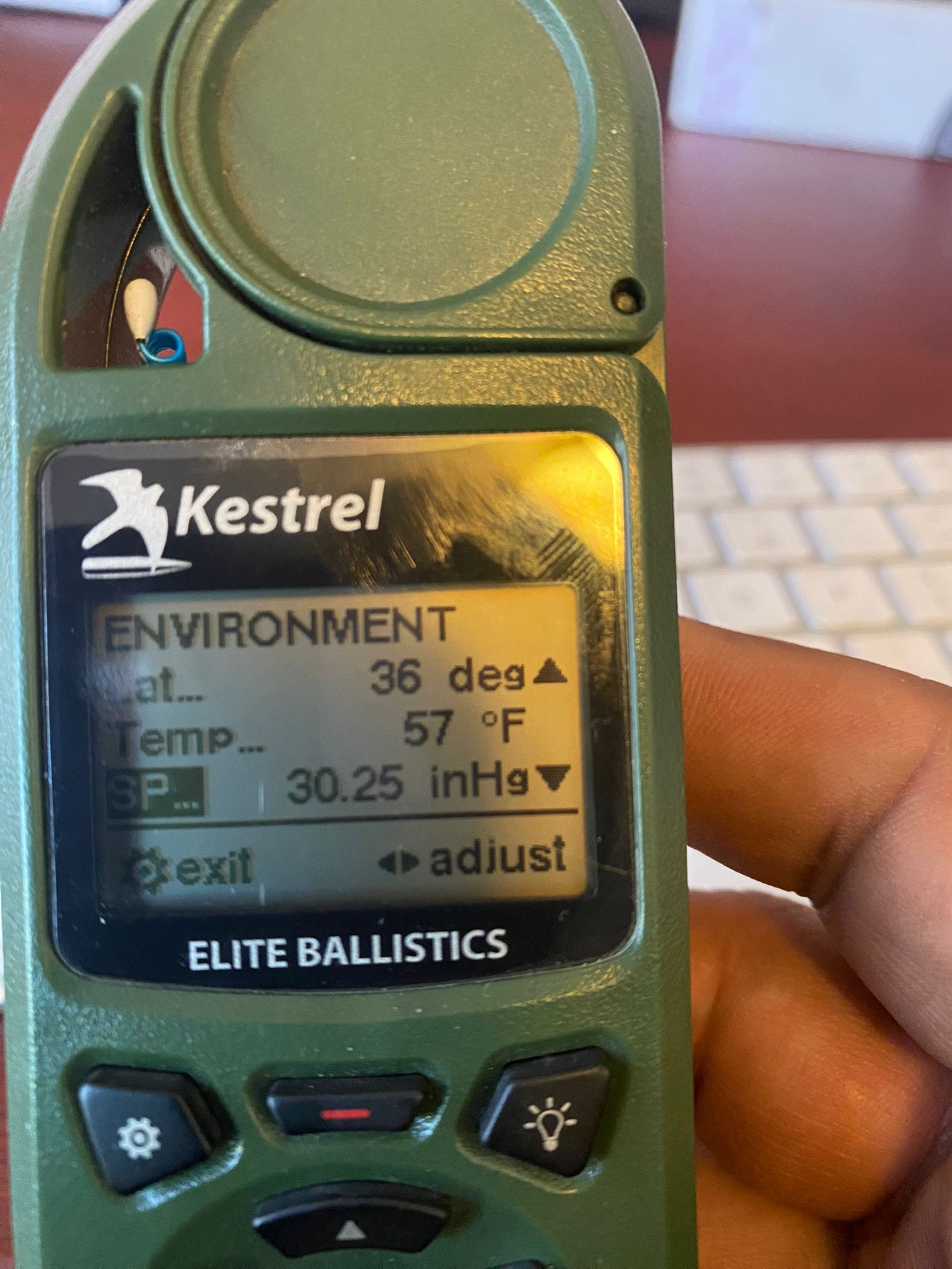

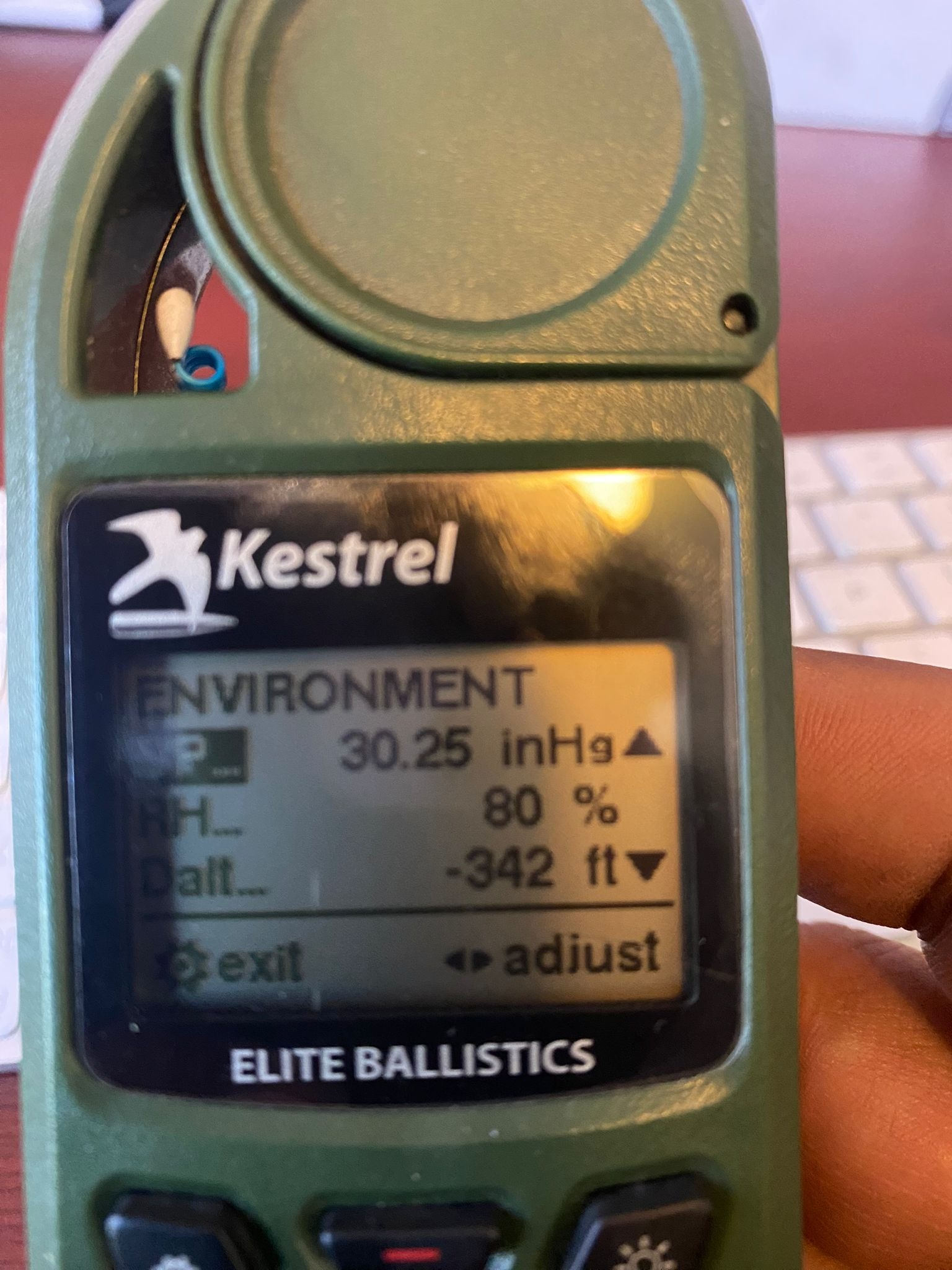

I have observed that the density altitude that Kestrel calculated does not match up with the DA that is shown or calculated by nearby local airports. For ex: As of 06/05/2023 the Raton Municipal airport is showing Temp 57 F, Humidity 80%, Pressure 30.25 in Hg and DA as 7328 Ft. However if I enter the Lat and same environmental parameters in Kestrel, I only get a DA of -342 ft. Can you check why Kestrel is showing a diff number for DA vs that calculated by local airport?
Link to Weather/DA calculation for Raton Airport

so what does the kestrel say when you actually let it do environmentals and not just enter data?
View attachment 8156265View attachment 8156264
Because the kestrel wants uncorrected pressure not corrected.
Also, any DA within 500 ft, hell even 1000 feet will be more than enough.
I am sitting in WA, so cannot physically check station pressure in Raton. Hence I checked diff weather websites and also the website for Raton airport to get the environmentals. When I enter those environmentals in kestrel I get a diff number for DA vs what the Raton airport is showing. Trying to understand if I am calculating DA wrong or the airport is on a diff calculation or something else.
@_Windrider_ : What do you mean by "uncorrected Pressure"? ...thanks
That number you are using is barometric pressure, it’s what we use in aviation. It’s corrected for sea level. You need to use station or absolute pressure which is uncorrected. In order to use barometric you need your elevation.
Reactions: harry_x1
ok...I figured out where I was confused. I had checked AB documentation before raising this thread...however I was confused after reading the write up and assumed that the Barometric Pressure reported by Airports should be roughly close to station pressure (though not 100% same). But now I figure that the reported Barometric pressure can be way way diff than station pressure, especially on higher elevations. Thanks for those who helped.
Use 23.24”Hg and see what you get. Raton is approx 6680 feet elevation. Standard pressure would be 29.92 - 6.68 or 23.24. That’s not exact but it will be in the ball park
Reactions: harry_x1
Yup...figured that out now...thanks all those who helped clarify

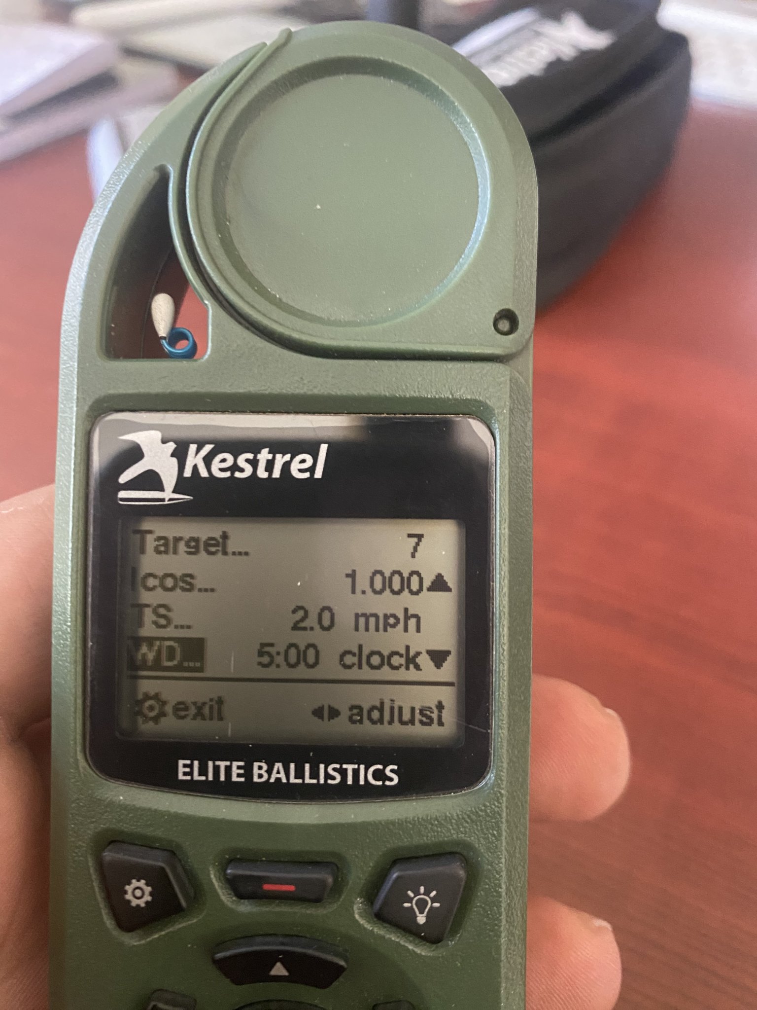

Quick question- inside “Target” menu my kesteral is showing TS as 2 mph. Is this by default or should I make it zero. Am shooting stationary targets. I never touched this number so not sure why it is showing 2mph.
"TS" = Target Speed. Set it to whatever you want. It will then calculate your mover (Lead) solution based on range, enviros, etc.

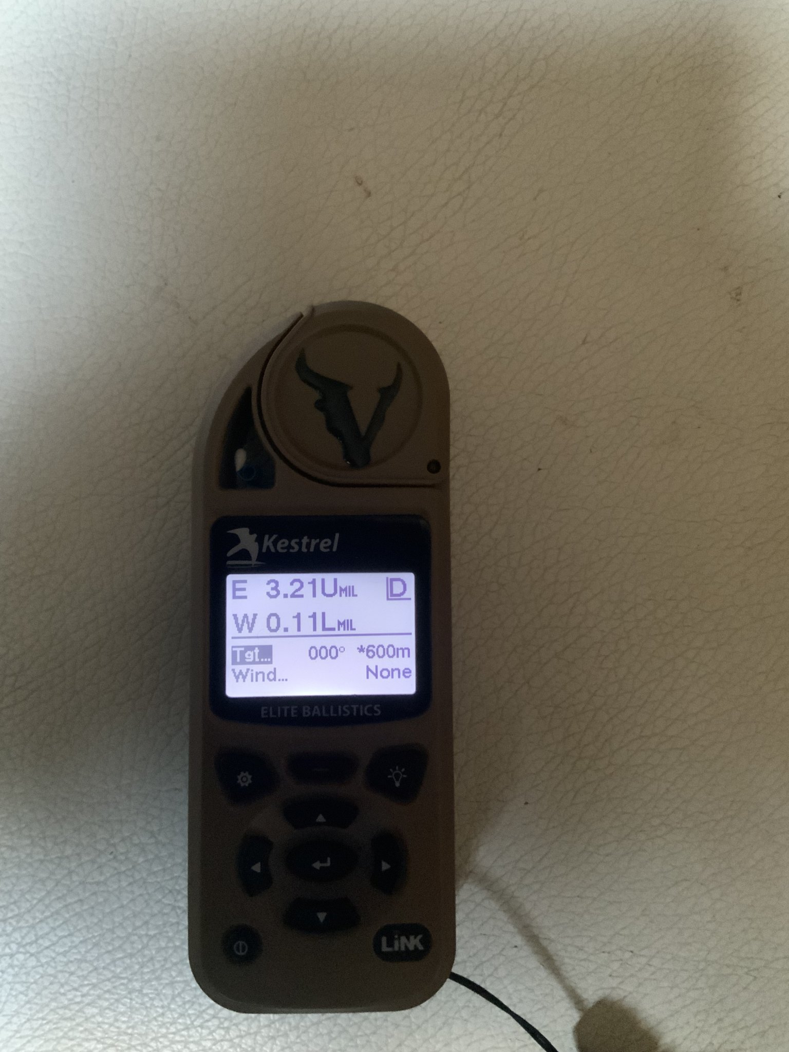

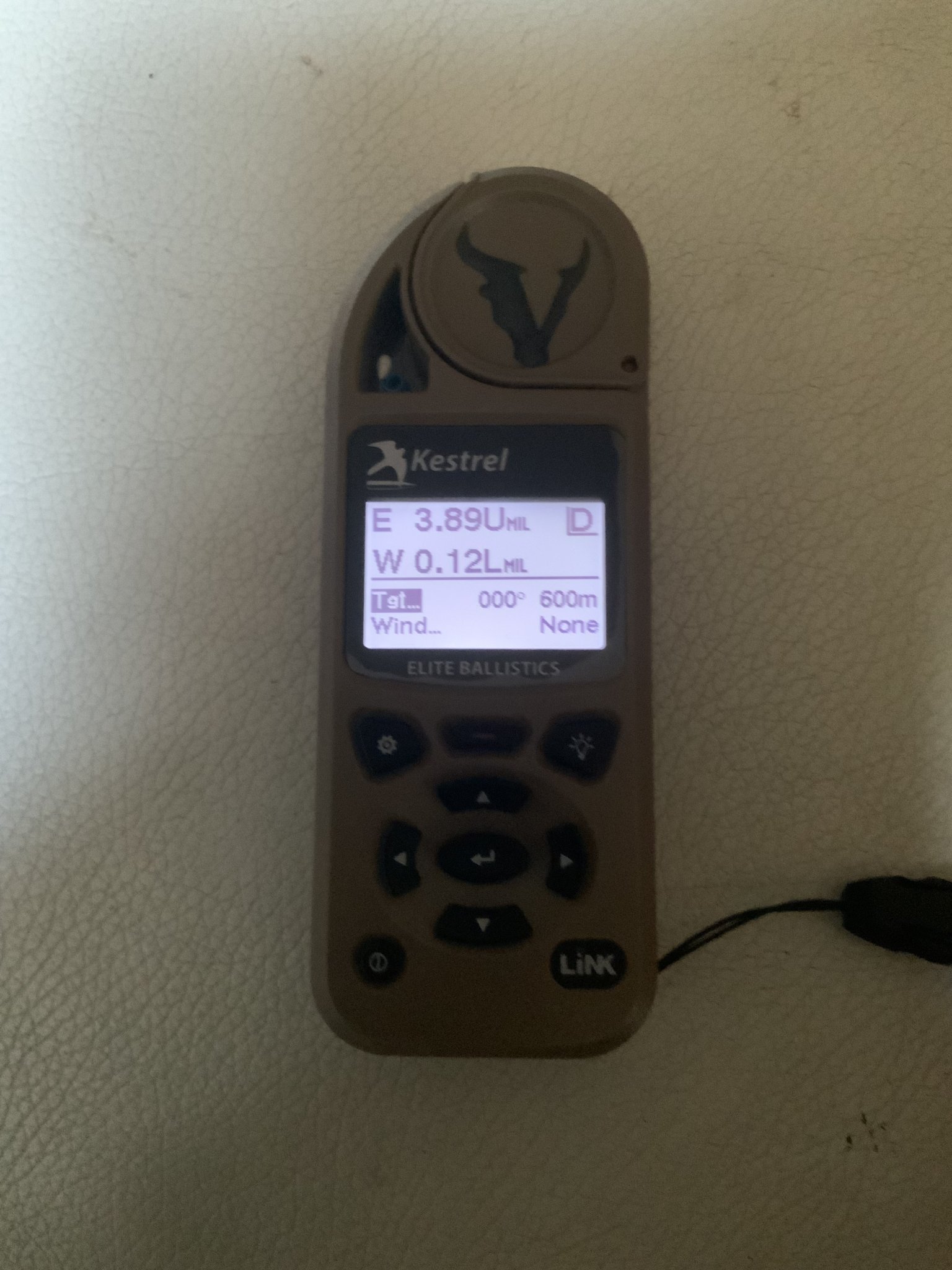

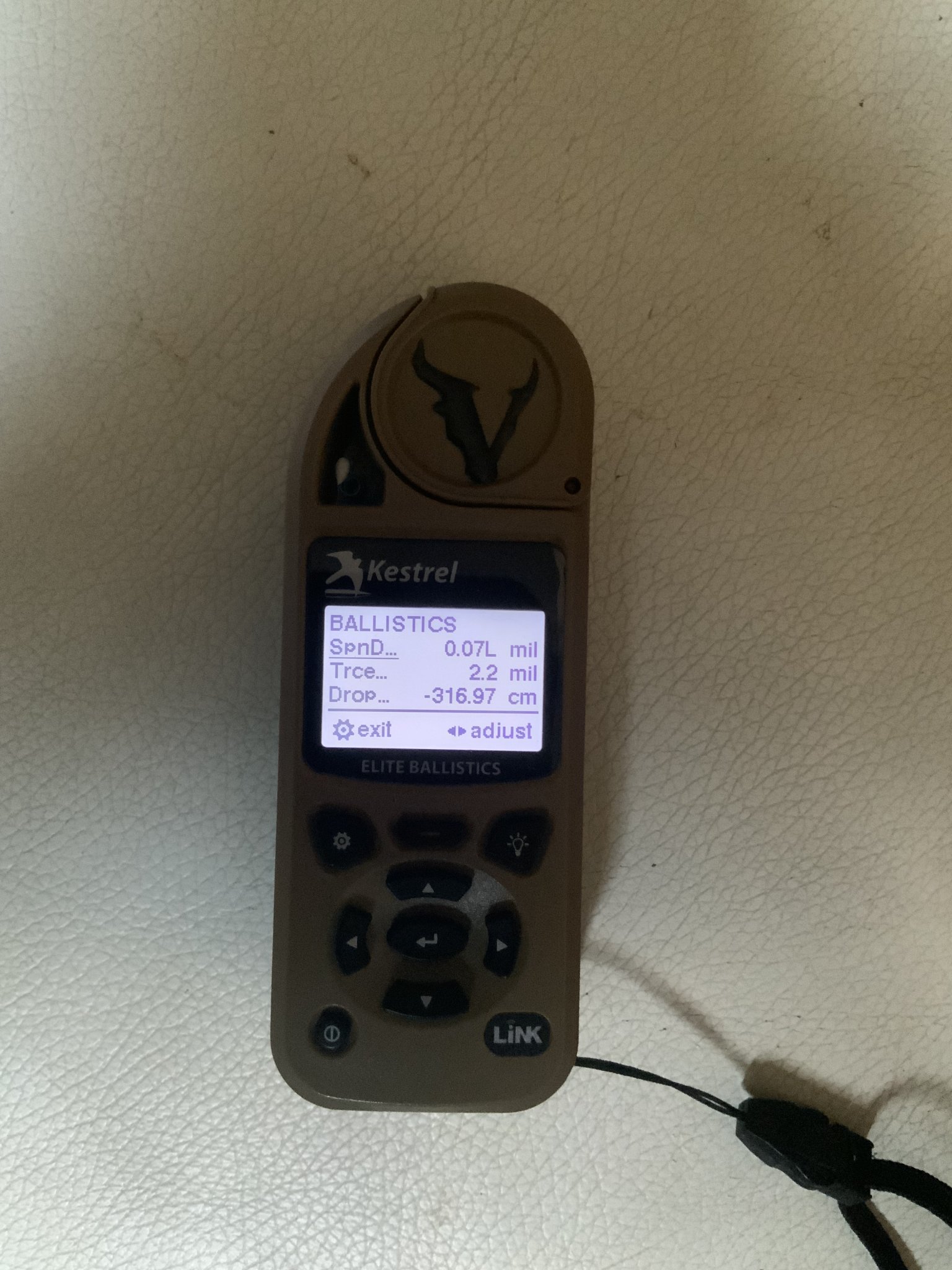

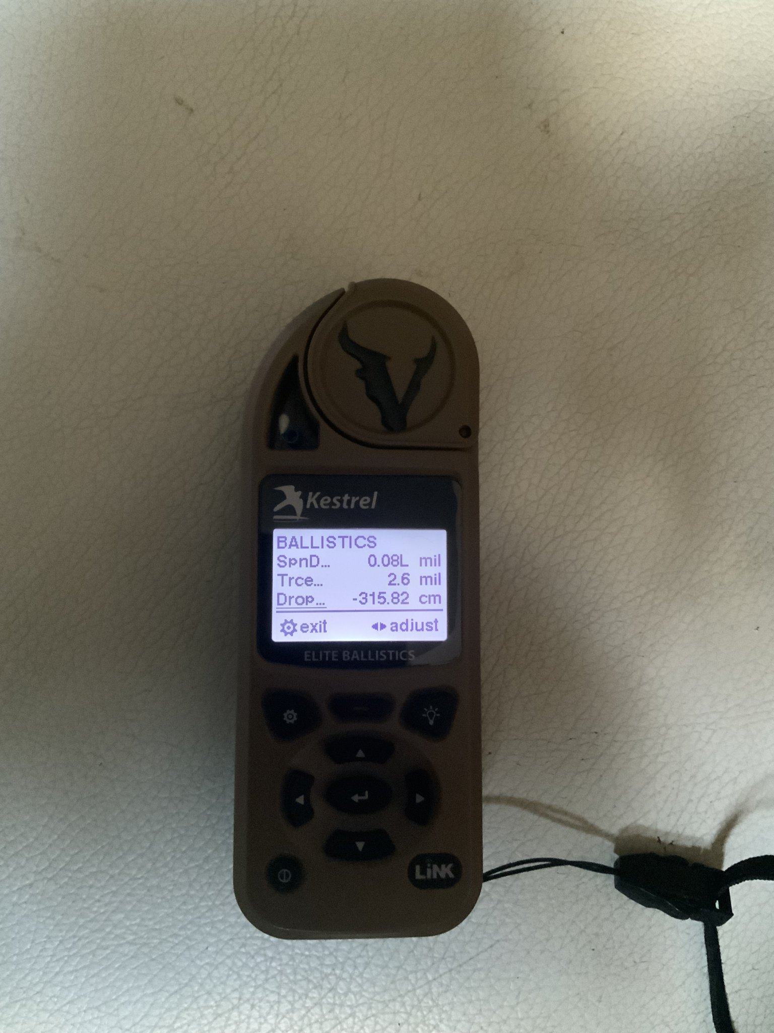

Question about drop value.
why the value of the drop doesn’t change ?
first two pictures, distance 600 meters, angle zero, 3.89 MIL, drop -315.82 cm
other two pictures, distance 600 meters angle 30 degrees, 3.21 MIL, drop - 316.97 cm ( also a little bit more )
I‘v checked it with several caliber and the result is always the same, the drop value doesn’t change between a solution with zero or with a presence of an angle shooting
AFAIK angle only shows in the Target menu not the Ballistics menu
Drop is not a firing solution. Drop is the true drop the bullet experiences from the time it leaves the barrel. This is not used to calculate your firing solution.

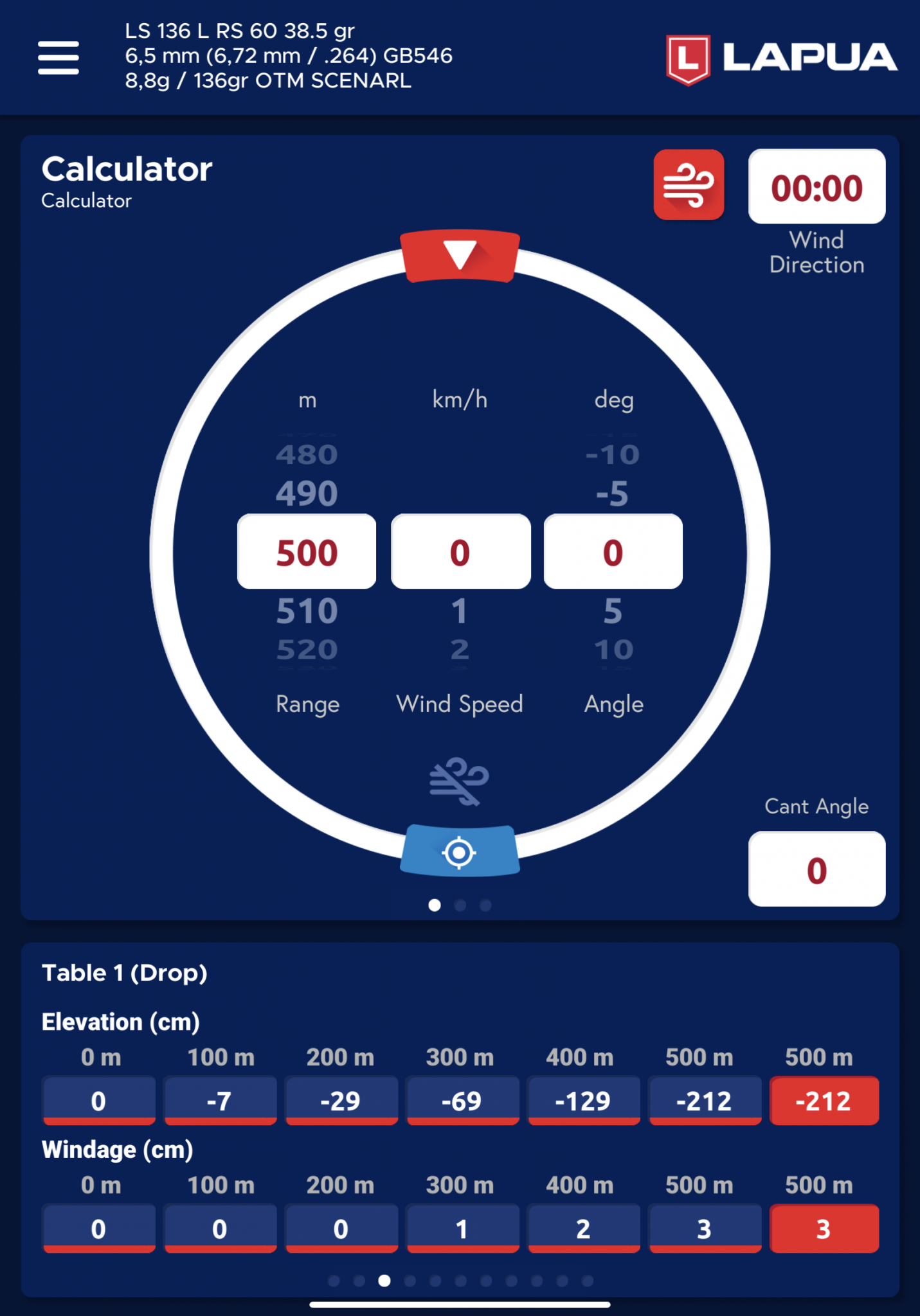

Yes I know, but why with different angle the drop doesn’t change ? For example with the Lapua application we can see the difference zero angle one drop value, with 30 degrees a different drop value
