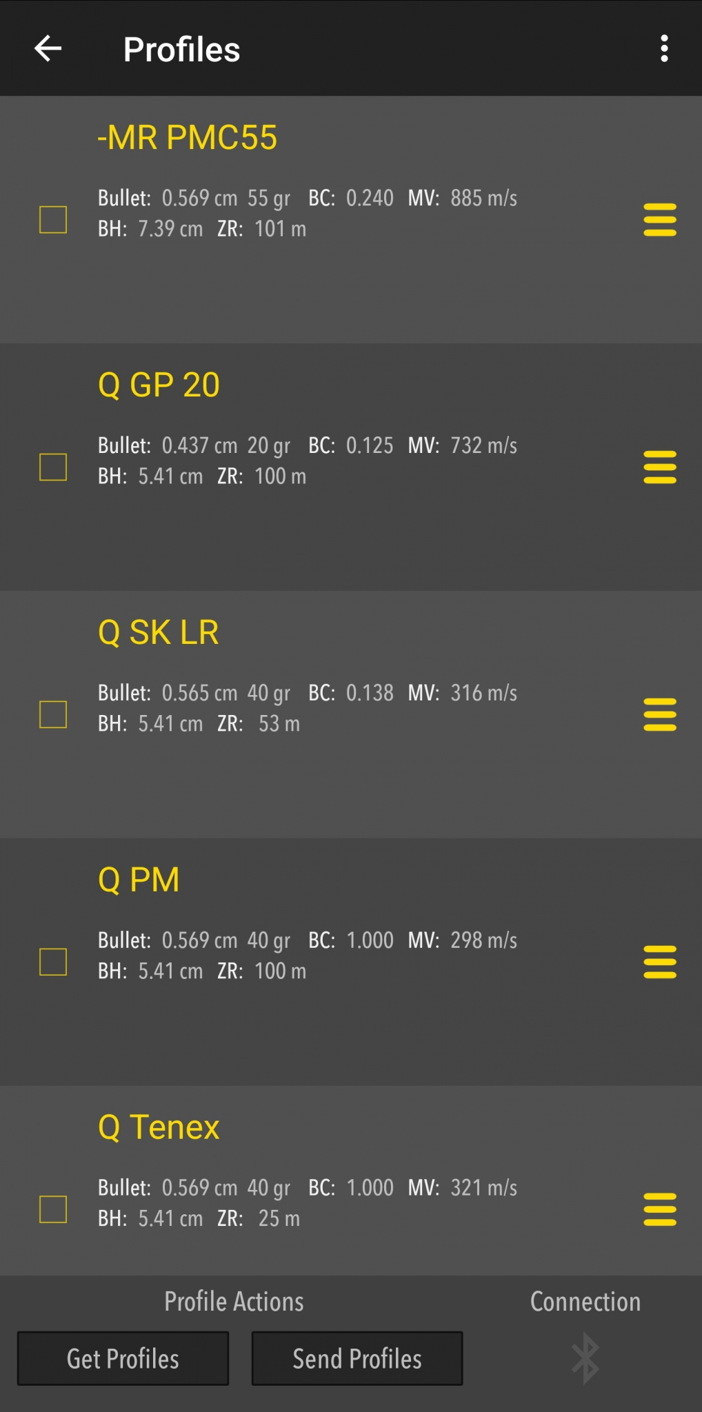

The recently updated app shows the profiles quite spaciously.
Can you check this?
The phone is S10+ in 1440x3040 resolution, running android 12.
I tested the app with 720p resolution and it looked the same.

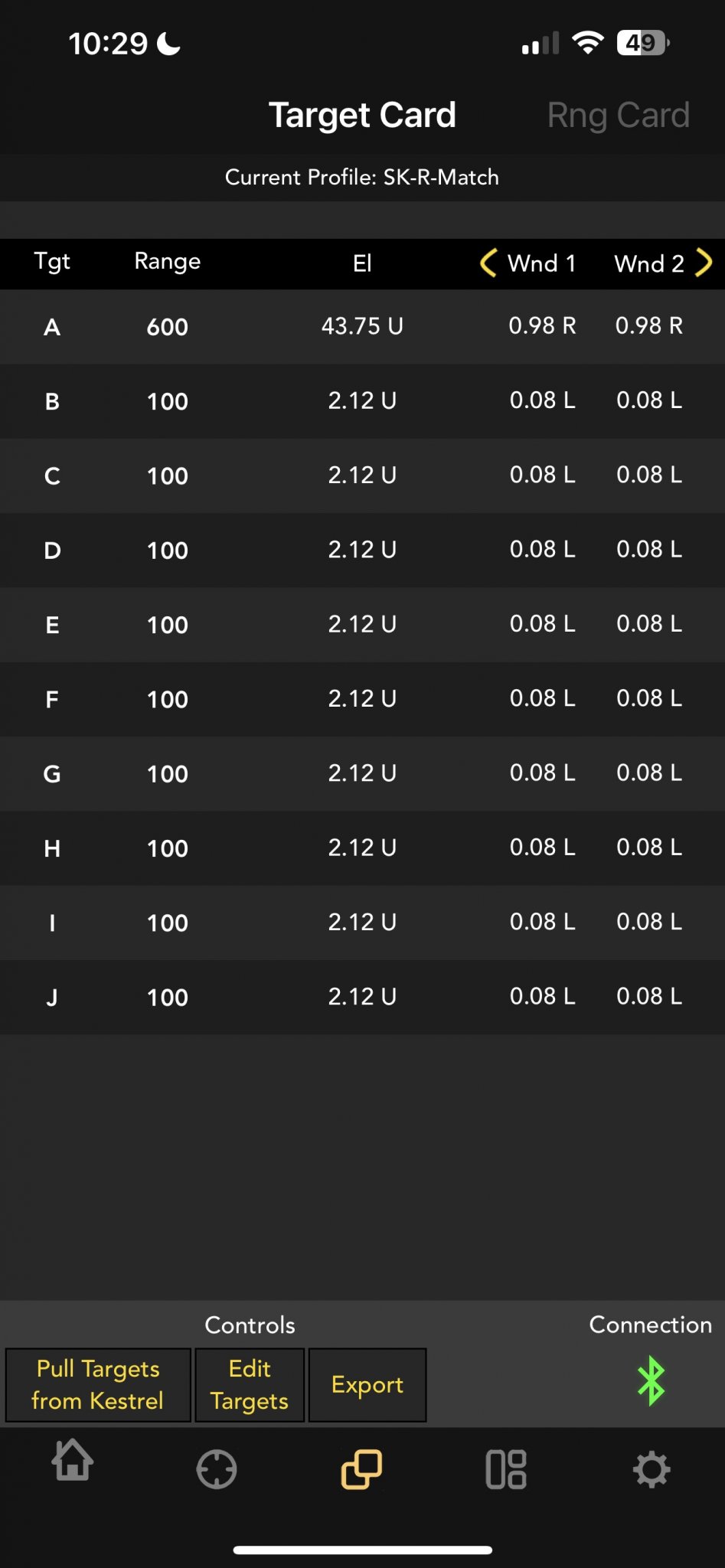

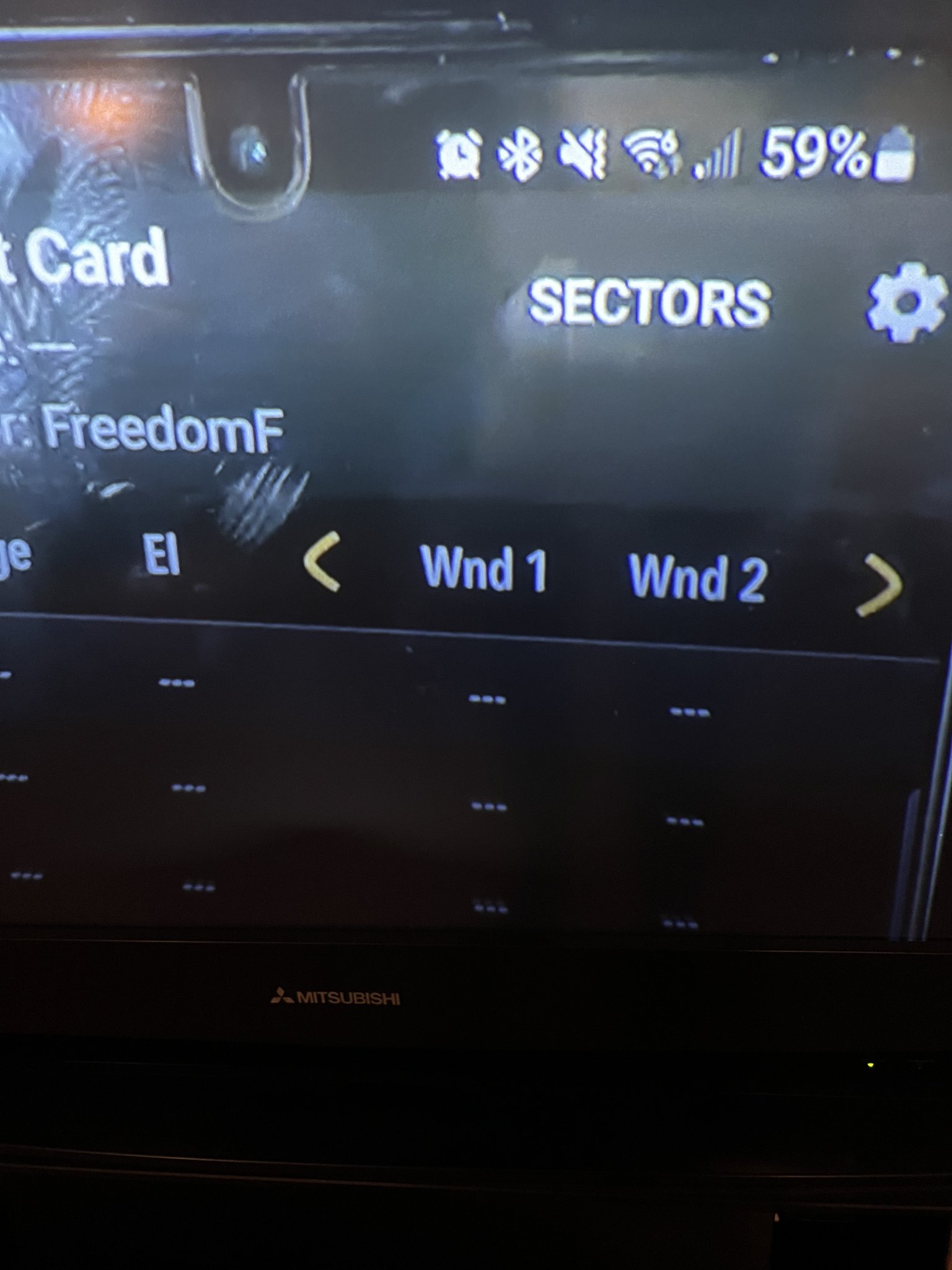

@Kestrel Ballistics My question is about using the Kestrel Link Ballistics (KLB) app to load sectors on my Kestrel 5700 Elite. I have searched and not found my answer.
I have an iPhone and when I go into KLB and select target card it shows a greyed out Rng Card I the upper right corner. From here I can load up targets and send them over to the Kestrel as long as I have the sector
open I want to load. There is no way to save sectors on the phone that I can find.
Why do I ask? My
buddy has an Android and his KLB is different than mine in that he can go to target cars and select Sectors in the upper right corner and it saves his sectors on his phone. This would be extremely handy for me to have since I shoot the same ranges quite often and would save lots of time. I could tweak any COF changes on the fly instead of building them.
We couldn’t find anything on the Kestrel sight that says the two operating systems differ in form factor in regards to sectors.
Thanks to anyone that takes the time to help me out.
Why do I ask? My
It’s my understanding that the update for apple devices hasn’t been released yet. Last I heard was that it might be pushed next week
