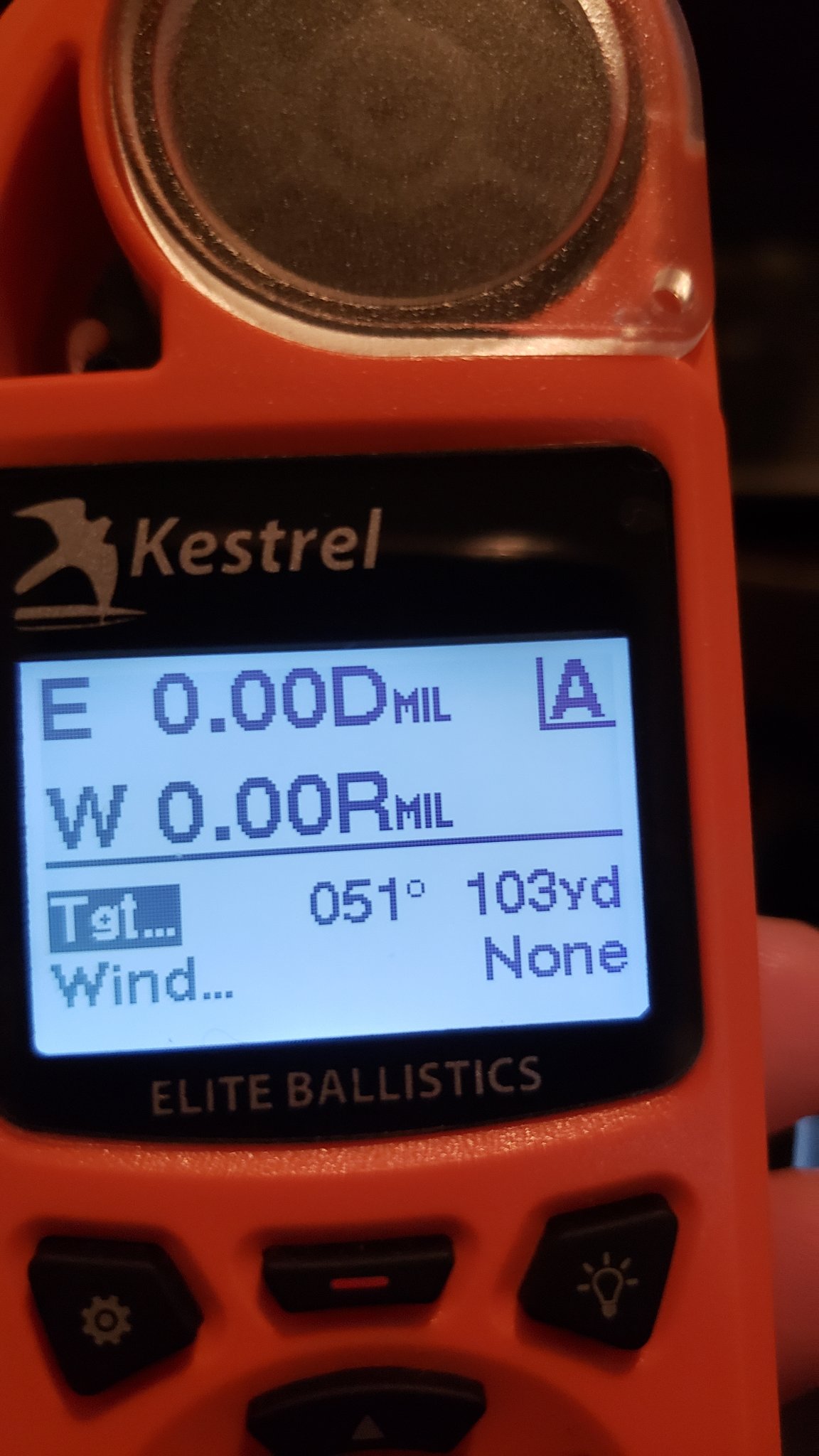

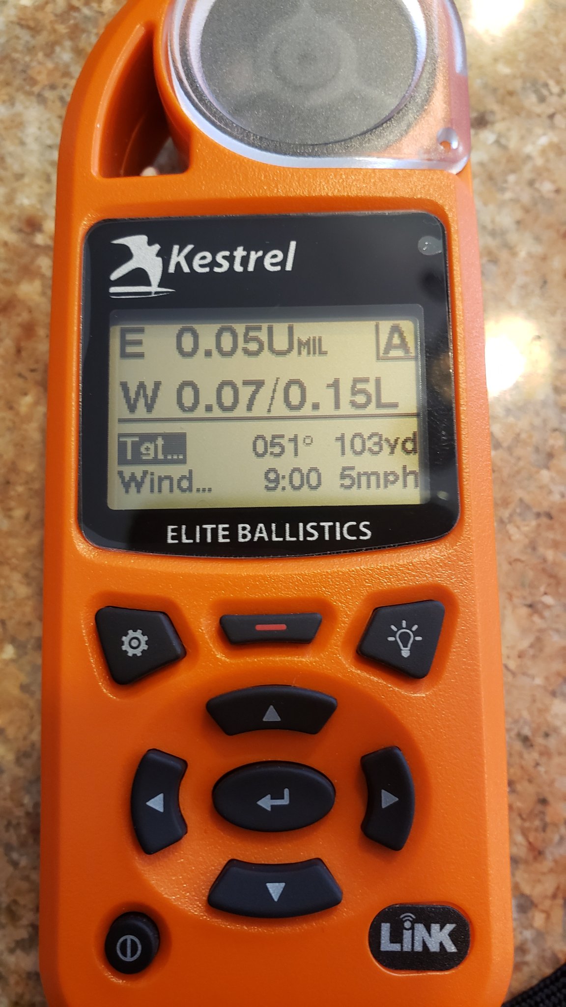

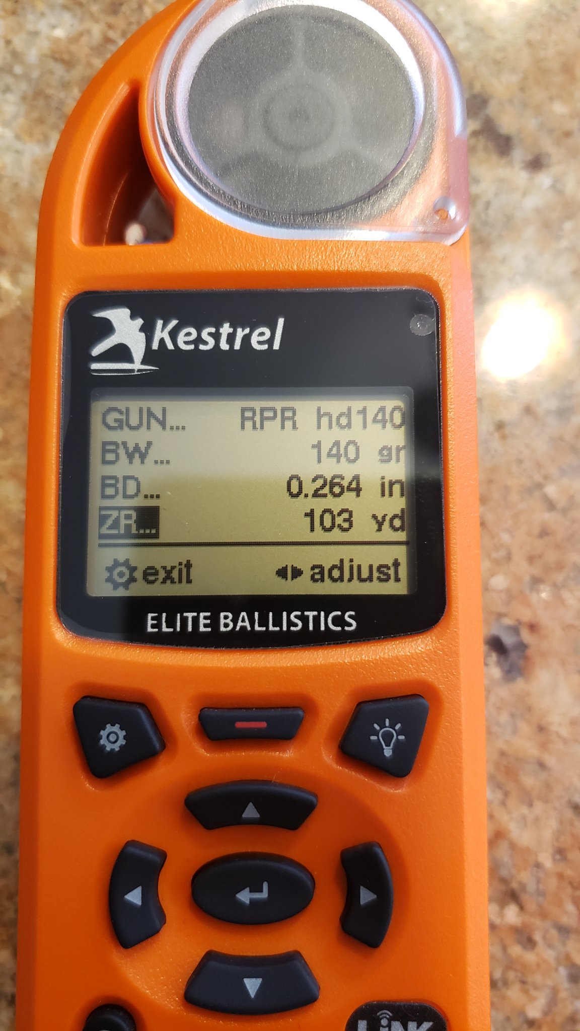

Help me understand what I am seeing, first 2 pictures is my zero distance and it's calling for elevation. I have 5mph and 10 mph 3'o'clock wind. I zero the wind, and the elevation goes to zero shown in picture 3. Is this aerodynamic jump, and if so at 103y?

Help me understand what I am seeing, first 2 pictures is my zero distance and it's calling for elevation. I have 5mph and 10 mph 3'o'clock wind. I zero the wind, and the elevation goes to zero shown in picture 3. Is this aerodynamic jump, and if so at 103y?View attachment 7070164View attachment 7070165View attachment 7070170
Turn spin drift off and either turn latitude to 0 or 1. That should knock out any Coriolis.
Should go to zero when zero wind inputted at that point.
