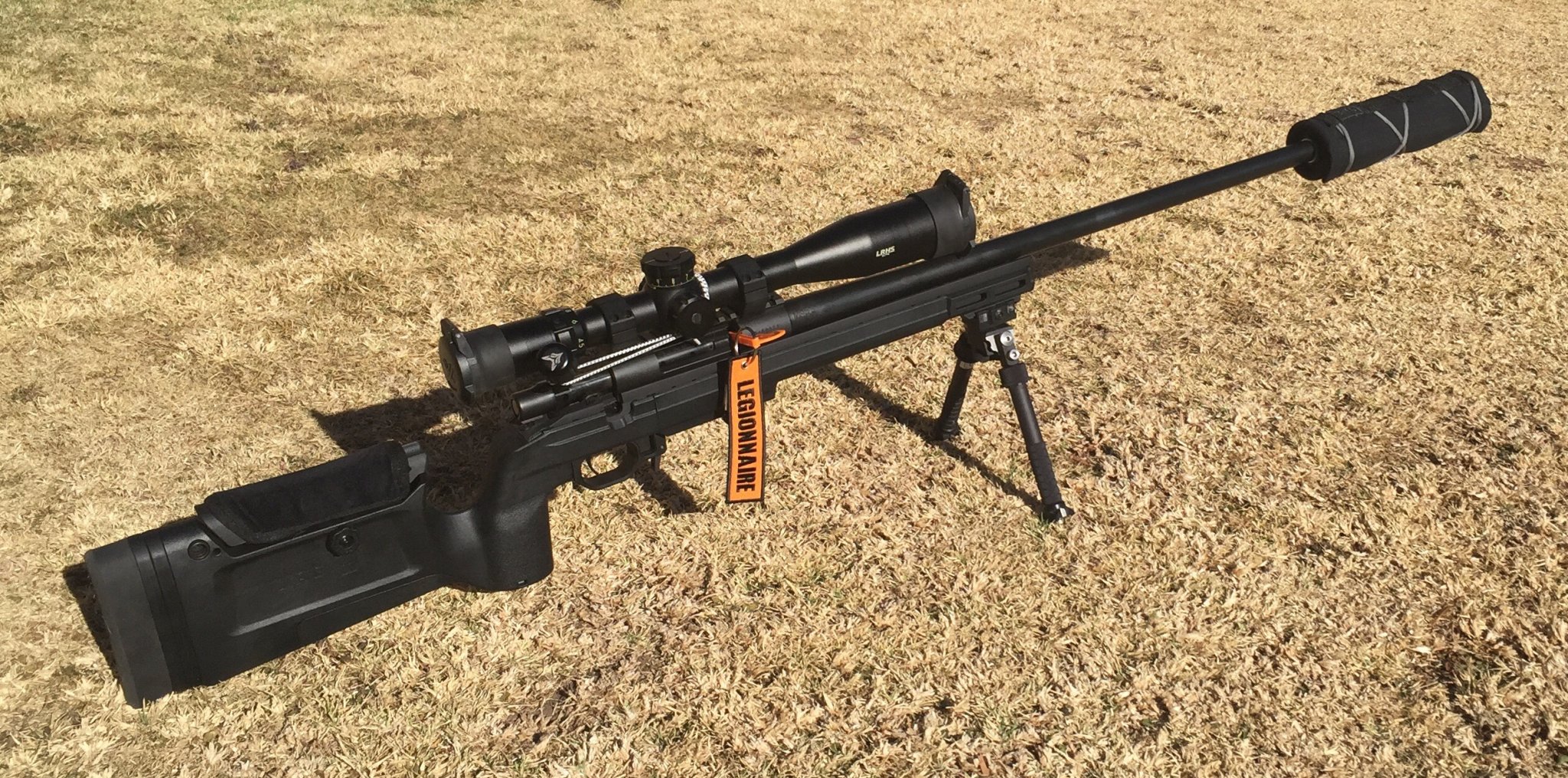

KRG Bravo Chassis
Ready for some hunting

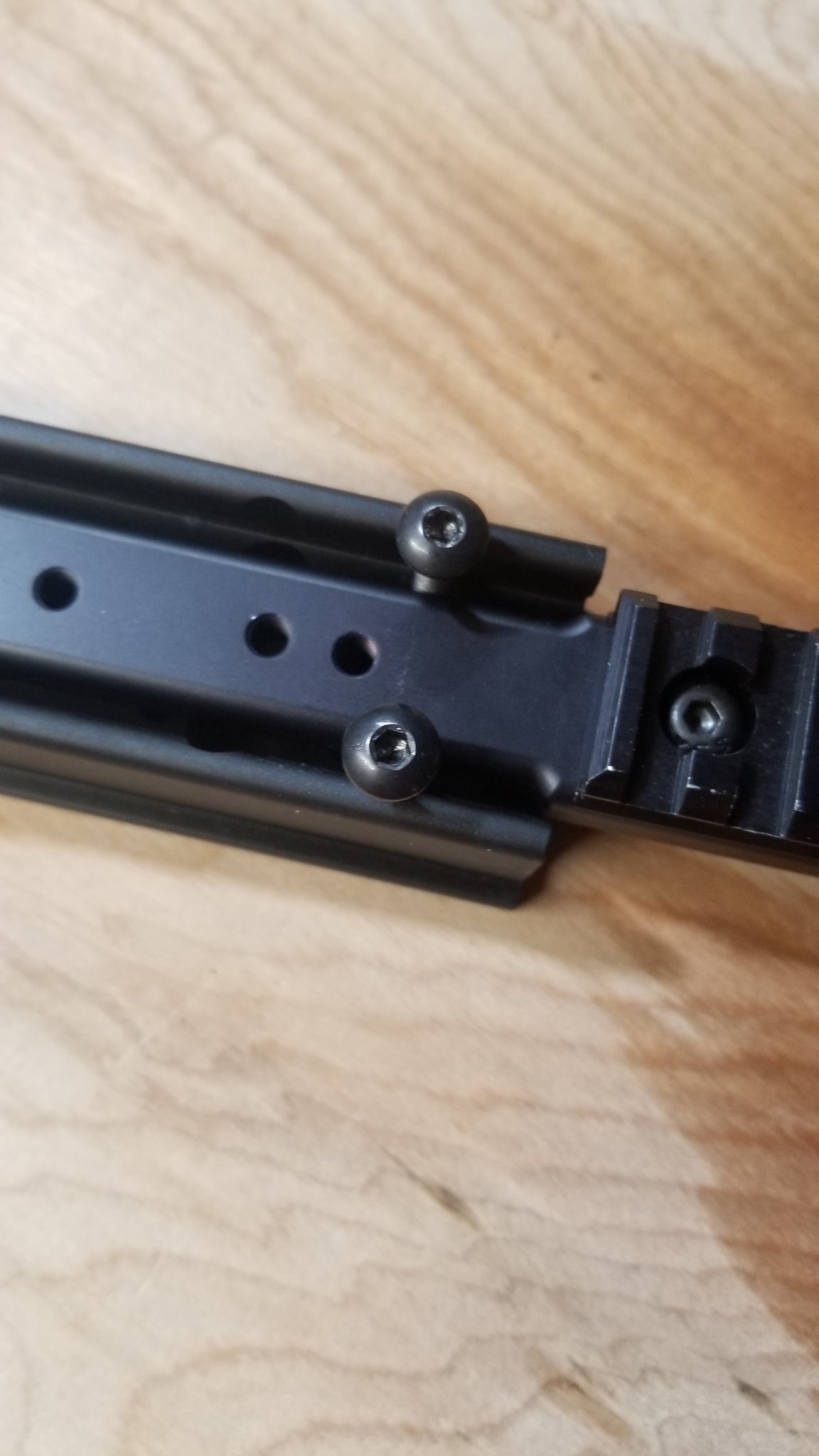

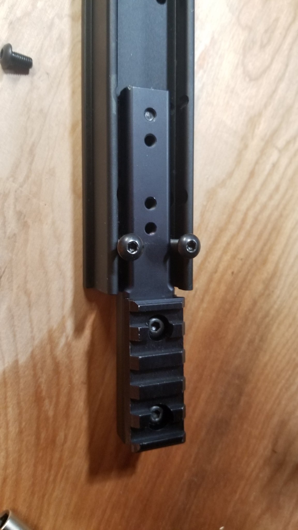

It is kind of a pain in the ass to install the picatinny etc on a bravo because the screws come with blue loctite on them which prevents them from simply spinning with only pressure to keep the backing nut in place. I have to jam something in there for counter rotation pressure to get them to actually tighten instead of spin freely.
And it doesnt help that the forend screws are actually under the picaitnny rail so I have to start installing the forend to get the screws just started, half install the picaitnny rail so that I can actually get it attached but still loose enough to rock so I can access the still loose forend screws under it, tighten down the forened screws and then finally tighten the picatinny rail up.
And I dont have an extended bit so taking the action out doesnt help as I need to have the action installed before I install the forend so that I can access the action screws.
Its actually a pain in the ass but worth it because once assembled its great.
Hi guys, here's a couple ways to get the rail installed:
1- With the chassis completely assembled you can slide the nuts in if you are good, or if you tape the nut to a flat blade screw driver and insert it through the spigot hole
2- Remove forend, install rail onto forend, install forend leaving out very front forend screws
3- Remove forend, tape/epoxy flat nuts into place, install forend, then install rail
@Jackomason We don't recommend an MLok mounted bipod because there is so little surface contact with the MLok mounting system. I think with an Arca to MLok you might be better off but that is still iffy I think. I would suggest to try to run screws into the aluminum backbone if possible, or at least into the wider spaced mount holes on the forend (you put the included hex nuts into pockets inside the forend). If you can't do those, try the MLok way and see what happens and let us know.

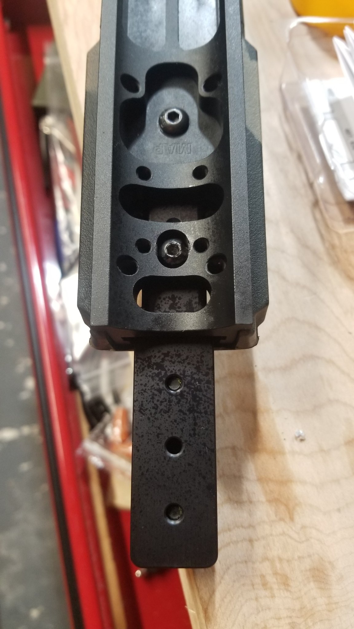

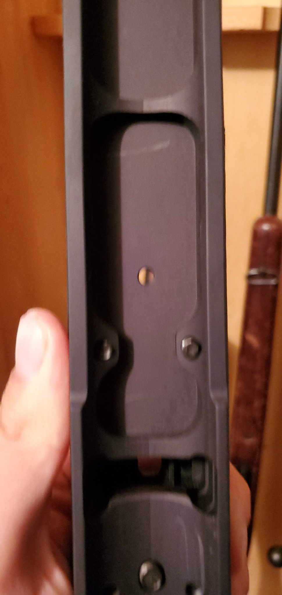

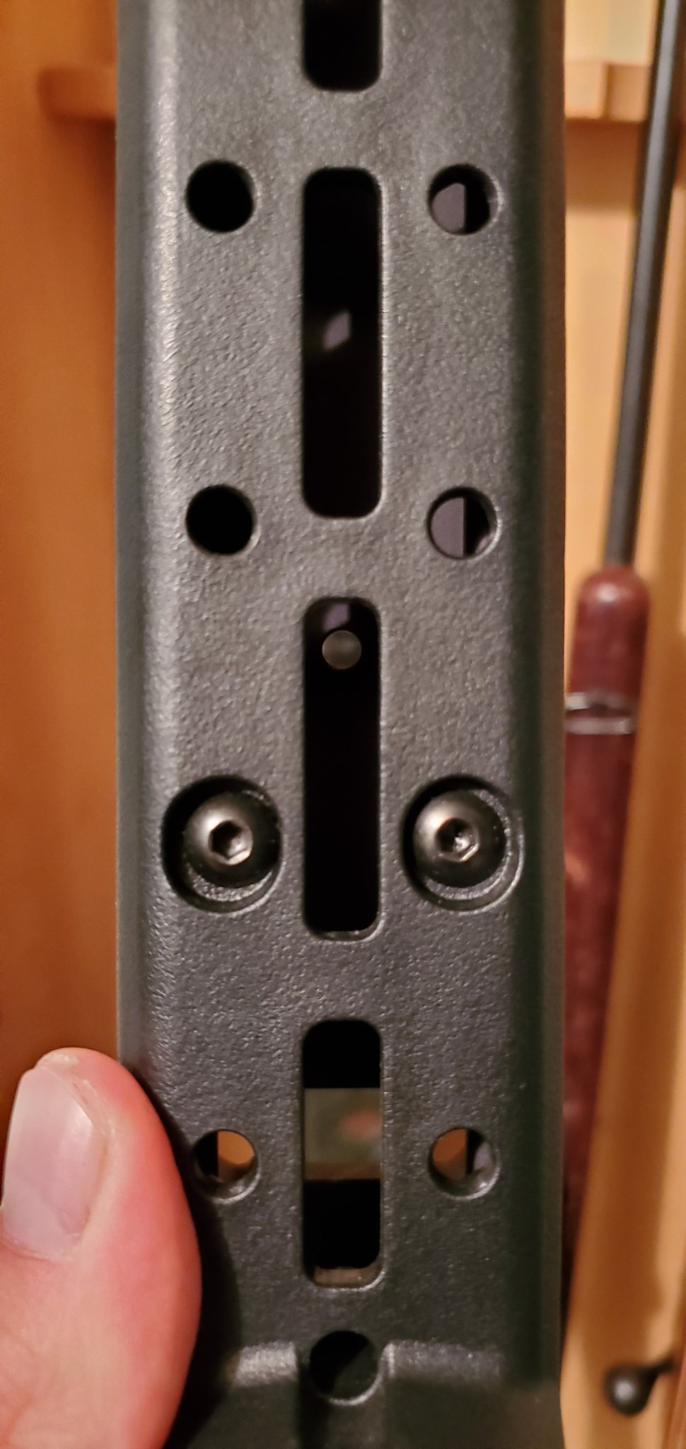

Put an MPA spigot on my bravo today. Had to open up one hole and drill another (used a 13/64" bit in my drill press) and bolted it down to the spigot from the top of the backbone. The screw that sits in the pocket, i reduced the outer diameter of the head with a dremel until it fit down inside the pocket so itd be out of the barrel channel. Super easy.
To be sure it was centered up, just ran the front screws that hold the handgaurd in to the backbone.

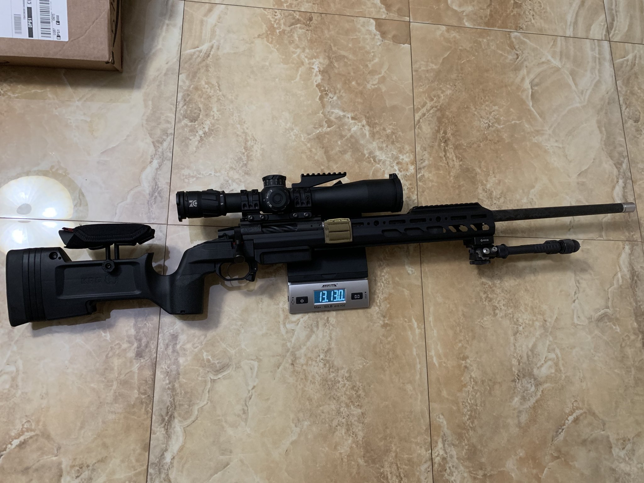

The Bravo being such a light chassis, gets really front heavy with a heavy pipe hanging off the action.
My wife's rifle with a Bravo has a 24" heavy Palma barrel, and it was pretty front heavy. Changed out the stock plastic LOP spacers for two of KRG's weighted metal LOP spacers and balance is damn near perfect.
I would hesitate to go much heavier on the barrel than a 24" heavy Palma or m24 for balance purposes.
Looked at several Bravos in the meantime and came close to the same conclusion. However, I will be going with a 26" M24 barrel, especially since Justin from KRG confirmed that they are working on getting the heavy spacers and front end weights back in stock, they were just overwhelmed by the popularity and demand. Should they not be in stock by the time I'll need them I can always temporarily go with some of the heavy filler material beads I've got for bags. This one will not be a light hunting rig but more for the range and private competitions. Also besides the LOP and front end weights, their heavy barricade stop is another option for achieving balance.

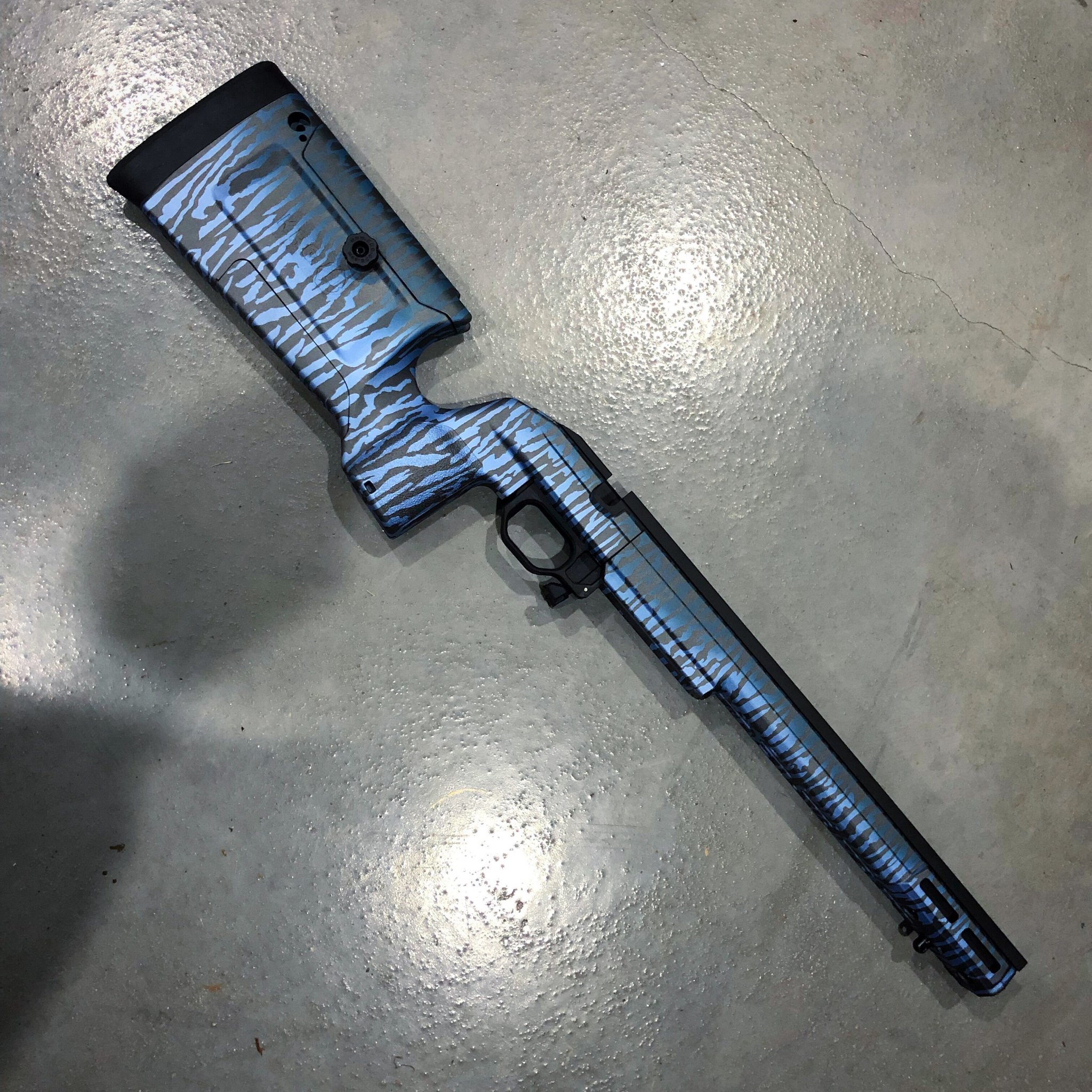

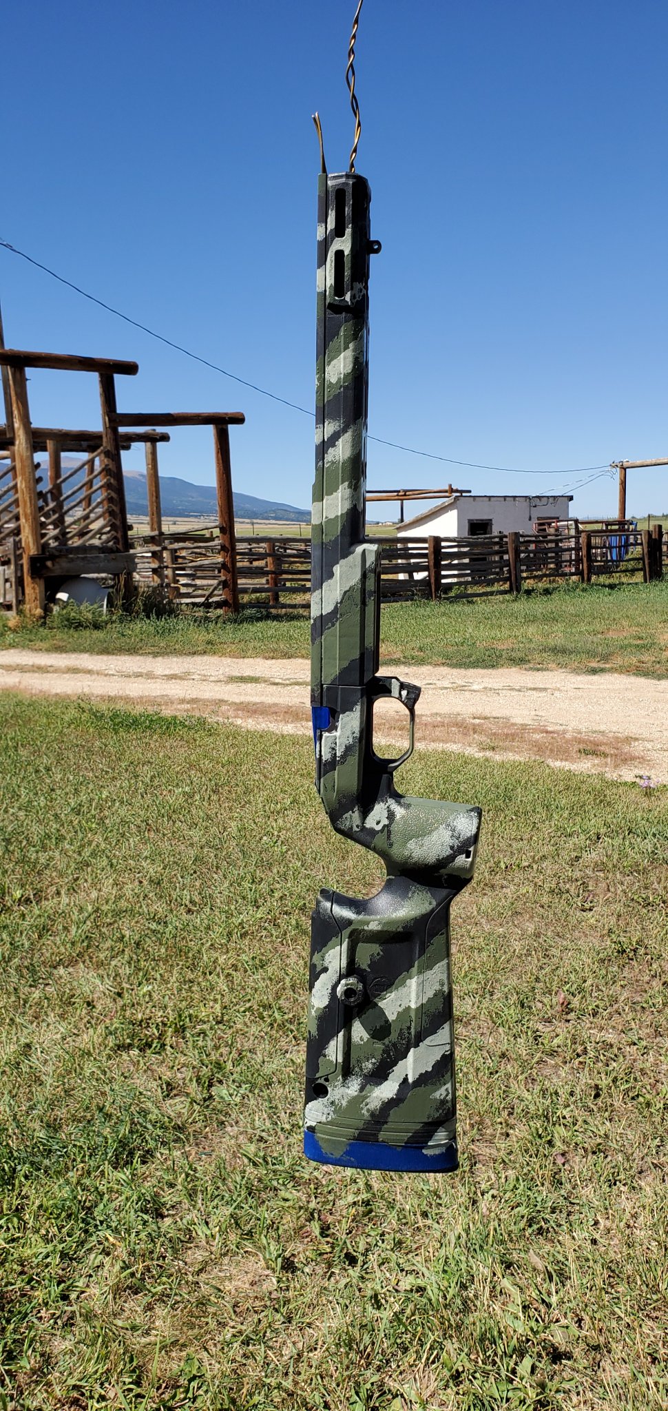

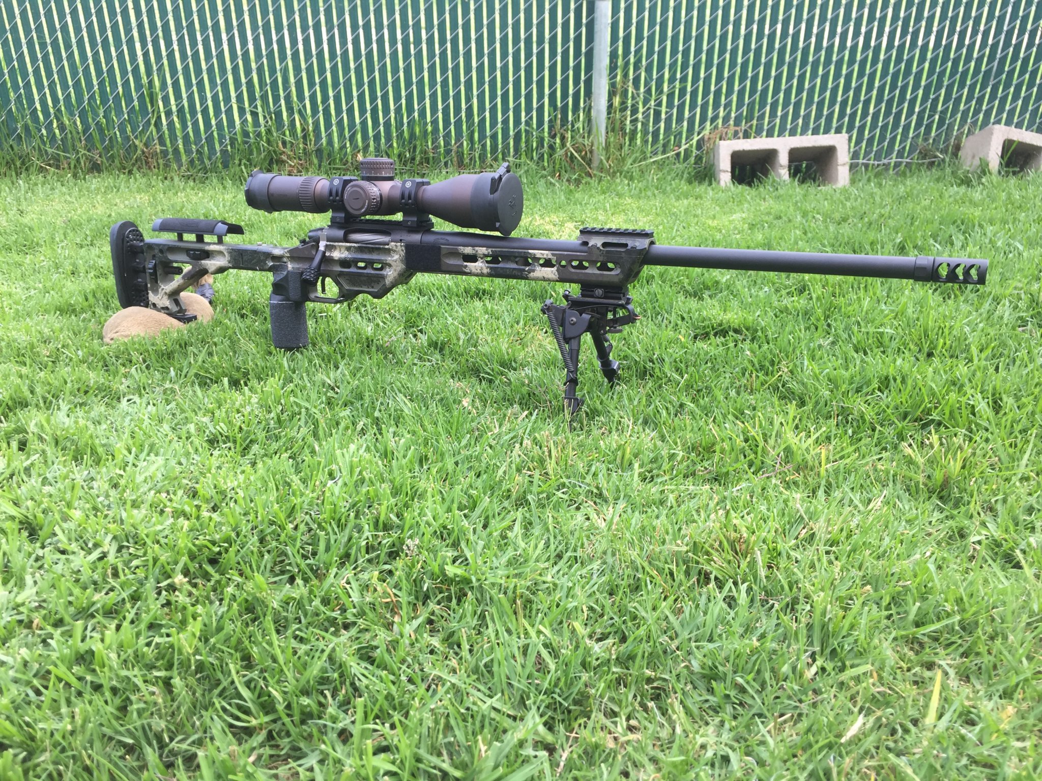

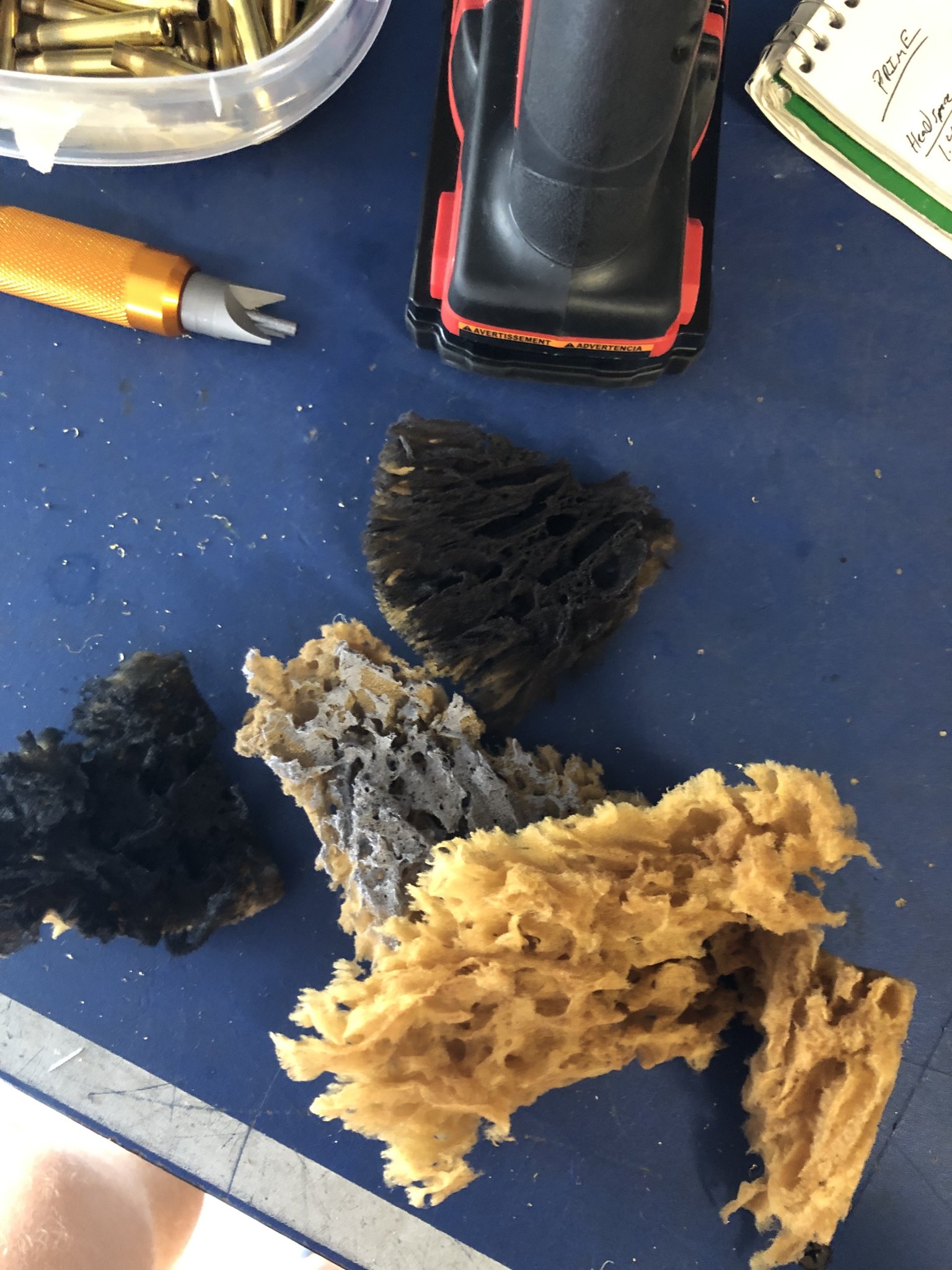

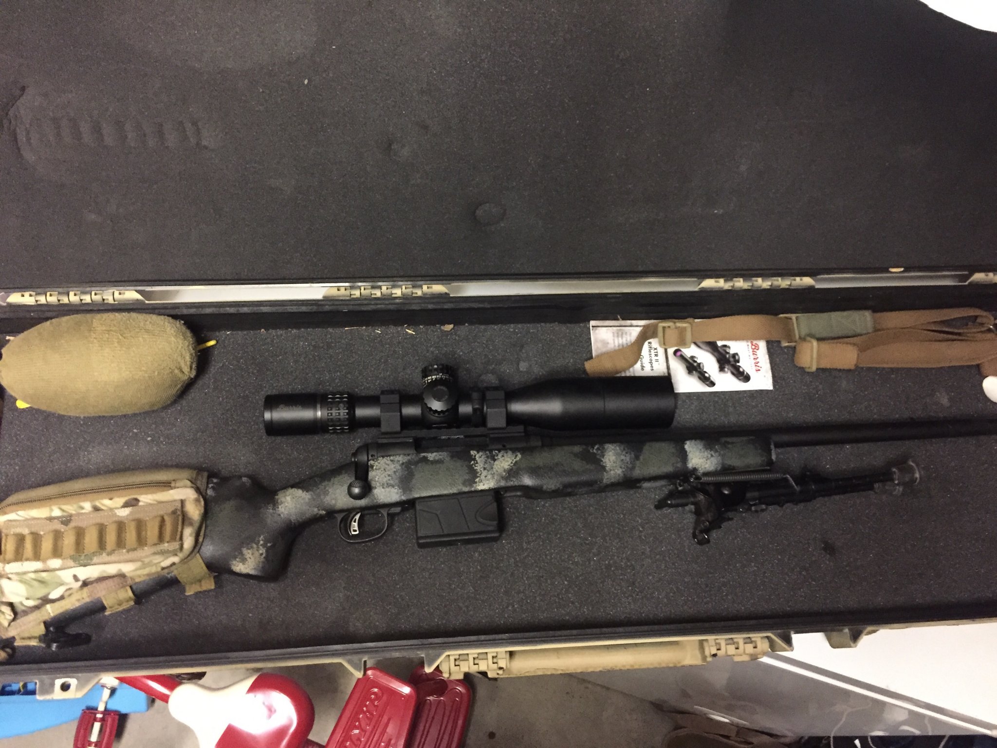

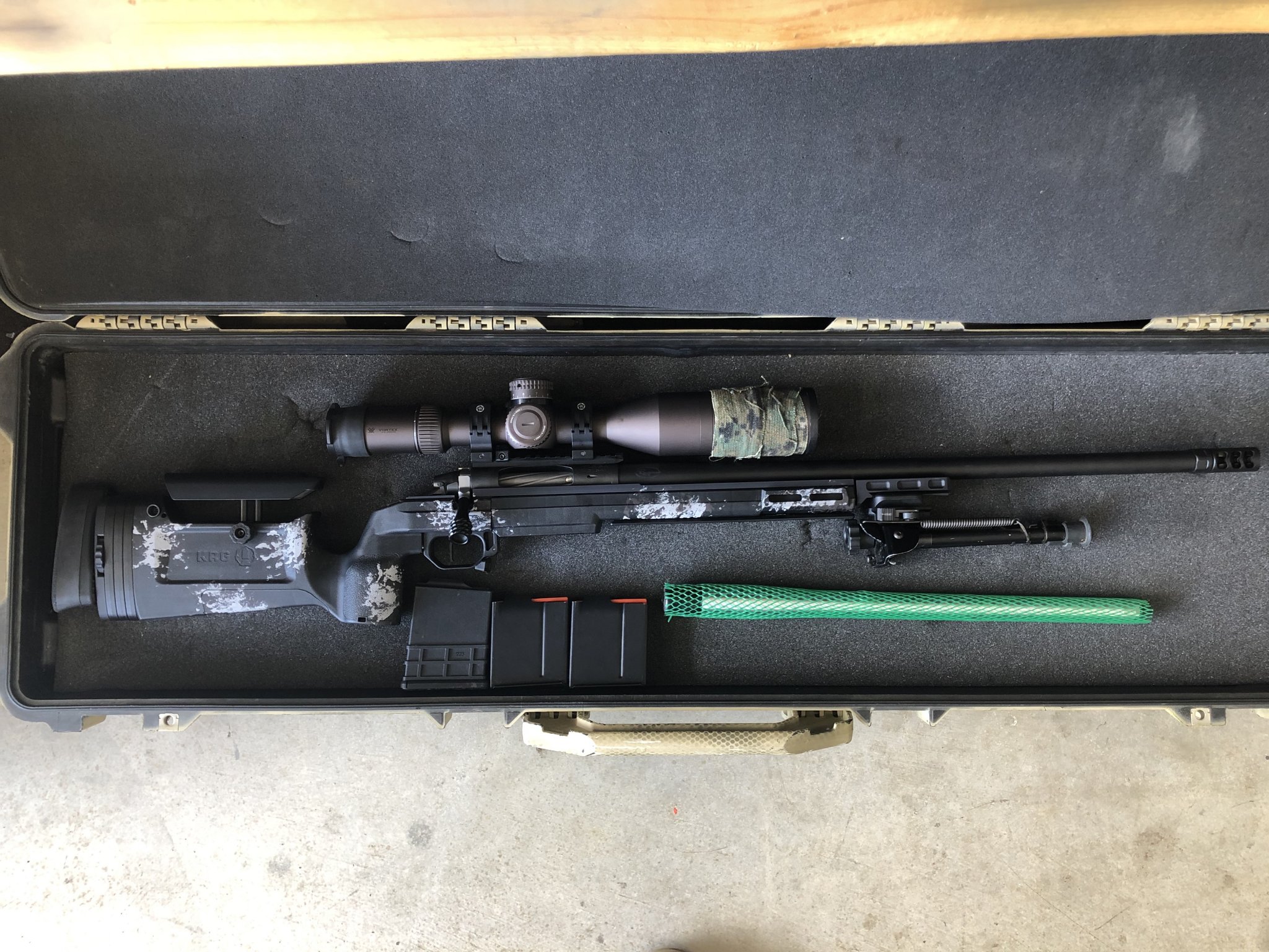

What did you use to get that paint texture? Looks great.
Sea sponge. I spray paint into a paper plate, dab the sponge in the paint and just go to town. I am a fan of manners paint schemes so I’ve loosely based it on that
