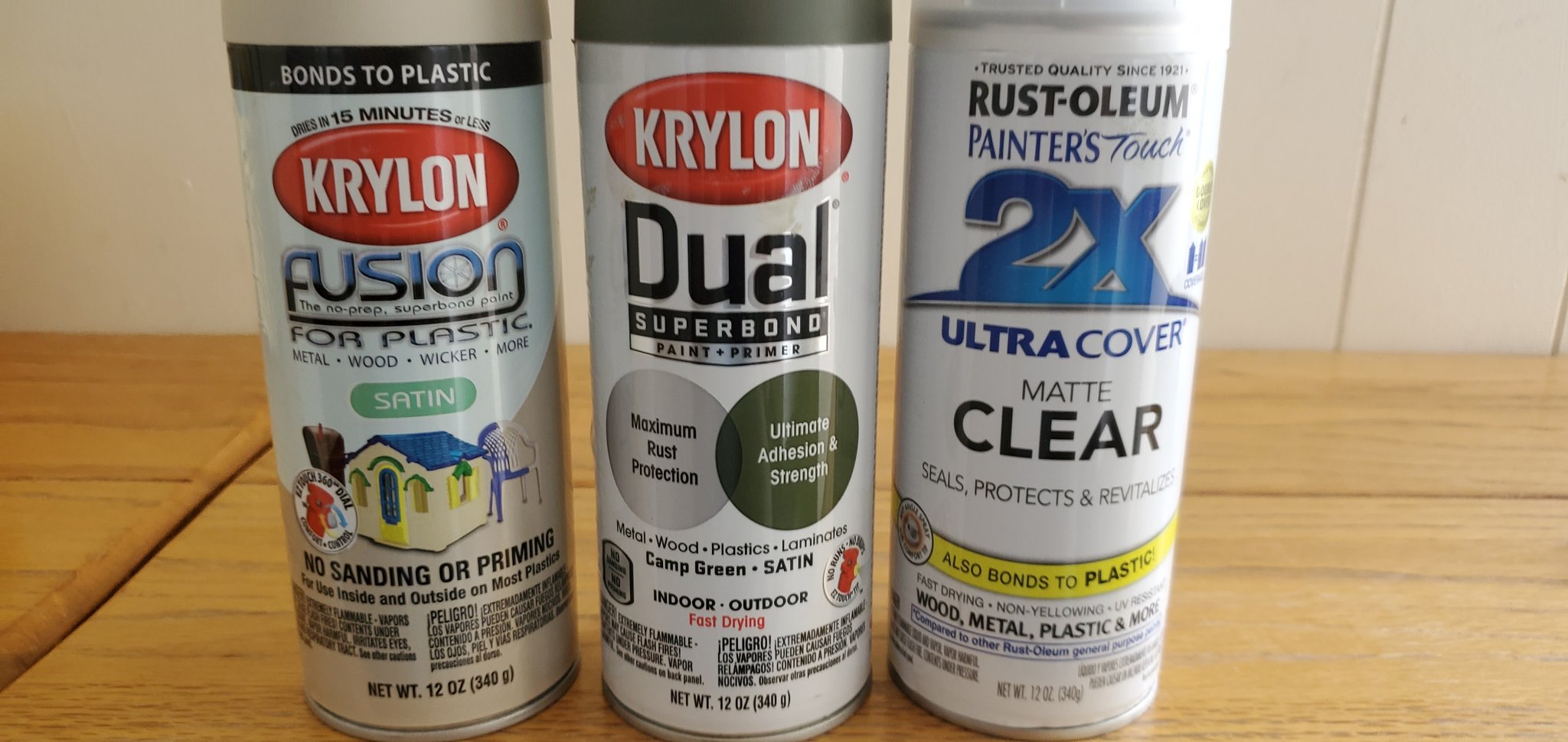

Choose a good brand, prep it and follow the instructions. Ideally for long lasting, do thin coats and do a lot of them (4-5 thin coats with 10-15 minutes between) clear coat goes on thin so you can do 2-3 of those. It's really not rocket science... it's worth practicing on cardboard and starting each coat with a quick spray on card board.
This is what I used.
I used a sponge so coats were thicker and had more time to dry between each so that colors didn't run together. The paint sticks well to the roughed up surface of the bravo nothing to worry about there.

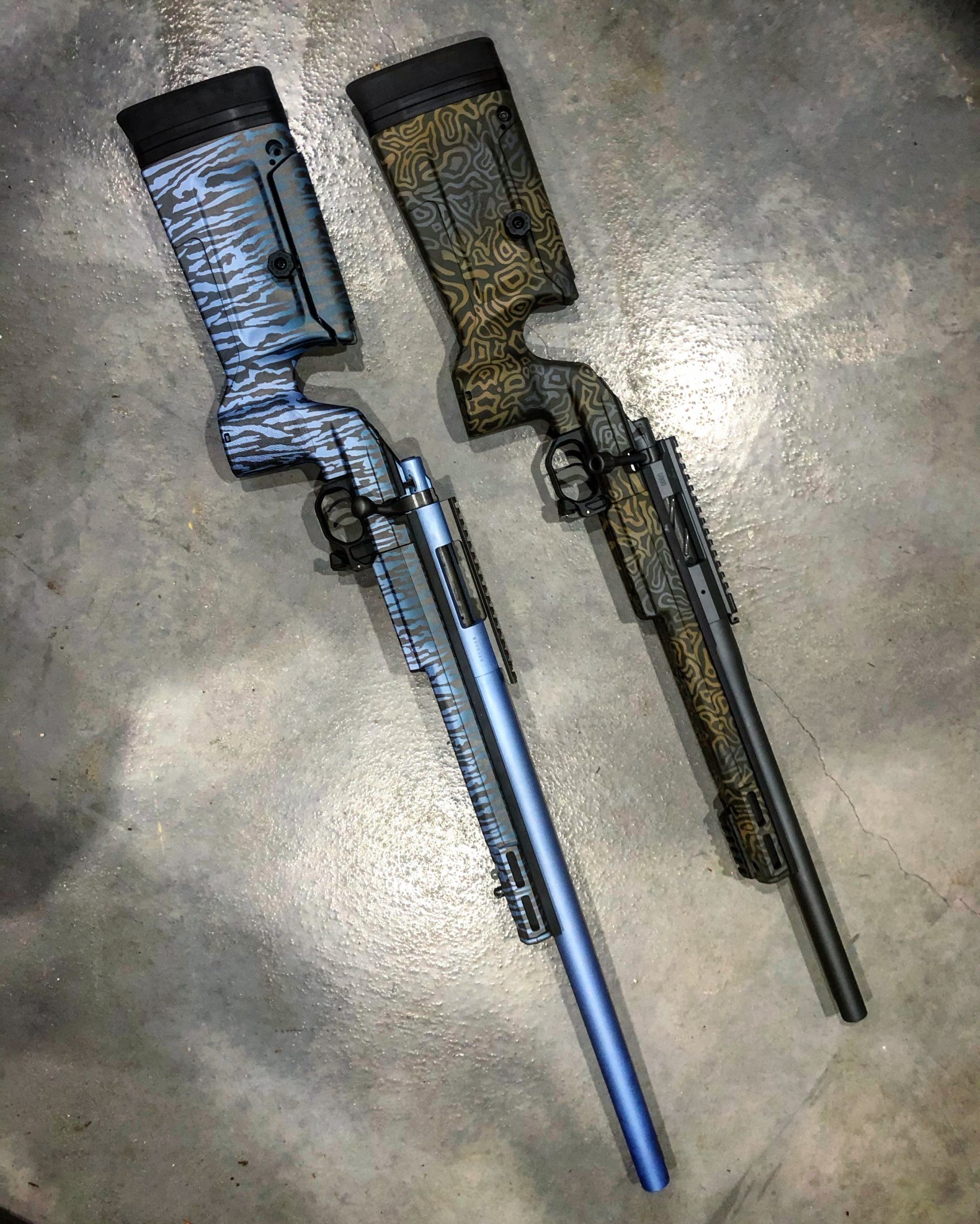

Finished coating these barreled actions late last night.
Blue - 20” 8tw MTU IBI barrel; 223AI on a Howa
Sniper Grey - 16” 7TW RemVmt IBI barrel; 223AI on a Ultimatum U300
Blue one is a buddies, the 16 is mine. can’t wait to get them to the range.

Your rifle is purdy! Do mine! ?

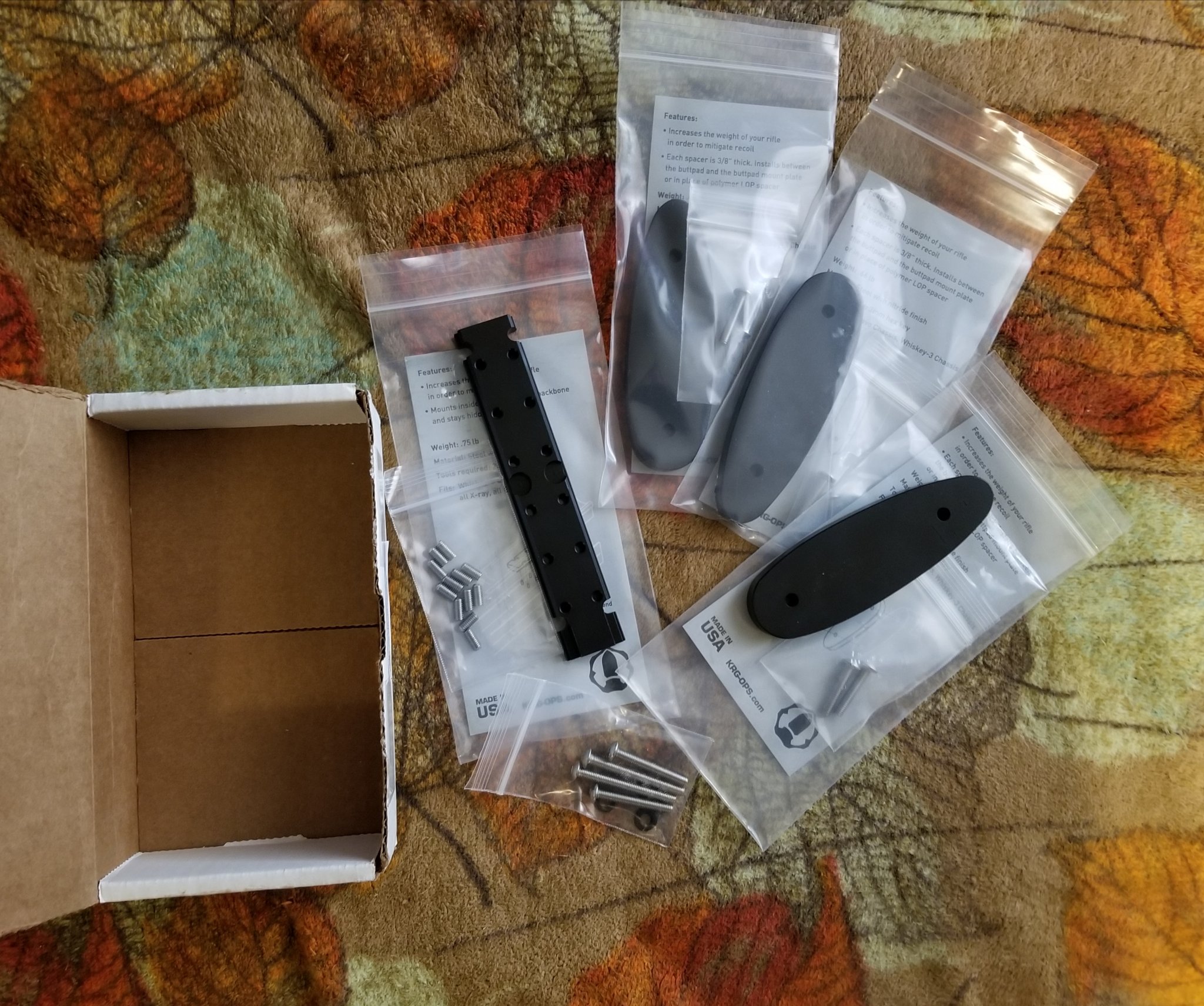

Most have been to the web site and know about the heavy LOP spacers and the forend weight, and have been on the notification list to receive an e-mail once they are available. TmDoc can correct me if I'm wrong but I believe his question was not directed to the issue if KRG will produce a weight system, but when it will be in stock and available for purchase.
There are other ways to add weight with bag filler material, lead, or stainless steel shot, with or without resin. decoy, or tire lead weights, a.s.o. but KRG sure can make a pretty penny by getting the LOP and forend weights out there, maybe by adding a designed weight kit to the grip, cheekpiece, or an insertable weight for the buttstock.
A lightweight chassis stock is great for hunting but a great many who have purchased the Bravo use it for range and competition shooting, and balance and weight is a prime concern not necessarily how light it is. The modularity of the KRG chassis line and interchangeability is a definite plus, although not all parts fall into that catgory.
Having the ability to add, or shed weight on a stock/chassis is one of the reasons why I''m choosing the KRG Bravo over say a Manners, or McMillan for my next custom build, besides the ability to add, or change features, and not have to worry about having to add bedding, pillars, or DBM metal.
Hopefully the weight kits will be in stock on the KRG web site soon. Santa will be getting a workout if they are is my prediction.

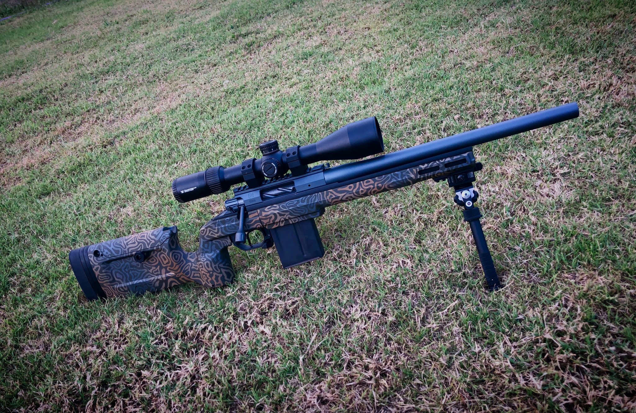

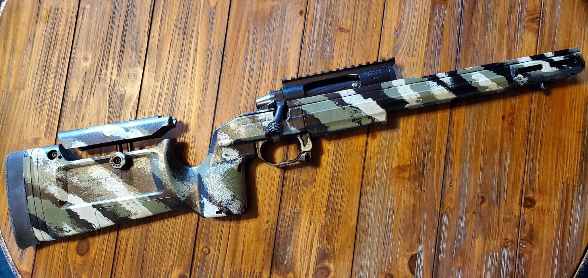

Great job with paint.

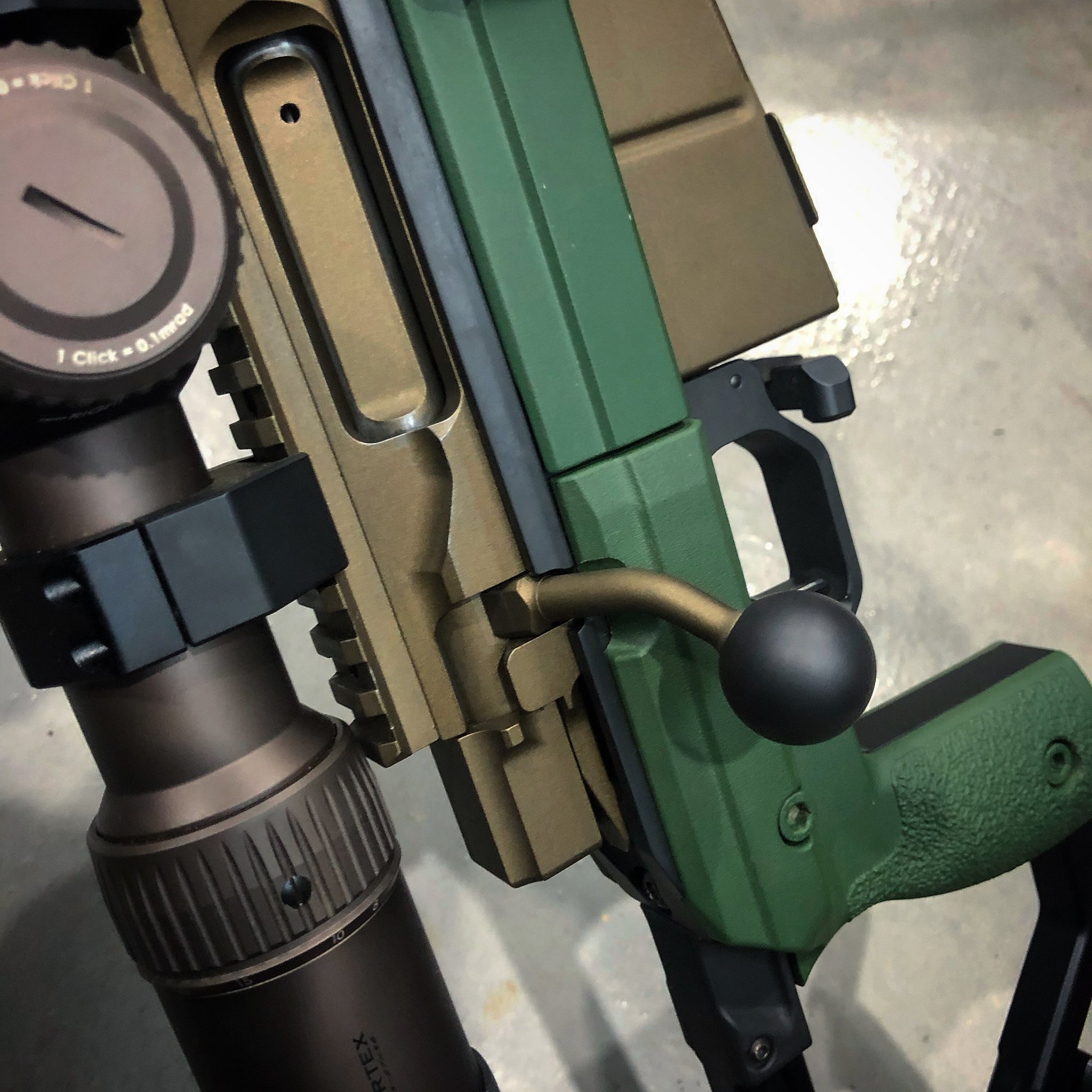

What Cerakote have people done with the Sako Green stock? I’m wanting to Cerakote the action and maybe barrel but would love to see some ideas. I’ve got a brand new ctr non stainless.
I did Midnight Bronze with my Highland Green Whiskey 3 and like the combo. Otherwise Sniper Grey/Tungsten/Cobalt would be safe and classy combinations.

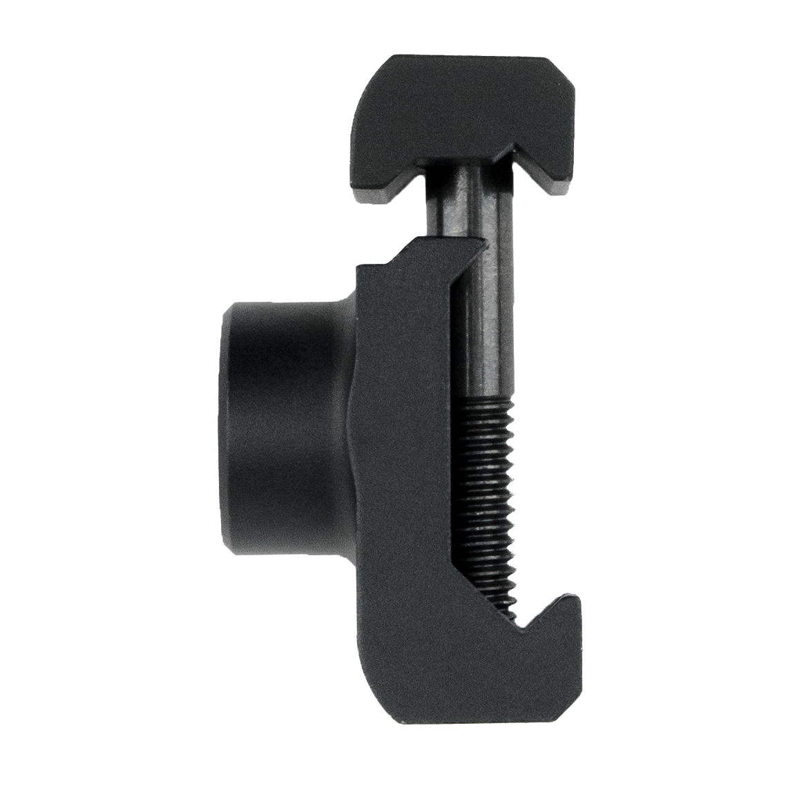

Does anyone know where I can get a OD limited rotation sling mount that will work in the X-ray chassis? I have the OEM QD sling cup, but I want to use a limited rotation QD cup.
Maybe not the most elegant solution but a friend who had one of these left over from an AR had it mounted on his X-ray via pic rail.
