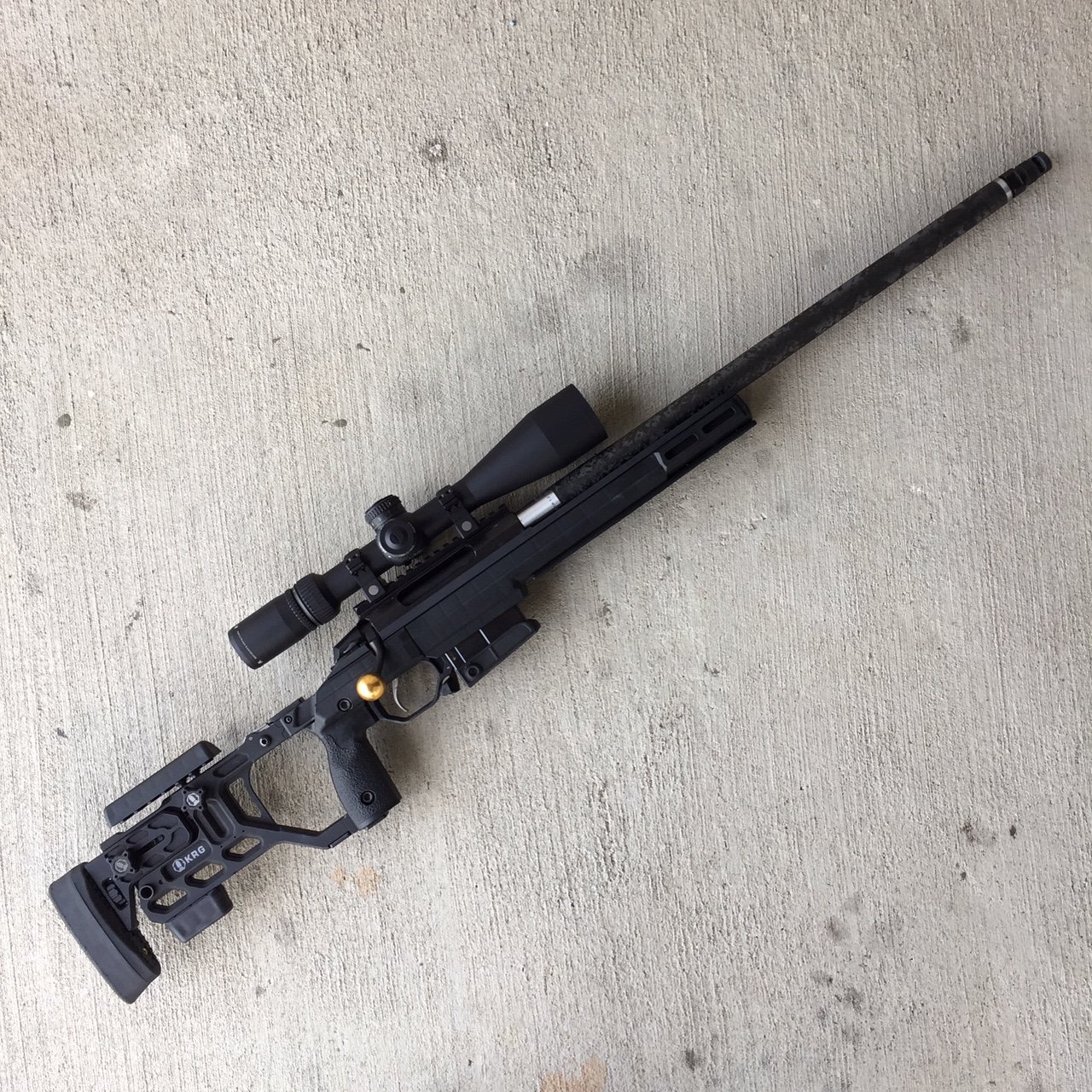

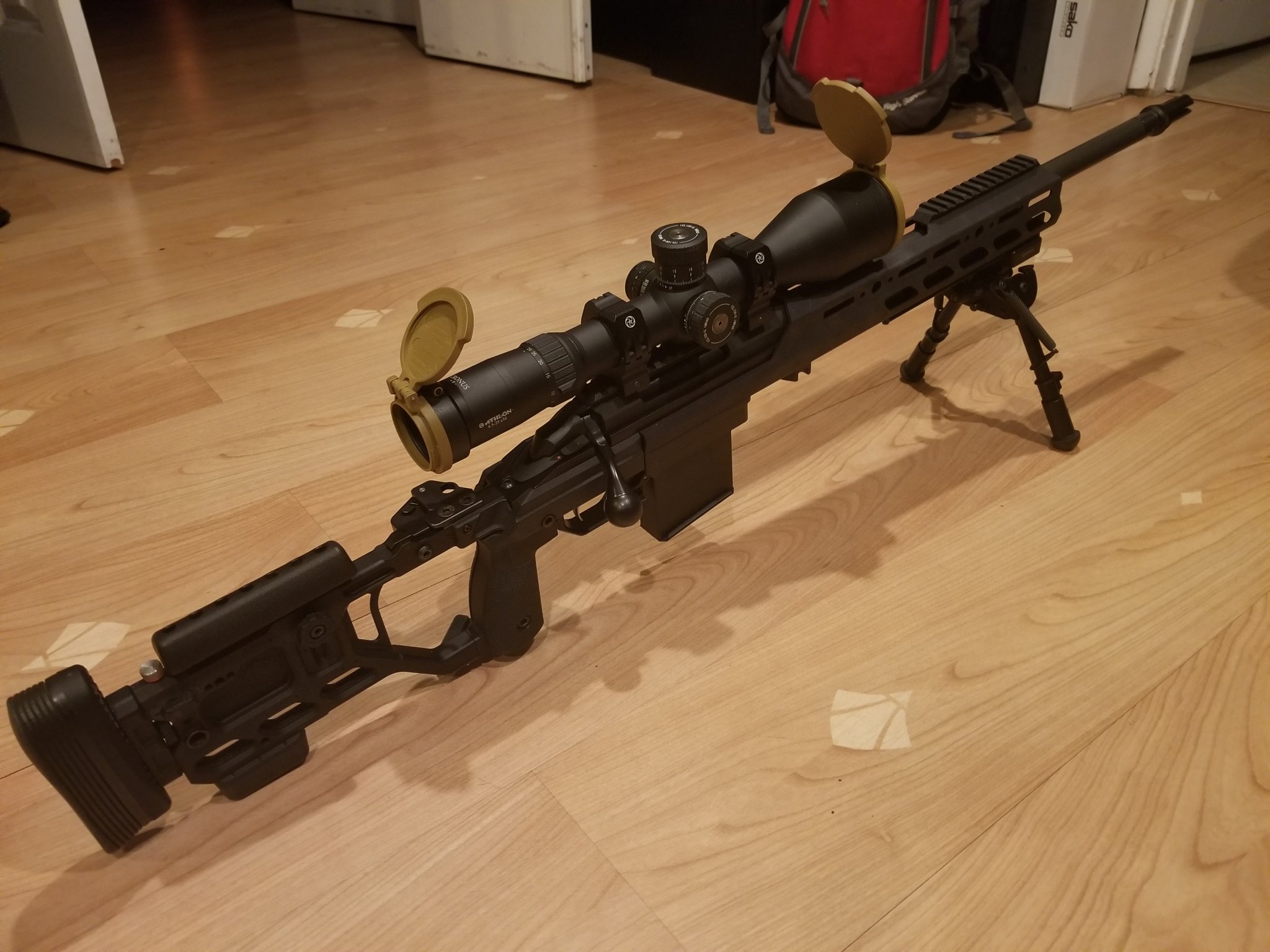

Curtis Vector, Bartlein 8 twist, 6.5cm, Jewell trigger, accurate mag, Nx8 4-32

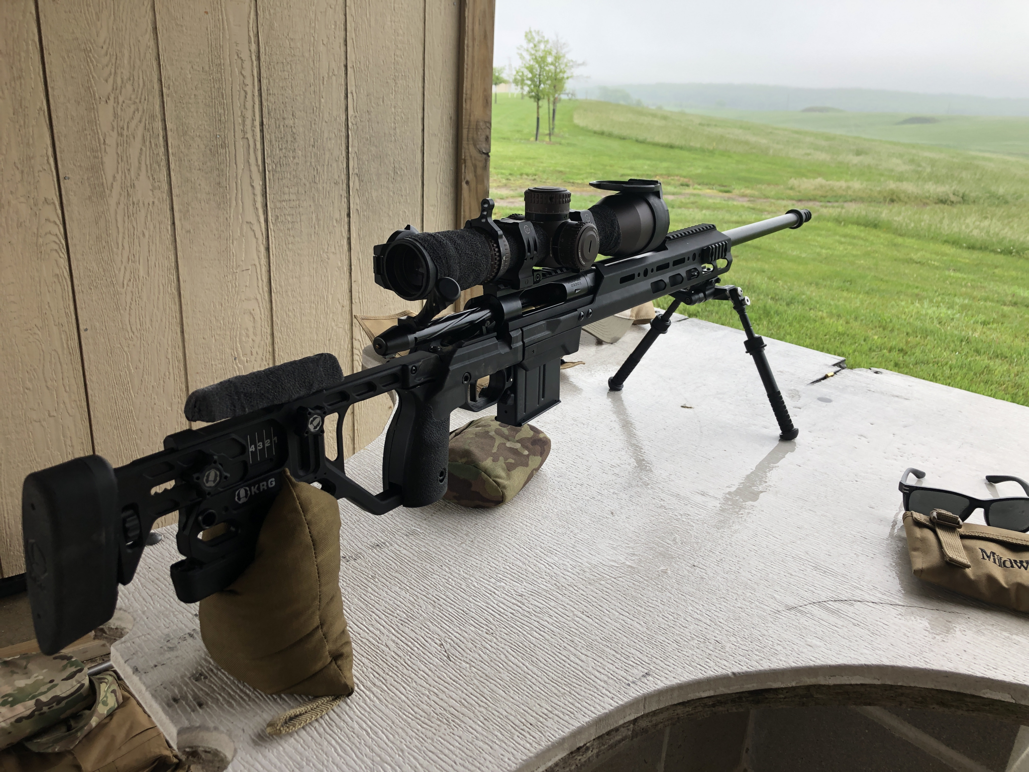

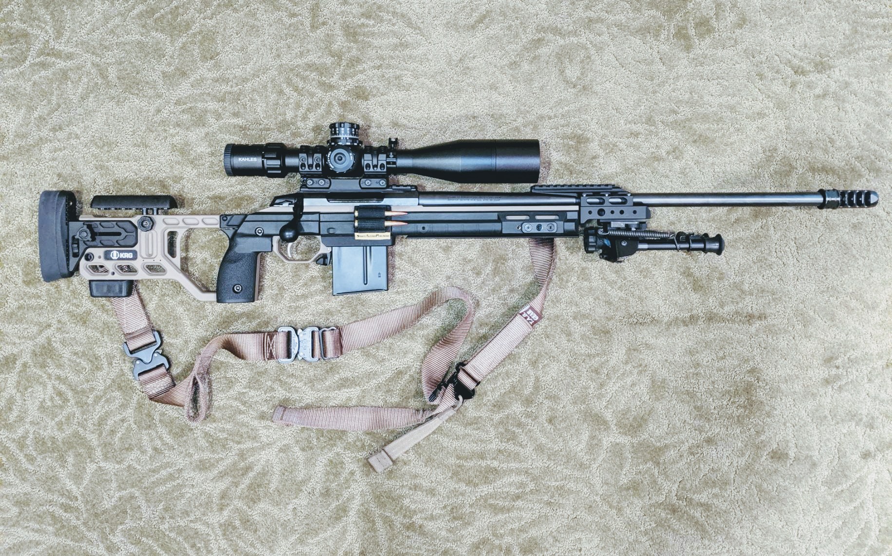

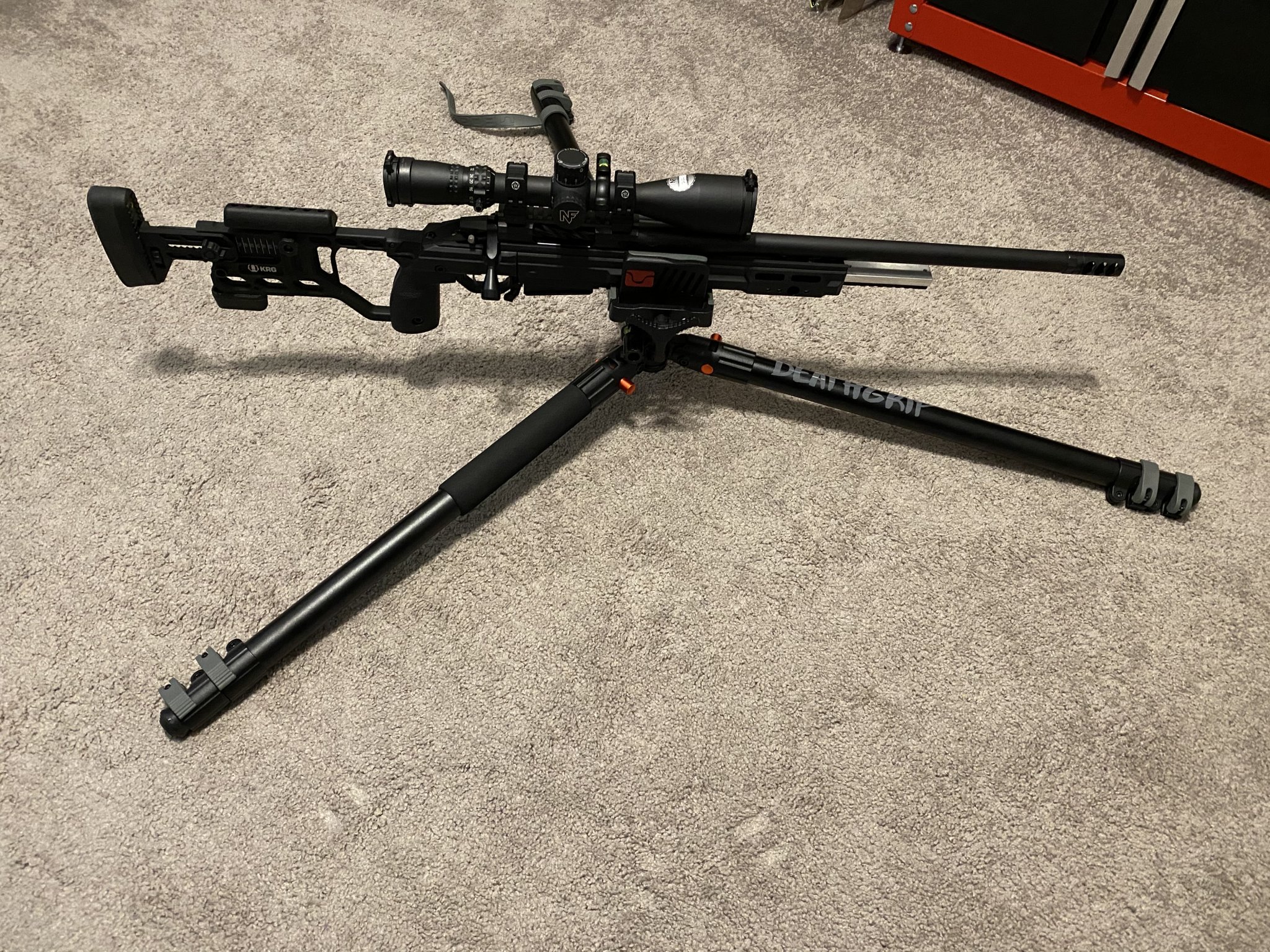

Stiller TAC 338 chilling in the KRG whiskey 3.

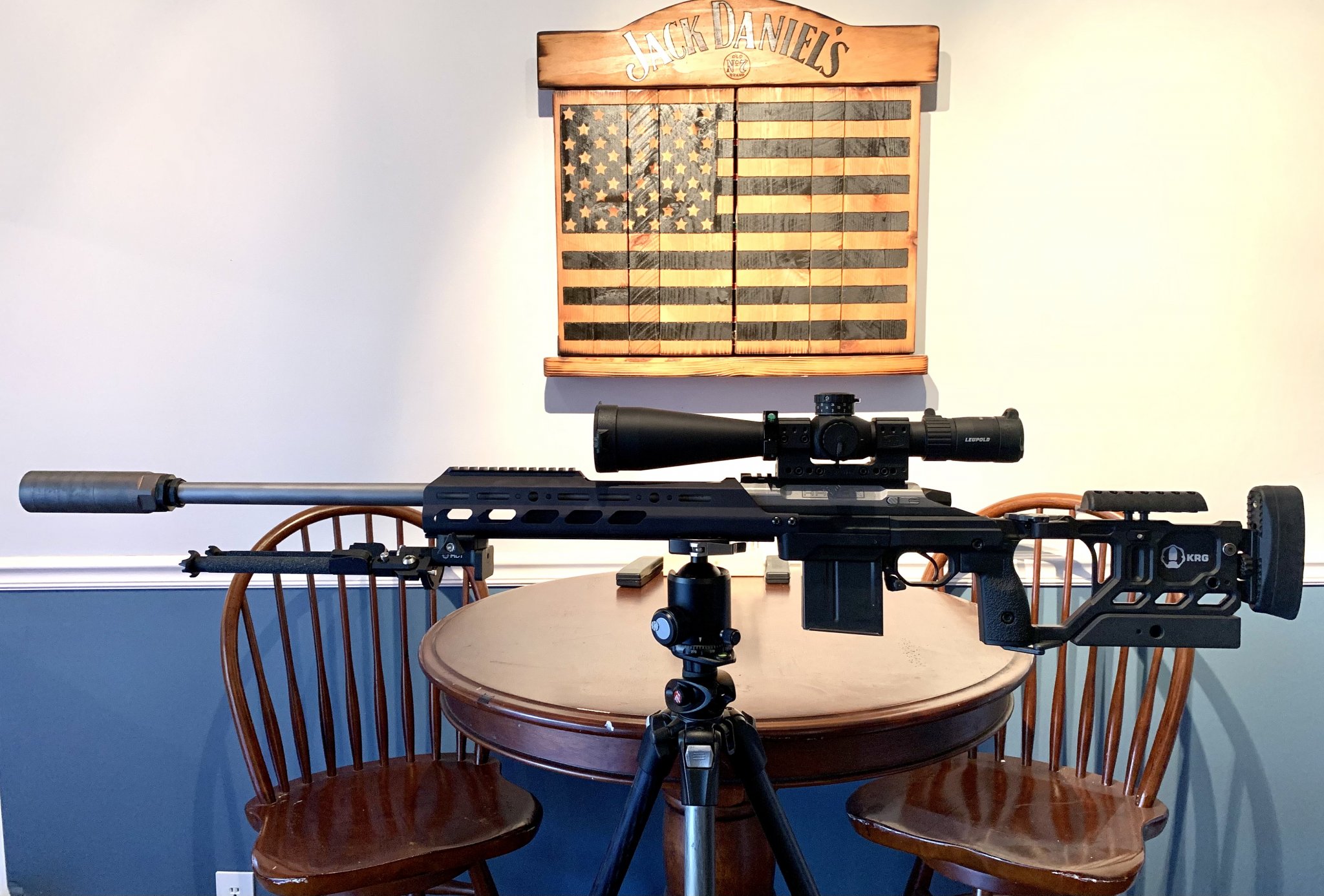

No problems with KRG AICS mags...

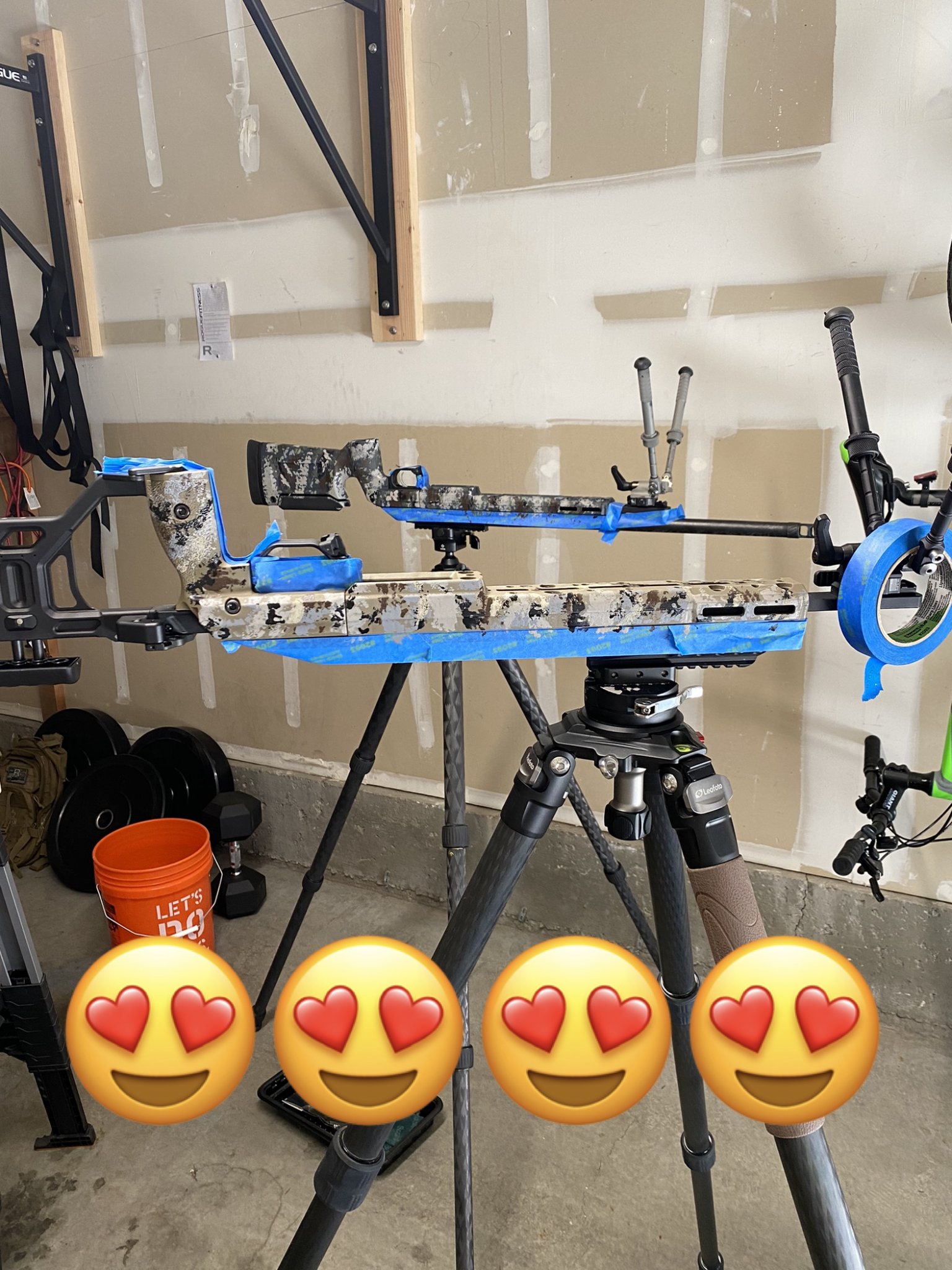

That is a badass paint scheme! Branden does great work, and I love that it's a topography map!
Is the topography map of a specific place that means something to you, or is it pretty random?
Its completely random. I came up the scheme and told him "something like this". He knocked it out a the park.

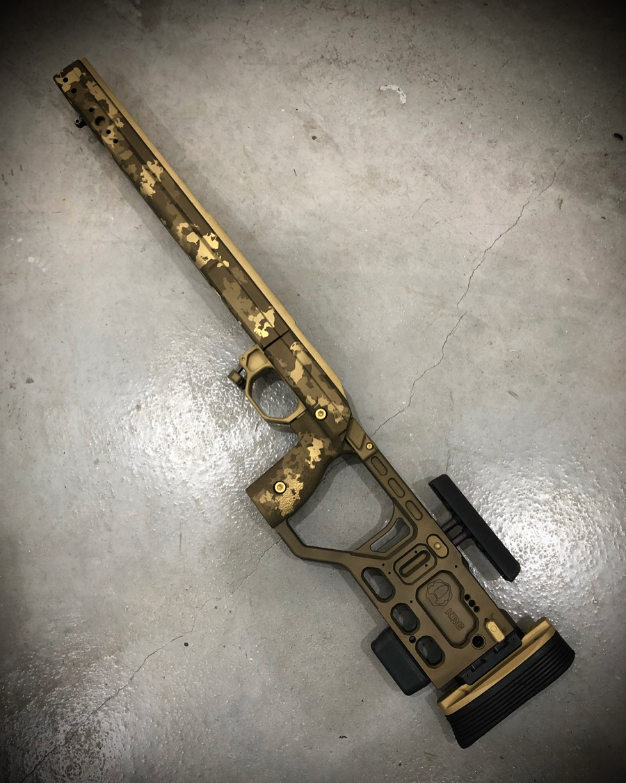

@charnicus

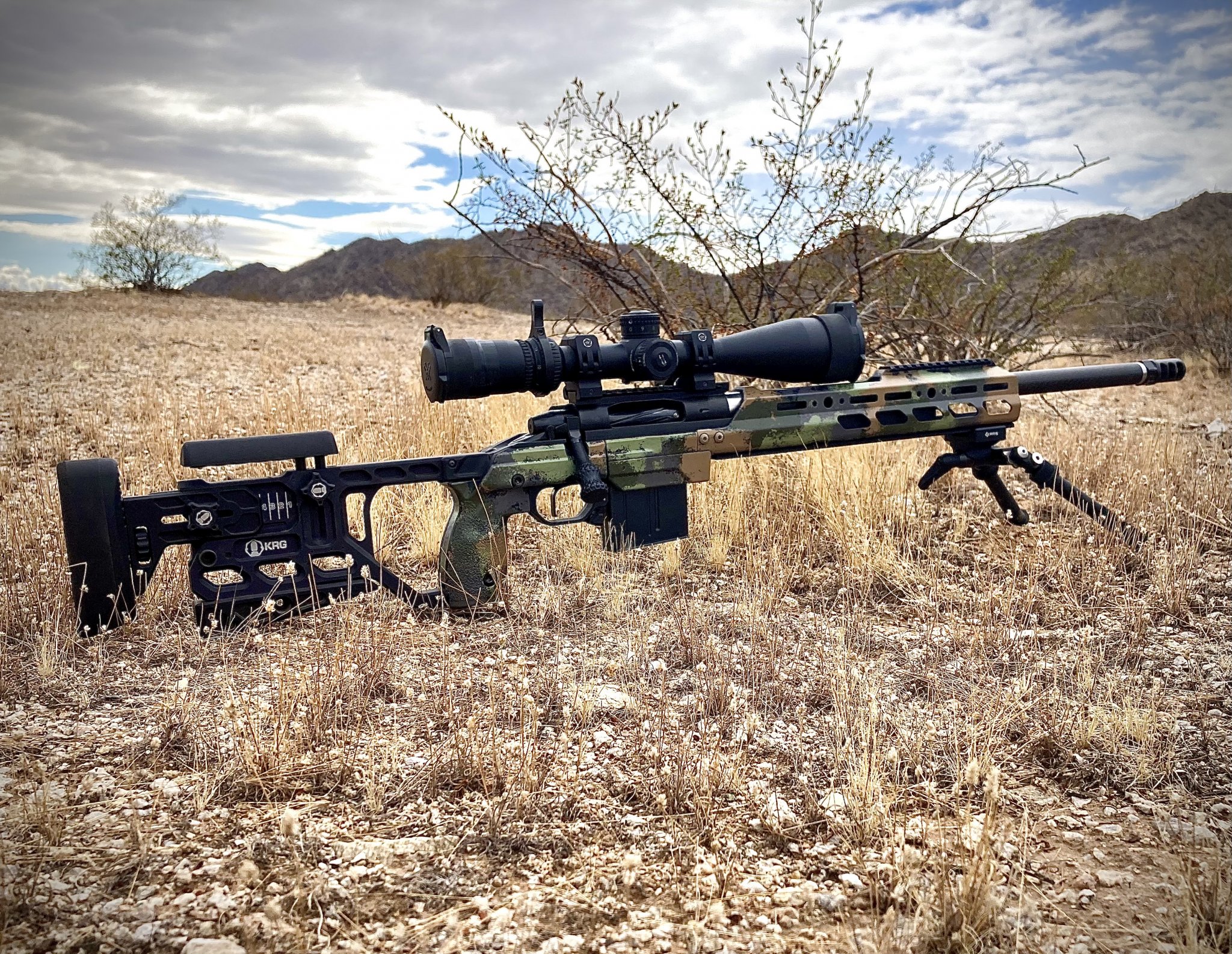

If I knew you could pull off a paint job like that, I would've just sent you my whole W3, let you swap the rears, and have you paint mine too! Looks good! Glad that folder found a happy home.
Reactions: charnicus
@charnicus
Haha you and me both! I’d still paint em for you if you sent me the plastic goods. I’ve got another backbone to secure everything onto.
